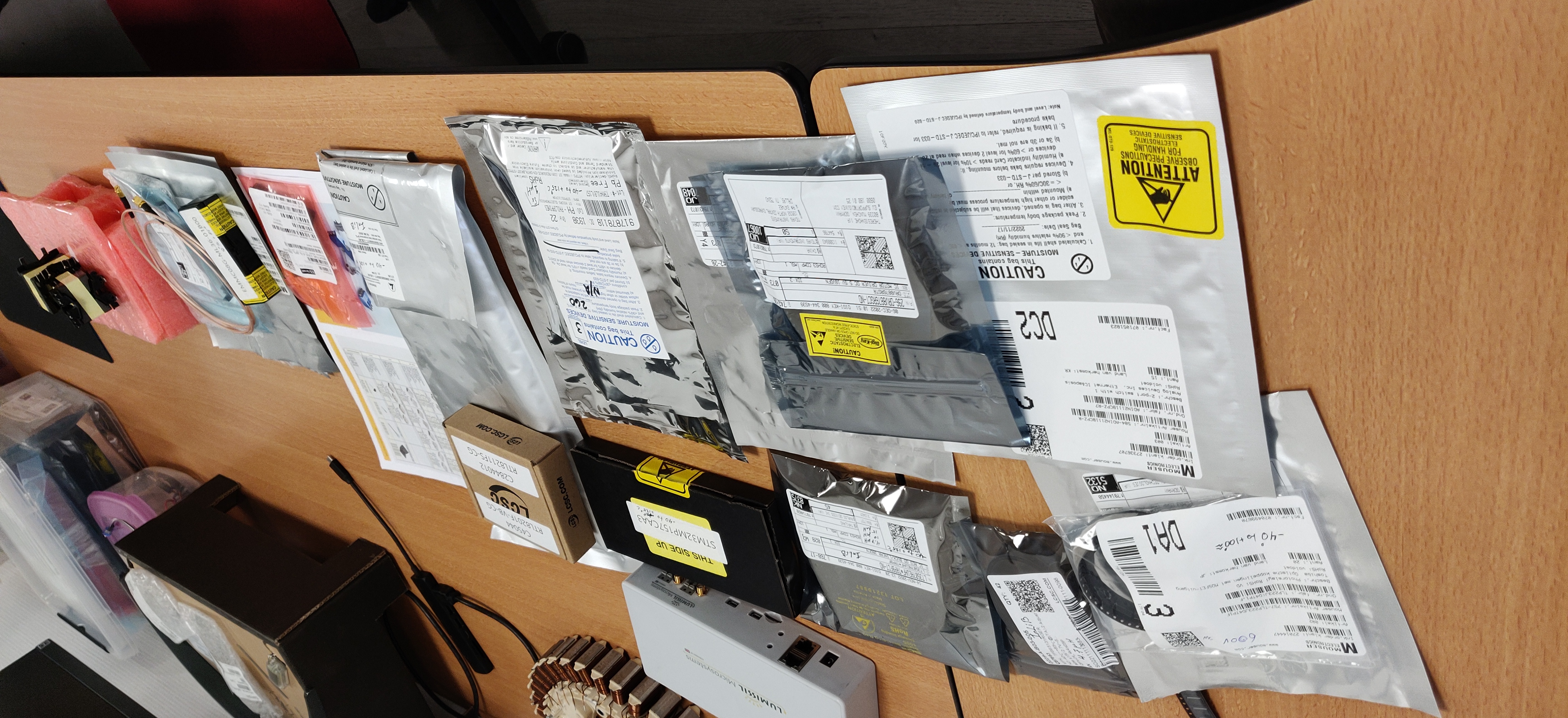

Over the past months I have been gathering IC's like a hamster contributing to the chip shortage, I gathered about 20 units worth of chips. The following items have been selected in order to cover the above desires. I only mention the noteworthy ones:
  1. one
  2. BTS710404ESAXUMA1 To drive the main contactors
  3. TLP223JD4TP1F To decouple the voltage sensing network from the HV lines when disabled
  4. TPS65131RGER To generate the symmetrical power supply for the PWM generation
  5. MT52L256M32D1PF The memory for the processor below
  6. DRV8876RGTR To drive the locking motor and door lock
  7. ADIN2111BCPZ To talk a modern single pair ethernet way with other devices
  8. LT3507AEUHF Main power supply will accept the continues input power 7 to 18V and generate 5V, 3.3V for the core components and 3.3V for interfacing items.
  9. STM32MP157CAA3 Will run linux for the ISO15118 protocol and ethernet interfacing, and the M4 core will handle the low level realtime items like the motors and LED's + CAN
  10. RTL8201F Ethernet controller
  11. STPMIC1CPQR Will provide the STM32MP1's power rail needs
  12. IS32CG5317 The main PLC Modem
What it looks like to be a hamster:

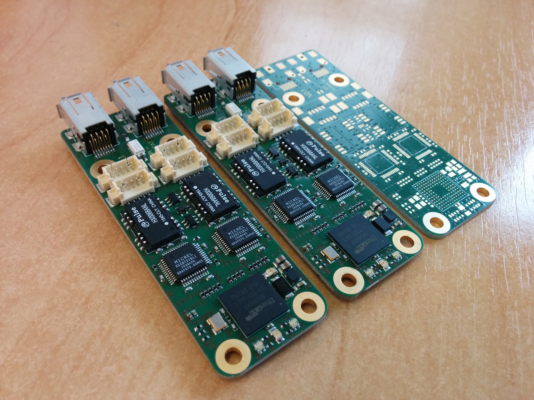

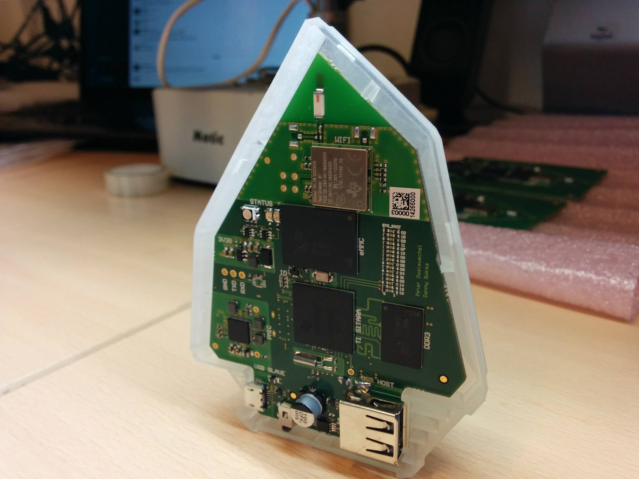

If you are patient enough and gathered enough youtube courage of manual BGA then it is possible to do BGA with paste and a paint stripper, below are a few project for which I used a temp controlled paint stripper and only tweezers to assemble xD:
Very nice! takes a fair bit of skill to achieve that. Around a decade ago I worked for a design consultancy that also had its own assembly line and also an xray system for the inspection of BGA reflow so have a reasonable understanding of how careful you need to be to get good results. I've done a fair number of commercial designs with BGAs but would never have the nerve to try and do DIY assembly on one (but then my eyesight and dexterity aren't what they once were, 0603s are about my limit for manual assembly these days!).
