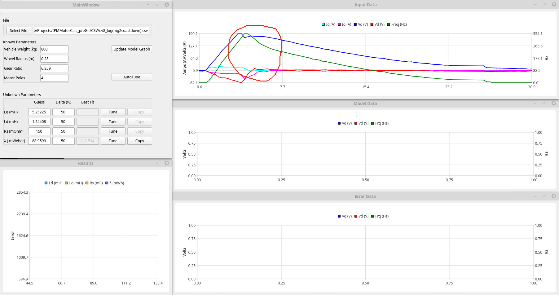

just graphed these logs, looks like synadv on mg1 is a little high, Im running the over modulated 5.25R
Pete9008
Posts: 1801
Has thanked: 102 times
Been thanked: 351 times
Re: Project RX8 , Prius gen2, Lexus transaxle to rwd
Post by Pete9008 »
On 5.25 syncadv shouldn't need adjusting, just leave it at the default (11 I think). It's now used for something different to the old syncadv and shouldn't need to change.
If ud doesn't stay at 0 then it is syncofs that's probably out and needs adjusting.
How easy is it to redo? I might be able to work back from the data you have to get to a revised syncofs value if its a pain.

Depends when it was, a while ago it would have been. I would have liked to rename it to synccomp to avoid confusion but we stuck with syncadv.
Just close to zero, say ud below at 5% of uq should be fine.
Edit - just to explain the back emf on a motor (the voltage when it is spinning but not producing torque/no currents flowing) should be pure Uq (Ud of zero). If it isn't then the controller isn't reading the motor position correctly and so there is probably an error in syncofs. It's never going to be perfect but just get close.
Syncadv is now used to compensate for the delays between measuring the motor current/position and getting the new PWM value out to the IGBTs; it is largely fixed by the firmware and so shouldn't need to change.
Pete9008
Posts: 1801
Post by Pete9008 »
Just had a look at your logs using the calculator, if you change to a comma delimiter rather than a semicolon they will load right in, you can then select the region you want to analyse and it works out the numbers for you (although only flux linkage for these logs). It gives 112,5mWb for MG2 and 64.0 for MG1.
I think the wobble on the graph you mentioned is just the control loops settling at the start of the coast down. Just ignore that bit.
Ud looks fine on those, no problem with it at all. Just need to adjust it with scynofs not syncadj :)
Edit - plot from the calculator, wobble ringed can be ignored:

Just tried calculating Lq from your log, get 1.9mH (not much data to go on though). Is that anywhere close?
If it were me I'd have the handbrake on, in high gear and foot on the clutch ready to catch any overspeed just in case!
Might still have a play with the simulator, be interesting to see if my calculated offset matches you measured!
Edit - just checked, I used 2.2mH when doing simulator runs so seems possible (BTW, Lq was for MG2)
Edit - Just tried it in the simulator and changing syncadv from 11 to 18 needed me to then adjust syncofs from 0 to 64000 to compensate. So a change of -1500. That would to suggest that to get from 18 back to 11 would need around 1500 adding to syncofs. Sounds a bit big and I doubt that you would be that far out but with the cogging of the second motor I suppose it could be possible? Interested to hear your results.
