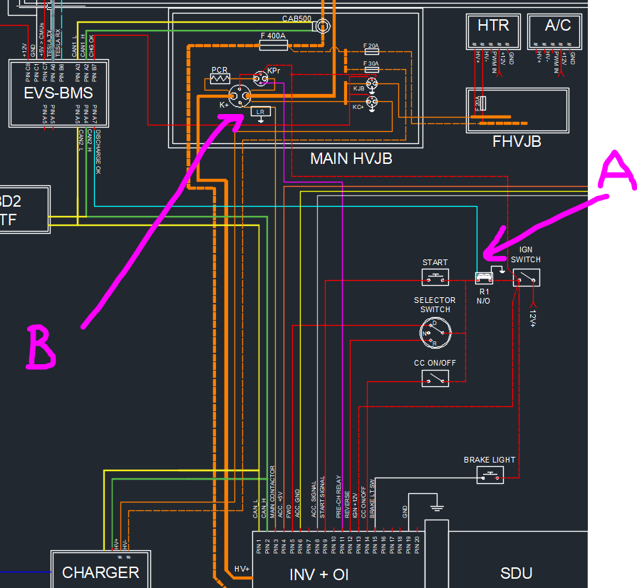

Hi All,
I have a Tesla rear SDU and OI setup where I am aiming to control the contactors via the inverter as per the OI setup wiring diagram - I'm at the point where I have the board swopped over and am rigging up my bench test arrangement. So I am wondering how others have done this setup and specifically how they have received a signal from their BMS to stop the inverter and open the main contactor? I.e. when there is an over-current, undervoltage, high temperature etc condition that the BMS detects and wants to shut down and disconnect HV to protect the battery.
Are folks doing this via CAN? Or a hard wired 12V signal for example (this would be best for me)? I'm wondering if interrupting the drive/reverse signal on pins 5 and 12 would be an option? Would be great to hear some views on how others are doing this or any links to threads on this topic.

Never NEVER allow inverter or other VCUs to DISCONNECT your DC contactors at its whim! You setup DC link in such a way that inverter can control contactors innitially, but when on they can be turned off ONLY by removing 12V from them (turn ignition key). That is called latching relay circuit.elShankos wrote: ↑Wed Jan 18, 2023 8:06 am Hi All,
I have a Tesla rear SDU and OI setup where I am aiming to control the contactors via the inverter as per the OI setup wiring diagram - I'm at the point where I have the board swopped over and am rigging up my bench test arrangement. So I am wondering how others have done this setup and specifically how they have received a signal from their BMS stop the inverter and open the main contactor? I.e. when there is an over-current, undervoltage, high temperature etc condition that the BMS detects and wants to shut down and disconnect HV to protect the battery.
You provide 12V and GND to your relay from inverter side. Then you wire its contacts so it can power itself from available 12V in case of NC contact. Then use another source of 12V (starting pulse) to supply momentary signal to turn relay ON. It will latch then and only release when you remove 12V from the first contact via key. I really need to find my drawing... .
I convinced TUV inspector in my circuit when i showed him that i can allways disconneect 12V when i turn off the ignition key. In case of inverter fault you can still mechanicaly brake the car and remove the key to sever the DC link.
Notaus button is there only to disable PWM generation inside inverter not to disconnect DC link in emergency!
I use notaus button (and BMS wired to it) to disable car while charging and if i manually trigger it. Since i use Lebowski brain i simply use Notaus to pull dsPic30 brain to GND into reset. But you can use notaus to trigger Mprot pin or BMS pin. Or if you want to be elaborate you can open both FW /REV pins which would also stop PWM generation as i recall.
Job of a fuse is to disconnect DC link in emergency. I use as much fuses as i have battery boxes. That way each box output can be interrupted in case of a short. Ie: if there would be a battery fire temperature would quickly reach 400degC and cables would melt/weld to casing causing a short. If you would then have multiple fuses throughout your pack they would burn out and protect the rest of the pack.

I beg to differ here. As i thought the same in the past ACIM motor should be nonreactive if you remove its source of excitation. I tested this in my Mazda with ACIM motor, it is solid.mjc506 wrote: ↑Wed Jan 18, 2023 10:28 am ....
Note, if you've got an induction motor, turning off the inverter (or killing it) while moving is relatively benign - magnetic field disappears, so the motor turns into a lump of spinning iron, and the driver retains control while the vehicle coasts to a halt. With a permanent magnet motor, stopping the inverter can essentially short the three motor phases resulting in very high uncontrollable regen. This could be a problem at speed... 'Safe'? (I think the SDU is induction, so not a problem in your case)
Aaand for some reason or other this is not true for Tesla LDU and SDU inverters. They will happily burn if you remove DC link. Must be that their spike margin is way lower than those bulky IGBTs other OEM use.
SO in case of LDU and SDU beware to latch your contactors!

Thanks for this - I think this is a really good idea and I recon I can do this with an available signal from the BMS. What about regen though? While slowing down to stop the car wouldn't you possibly still have regen pushing power back into the batteries before you can come to a full stop and switch off the ignition? Maybe this wouldn't really be an issue but worth asking.muehlpower wrote: ↑Wed Jan 18, 2023 10:04 am I use a PWM signal to pull the accelerator or brake pedal more or less to zero. With this I prevent over and under voltage of the battery, as well as blocking or spinning of the rear axle.

Thanks a lot for this reply arber - I will make sure to add the latching component to the the signal from the inverter to close the main +ve HV contactor - as per B in my pretty rough diagram (sorry its a bit small and still messy!) below: That's a really good point and thanks for explaining it.arber333 wrote: ↑Wed Jan 18, 2023 9:59 am Never NEVER allow inverter or other VCUs to DISCONNECT your DC contactors at its whim! You setup DC link in such a way that inverter can control contactors innitially, but when on they can be turned off ONLY by removing 12V from them (turn ignition key). That is called latching relay circuit.
At point A I was thinking to link in a relay to open when the BMS is not happy to discharge - so then if there was a problem (from BMS) while driving, it could open that relay and then drive and reverse would be lost - this wouldn't cause a problem for the inverter would it?
Can I also ask: do you use a main -ve HV contactor as well? I would like to for extra safety but I'm not sure how to implement it while controlling the contactors from the SDU inverter - so I wonder what others have done in this regard?

Hmmm... -HV contactor should be
1. Closed when precharge pin is on
2. Closed when main contactor pin is ON the same as +HV contactor.
I think you can solve this with another relay and connect it in a way -HV is on with precharge as well as main contactor.
Personaly i just use 500A fuse on -HV side. I see no benefit in another contactor.
