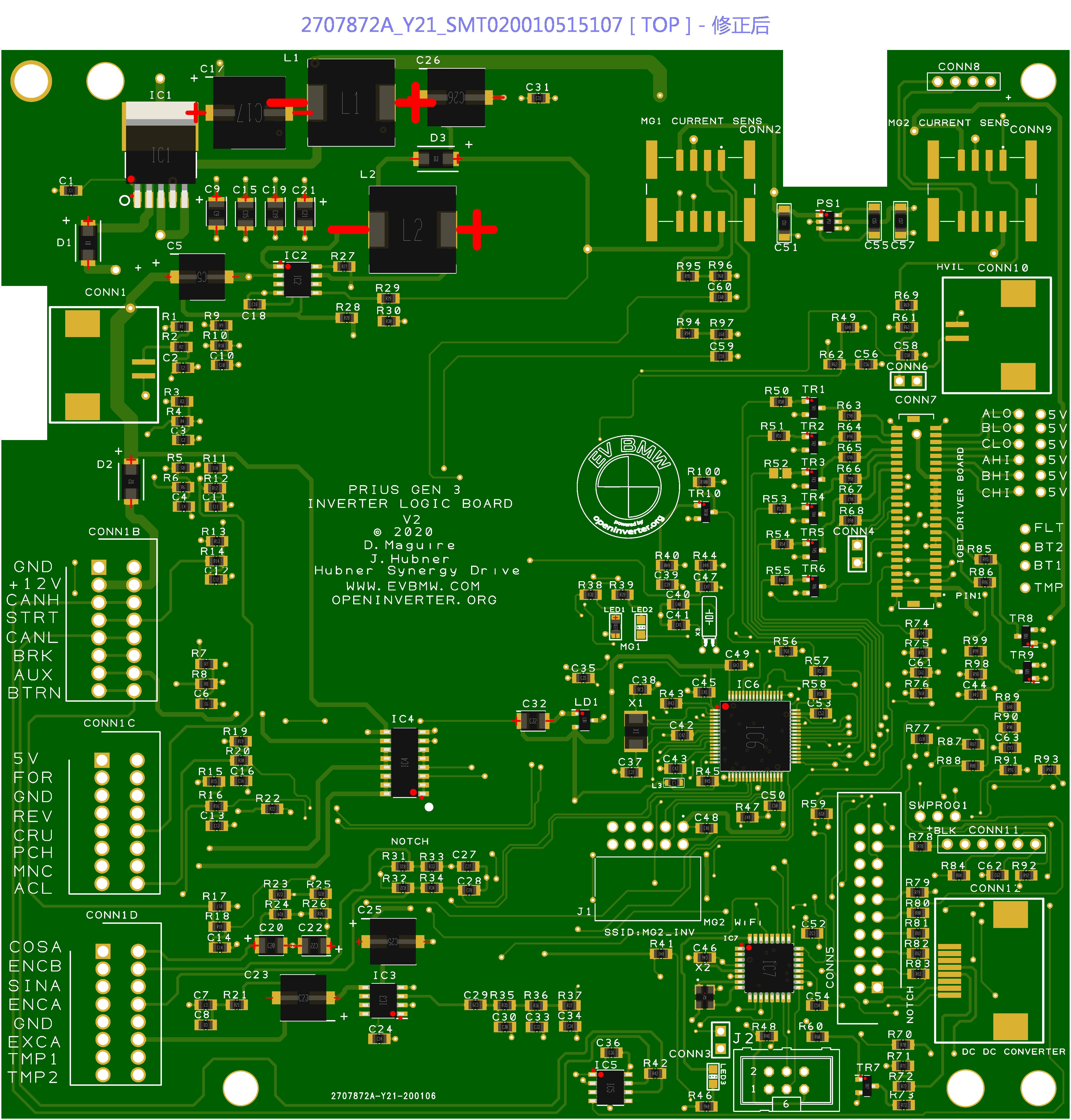

I'd like to give everyone a much overdue update on the Prius logic board situation. In short, we have a new board and new supply coming on stream. Boards will be available soon (including to those who have been waiting a long time!). The video here gives a full explanation and I expect to be using JLCPCB for all my builds if things go to plan. So, more boards, faster and cheaper:)

New Gen 3 prius board in production at JLC:)

Looks like this one has so less components - I'm using JLC for at least a year now - they've been great so far. Good choice.

Jack Bauer wrote: Mon Jan 06, 2020 3:38 pm New Gen 3 prius board in production at JLC:)
It doesn't look like matching PriusG3_V2 schematic you published earlier - no STM32 (Blue Pill) modules, and just one motor control?

PatrykS wrote: Tue Jan 07, 2020 12:32 am It doesn't look like matching PriusG3_V2 schematic you published earlier - no STM32 (Blue Pill) modules, and just one motor control?
I've watched the recent video that goes with the board release and it's an interesting combination of features that will be ideal for a lot of conversions. Which is MG2 control using a STM32 and high capacity battery charging using MG1 as a 3 phase rectifier and the buck/boost circuit for controlling charge current. Which is exactly the sort of combination I was hoping would work for my light weight project so I'm glad this has been produced.
I also don't think there's the real need for the Blue Pill modules any more now he's using cheap SMD assembly service. However I really like the idea of using the Blue Pill.
