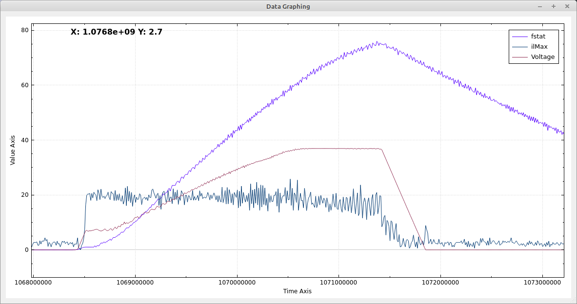

Here's a couple of graphs of the algorithm in action. The bottom graph shows acceleration. I find it very interesting how this clearly demonstrates the expected V/Hz curve with automatically determined boost. The other shows steady state.

Looking good, very interested to see how you get on with this but afraid I can't help as I know nothing about induction motors (except what I've learnt from your posts :) )

Here's another example of what this code does. This is ilmax following potnom. Throtcur is set to 1A per 1%.
I think I'm now at the stage where I'm ready to test this with a bigger motor.
Latest code, fully annotated: https://github.com/catphish/stm32-sine/ ... d93364c11b
As the graphs show, regen current seems to overshoot its target a bit. I suspect this is because the rotor speed is dropping so quickly. Hopefully in a real vehicle and with careful tuning of the loop, this effect won't be too noticeable.

Couple of questions - Is the motor changing direction in that second plot but not in the first plot? Also is there a max current limit set that stops it following the higher potnom values?

In these plots, the motor is always spinning in the same direction. When potnom is less than zero it is doing regen. Currently it has no concept of "negative" current, so it just matches positive current with (negative) requested regen.
The reason the current sometimes couldn't reach the target is because the motor was spinning too fast and the voltage was already maxed out. Later, I will add code to increase slip above its normal target once there's no more voltage to give. (ie field weakening).
Right now with no load on the motor it can do 0 to 100% speed and back to 0 in a fraction of a second if I request full torque.

Edit - ignore me, the rotor is stationary, think I'll stick to PM motors and leave you to the inductions ones - they're too difficult!
catphish
Posts: 965
Location: Dorset, UK
Has thanked: 99 times
Been thanked: 195 times
Re: Current control of induction motors
Post by catphish »
Pete9008 wrote: Thu Jan 19, 2023 10:37 pm I'd guess it's remenant magnetic flux in the rotor causing a back emf, if so not sure there is a lot you can do about it other than wait for it to subside?
The rotor is actually spinning. But because the slip is zero, current is zero.
I just realised, the fact that voltage gradually falls to zero like this is probably not random or accidental, this is probably a correct reaction to the decaying rotor field and we're matching voltage to back EMF to keep the current zero.
Pete9008
Posts: 1801
Has thanked: 102 times
Been thanked: 350 times
Post by Pete9008 »
Which bit of the plot are you referring to? I was looking at the last bit of the second plot where speed was 0 but the amp trace was still high and dropping.
If the rotor is still spinning then remenant flux will cause a back emf.
catphish
Posts: 965
Post by catphish »
Pete9008 wrote: Thu Jan 19, 2023 10:57 pm Which bit of the plot are you referring to? I was looking at the last bit of the second plot where speed was 0 but the amp trace was still high and dropping.
Sorry, I think this is just my poor choice of chart colours. In this chart, the visible line that goes to zero is IVT current. Speed is off the top somewhere.
