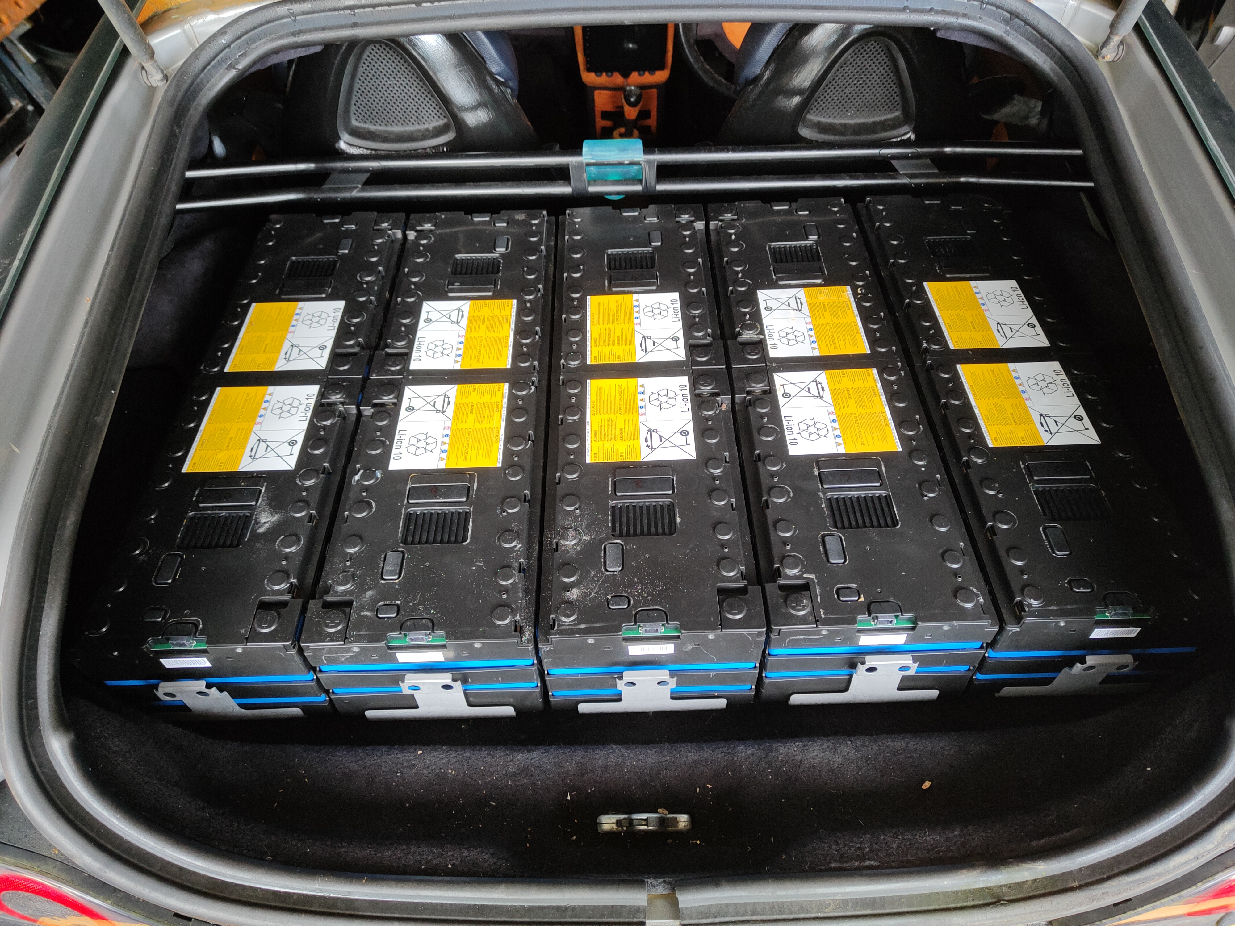

Well, I stripped down the Outlander battery had a think where I could put it. Seems that my little Smart Roadster has the perfect place for it!

I will need to get creative with the end connections. I have some spare busbars from a second pack that may help me. On the right hand end I will try and put the 350A fuse and service plug. The left hand end I will need to mount the main contactor and power cables.
I am reusing some of the old busbars to create the short jumpers between modules as I have reduced the gaps to allow it to fit snugly.
The weight may be a little high up and mess with the handling, but I am not overly concerned about this
There is also space under the bonnet where I reckon I can get another entire pack with some creative thinking.

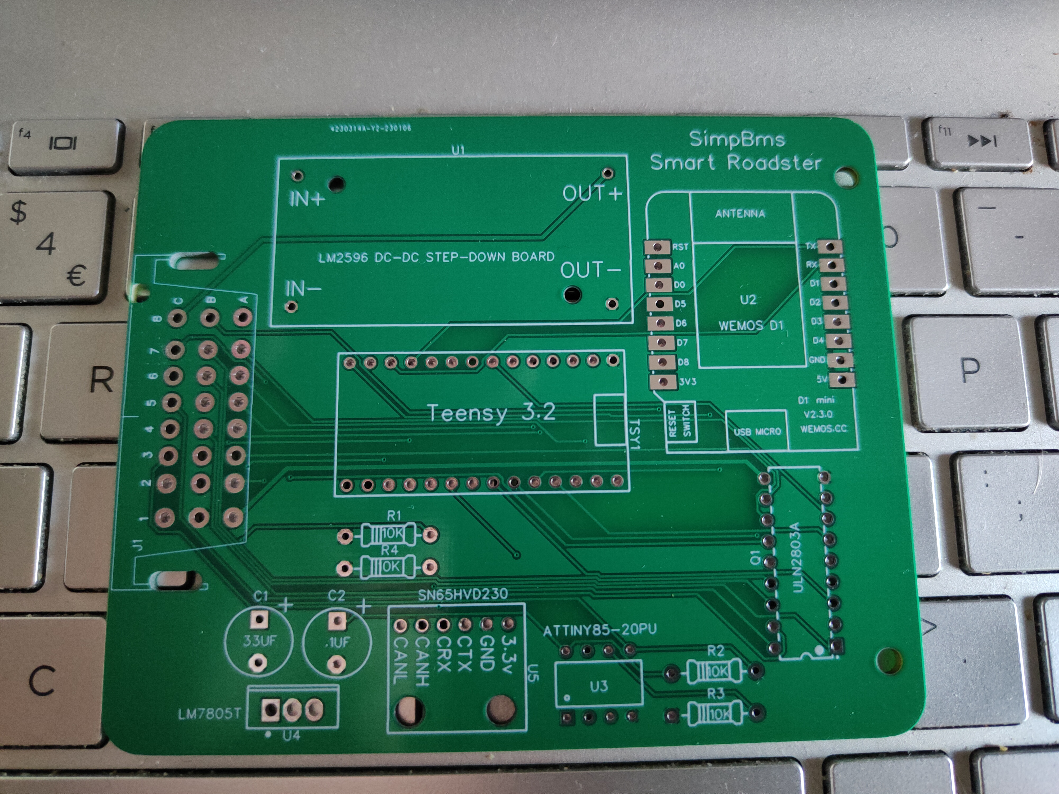

Also spent some time at the weekend fault finding the VCU that I previously had working. The mini360 converter seems to have an issue that wasn't resolved when replacing it. Killed the optos and darlington arrays. Most annoying!!

Ouch, at least those are low cost and easy to replace!
Those mini 360 seem to have very variable quality, you get good ones and bad.
I set mine up on the bench with a small load, and soak test for a bit.

Yeah, I replaced it twice and showed the same problem. Dropped to 2.5V at the input and no output. Connected one directly to a 12v supply and in to the output and it worked fine. Put it on the board and no joy. It made very little sense to me as the input connects to the same 12v supply I was using directly. Need to check the board and the wires. Or just bypass it with direct 5v to the Teensy
Pretty sure I will figure it out.

Back in business, dodgy ground, but now we are all good. Just waiting on a replacement opto

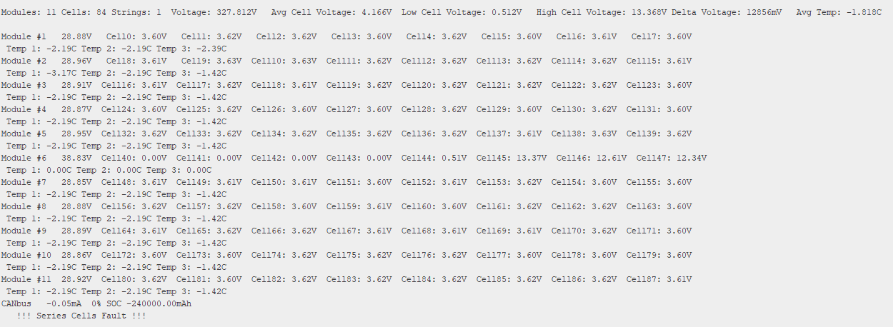

Well it only bloomin' works - sort of!
For some reason I have 11 modules registering, I am assuming that this is because I have left the connection to the termination resistor in CMU7. Should I remove it?
This is what I get in the debug.....and YES it is still that cold in the garage!

Do you have anything else on the can bus, I know for instance the ground fault detector will show up as a cell. ?

The current sensor is plugged in......I stripped everything else out
bigdaveakers
- Posts: 51
- Joined: Fri Mar 04, 2022 11:46 am
- Has thanked: 5 times
- Been thanked: 5 times
OK,so I removed the current sensor......no change. I snipped the wires for the termination resistor......no change.
Then I disconnected the dcdc converter......
Down to 10 cells and a Ready status
However getting a !!! Series Cells Fault !!! which I will need to dig in to the code for.

Last one for the night, promise!
Poking in the code it seems like the settings are for 12 cells in series
Via the menu I changed this to 80 and the !!! Series Cells Fault !!! has gone away!
Now, just need to figure out what is the deal with the phantom 11th module when the DCDC is plugged in to the CAN bus
settings.Scells = 12; //Cells in seriesNow, just need to figure out what is the deal with the phantom 11th module when the DCDC is plugged in to the CAN bus
