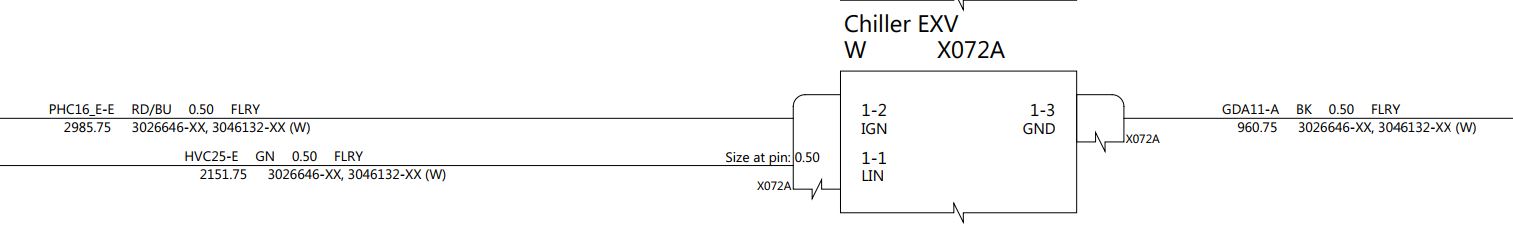

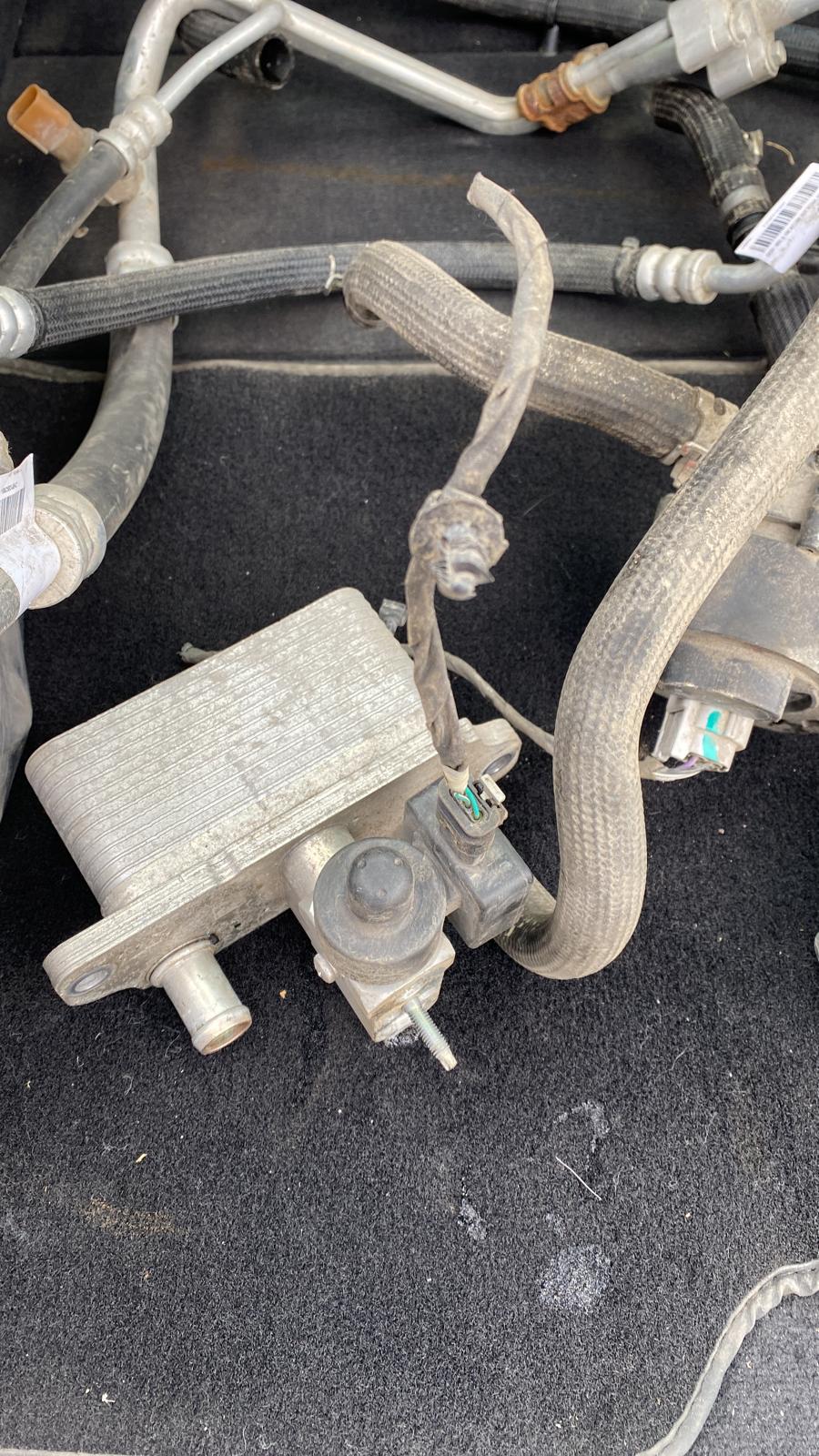

Anyone tried to control this one?
It has 3 pins.
It's either LIN or PWM
It has 3 pins.

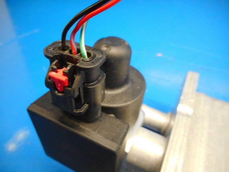

Ok the valve has a LIN connection and a +12vdc and GND.

Ok its slow but got LIM comms with THC, but sadly it doesn't address this valve...so either its PWM or the THC thinks it doesn't need to address a EXV valve.

Just seen this thread, your valve looks very similar to one of the ones I have, pretty sure it's from the same manufacturer. Do you know the pinout on yours?
If it is a Sanhua valve they mention both LIN and PWM versions on their website so it could be either but I'm guessing the hardware (and so pinout) would be the same and it's just the firmware that changes.

Yes; the Tesla pin-out is known. And it should be a LIN.

Quick update - the Tesla valve and the Jaguar valves are different. Overall they are very similar but on mine the connector is on the opposite side of the square section of the housing, The pinout is also different. Still think they are the same manufacturer but they obviously customised for Tesla or Jaguar.
In case it's of use mine is now sending out data with Gnd on pin3, LIN on pin2 and 12v on pin1 (which is different to the above Tesla one). It responds to LIN address 0x35 at 9800baud with 8bytes of data (c3,00,00,00,ff,ff,ff,ff - guessing ff's are padding and the first 4 bytes are status and position?). Still need to find the command addresses.
I'll post any further data in my other thread.

Mine definitely sends 8 bytes out on 0x35 when requested followed by a checksum which matches the extended calculation. Little more information on the bytes:
Byte 0 - Bit0 seems to be an error flag, set if valve has received an invalid message
Byte 0 - Bit4 another flag, seems to get set if I interrupt the power up motor sequence
Byte 0 - Bits7&8, always set
Byte 1 - Always zero, wondering if this is the valve position readback
Byte 2 & 3 - seem to be a countdown during the motor initialisation sequence, counts down from around 0x200 at start to 0 at end of sequence.
Fairly sure the command register is 0x34 as it is the only address that causes the invalid message flag to set if the CSUM is invalid. The only message length that it is happy with is 8 - so an 8byte command on 0x34. Not good - I was hoping for a smaller command.
This is where I'm a bit stuck, the obvious simple patterns I've tried seem to have no effect. This suggests that it needs the correct combination of byte values, with 8bytes that's an awful lot of combinations to try even if I automate it. Next test is probably to try all combinations of the first two bytes with the rest set to 0xff but if that doesn't work it's going to need either some inspiration or a LIN bus scan from a working car!
