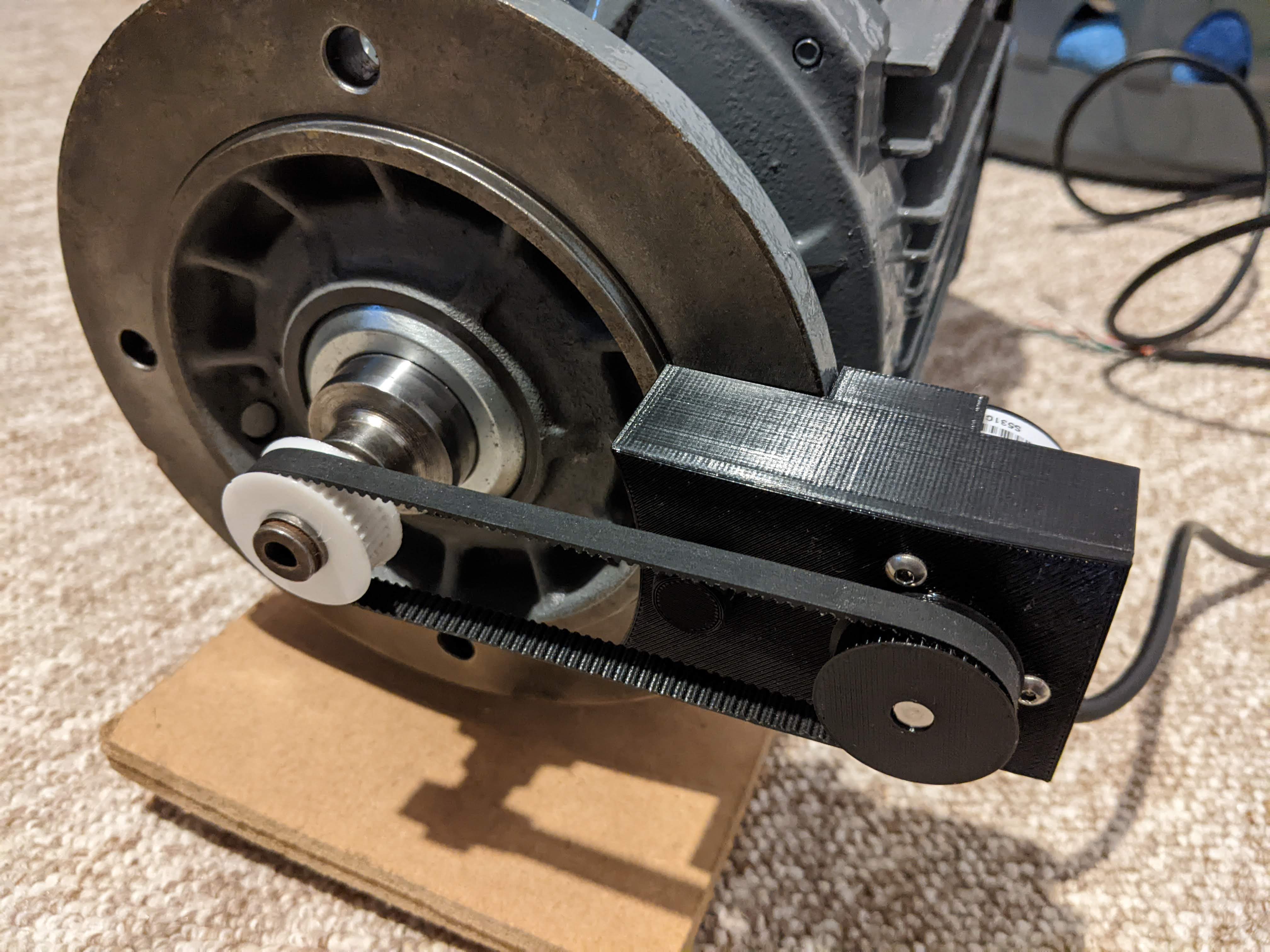

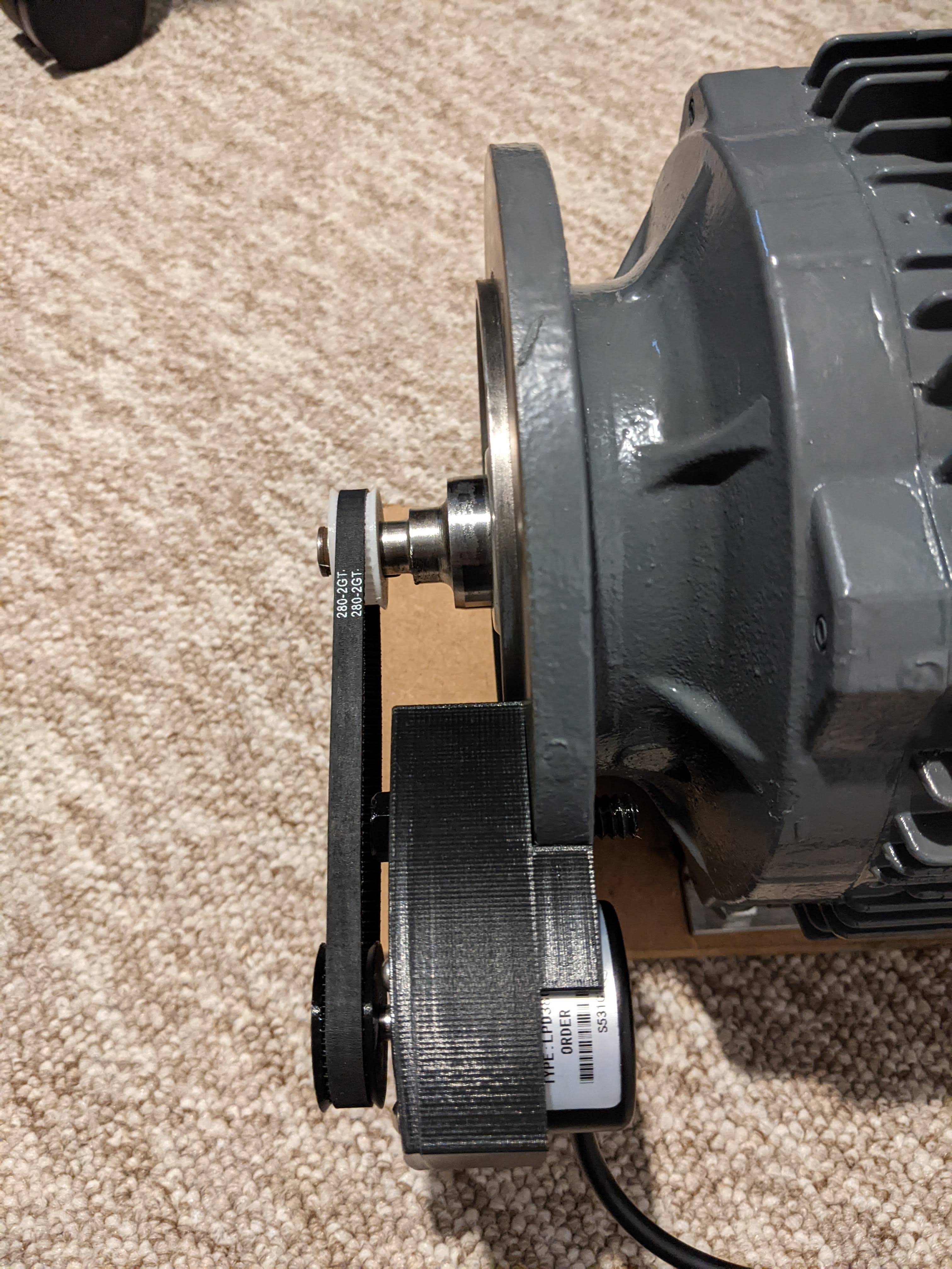

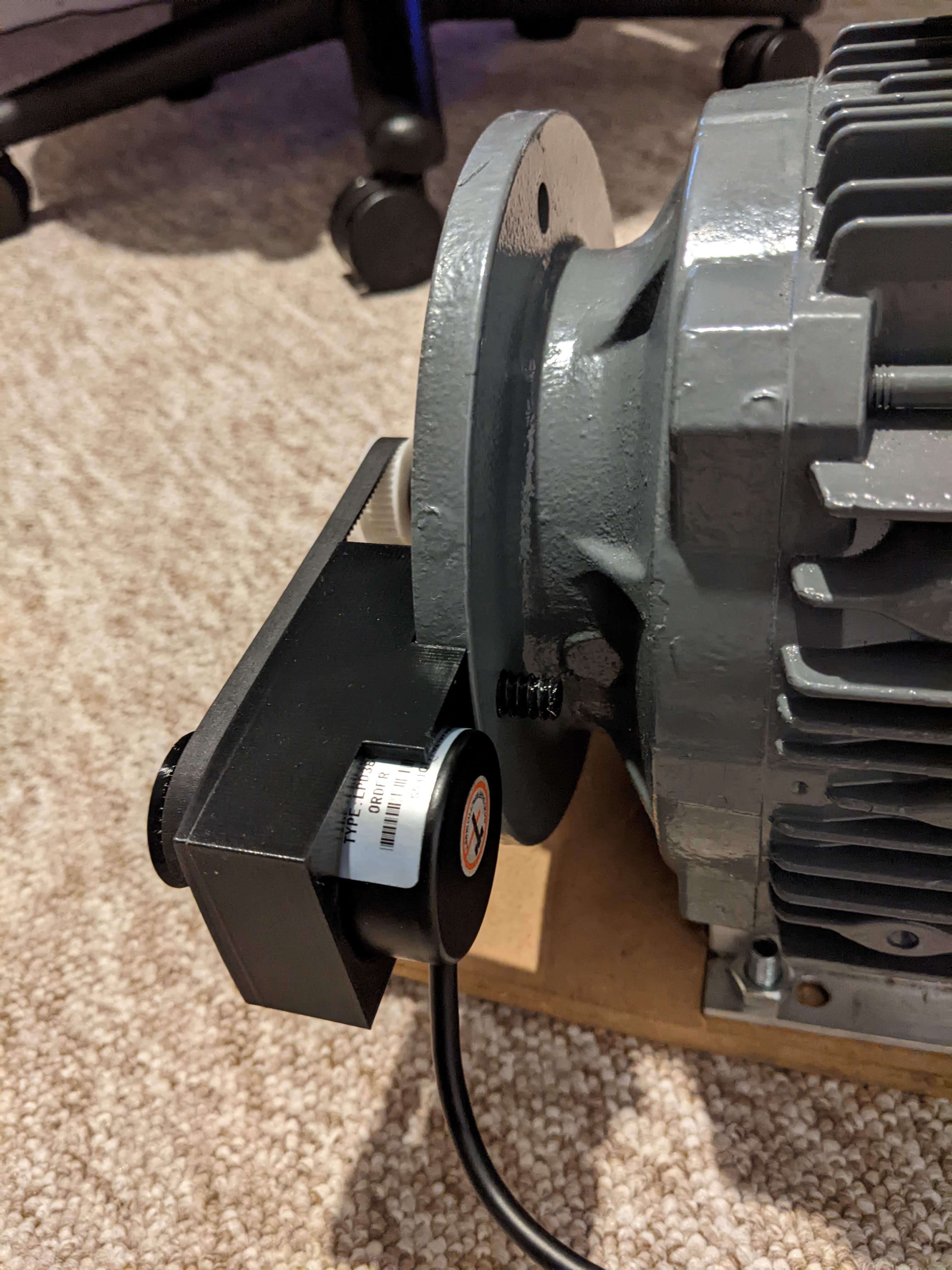

I decided not to worry about the flywheel for now. I've rigged up my encoder to the motor using 3D printed brackets and pulleys.

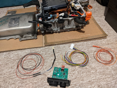

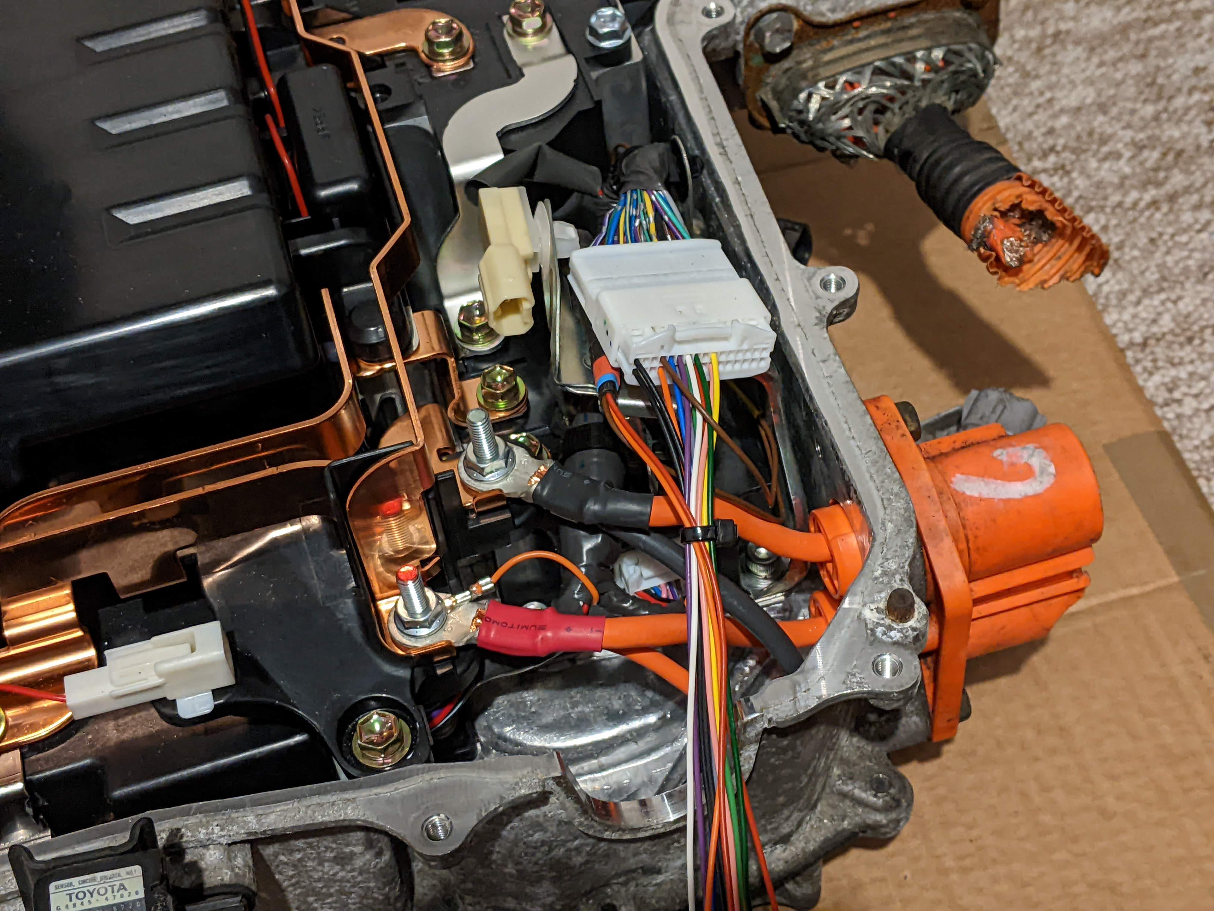

I've also now got the remaining connectors needed to hook up the Prius inverter control board, so hopefully I can get it up and running soon.
I'm rather unsure how to use the boost converter so I've made a separate thread to ask about that.

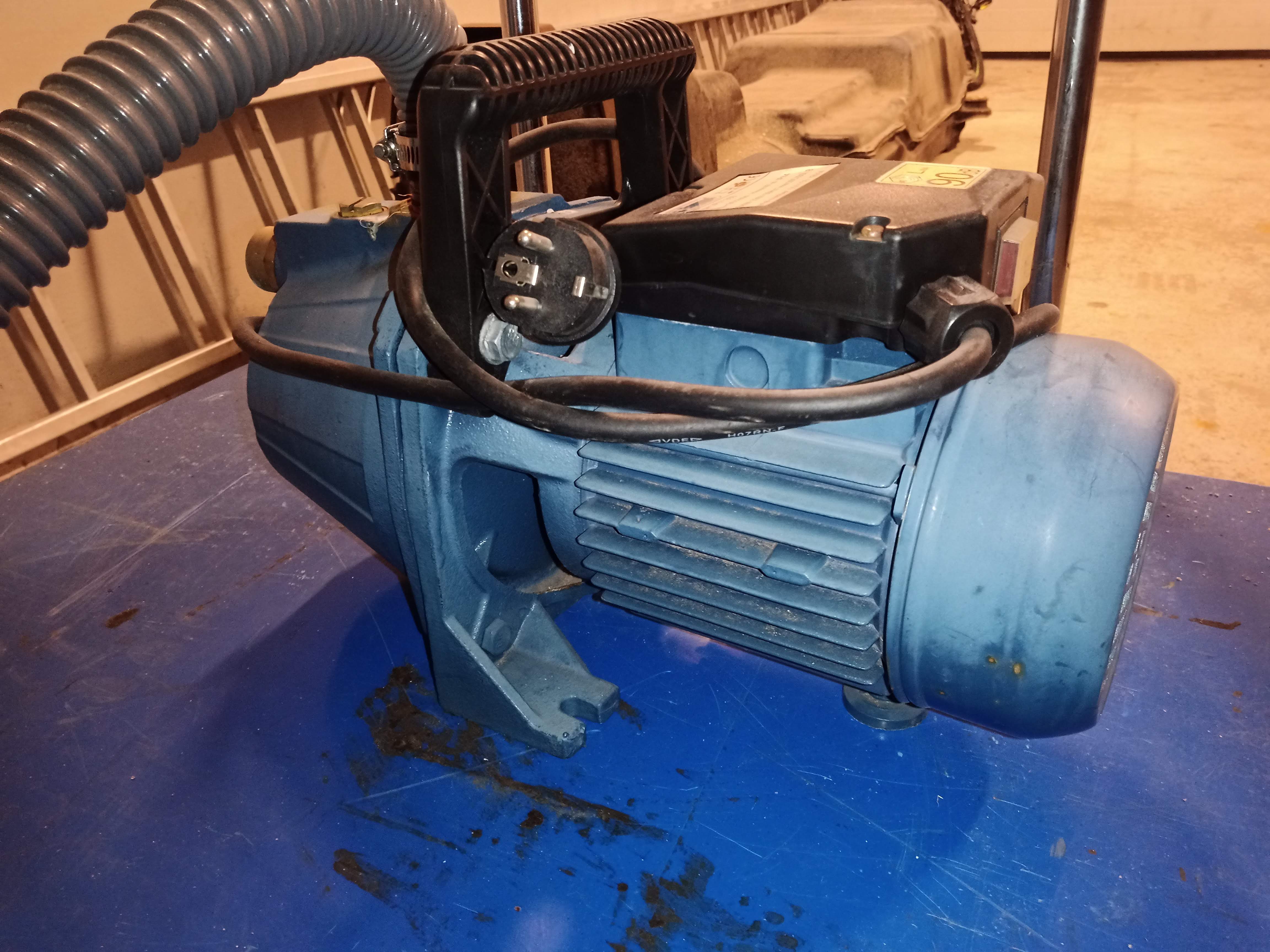

A little late in the process, but I have used a water pump in a similar setup.
Then you can choose the load by changing the hight of water outlet.
Works great, can run forever and never heats up.
Maybe a little difficult to calculate output power (efficiency) but should be possible if you know liter/min and hight.

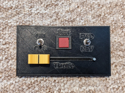

I've got myself some switches and buttons to make up a dashboard (ON/OFF, START, FWD/REV), and am now getting to work on the wiring.
It's disappointing that there are no outputs on the VCU for CSDN and MSDN, and also that the output for CPWM is a low side switch, despite the the fact that this line is active high. Therefore, after a lot of thought about this, I think the most sensible approach will be the following:
  • Attach MSDN and CSDN to toggle switches to allow them to be switched on and off. In theory they can be on all the time, but it makes sense to have the option to shut them down manually.
  • Pull, CPWM low so that it is inactive by default, and add a PNP transistor between the VCU and CPWM so that its low side switch can pull CPWM high on demand.

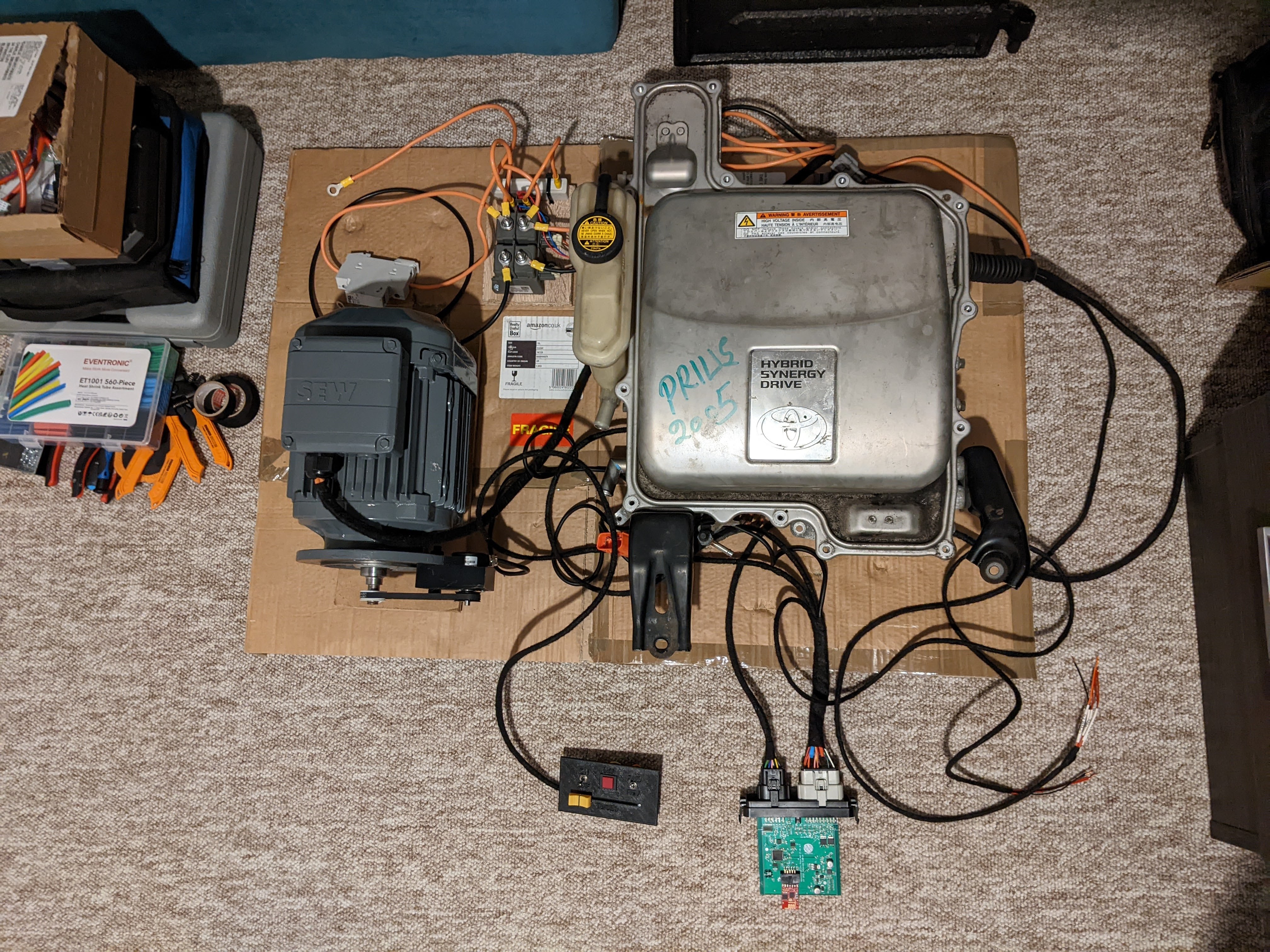

Bench setup is now complete and running. So far I've only done very low power testing using my bench power supply but everything is working as it should. The boost converter in the Prius inverter seems very capable so I'm hopeful that a single 60V battery module will b sufficient. Photos attached of full setup.

I've now got underway testing some code changes. I will discuss those in separate threads. After using the setup for a while this evening, it's clear that I need to make two additions:
  • SWD programmer, the ESP8266 serial update process is too unreliable to continual updates and testing.
  • CAN interface, because the ESP8266 graphing process isn't nearly as nice as Savvycan.
The lack of load on the motor shaft is a little disappointing, but not critical. Ultimately I can always test that code is safe on the bench setup, and then test more thoroughly in my car.

If you dont mind... i suggest you take the fan off the rear of the motor and put encoder there.
Then you can think of connecting any load you want since you wont be hampered by the pulley from a sensor in front.
Or you could just 3d print a wheel and use 1ch optical encoder :) works great for ACIM. https://mazdamx3ev.wordpress.com/2015/0 ... er-senzor/
