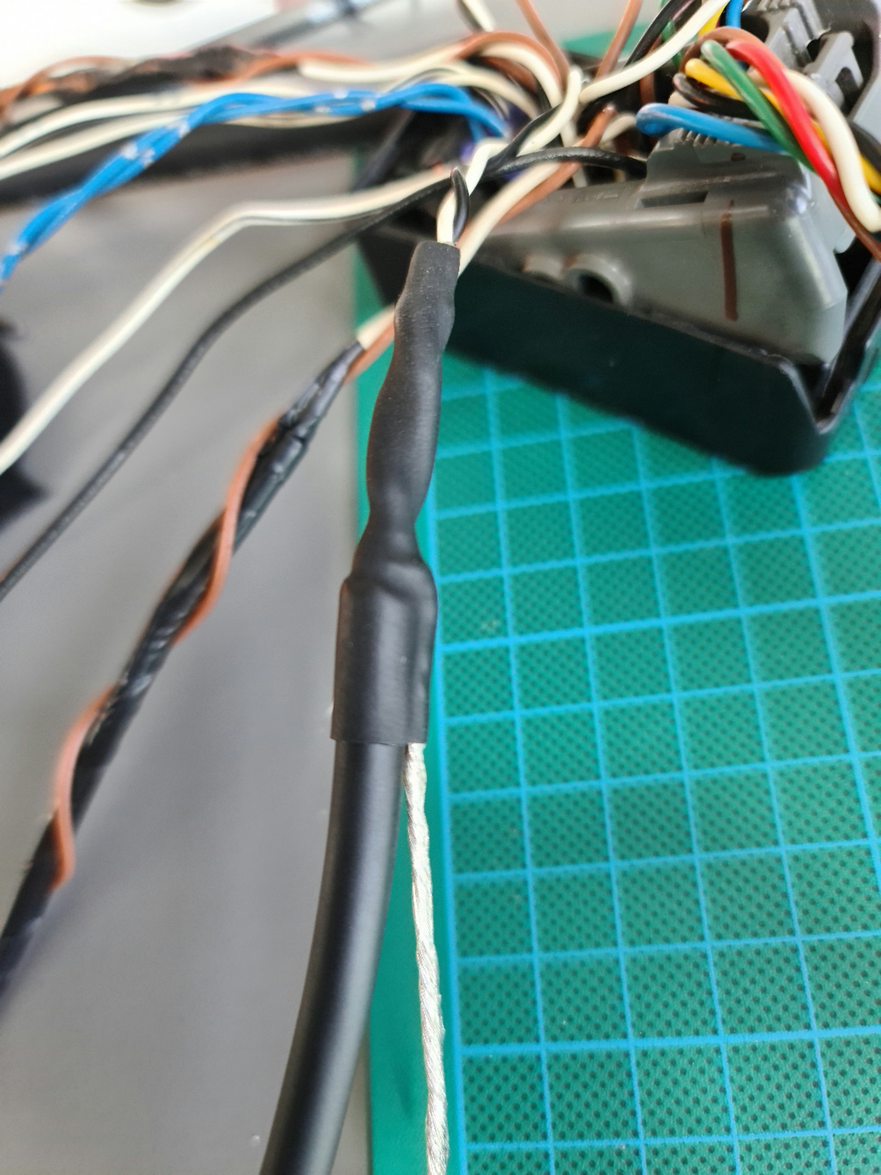

My journey into gs450h harness building has begun. It's maybe out there to find (I've tried, read a lot of threads) and perhaps I've even read it already but not realised? but here goes, I'll try as I go (as I build my harness) to show the lay out and methods (open to criticism for the sake of improvements of course).
I've decided to start with the Synchronous serial communication cables first due to the importance I believe they have, plus the fact that my gs450h inverter plug only came with about 125mm (5") of "pigtail" length.
After stripping away the original layers of insulation and wire jackets it looked like the best "easily available" high quality replica cable would be "oxygen free balanced, braided shielded microphone cable" (twisted pair inside braided sheath with cotton filler strands and strong outer jacket).. it's also quite reasonably priced because it's available almost everywhere for stage microphone cable.
I used internal glued heat shrink on all joints and tripled this for rigidity at the point of where I have the (not ideal) soldered connection between original wire and new extensions. Crimp connections would be ideal but it's my one bad habit. (As if I only have one) ...
I haven't yet extended the brown (I think "drain") wires but my intention so far is that I'll extended them at least half way along each of the four respective synchronous lines before looping back towards the invert plug end again and then linking into the exposed braided section I've left exposed. I guess this is how it would have been from Toyota? But I don't know for sure as so far I can't find an image of a full "uncut" harness that's been unwound and layed out in an easily identifiable way.. if anyone has any personal experience on this I'd love you to join in the thread.
I'll add more information as I go, I'll externally braid all my cables with "Clean cut" (nylon automotive braided sheathing) once I get closer to final cut lengths and am almost ready to pin to the Zombie verter connector.
Hopefully my ocd approach will assist others that want to build the harness from scratch (from scraps) too.

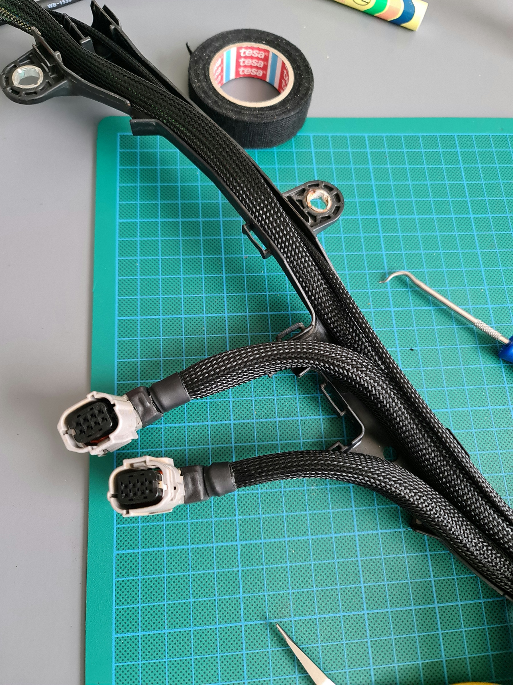

Adding to the overkill theme, plus I really really dislike the plastic convoluted tubing on wire harnesses (unless it's vital for absolute safety reasons).

Part of "measuring twice" is to also test fit prior to locking all the cables into the original plastic cable router/holder. Then once all positions are tightened up (zip ties at resolver outlets) and a bit of masking tape to hold placement of speed sensor and valve body harnesses at correct distance/stick out. Then it's back to the bench to finish off that section. Add second layers of braid where required and add some heat shrink at the emerging end that routes two larger batches of wire bundles too the inverter and respectively the VCU "position holder" (as I don't yet have my zombie)....

Ok so I've finally added the mysterious drain wire loops that travel half way up each synchronous serial cable and then back again towards the inverter plug end where they then hook into the shield braiding within the cables. Again I'm almost sure this is unnecessary however I "think" it's how Toyota did it? (Looking forward to hearing back regarding this from those lucky enough to get a factory "uncut" harness). Will be doing the same "drain loops" for each of the resolver cables too... didn't have any suitable length brown wires so pink was it seeing as how there's no other pink wires in the gs450h inverter/transmission plugs. Time to add the braided protection layers.

Re: Zombie-GS450h Synchronous Serial & harness overkill?
Braided sheath fitted to each synchronous serial line.

Ah, sorry I only just saw this thread. Part of my job is the specification of systems and cables in applications such as this, I can add a bit of feedback.
The drain wire connections don't need to be half/full length, they should be kept short. For differential pairs they are terminated at one end only. Toyota sends the brown wire down the loom and then does a 180 with it before crimping onto the cable shield (braid), so that the braid only has to fold once and so the crimp is kept straight.
For resolvers use shielded 3x twisted pair. For the USART a single shielded twisted pair per signal pair.
I'd be looking at something like a cable designed for RS485 for the USART. For the resolver, there are dedicated encoder/resolver cables available.
Keep your unshielded conductors short, heatshrink over when breaking out of shielding (adhesive lined heatshrink since we're outside!), and heatshrink over the braid/wire crimp connection first.
For my project, I used some shielded twisted pair wiring from a Jaguar, this was just two wires twisted into a pair, with a drain wire, wrapped in foil tape. No outer insulator. Crude but effective for applications such as this. I liked how compact the arrangement was.
Please never solder automotive wiring.
