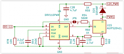

I myself have a little smaller project in the pieline, as I want to use the original tesla m3 hv contactor.
I have ordered some stuff from TI.com so I can put together an economizer circuit for the coil. Should be based on a DRV110, I hope I manage to put together something usable. https://www.ti.com/product/DRV110https://www.ti.com/tool/DRV110EVM

fredd90 wrote: Fri Mar 26, 2021 1:04 am ...Should be based on a DRV110, I hope I manage to put together something usable. https://www.ti.com/product/DRV110https://www.ti.com/tool/DRV110EVM
Went the same route. My pittfalls seemed to be:
- When using a low-side protected-mosfet, find one that is capable of doing 20KHz (most are not).
- My contactors seem to have a small capacitor across the coil. This disturbs the current measurement of the DRV110 (immediately limits at the initial pulse) and thus the current regulation. That's the reason behind the RC-network parallel to the sense-resistor.
- Don't forget the pull-down at the enable-input when driving from a CPU. The DRV110 has an internal pull-up, so when the CPU-output floats (at boot) is will activate all contactors :twisted: .
- Really test with the contactors wou want to use, measure current feedback with an oscilloscope and adjust the RC-network to avoid hissing sounds from the contactor and a stable pulsewidth.
JLC doesn't stock the DRV110, so I manually add them only to the outputs that I use for contactors. Solderjumper is to use the FET as a normal output when the DRV110 is not present.

FJ3422 wrote: Sun Apr 04, 2021 7:26 am
How I ended:
Interesting, I have already had time to sketch a bit on components and it is as you say, difficult to find fast switching n-channel mosfet.
Good idea regarding pulldown resistor, easy to forget ;)
My plan is to buy a loose hv-contactor and experiment with it, it draws about 8-9A in startcurrent so the mosfet needs to be quite solid.
I have found this one on Elfa: https://www.elfa.se/en/automotive-mosfe ... opup=false
Continuous drain 20A @ 40v. and 20-25ns at full amp
I bought the drv110 experiment board to make things easy but the included mosfet maxed out at 1A unfortunately, just wait for the new mosfet.
I have no idea if my contactors are equipped with a condensator, hope not ;)

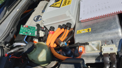

PCS controllers have arrived and almost at a full power test:)

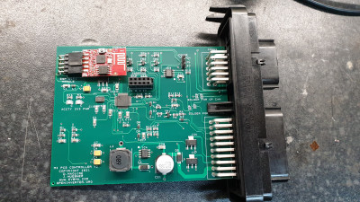

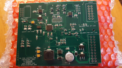

Got some time this morning to build up a controller and start testing. DCDC side works but no output from charger. traced to a simple software issue (incorrect boolean) so once Johannes fixes that we should be charging:) Assuming all goes well boards and kits will then be in the webshop.

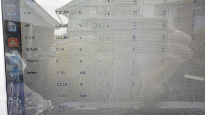

...and we are charging:)
