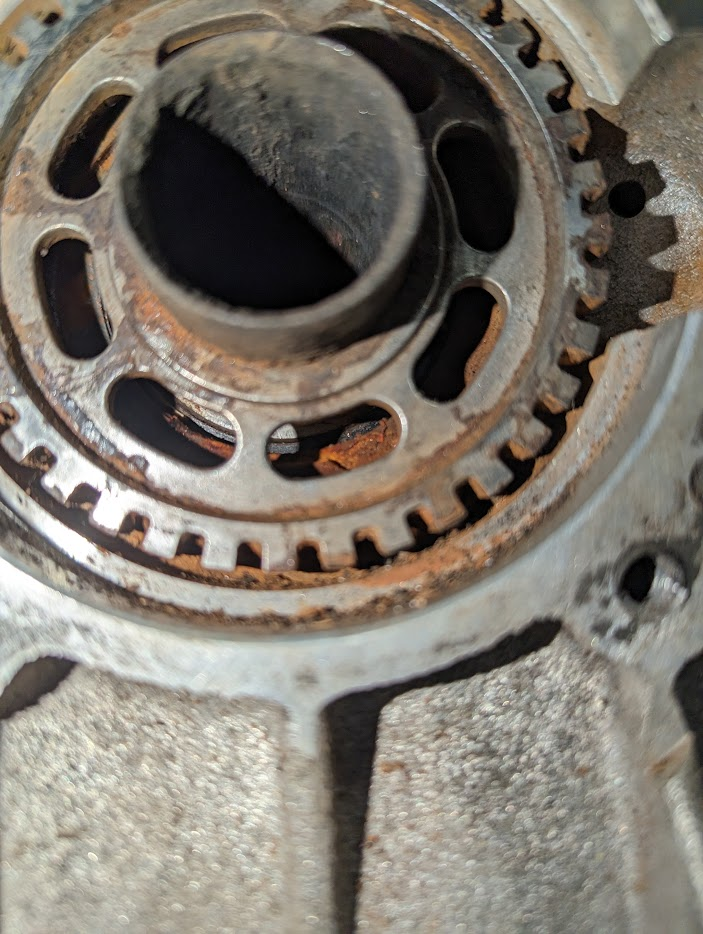

Shaft Surface Damage
Been thinking about shaft damage source and repair. Here are some thoughts. Note it is mostly just guesses, no way to confirm without lab level material analysis
Corrosion Damage
EV builders that source salvaged LDUs which has been sitting around awhile shows high rust/oxidization damage. Here is @Boxster EV's original pic
viewtopic.php?p=36449#p36449
Here is a pic of another Porsche EV builder recently reached out to me for LDU seal repair. This LDU sat idle (drained with whatever coolant trapped inside and no drain path in reluctor chamber) for 2.5 years. Installed and pumped with coolant 1 year ago. Manifold just pulled and reveal this pic
This info + what we have heard on shaft metal material suggest it is not stainless. Johan did some guesses and I revised my post on shaft hardness to reflect this thinking it is maybe hardended 1045 steel.
viewtopic.php?p=49511#p49511
Note the seal is a triple lip seal. LDU was a T13 (originally 2013 made) Rev Q Reman
Seal/Debris? Damage
Scientifically, we've been very focused on PTFE lip material hardness in relation to shaft hardness. But the close up on wear pattern may suggest differently...
Here are some close up on my shaft surface before and after 600->1500 grit prep
Here is @Wim_V's shaft with triple lip seal. We can see the accumulated debris on the rotor facing side of the lips
viewtopic.php?p=46359#p46359
Similar rotor facing side lip surface debris is present on my single lipped seal
viewtopic.php?p=46858#p46858
Given the location of the wear on mine and WimV's shaft, it seems to suggest the shaft scoring might be on the dry side of the lips by debris rather than the PTFE lips? If so, perhaps triple lip with its trapped region between the lips could retain debris including any dislodge lip material and cause scoring? AND maybe this is why Tesla rebuilds shifted to single lip?
Debris is probably left over solids after vaporizing the leaks water content?
What happens to the vaporized water from the leak?
Assuming PTFE lip are hot from friction. Wonder what happens to the water content from minute leaks on the dry side? Would they steam/vaporize and expand? Where does the expansion go inside the triple lip seal? Cavitate back towards media btw the 2 media facing lips chamber and exit the excluder in that chamber?
These are all guesses of course, but putting it out here for all to consider since we have so little data and no lab material study results.

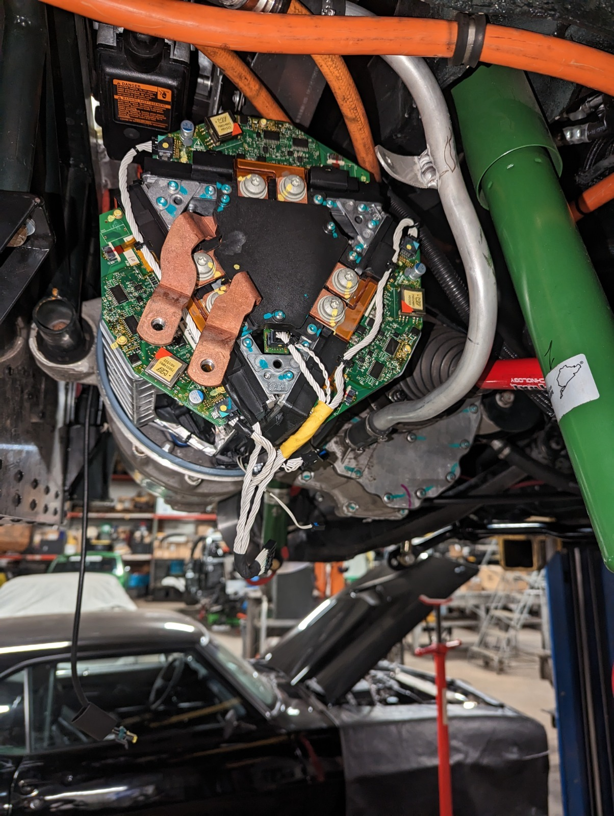

I wanted to share my coolant leak experience, since it is now "patched up" thanks to the help and resources of Howard. I believe he shared some photos already, but I obtained my LDU back in 2018 and it sat for a little more than a couple of years before coolant was added to the system and then maybe close to another year before the coolant was running through the system with pumps on a regular basis with testing. I got about 90 miles of driving before the erratic behavior began. I posted about that on here before I knew the issue. It started with losing power on braking and having to be towed home in shame
. . . and then the overcurrent issues that I thought was in the programming . . . and finally the pot settings went awry and the temp was reading -1230 c, which is below absolute zero!!!!
I was assuming the card was bad and when we opened up the inverter to replace the card, we saw the coolant invasion.
This meant we needed to check the other side of the motor and sure enough . . .
After cleaning off the rust, it was clear the shaft was pitted, which was not unexpected by Howard.
CONTINUED IN NEXT POST

CONTINUED . . . .
Howard explained all of the options and since my car was in a shop with lots of cool tools and my partner on this build has a lot of experience in metal work and welding, we went for the option to undercut the shaft and then add a new outer sleeve of stainless steel at the same length as the shaft to accommodate the seal.
We closed up the breather hold and drilled out the new emergency drain and set the new seal (courtesy of Howard's stock) and re-installed everything.
We also added drain holes on the Inverter side.

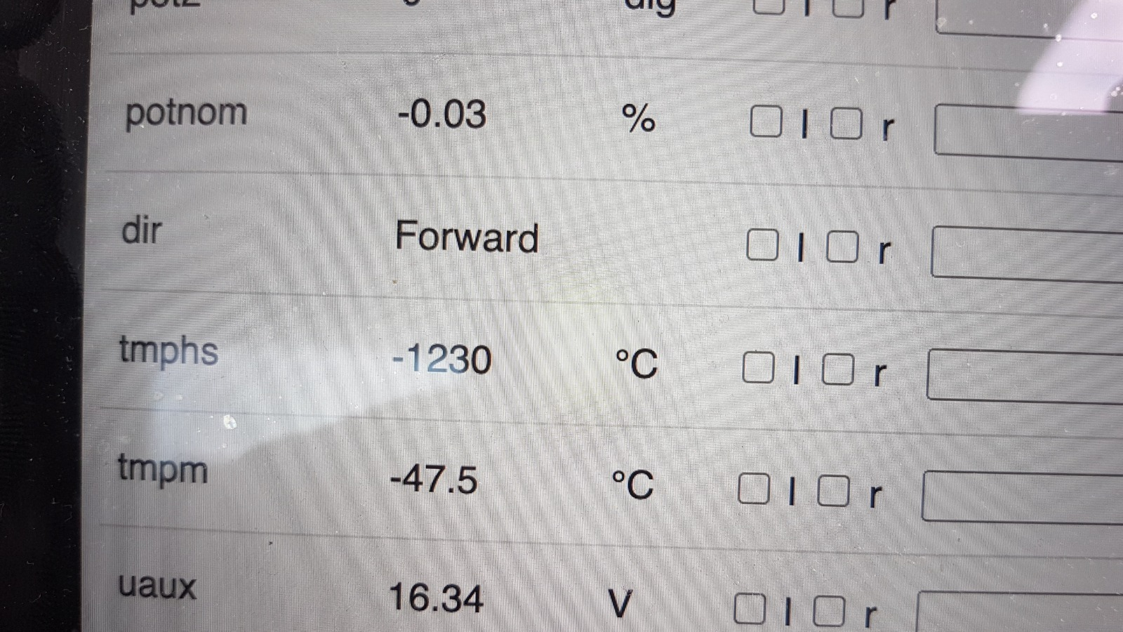

I am reusing the DU card that was in there during the coolant leak, along with same harness (thorough cleaned) for now and it powered on fine and temp readings are correct again and pot nom is back in line with where it should be and voltage readings are accurate.
I am getting NO ERRORS at the moment BUT the OPMODE is staying in OFF and I have not been able to get it back to ON. I am trying to determine if the card just has some damage I cannot see that is causing this or if the inverter has any damage. No visible damage to the inverter.
I am not sure if there is any troubleshooting anyone would suggest at this point. I plan to swap the card out for an older one I have in a box somewhere to see if that solves the problem and answers the OPMODE not coming on and damaged DU card issue.
