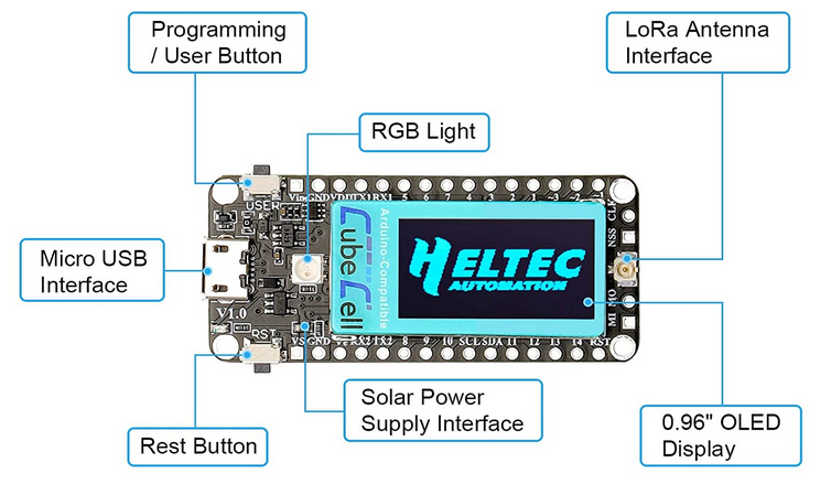

Talking of non-essential creature comforts the one thing that I have always wanted to add to a car is a way to remotely enable the heater/AC to either warm or cool the car ready to go (and the recent UK weather has focused my mind on the heating/defrosting side!). Now I could do this with the existing remote plip, the trouble is it is very limited in range and there is no confirmation if you can't see the car. An alternative would be to use a mobile SIM, but I'm not keen on this for a number of reasons (SIM costs, complexity, don't like smartphones, power consumption, need static IP address, poor local coverage, etc). Instead I've ordered one of these:
It's a LoRa wireless transciever with a M0 48MHz micro, oled display, couple of buttons and battery management circuits. The LoRa wireless transceivers can supposedly give a range of >5km line of sight (been tested to 14km!) or ~1km in built up areas, only uses uA in standby mode (and the car end 6mA in receive mode or 2mA @ 12V via a switch mode supply) and is supported by numerous code libraries. The plan is to make a fob sized remote out of it, have it show the car status (SOC, range, voltages,temps) on the display on a single button press and on an additional long press start the car climate control.

Hi Peter, what talks to the "LoRa" at the vehicle side? Looks like an awesome thing.

On the LoRa the plan is to build one of these https://www.fanstel.com/lr1262 into the VCU. Will probably add another into the house BMS (Building not Battery!) to allow it to monitor the car's state too (could do that with WiFi but don't like having the constant power drain associated with WiFi and the car will also be parked a little too far away for WiFi to be reliable).
