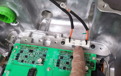

On my build the capacitors in the Lexus inverter are not discharging and even after 24 hours they are HOLDING HV VOLTAGE almost to the level of the battery pack i.e. 400 Volts. If I take a voltage reading, with the HV battery completly disconnected, at the terminals of the inverter I have just short of 395Volts.
As I understand it the inverter capacitors are supposed to discharge through the MG1 and MG2 connections to the GS450H Transmission.
Obviously not a great state of affairs!!!
I hope no one else has experienced this issue.
Any guidance regarding this would be really appreciated.

there should be a ceramic resistor at 15 kohm or so current connected at + and - high voltage. its purpose is to smoothly discharge the capacitor after disconnecting the battery. it's probably missing or not connected to you.
mg1 and mg2 motors are not involved here

hello. the link doesn't open for me. here is a photo for example, this is in the Nissan em61 inverter, but the same detail is in all high-voltage inverters of Toyota, Lexus, Tesla and others. one end of it is connected to the + and the other to the - high-voltage input in the inverter. when the main contactor is turned off, the voltage of the conductors will discharge to this resistor.dadiowe wrote: ↑Tue Oct 25, 2022 1:10 pm Hi Romale,

No, it doesn't discharge through MG1 or MG2. There is no mechanism for that. There is instead a ceramic bleed resistor inside the converter housing.dadiowe wrote: ↑Tue Oct 25, 2022 10:56 am On my build the capacitors in the Lexus inverter are not discharging and even after 24 hours they are HOLDING HV VOLTAGE almost to the level of the battery pack i.e. 400 Volts. If I take a voltage reading, with the HV battery completly disconnected, at the terminals of the inverter I have just short of 395Volts.

Thanks Romale that sorted my inverter discharge problemRomale wrote: ↑Tue Oct 25, 2022 1:16 pm hello. the link doesn't open for me. here is a photo for example, this is in the Nissan em61 inverter, but the same detail is in all high-voltage inverters of Toyota, Lexus, Tesla and others. one end of it is connected to the + and the other to the - high-voltage input in the inverter. when the main contactor is turned off, the voltage of the conductors will discharge to this resistor.

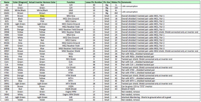

Hey guys, first post here. Been lurking a while and wanted to share the pinout I'm using for the Molex replacement inverter connector, I didn't see this documented anywhere so apologies if this has been covered before. If it looks good I'll add it to the wiki.
