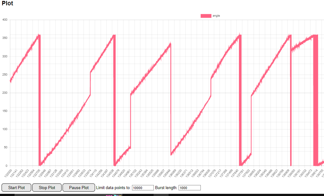

Still trying on this -can't now help wondering if the question of whether i need to weld the gears up or not is important here and don't seem to have a defintive answer yet for gen3 gearbox. Latuta makes no mention of it, but his gen3 set seems to spin in foc mode without issue. Maybe my gearbox is duff, it was after all from a breaker.
To go back to last known good, i loaded V4.90 sine software. MG2 turns great on 0.5 amp @ 90v
With my resolvers wired up I get this graph which to me looks close enough to Bigpies known good graph above, especially given motor is hand cranked to generate this.
When hand cranking the motor, it sometimes 'grips' and i get a resolver graph, othertimes it seems to 'let go' and i'm turning nothing. I wonder if sometimes the gearset turns one side instead of the other, its like a 3 way split inside if i understand correctly.
So then i load up foc, set the params back (resolver etc), precharge, bypass bulb and set manualid to 5. I get some clonks, the motor tries to turn, but then is free to turn by hand with some whining from inside.
Do i have a duff gearbox, do i need to weld it up or is it still something else ?

Definitely something else. Since it's not pulling all the available current from the battery means you have current control so that's ok. So what's left now probably other settings and resolver. You need to make sure pole pairs/res pole pairs are correct for your motor and then search for correct resolver combination.

If it spins on sine means it will also spin on foc once you get the settings and resolver correct. Welding has nothing to do with it. You weld for a different reason which is combined output.

I now think the welding might be a red herring. As was stated if it works in sine mode the mechanical connection is there.
So mulling this over, i set all my params to be same as Bigpie and got a pretty even rotation on manualid=3 at 90v (drawing about an amp). Not perfect (the occasional clunk) but a big improvement
