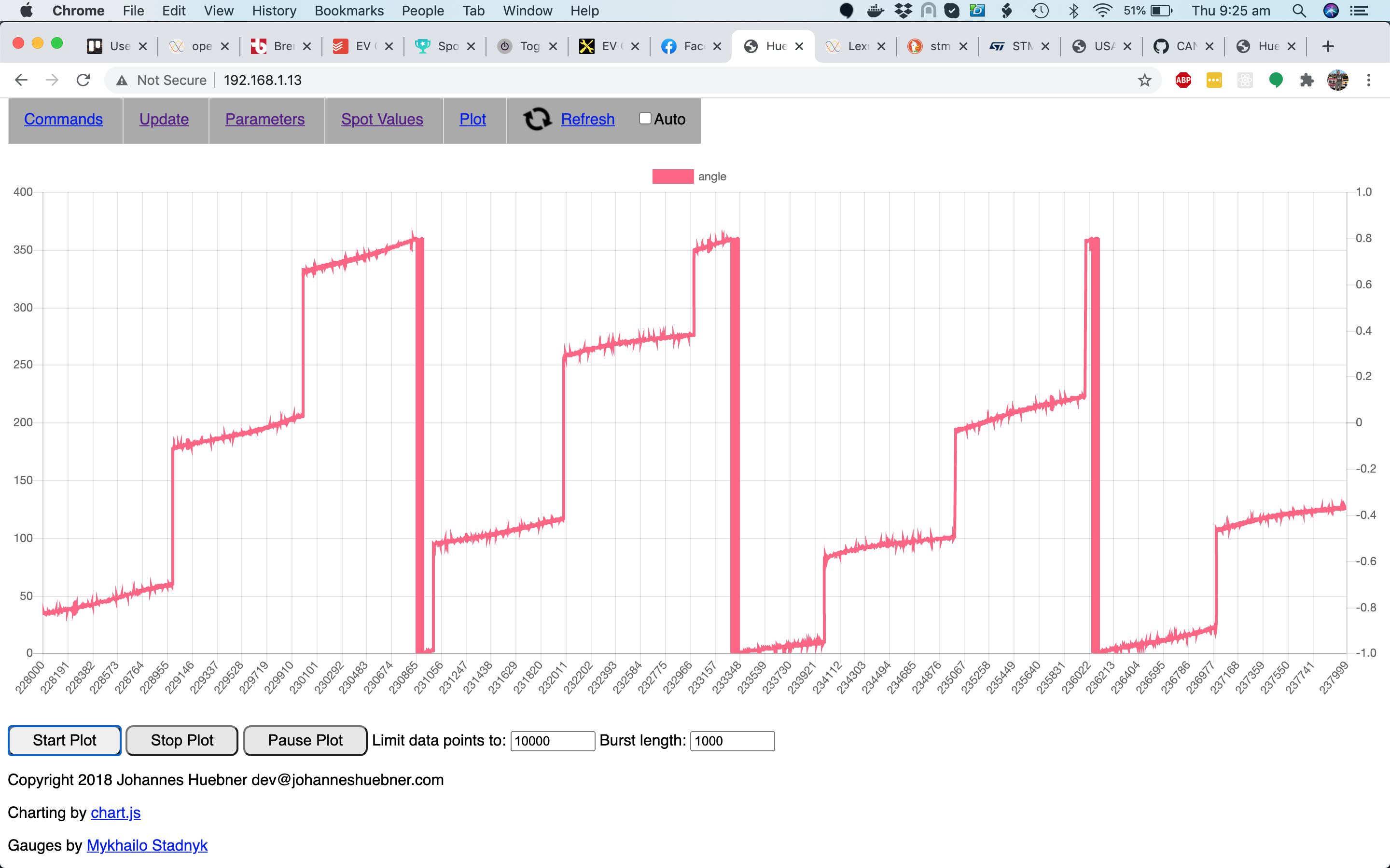

OK - V1C board Prius Gen3 inverter and gearbox wired to MG2
Been through all the wiring again and checked the pairs etc (Pair 1 - encoder A & Sin, Pair 2 - encoder B & cos).
I downgraded to 4.90 FOC f/w figuring maybe if the latest version of sine f/w was broken in manual mode then maybe foc is somewhere too, and it seems the videos from Damien and Latuta are on earlier versions. Didn't seem to make any difference.
Results are pretty much the same as before, 4 graphs as shown:-
https://www.dropbox.com/s/yip2iv3dz8ug5 ... 1.PNG?dl=0
https://www.dropbox.com/s/jrvlouy11ek8y ... 2.PNG?dl=0
https://www.dropbox.com/s/u26poqy7751ht ... 3.PNG?dl=0
https://www.dropbox.com/s/68mc4nujufxkz ... 4.PNG?dl=0
Plots 2 & 4 are a mirrors of 1 & 3 in terms of the orientation of the teeth.
Do any/none look right ?
E46 touring

Post by m.art.y »
FFMan wrote: Tue Nov 01, 2022 9:38 am Do any/none look right ?
Not all graph is visible isn't clear if it has full 0-360 amplitude. So what is happening? Do you hear a specific sound that the motor is making as you try to spin it? Check if you have your settings right in encoder mode, pole pairs, pinswap. And did you wire resolver inputs correctly. Without correct feedback from current sensors and resolver the motor is not going to budge.
Posts: 1597
Has thanked: 75 times
Been thanked: 306 times
This is mine from when I was getting setup.
You can see it has a plot from 0 climbing up to 360 and dropping back to 0. If you're spinning it too fast or not using enough plot points you'll cut off bits.
BTW, if you attach the images directly to the thread, it'll be easier for people reading to view and compare and ensure they remain should you deleted them from dropbox.

Post by FFMan »
sorry - yes each is swinging from 0 to 360, very little jitter at idle.
I have (names from memory):-
encoder - resolver
polepairs 4
respolepairs 2
pinswap pwm23
well that is the queston really - what is correctly. I identified the resolver pairs with the meter, then as stated above paired on the ampseal encoder A with Sin, and encoder B with cos connections. The V1c is slightly different to the version used in Damiens video so it was best guess but seemed to be confirmed by the russian diagram.
So when I turn on the 80v (lithium) HV with 100w bulb inline and step increase the manualid the light stays on and the motor does nothing. I believe the bulb should extinguish after a few seconds. I've upped the manualid to 5. Not tried with the bulb bypassed yet as it does not seem to be recommended at this stage.
appreciate the response.

this is using the pairs shown in the second graph.
Given my graphs were a little inconclusive, shall i just try each pair combination in turn to see if motor spins or is there definitely still a bigger issue ?
i've added a dump of my params in case you can spot anything. Deadtime is set to zero, i got the impression this was right for Prius.
params (4).json
(1.29 KiB) Downloaded 106 times
