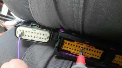

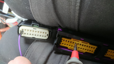

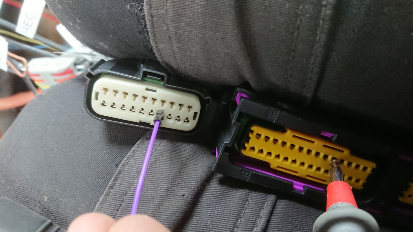

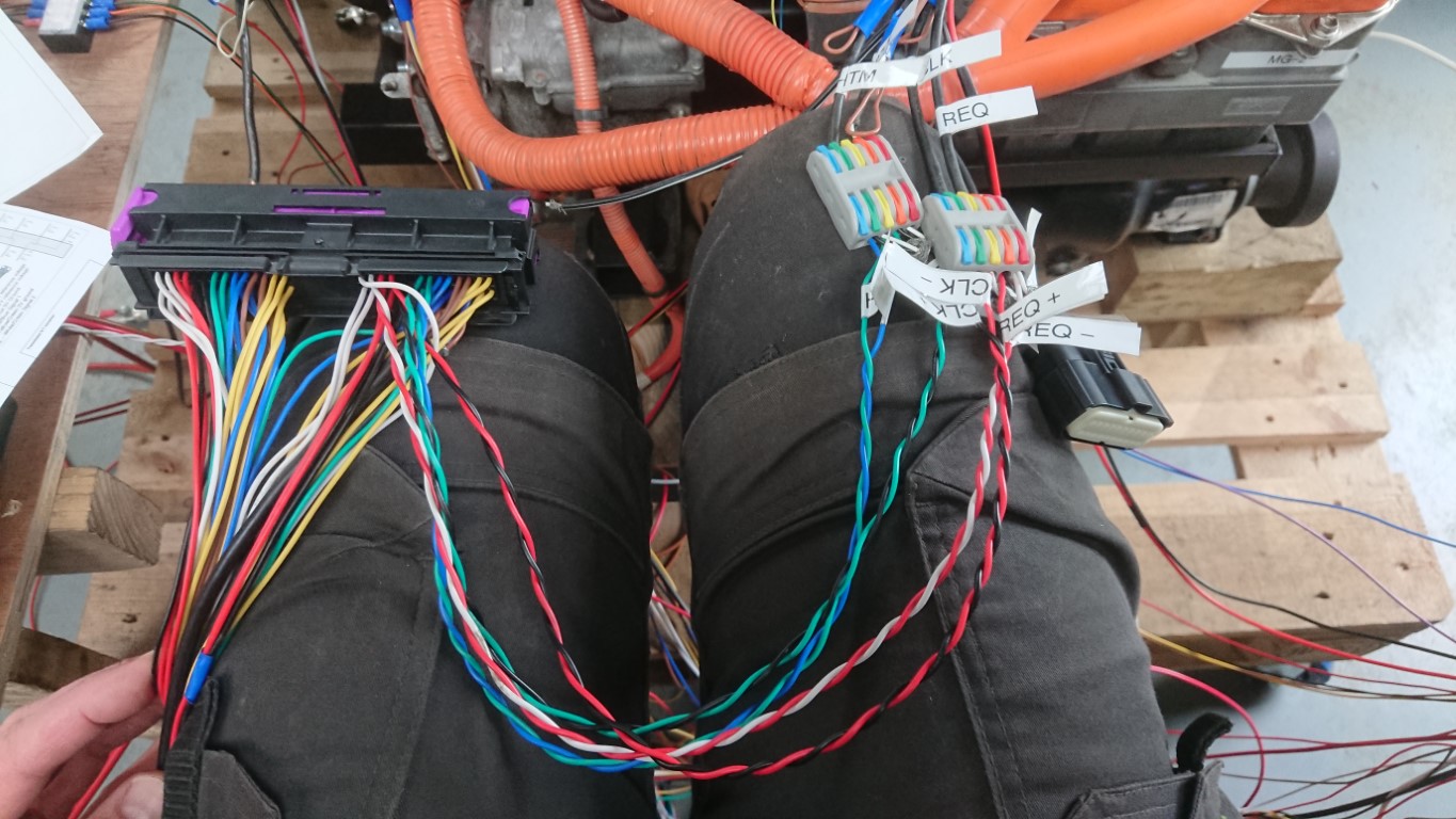

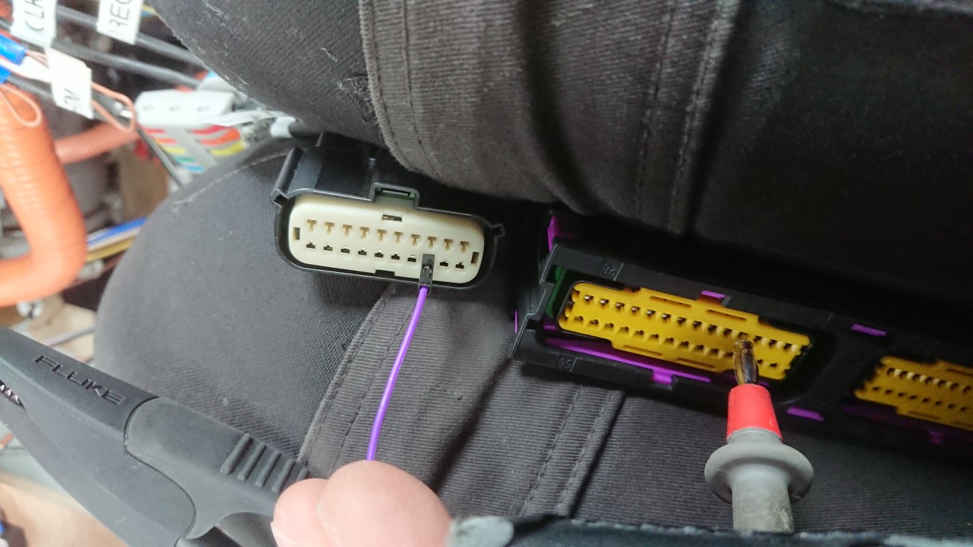

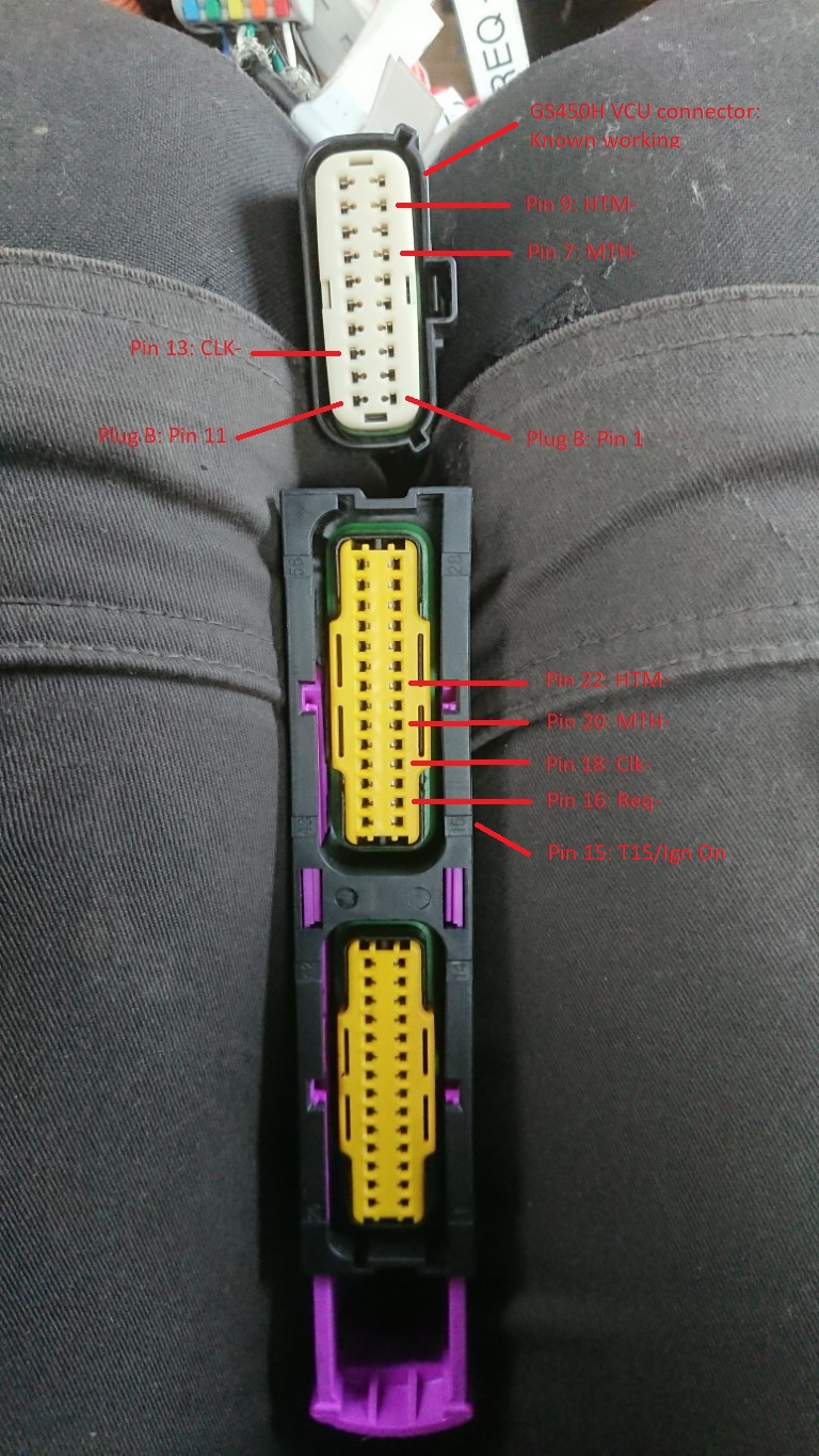

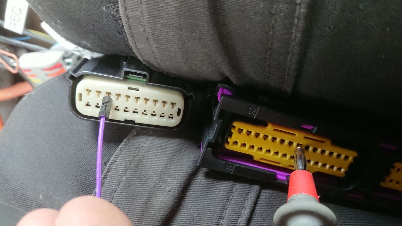

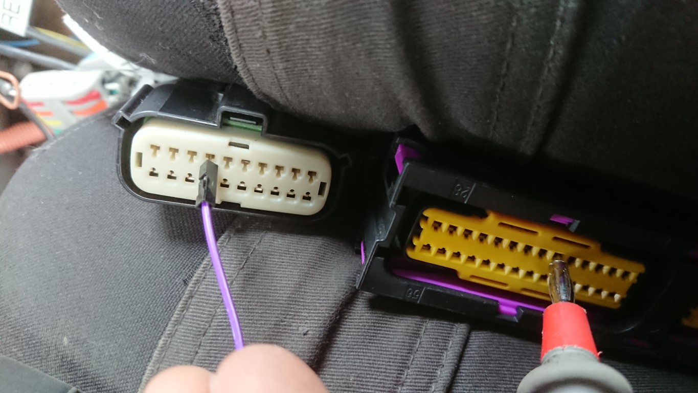

Not easy to explain where all the checks are happening so photos below should cover it. So 8 off inverter comms wires come in at top right to one side of the connector blocks, and the GS450H VCU (small black plug to the right of the connector blocks) and Zombie header connectors are joined and connected to the opposite side of those connector blocksEV_Builder wrote: ↑Sat Oct 15, 2022 8:18 pm Well if you ask me you should tell us where you think you connect everything? Let's check pin 1 etc..might be stupid but I bet something small is causing this.
This is how I'm reading the pin numbers (from wiki's and github pinouts)
And with the inverter plug disconnected so I'm not getting continuity across the termination resistor on each pair, below photos show where I get continuity for each of the 8 comms wires between the VCU header plugs. The GS450H is working ok, so unless I'm reading the pin numbers wrong, I think the Zombie should be ok! And just to note, all the other connected wires work as expected, 12V and ground, shunt CAN, contactor control, throttle inputs, ign on and start, so pretty happy I have the pin numbering ok

Rechecked this and I must have saved the params without saving to flash or power cycling the VCU. Changing the inverter option, saving to flash, power cycling the vcu, reconnecting and downloading and reading the parameter files does change the inverter number in the parameter files.

Pin 16= REQ -....
- Posts: 559
- Has thanked: 385 times
- Been thanked: 80 times
Re: ZombieVerter VCU Support
Yea, do you see something wrong in the photos? I have 16 = req-, 17 = req+, etc
No can't see it, I think next step is that the VCU program is adapted to spit out something on the web interface to confirm us: receiving/ succesful sending of data.

If you see that coloured levered clip / join block.
Why are there more then one wire in?

I have two wires coming out from each, one goes to the zombie connector and the other goes to the GS450H VCU connector. This is so I can plug in either the zombie or the GS450H VCU to run the one driveline...for testing purposesEV_Builder wrote: ↑Sun Oct 16, 2022 5:22 pm If you see that coloured levered clip / join block.

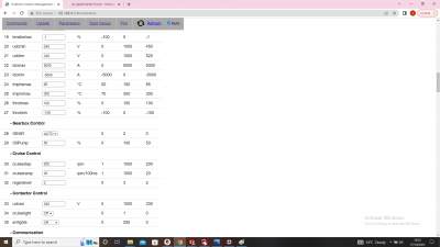

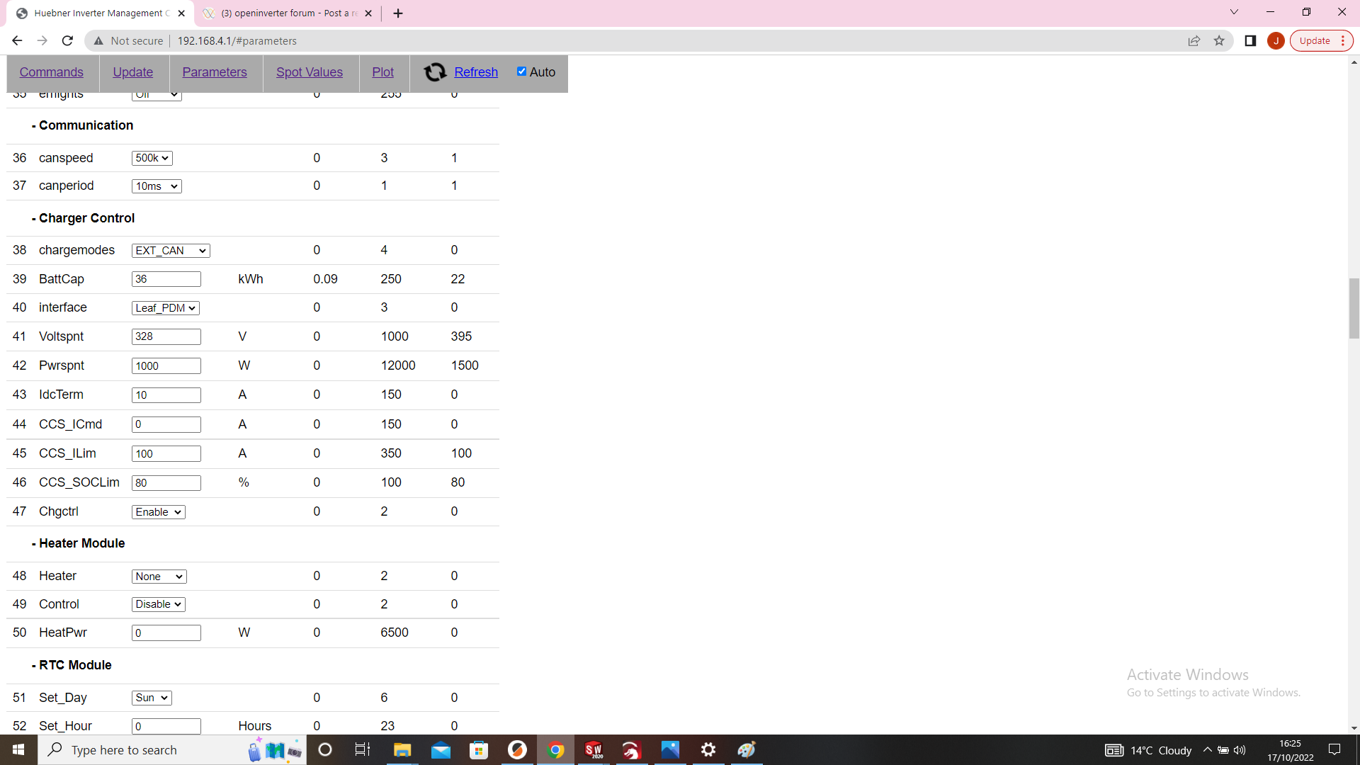

Good afternoon all!
Having an issue with my ZombieVerter / Leaf Gen2 Setup..
I have the setup in the car - (complete gen2 motor, inverter & PDM)
I am using LG Chem batteries, 300v (4x 5 batteries in series strings)
and obviously the ZombieVerter!
I am currently trying to get the setup to charge.
When the EVSE is plugged in, (& ign on) IT will close the contactors and charge for a short period but will soon after cut out, and I'm struggling to work out why. (probably worth noting, the can is communicating and the motor will spin)
I have attached some pictures of my parameters to help anyone kind enough to take a look!
I have noticed, in the 'spot values' the 'SOC' IS at 99.9% which could well be the reason its stopping it from charging but I cannot see what parameters are used to calculate this.. (UDClim & UDCmin etc are all correct)
Any advice?
Regards and Thanks in advance!

SOC is calculated using data from "BattCap" at the isa shunt. The interaction of the charge parameters is explained in the instructional videos to the best of my recollection. However I suspect your battery is full. Charge is terminated when 1)Idc drops below IDCspnt AND 2)UDC exceeds Voltspnt. So check if those conditions are being met firstly.
Hi,Jack Bauer wrote: ↑Tue Oct 18, 2022 10:50 am SOC is calculated using data from "BattCap" at the isa shunt. The interaction of the charge parameters is explained in the instructional videos to the best of my recollection. However I suspect your battery is full. Charge is terminated when 1)Idc drops below IDCspnt AND 2)UDC exceeds Voltspnt. So check if those conditions are being met firstly.
Thanks for your response,
Battery is not fully charged - Currently pack is at 280v max charge for the pack is 328V.
Car will charge successfully if used in 'HV_ON' manual mode, but when using EXT_CAN it fails. 'UDC' doesn't exceed 'Voltspnt' and IDC doesn't drop below IDCTerm (I presume you meant IDCTerm rather than IDCspnt). Weirdly when the EVSE is plugged in the system will precharge twice before going into 'Charge' mode for 5-10 Seconds before opening the contactors again. I have validated CAN wiring & termination resistance and all seem to be ok!
do you have any links about how the ISA shunt use the 'BattCap' Data to calculate soc? and if the zombieverter sees that it is at 100% Soc will it use that to terminate charging or does it only use the parameters you have mentioned in your reply to terminate charging? (Excuse my ignorance)
Regards!

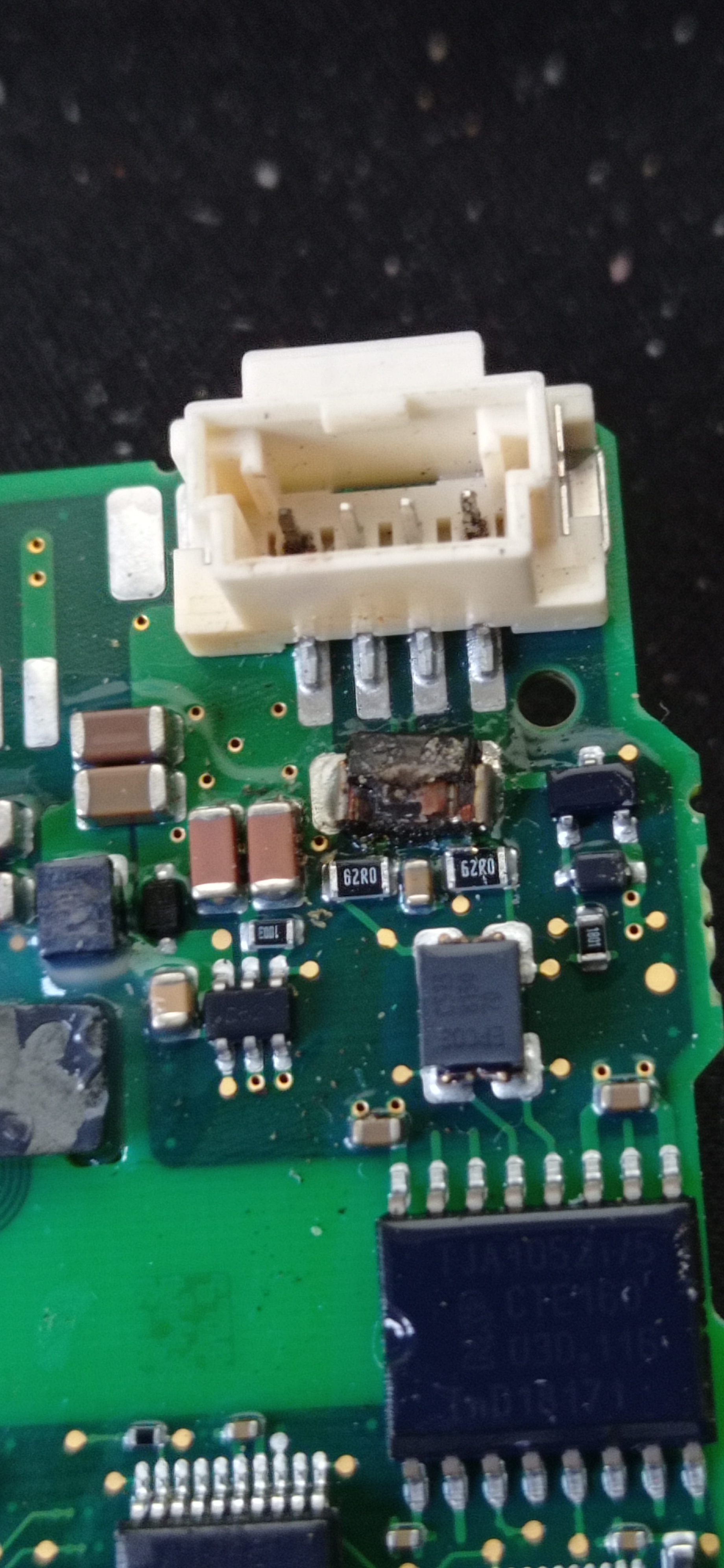

Today was not such a success as I managed to short out the HV sense wire from the positive side of the battery pack despite the positive terminal being disconnected from the battery. Further investigation appears to show that the capacitors in the Lexus inverter are not discharging and even after a few hours are HOLDING HV VOLTAGE almost to the level of the battery pack i.e. 400 Volts.
Obviously not a great state of affairs!!!
I hope no one else has experienced this issue. I have the Voltage sense wire connected after the master safety fuse, the negative contactor is not energised or welded. If I take a voltage reading, with everything powered off, at the terminals of the inverter I have just short of 390Volts.
Any guidance regarding this would be really appreciated.
Further to my Explosive start to the week. Can anyone tell me the part number of the component just below the 4 pin connector in the IVTS shunt? It is a long shot that nothing else is damaged but worth a try before spending £300 for a new unit.
