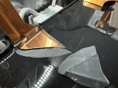

- 4markowen
- Posts: 42
- Joined: Mon Apr 20, 2020 9:12 am
- Location: Nottingham, UK
- Has thanked: 21 times
It was £18, and 'not working' so can live with it if I've completed borked it.
Not sure if you can see the full damage, will that glue back on? Should I not attempt it?
