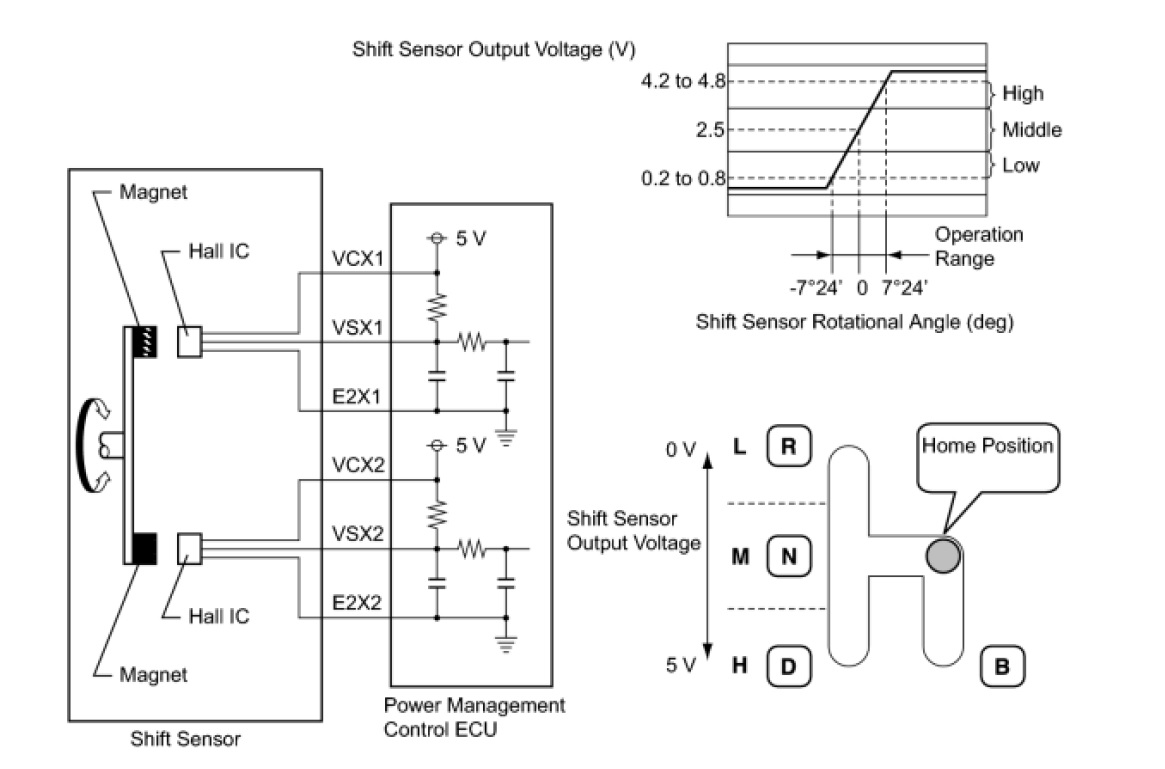

I have a Prius gear selector that I'm curious could be utilize for gear selection on the ZombieVerter? This is to drive a Nissan Leaf stack.
As I watched the ZV videos, the Forward and Reverse are triggered by 12v signals. Could it theoretically be programmed to be triggered by 5V hall effect signals?
HYBRID CONTROL SYSTEM Lever.pdf
(479.56 KiB) Downloaded 61 times
Posts: 3563
Been thanked: 87 times
Re: ZombieVerter VCU Support
To do so would require hardware changes.
FieroJam
Posts: 21
Joined: Tue Jun 28, 2022 8:00 pm
Location: USA
Post by FieroJam »
Jack Bauer wrote: Wed Oct 05, 2022 9:19 am To do so would require hardware changes.
I sort of figured. Back to the drawing board, although I've seen a couple of DNR gear selectors (round selector and push button) on Alibaba that are 12v.

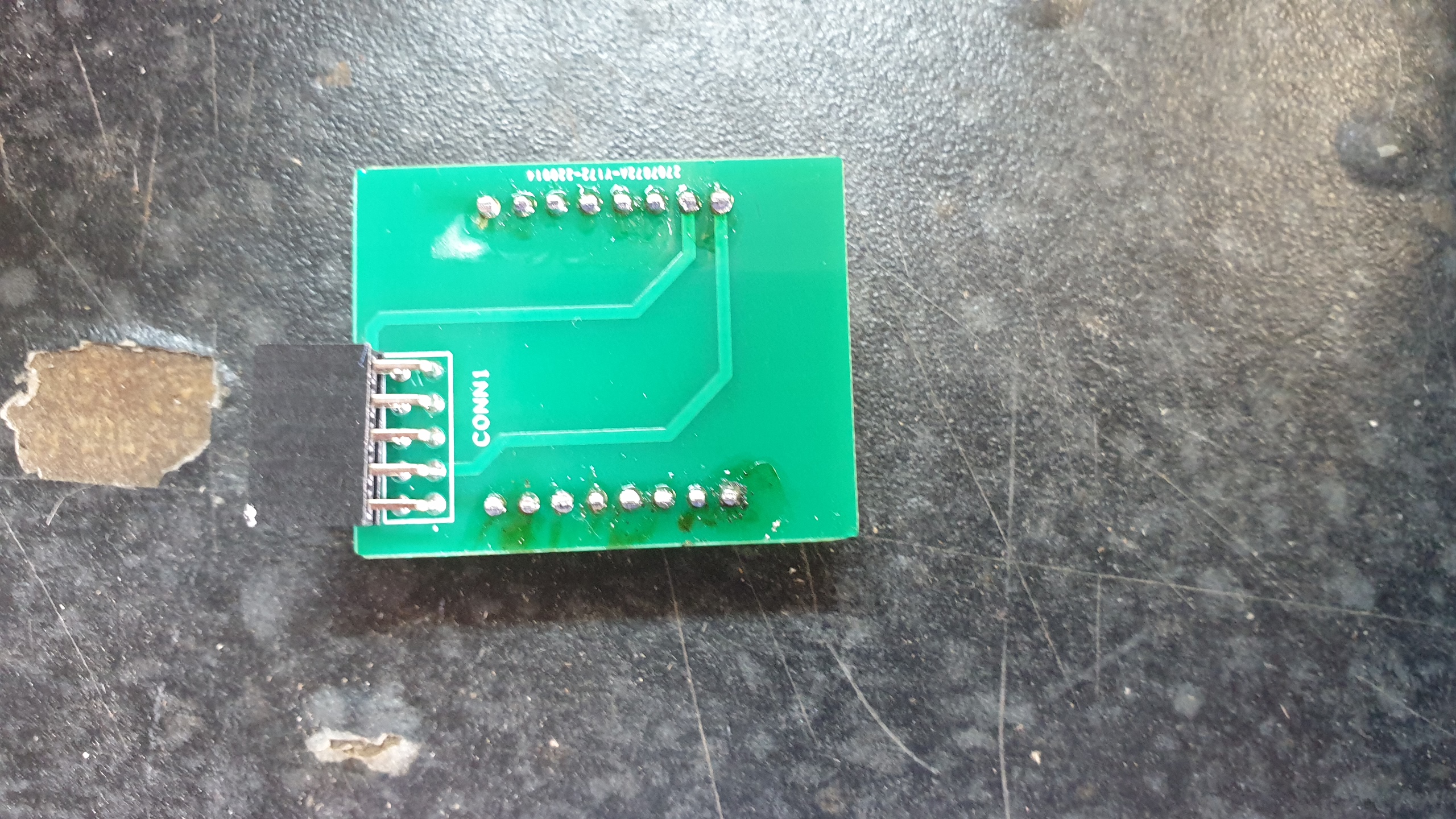

Just to advise that due to the complete fall off in quality on the Olimex WiFi modules all kits and boards will now be supplied with a Wemos D1 Mini module and adapter board. As of the next board order I will make the pcb dual footprint. These Wemos modules seem very much more robust than the Olimex at least in limited bench and vehicle tests.

Jack Bauer wrote: Mon Oct 10, 2022 11:19 am Wemos D1 Mini module and adapter board.
Are you selling these individually? I’d like to replace my Olimex as it only works very intermittently.

AdrianB wrote: Tue Oct 11, 2022 9:34 am Are you selling these individually? I’d like to replace my Olimex as it only works very intermittently.
Like i said somewhere along here, you just need to get one D1 mini module and solder 4 wire adapter cable directly to its pins. On the other side should be at least 2 by 2 pololu female connector to simulate Olimex.
And if you by chance glue your D1 mini to zombiverter board you can still programm it via its usb port. This really solves a lot of headaches.
Posts: 3563
No real point in my selling the little adapter boards as they are super cheap. Here are the gerber files. Just pop them into JLC or any pcb maker and you'll get 5 for a few bucks. I'll be making a little video shortly on how it goes together but to be honest it's fairly foolproof.

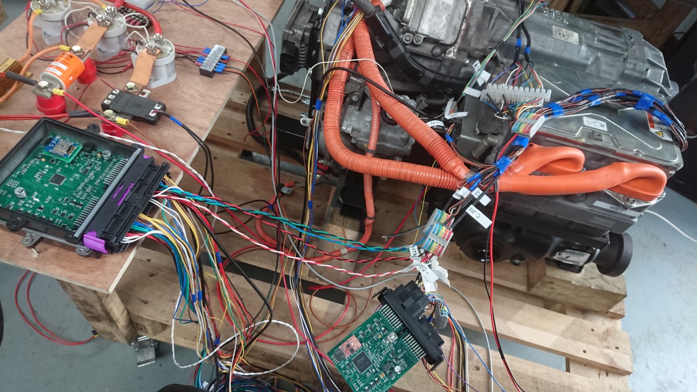

Well cr@p :? :? :?
Exciting delivery yesterday, new built Zombie arrived and cool to see the new wifi module with it. Was feeling positive this was the pot of gold, but....
Some more head scratching to do tomorrow, there's just something silly catching me out, has to be something small and silly. Wondering if anyone has any ideas for things to check!?
Get the same result as with the last Zombie, goes into run mode with no errors but no inverter whine, no InvUDC reading, InvStat stays off. Precharge and contactor sequence works spot on (60V at inverter HV input), inverter power relay ok too (12V at inverter power), gear selection is working, pot 1 and pot 2 and potnom graphing ok. Rechecked continuity from the inverter plug pins to the Zombie PCB for the 8 comms wires and all ok, and plugging in the old GS450H vcu starts up and runs the transmission in fwd and rev as expected. So confident the comms wiring is ok. Even tested with and without the HSDN connected, and have a switch mimicking the brake input signal.
Had saved a copy of the parameters that came on the vcu so even tested with those except for changing GS300H to GS450H for inverter as throttle settings were very similar.
Maybe someone see's what I'm missing? :) Good news is that when I figure this out, I have the vcu for the next project :D
Post by EV_Builder »
Don't you have simply Rx and tx switched?
Is there a parameter or something visible about comms working or not? Like sending Ok and receiving ok? Byte counts?
Posts: 3563
So the vcu you received was bench tested on my 300h setup prior to dispatch and also given a 24 hour soak test. My 450h is in the process of transplanting into the E39. As they both use the same hardware for comms the worst that could happen is the oil pump on the 450h would not run. We know the hardware is good, software is good enough at least to run on the bench so right up to the pin header on the vcu should be good. As your inverter is proven good it really does only leave the intermediate wiring.
nkiernan
Posts: 509
Has thanked: 284 times
Been thanked: 65 times
Post by nkiernan »
Jack Bauer wrote: Sat Oct 15, 2022 7:14 am So the vcu you received was bench tested on my 300h setup prior to dispatch and also given a 24 hour soak test. My 450h is in the process of transplanting into the E39. As they both use the same hardware for comms the worst that could happen is the oil pump on the 450h would not run. We know the hardware is good, software is good enough at least to run on the bench so right up to the pin header on the vcu should be good. As your inverter is proven good it really does only leave the intermediate wiring.
Apologies, know I'm like a broken record at this stage :? Yes, that's the only thing that makes logical sense, and I've tried many different checks to see if I've done something silly but everything keeps checking out ok. I have the GS450H Tee'd back in so its easy to check between the inverter plug and both VCU headers (inv to GS450, GS450 to Zombie, Zombie to Inv), and can get continuity between all the relevant comms lines, and I can get approx 60R between each pair on both the Zombie and GS450H (with no power connected and only connecting one of the VCU's at a time). The GS450H runs the set up no problem every time. I'll recheck the comms wires again tomorrow with a fresh head, but I've checked and double checked many times over the past month or two so I have been happy the wiring is correct. Just to note, the GS450 VCU is running the user V3 code.
It really feels as if there is something like a shut down or safety shut off or something preventing the inverter firing up...like you'd expect from the HSDN/Park signal...or is there any way the Zombie could think its in 'charge' state so keeps the inverter shut down?!
Posts: 3563
Nope. Opmode would be in "charge" instead of run. Does the oil pump run with the zom?

EV_Builder
Posts: 1199
Location: The Netherlands
Has thanked: 16 times
Been thanked: 33 times
nkiernan wrote: Sat Oct 15, 2022 5:48 pm Apologies, know I'm like a broken record at this stage :? Yes, that's the only thing that makes logical sense, and I've tried many different checks to see if I've done something silly but everything keeps checking out ok. I have the GS450H Tee'd back in so its easy to check between the inverter plug and both VCU headers (inv to GS450, GS450 to Zombie, Zombie to Inv), and can get continuity between all the relevant comms lines, and I can get approx 60R between each pair on both the Zombie and GS450H (with no power connected and only connecting one of the VCU's at a time). The GS450H runs the set up no problem every time. I'll recheck the comms wires again tomorrow with a fresh head, but I've checked and double checked many times over the past month or two so I have been happy the wiring is correct. Just to note, the GS450 VCU is running the user V3 code.
Well if you ask me you should tell us where you think you connect everything? Let's check pin 1 etc..might be stupid but I bet something small is causing this.

nkiernan wrote: Fri Oct 14, 2022 7:59 pm Had saved a copy of the parameters that came on the vcu so even tested with those except for changing GS300H to GS450H for inverter as throttle settings were very similar.
params_as_delivered_131022.json
params_newly_set_131022.json
These two files are identical.
Not sure which version of the code is on there, but if it is 1.01 Inverter=6 is undefined. This is an easy way to drive yourself crazy is to set a value that is valid in one version and then put on new code where it isn't and it will just keep doing undefined things. I'd set it to GS450h, save to flash and power cycle to be sure it gets initialized properly.
