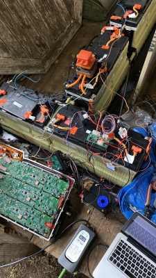

Hi!
I was able to charge successfully from a wall socket at baby test ampage. (5amp)
I used a variable resistor to get the resistance correct for it to detect the plug.
I haven’t put my brain to work on the charging side of things in a while so I might misremember this but I think SIMP BMS controlled the charge relay, and damiens gen 3 board did the handshake. https://www.evbmw.com/index.php/evbmw-w ... controller
I’m happy to talk through my progress. If that’s useful to you!

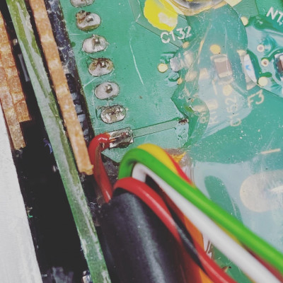

Cool I’m away for a while so can’t show you specifics but I have an eu version, so no modification required.
Evbmw covers the steps to convert to 3 phase eu.
I have spammed some photos, cutting the board isn’t that bad it’s nerve wracking!
The hardest is routing the cable to not compromise the weather sealing.
I also left a spare cable in mine to avoid having to desolder the whole lot Just for one broken line. I think it’s 18 lines (I used 3 ground and 3 positive because they’re thinner gauge than ideal.)
I had to merge these into two pins defeating the purpose 🤣
I think mine is 18 but I cannot remember off the top of my head.

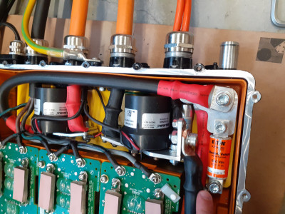

muehlpower
Posts: 689
Has thanked: 14 times
Been thanked: 141 times
Re: Tesla Gen 3 charger compatibility
Post by muehlpower »
The difference between 48A and 72A is easy to see, as the 48A only has 2 instead of 3 modules. I think there are also some with only one module. US models differ in the hardware only in the contactor part, which is normally not used by us. I used the space on mine to accommodate the DC contactors for fast charging and a couple of fuses, as well as the voltage measurement for the LIM.

muehlpower wrote: Sat Nov 13, 2021 12:56 pm I used the space on mine to accommodate the DC contactors for fast charging and a couple of fuses, as well as the voltage measurement for the LIM.
Thanks, that is very helpful and nicely done. Would you explain the wiring a little bit? Do you have AC coming in via 2 separate ports (black thick wire and 2 smaller orange wires) and is it wired for 3 phase? How is the control done when you connect to single phase and then 3 phase is it automatic or you have to change a setting? Also looks like you're not using AC contactors how are you timing the AC application to the charger is it done via EVSE? Which control board are you using? Also looks like you totally removed Tesla mainboard are you connecting to the modules via it's connector?
muehlpower
Posts: 689
The AC input is the black cable (4x6mm²). The two thick oranges on the right are the DC input and, like the AC input, are connected to the CCS2 inlet. The two thin orange cables supply the DC-DC converter, battery heater, cabin heater and A/C compressor with power. I completely removed the original board and led the cables through the old connector hole to the controler. The two thick, lower orange cables go to the battery box, in which the main contactors and the main fuse are. In single phase mode only one of the three modules works, which gives me up to 6kW if the socket is adequately fused. I do not bridge 2 modules on the AC side because there are no single phase outlets larger than 32A! 16A is normal
