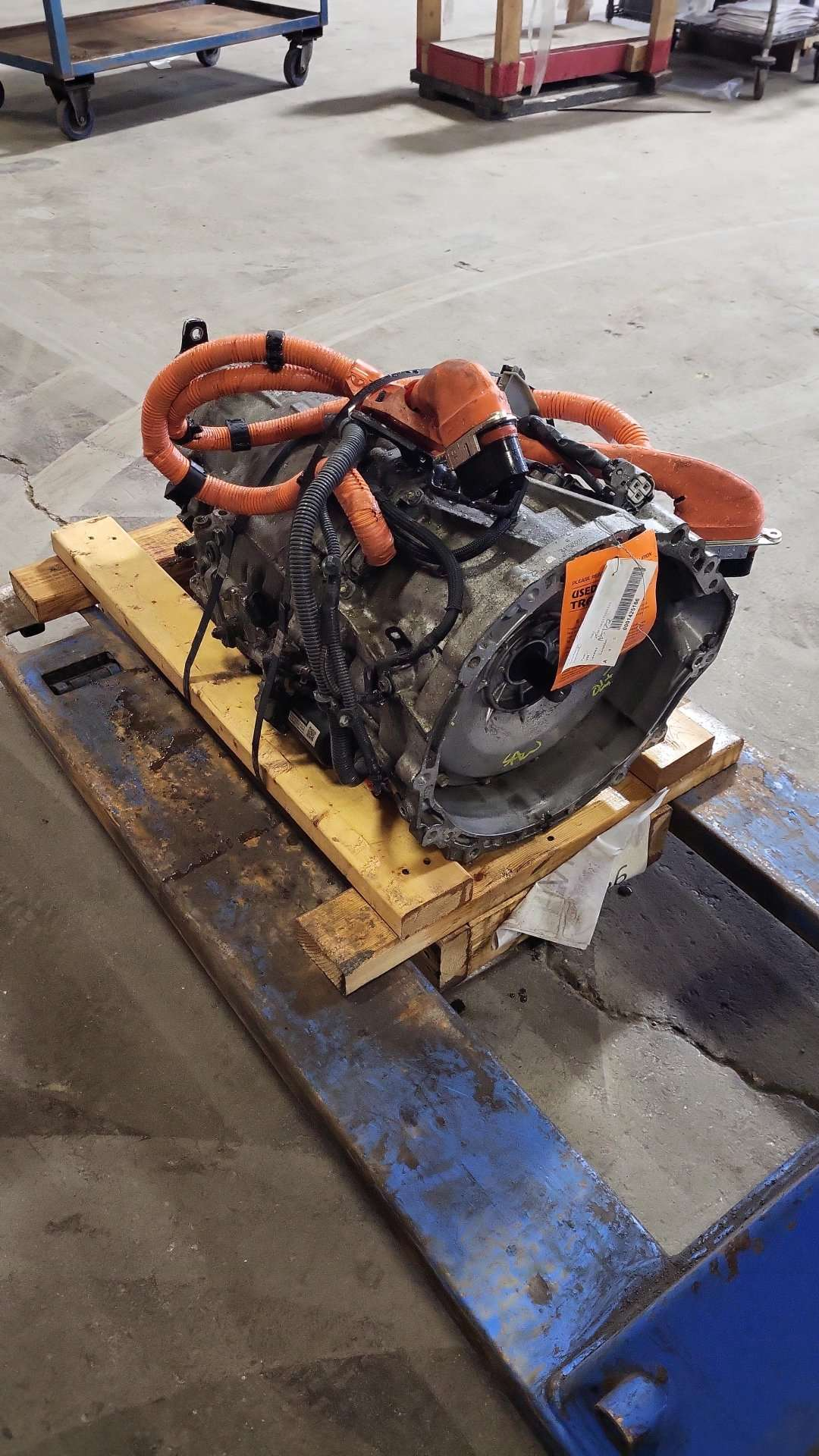

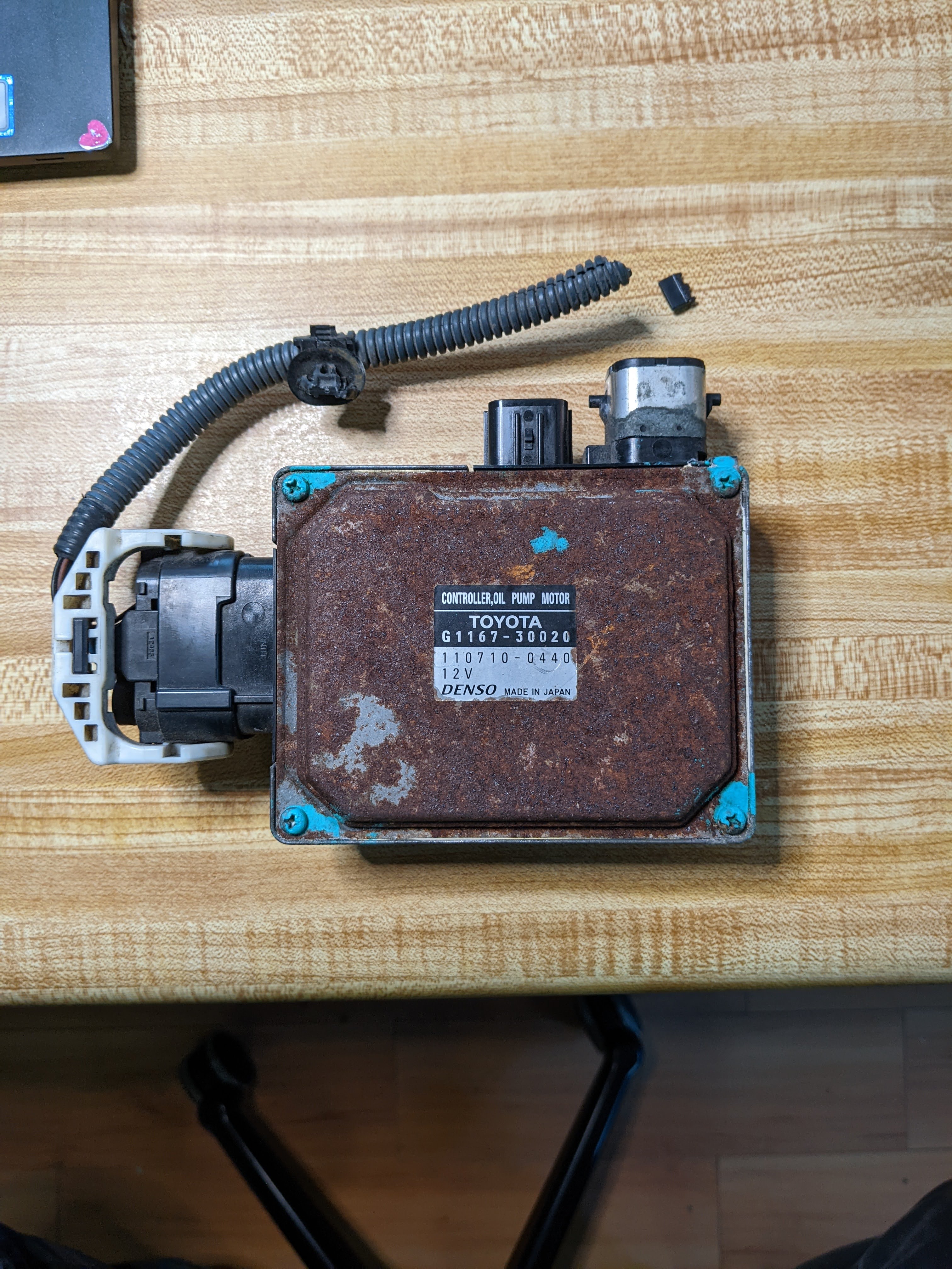

After some searching on car-part.com, I found a GS-450H transmission for a really good price. I think they're pricing it like the GS-450 ICE auto trans? Around the same time, I spoke with a member on a Volvo message board, not too far from the salvage yard's location in Canada. He's looking for some of the manual transmission parts that I have kicking around. He's buying the transmission, driving it down here, and driving back with my parts. We both wind up getting a good deal, and no shipping.
Based upon the pictures they sent, it looks like it has the pump, the HV loom, and even (part of?) the wiring for the pump? I doubt the controller is included, but those aren't too expensive on ebay.

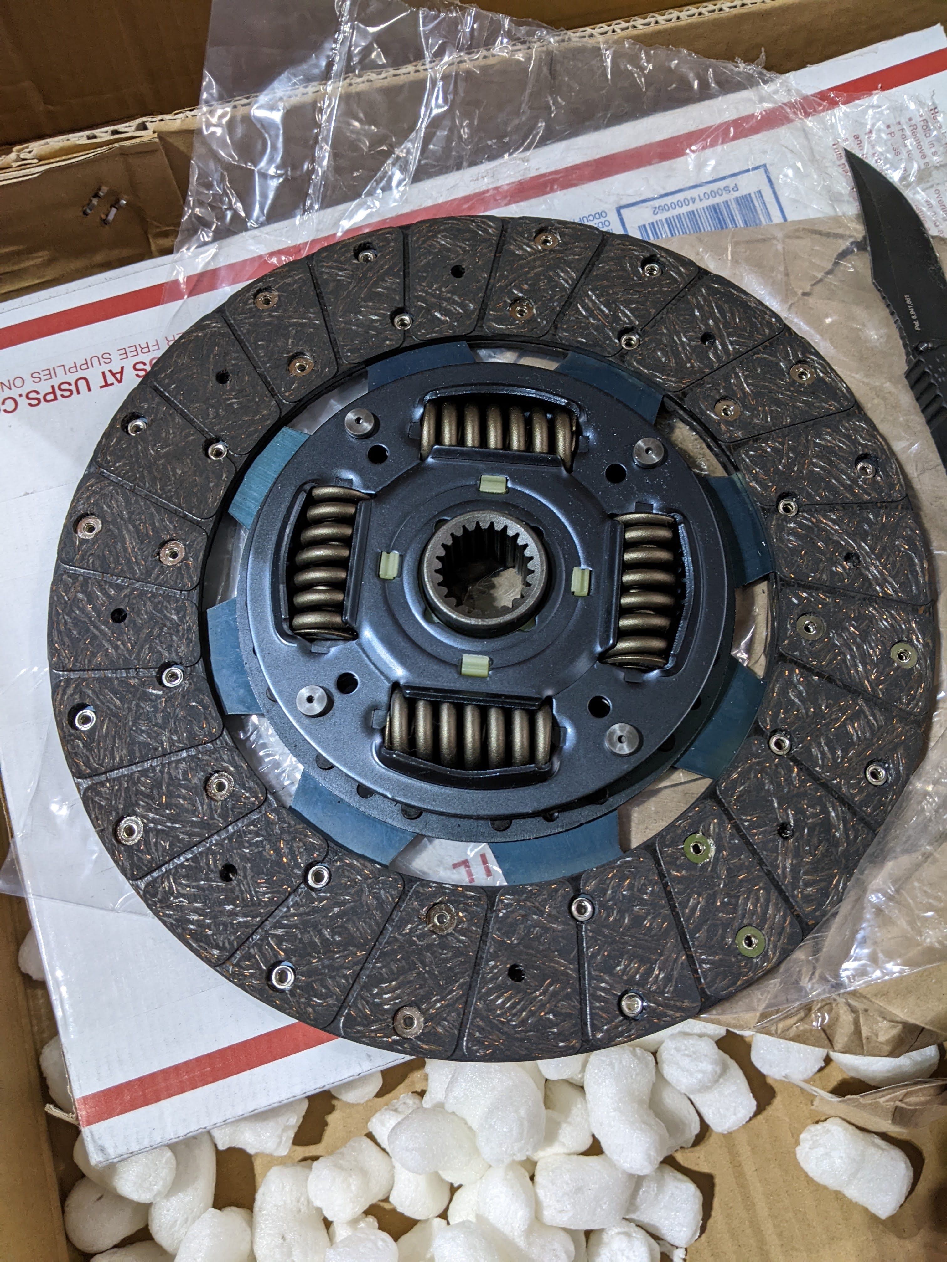

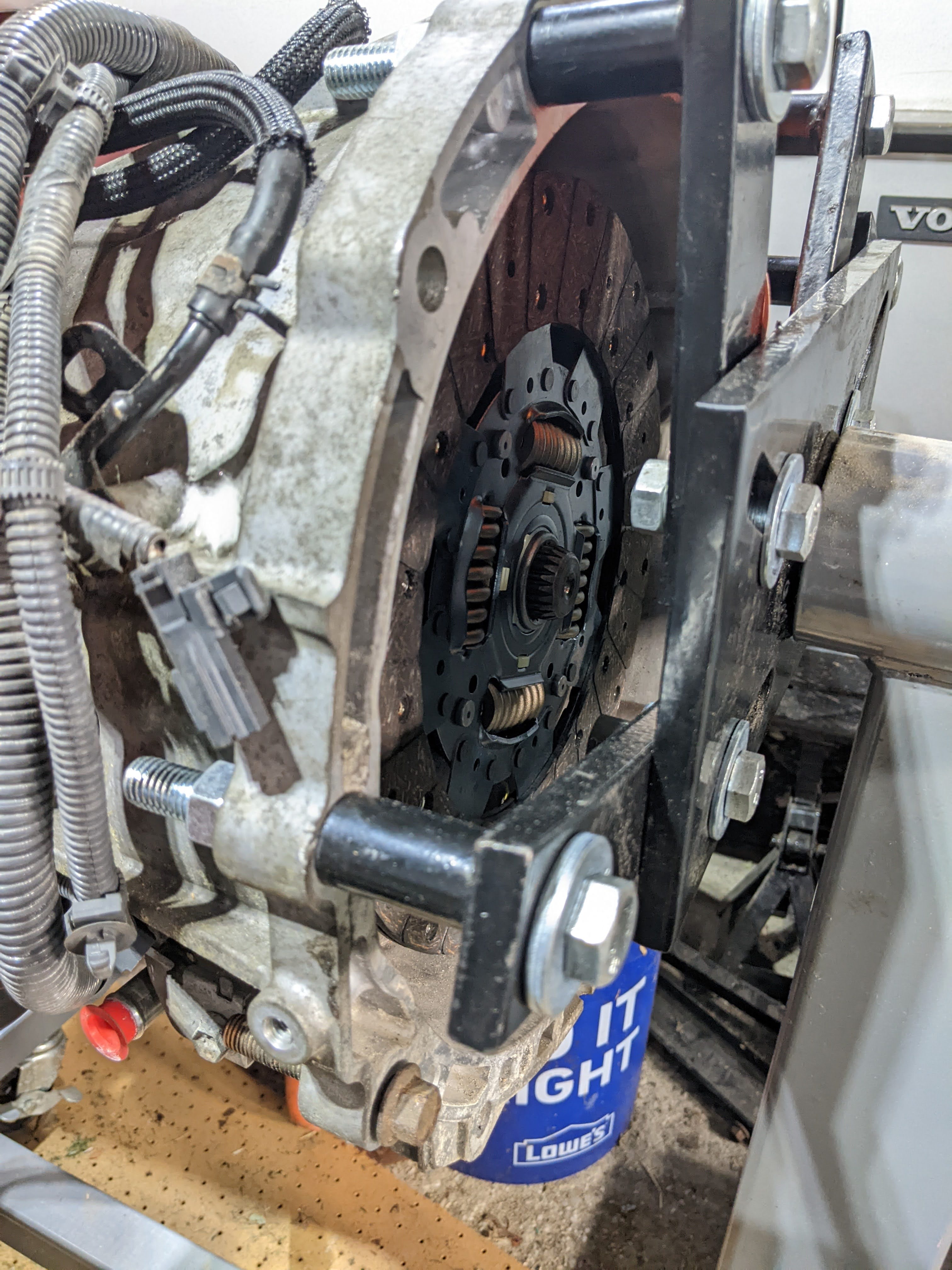

Clutch disk arrived today, via ebay: viewtopic.php?p=48324#p48324
Now to decide how to attack it with the grinder.
Next, I'll be ordering the blanking plate from this thread: viewtopic.php?p=20934#p20934
