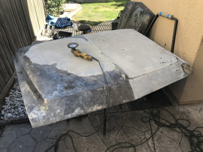

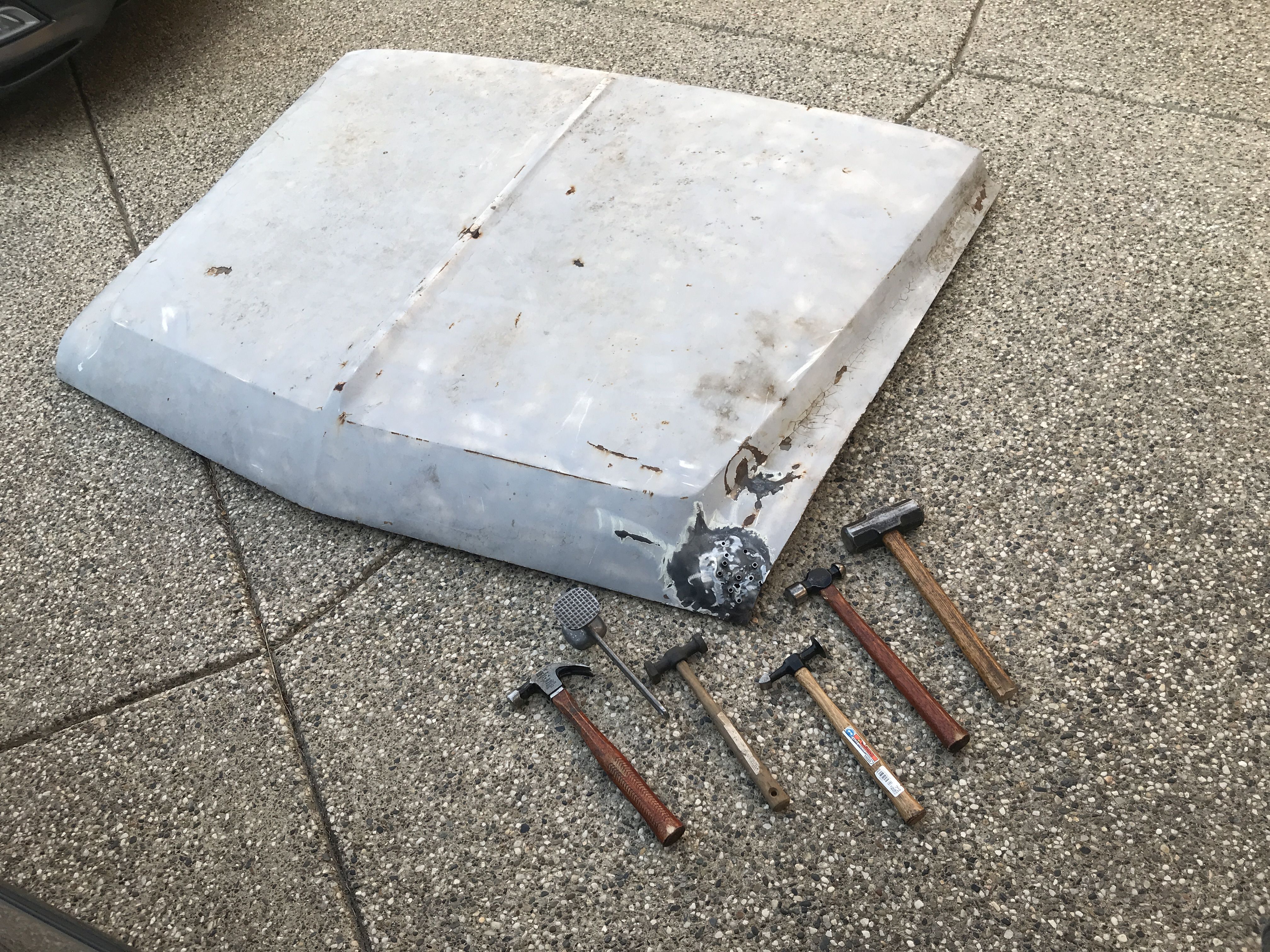

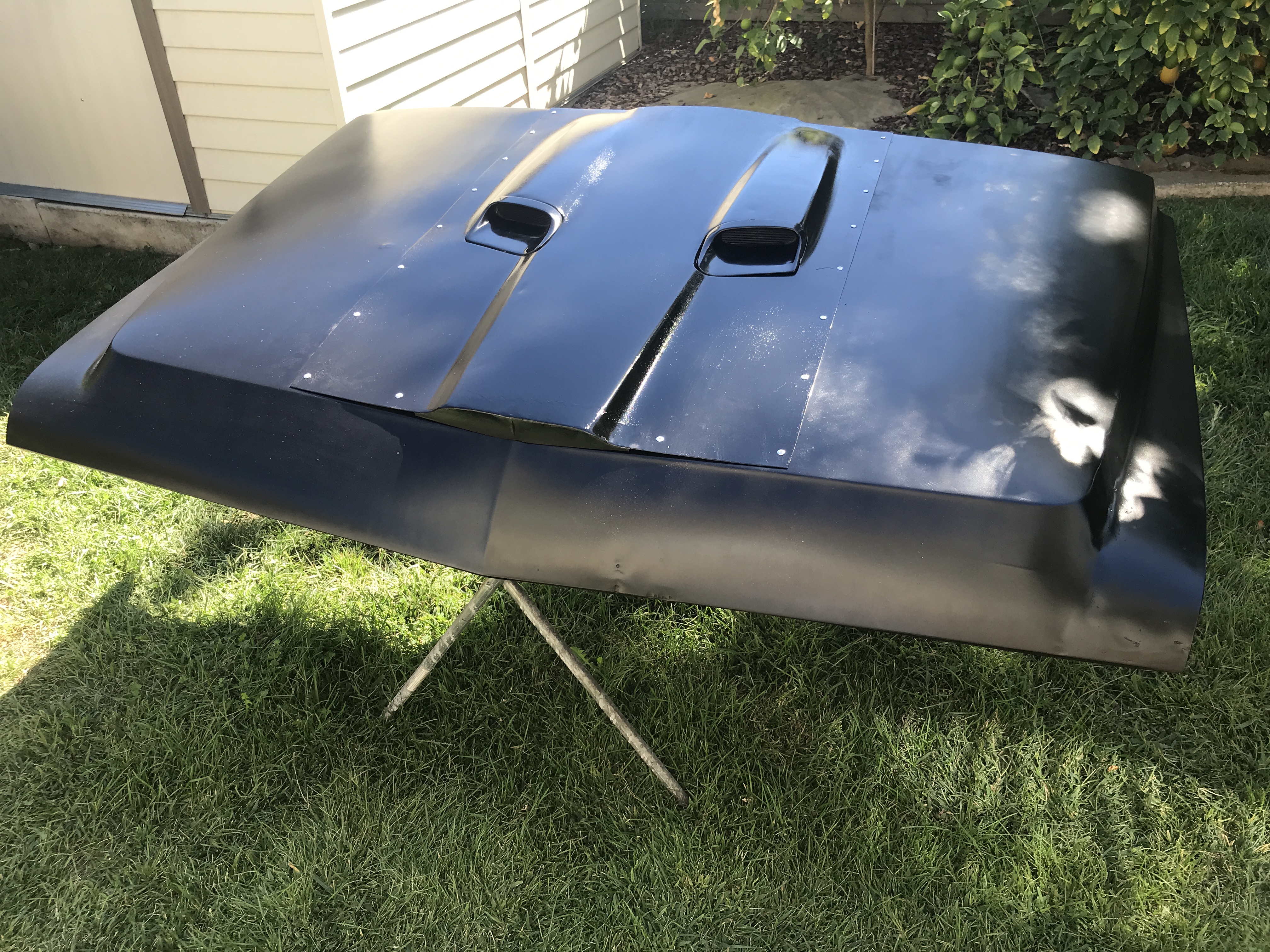

culminating in my last act of defiance where I mount Pontiac GTZero nostrils atop a Chevy hood
all documented in excruciating detail on My Dusty 71 GMCe Electruck build thread on 67-72chevytrucks.com
- Gregski
- Posts: 3164
- Has thanked: 633 times
- Been thanked: 1610 times
ha ha, or as I like to call it dent, hole, and crack cover
- TheSilverBuick
- Posts: 187
- Has thanked: 3 times
And here I thought leaving the 400 hood on my Firebird was sacrilegious when I put a turbo L6 in my Firebird, lol!

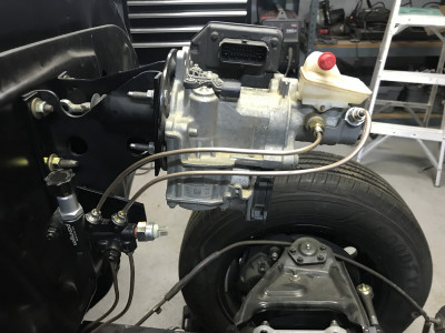

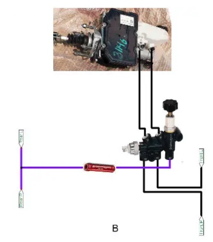

so I decided to re plumb the iBooster with much nicer and gentler sweeping bends, and then go to EVCreate to see if I got the front and rear lines correct
any guesses if I got it right?
- Gregski
- Posts: 3164
if indeed I made an error, now I must figure out how to somehow blame SuperfastMatt for said error, as I do not identify as someone who is error prone

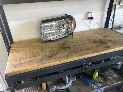

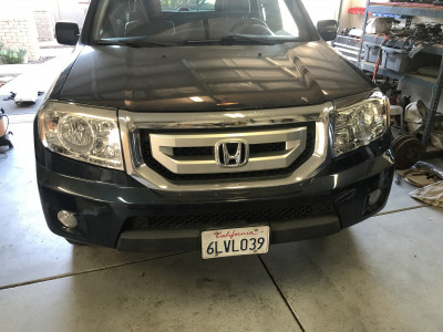

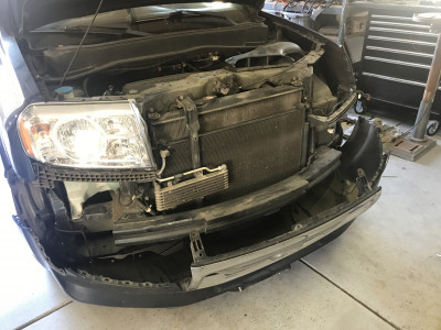

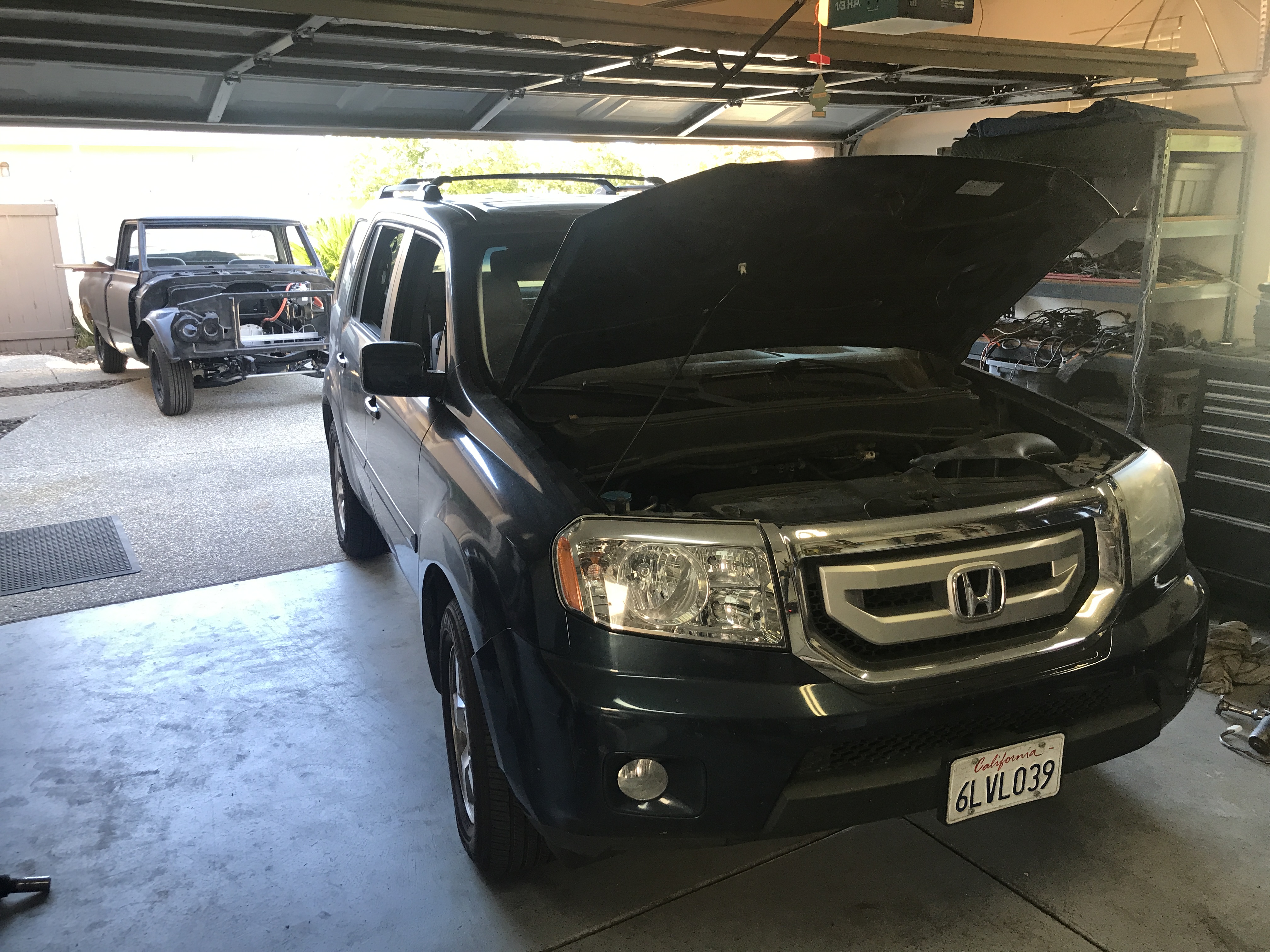

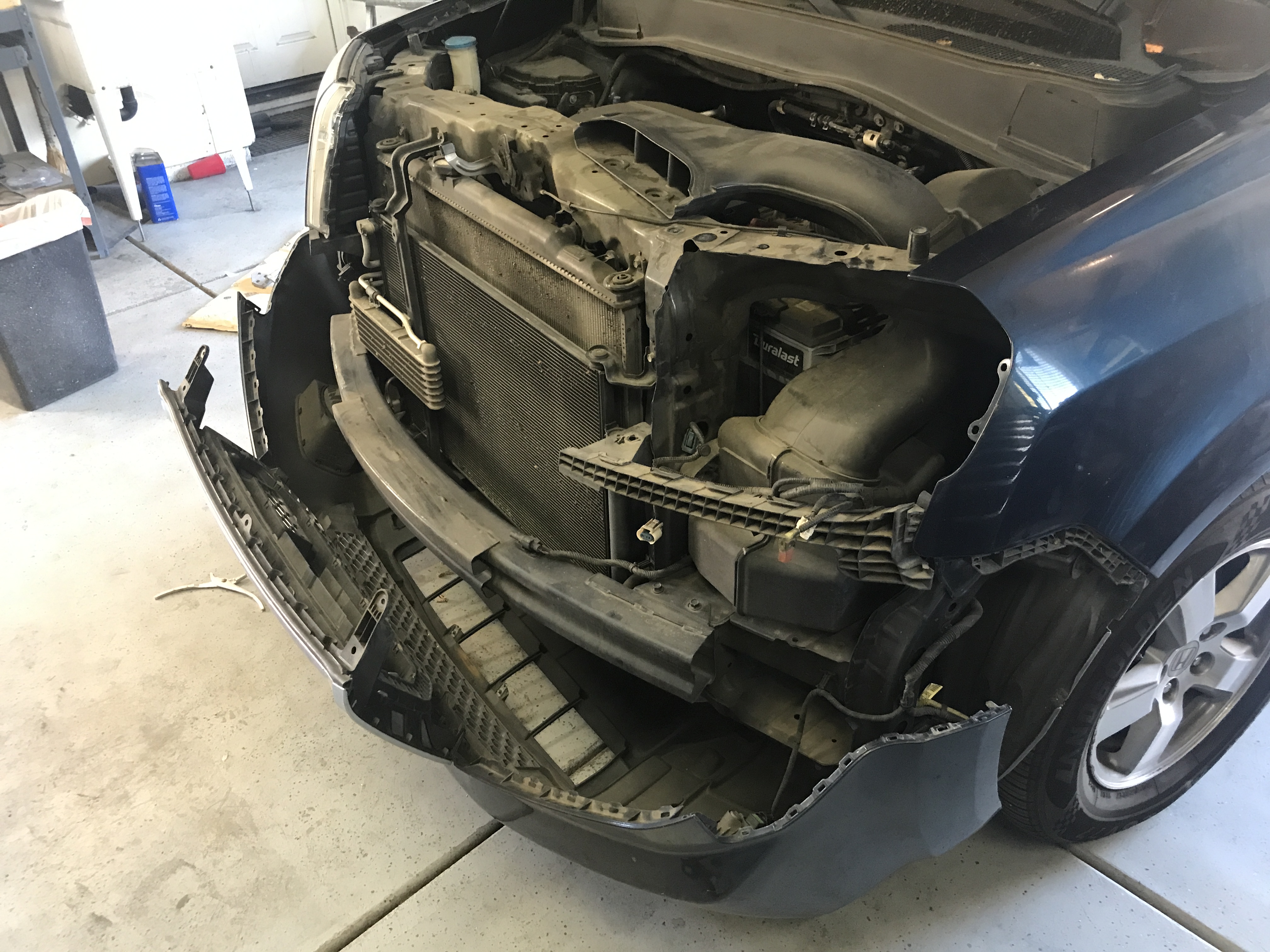

not a truck update but just letting you know what's been keeping me from updating, apparently my wife's love language is "making me do shit" so here I am finally replacing the headlight on her 2010 Honda Pilot, YES the front grille and bumper have to come off first, you read that right
P.S.Mangelsdorf
- Posts: 1230
- Location: Raleigh, NC, USA
- Has thanked: 323 times
- Been thanked: 352 times
I feel your pain.Gregski wrote: ↑Tue Oct 25, 2022 2:24 pm not a truck update but just letting you know what's been keeping me from updating, apparently my wife's love language is "making me do shit" so here I am finally replacing the headlight on her 2010 Honda Pilot, YES the front grille and bumper have to come off first, you read that right
My father's previous truck, an '09 Sierra, called for the same thing. Turned out if you were a determined and dumb teenager, and didn't mind ending the experience bleeding, you could juuuussstttt barely squeeze your hand in to change the bulb with the vehicle still assembled.
My V6 Challenger takes the cake though: to change the plugs and coils, you have to pull the intake manifold. To get longer runners they laid the intake over and it completely covers the driver's side head.

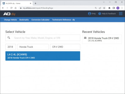

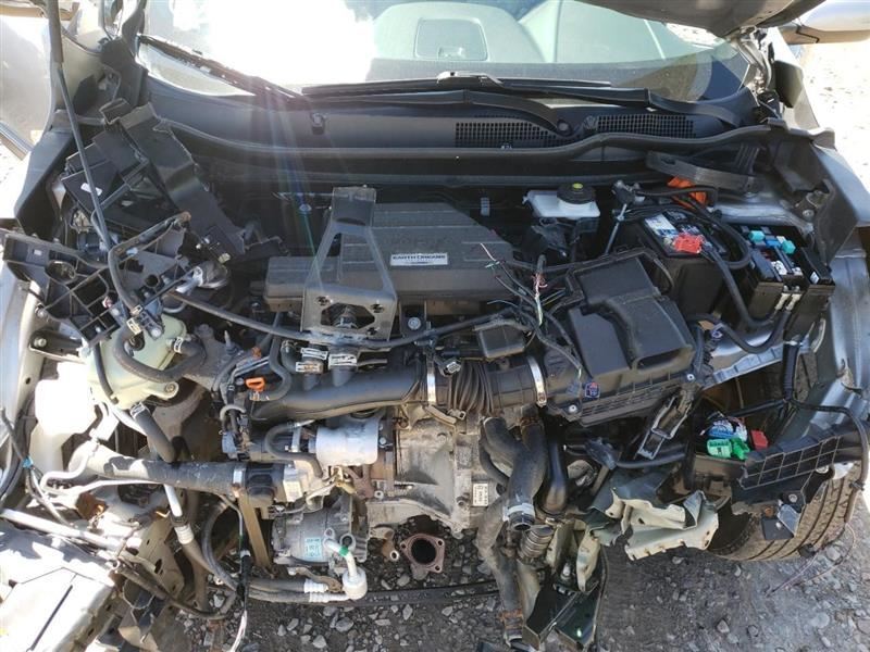

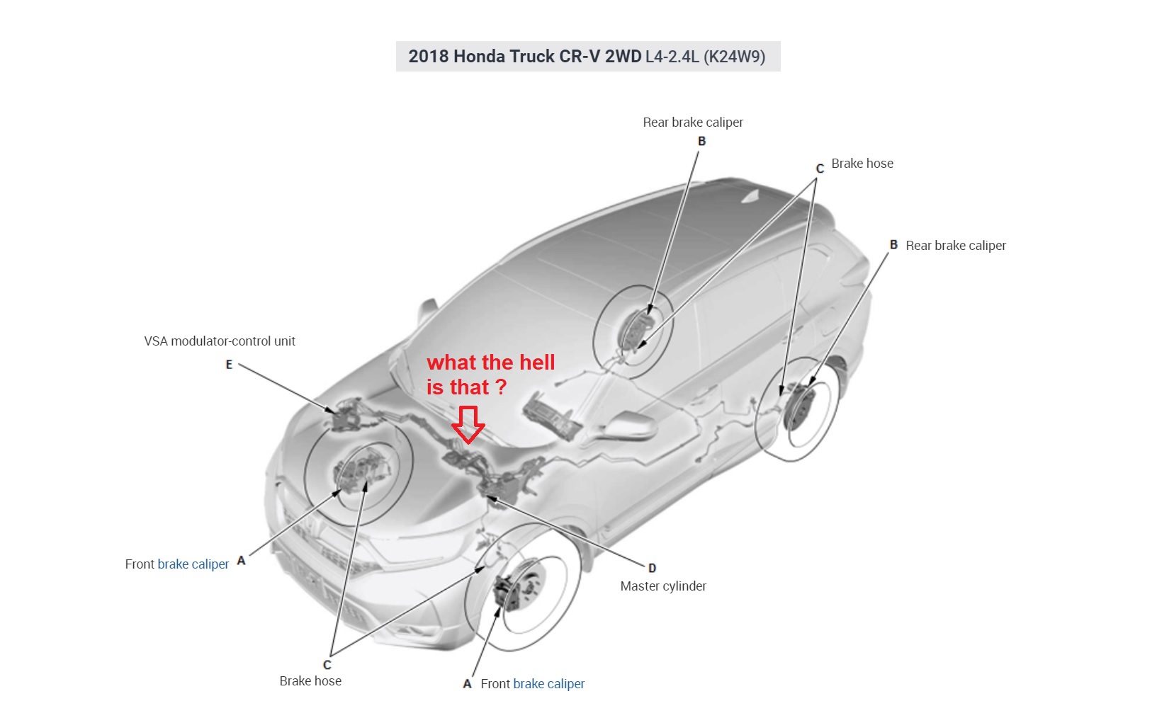

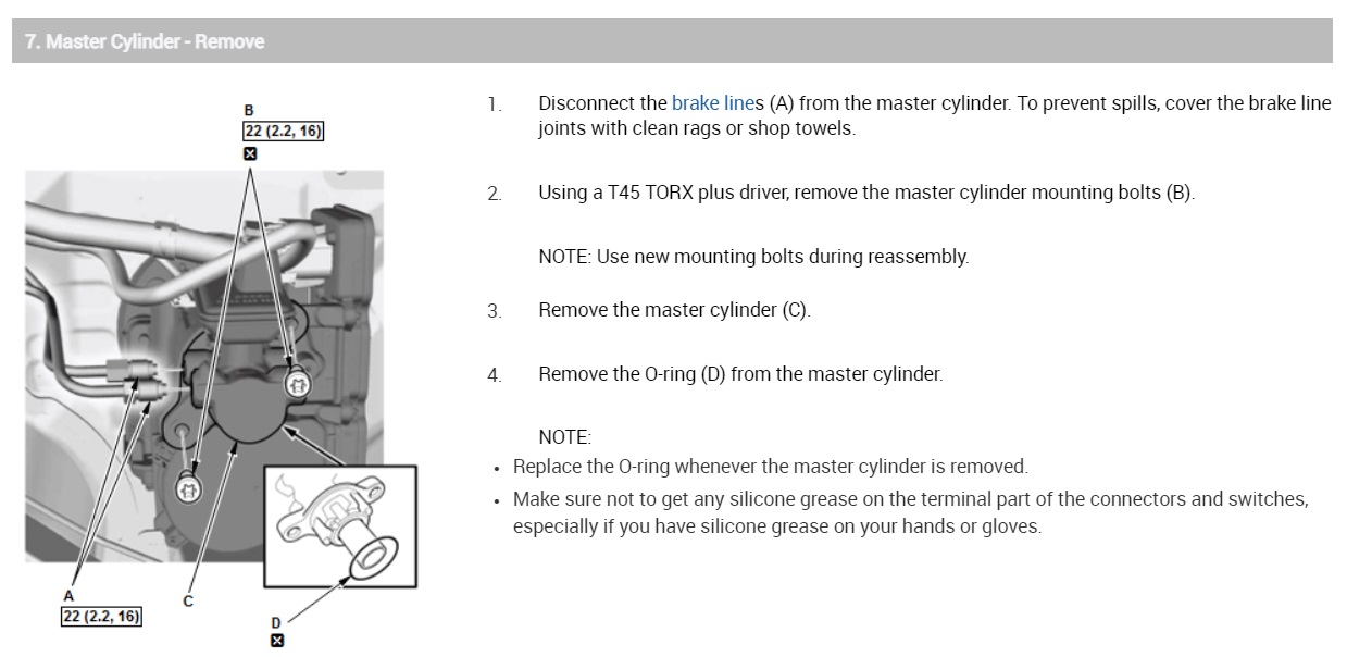

so here we go taking another one for the team, I just subbed to one months worth of ALLData for a 2018 Honda CRV hopefully we can learn more about this master cylinder iBooster thingie
if anyone here speaks Honda I would really appreciate a translation of E. VSA modulator-control unit
and this is the closest we get to a label for the two brake line ports

respectfully...
P.S.Mangelsdorf
- Posts: 1230
Is it the ABS solenoid module?
- Gregski
- Posts: 3164
ah yes, of course looking at an actual picture under the bonnet and it's clear as mud
- Gregski
- Posts: 3164
I appreciate you trying to help, I am knee deep in acronyms at the minute, I even had to Googlenate "VSA"
Vehicle Stability Assist
VSA stands for Vehicle Stability Assist. It helps to keep cars handling correctly during cornering, particularly if the system's sensors detect understeer or oversteer. It's especially useful when different wheels have different amounts of grip, a situation that would normally lead to skidding or plowing.
What is the VSA modulator control unit?
[Greek] The VSA modulator-control unit checks the pump motor operation during regular diagnosis when the vehicle is driven over 15 km/h (10 mph) the first time after the ignition switch is turned ON (II). You may hear the motor operate at this time, but it is normal. [/Greek]
P.S.Mangelsdorf
- Posts: 1230
ABS: Antilock Brake System. It looks like the mystery item is right where the brake lines split up, which is where I would expect the solenoids for ABS would be.Gregski wrote: ↑Tue Oct 25, 2022 11:13 pm I appreciate you trying to help, I am knee deep in acronyms at the minute, I even had to Googlenate "VSA"
- Gregski
- Posts: 3164

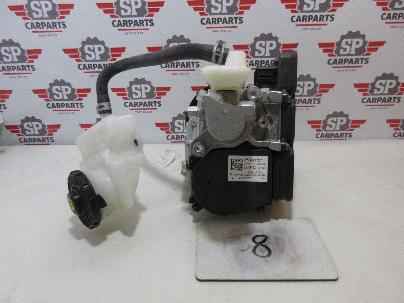

great looks like now I need to hunt down the remote reservoir for this iBooster animal
looks like this
looks like this
- mjc506
- Posts: 343
- Has thanked: 30 times
- Been thanked: 29 times
Looks like it's 'only' a brake reservoir?
Motorcycle reservoirs will probably fit the hose fine, but might be a little small.

its just a reservoir, a little tank and a hose is all you need. or put a different MC on it, like i did. I turned some aluminum on my lathe to make an adapter to mount a Subaru MC onto a chevy volt ibooster

thank you for the suggestion
so the VSA is going to be monitoring things like wheel speed, yaw, steering angle, and acceleration. It will then tell the ABS modulator which wheels to apply braking force to. this is per wheel braking force intended to counter act the unintended rotation of the vehicle around the y axis. a spinout if you will. the silver box with the can on it that has two or more lines coming in from the master cylinder and 4 going out is the ABS modulator. it will pulse the brakes on all 4 wheels at the same time or independently based on input from the vehicle. Traction control(wheel slip), stability control(spin out) and antilock braking all use braking force as part of their control inputs to perform their respective functions. That ABS modulator is just a smart distribution valve for braking force. it can be deleted if you only want breaking assist from the ibooster. a good proportioning valve is recommended for front/rear break force distribution though.
In EVs that ABS modulator performs and addition function. The vehicle monitors brake pedal travel as reported by the ibooster, and compares that to the amount of regen braking available. if the pedal travel corresponds to an amount of breaking force that is within the capability of the edrive then the car will tell the abs module to feed the pressure back into the ibooster in its return loop thus negating the breaking pressure in the hydraulic system. as the braking request from your foot increases the car will tell the car to increase the hydraulic pressure in the break lines by closing the return loop. thus blending hydraulic and regen braking. until you come to a complete stop and all stopping force is transferred to the hydraulic system.
edit:
it looks as though the VSA modulator is what I was calling the abs modulator. your mystery component looks to be some kind of junction block where the 4 lines coming off of the VSA modulator split off and go to their specific wheels. Ill have to go out and look at my Clarity to see if I have one of those. it may be a packaging requirement on the CRV that is not really necessary. its possible that there is a separate abs solenoid apart from the VSA modulator that handles the abs functions. though i was under the impression that the VSA module handles both ABS and VSA functions
edit:

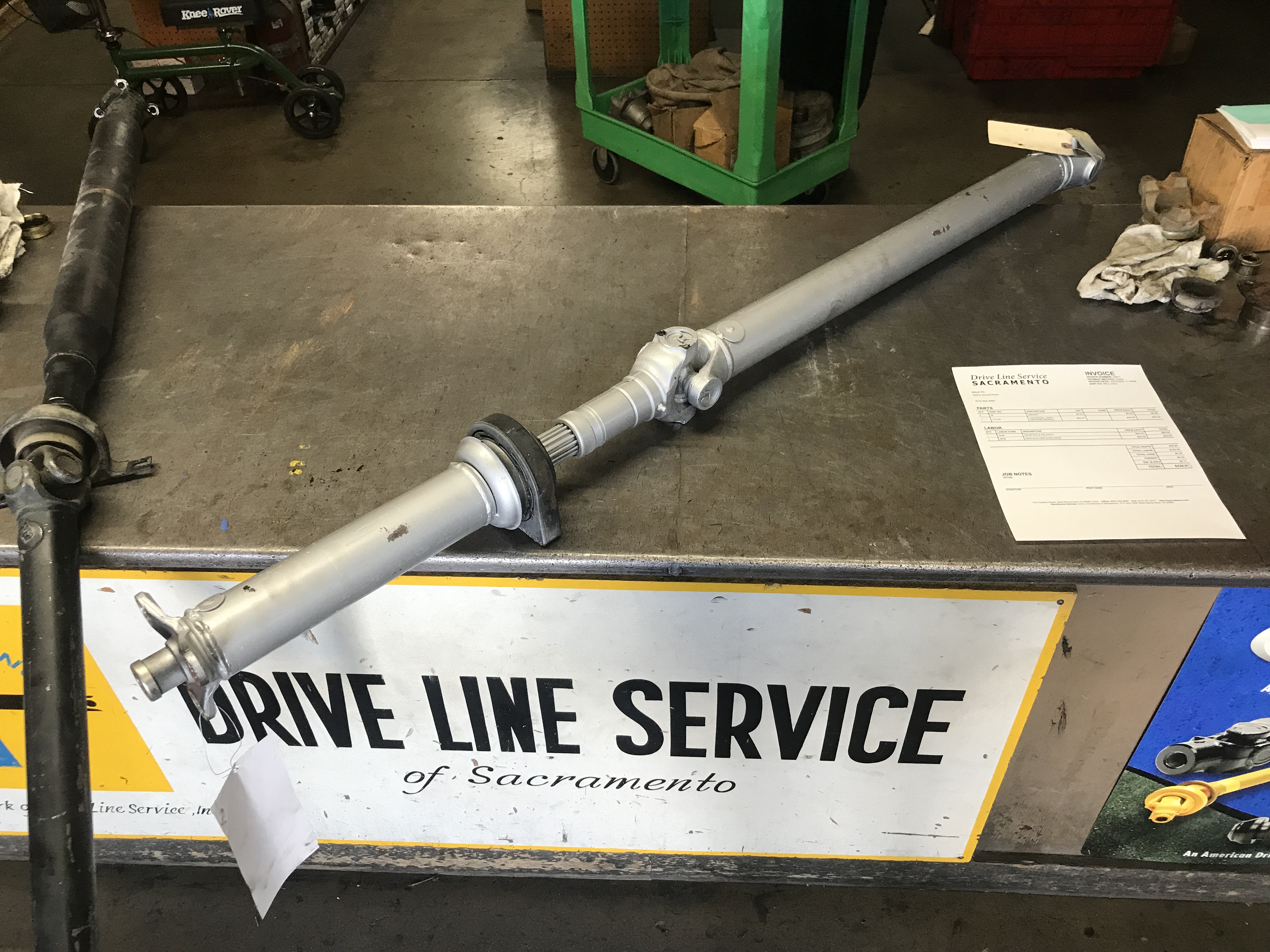

how I dropped off yet another drive shaft for shortening and monkeyfication
[ after taking it down to bare metal, primering it, then painting it BLACK like the truck gods intended ]
how I picked it up [ this time it's personal, lol ]

That looks nice, definitely hurts they changed the color on you.
