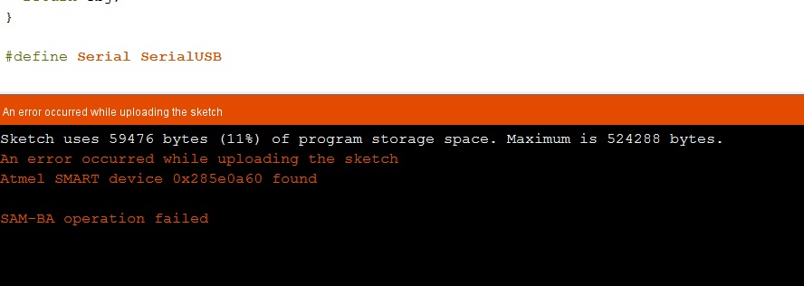

No if i remove power and add it i still get bossa programming port on com16
Also i dont get any CAN comms on either port. Should that mean flash is frozen? How to untangle this?
EDIT: I get this when i try to upload sketch
Send auto-baud
An error occurred while uploading the sketch
Set binary mode
readWord(addr=0)=0x20001000
readWord(addr=0xe000ed00)=0x412fc230
readWord(addr=0x400e0740)=0
readWord(addr=0x400e0940)=0x285e0a60
version()=v1.1 Dec 15 2010 19:25:04
chipId=0x285e0a60
Connected at 115200 baud
SAM-BA operation failed
Atmel SMART device 0x285e0a60 found
write(addr=0x20001000,size=0x34)

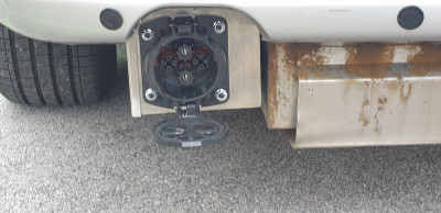

Finally the fruits of my labour...
I mounted the box to the place of exhaust. Self sustained no power from the car required. Apart from solid GND. I intend to test this a bit. In the end i will probably add CAN line to BMS for protection.
I intend to simply use a heartbeat telegram similar to Outlanders 0x285 to keep chademo operating. If that would be missing VCU would stop.
Edit: that rust does not belong there
. I guess there is no inox welding wire. I have to sort it out before winter.

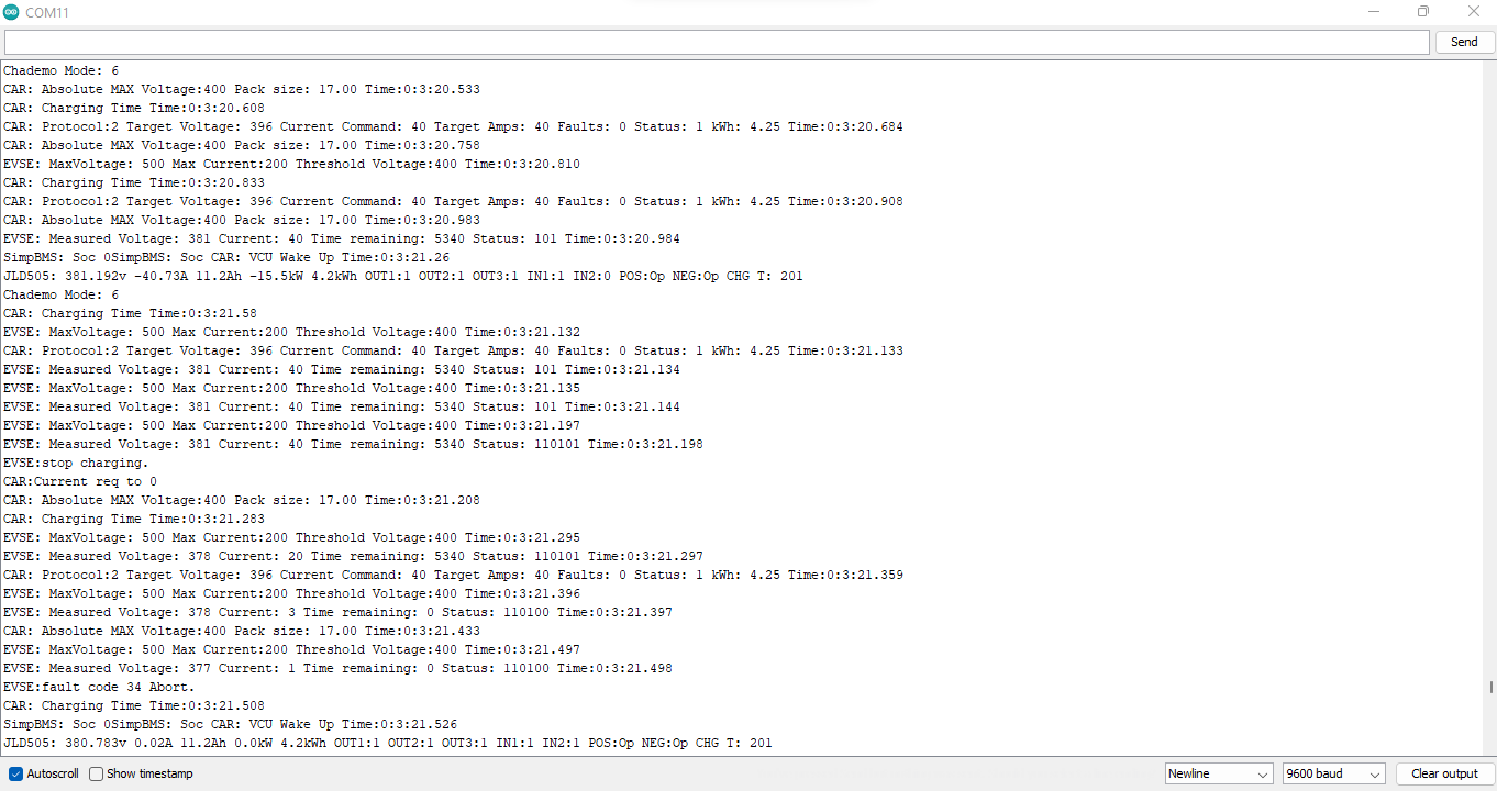

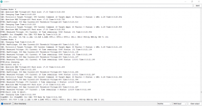

Hey Guys, I've set up a due with bigpies shield in the wiki. Testing on a nearby charger it stops charging after almost exactly 2mins every time I test it. Its a Tritium PK350 "ultra rapid charger". Has anyone else had a similar issue? I'm Planning on testing on the next closest station tomorrow, unfortunately its 40km away
Attached is a screenshot of when it stopped.

Which version did you use? V1 had a few mistakes that needed correction:D
If V1, R4 needs to be a solder bridge, R7 needs removing. IN2 needs a 1k pull up to 3.3v adding too. I've also changed IN2 to use pin 5 vs pin 6 as I've blown pin 6 on my due.

Using V2
The charger stops at exactly 2mins everytime, I'm thinking a compatibility issue. I'll get a CAN log over the next few days.
One thing I found on the V2 board is the 3v3 wasn't connected to the can transceivers, The traces are there but a through hole is missing to join them. Great job on the board though, it's a neat little solution.

Doh, I'll update that, I've not actually got round to ordering v2 boards yet
. A can log would be good and also if you do DBG=3 before starting it'll spew out more info too.

- Posts: 3562
- Has thanked: 134 times
- Been thanked: 335 times
While i was charging at 100A my battery filled up fast and voltage raised to VMAX value of 390Vdc.
There Chademo stopped charging and shut down.
Immediately voltage droped and i was left with some 76% at 378Vdc.
This just wont do! I want to be able to have some current tapering at least at the last 10% of charge.
So i went to study the code and inside chademo.cpp file i found the routine to transmitt askingAmps parameter within CAN telegram.
Then i inserted a conditional to observe voltage and reduce askingamps when voltage would get above preset value.
I set minimal amps to 20A for testing.
I had some problems with parameter declarations and i decided to keep the old parameters and condition them by some parts.
I will let you know how testing goes tomorrow...
if (Voltage > (settings.targetChargeVoltage - 2)) {
askingAmps == settings.minChargeAmperage;
- Posts: 3562
Crap! I couldnt get any reduction at EVSE with previous code.
I will try with direct values.
@isaac96 could you elaborate how could we taper down charging by reducing amps in mid charge?
tnx
tnx
