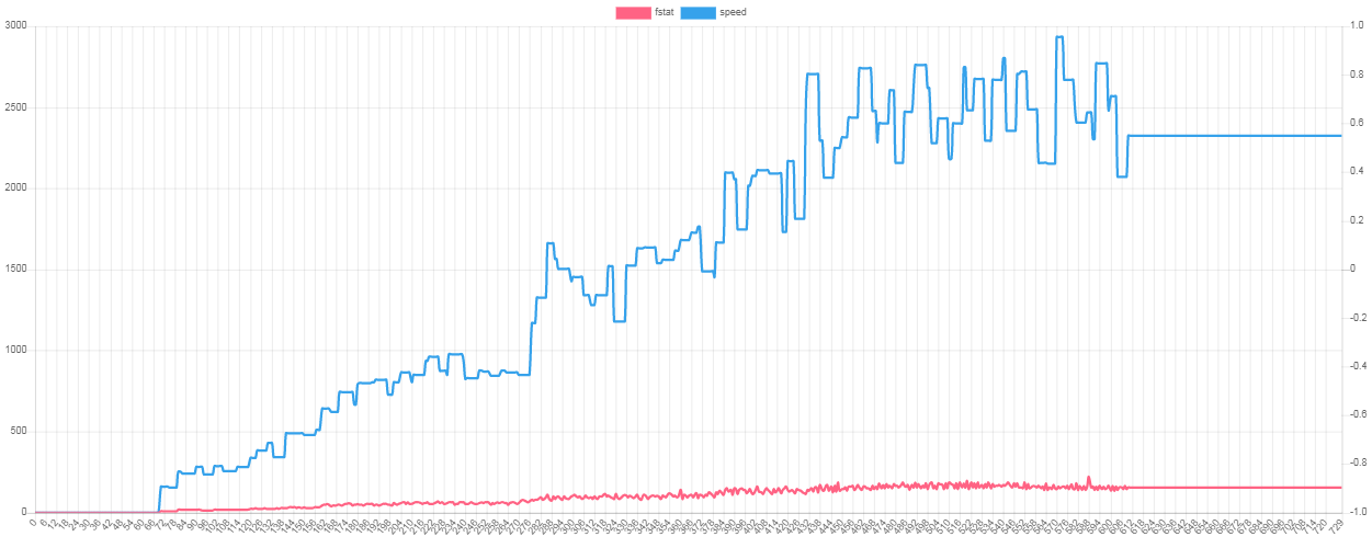

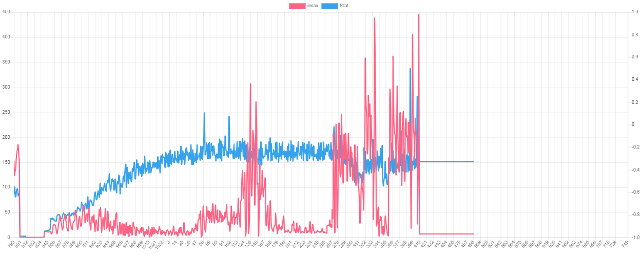

I have tested the other motor in a car with the same inverter. In fact i just replaced my board for his.
He has 200Vdc.
I performed offset calibration and it seems best setting is just 28000 wheras my motor offset is 27000.
Then i tried to turn motor with force.
I used one tire in the air and tried to turn it like a flywheel.
I applied parking brake and hold it to create friction.
I tried to move the car inside garage.
Facts:
1. We have to replace phase cables because car wants to move backwards
2. When torque is applied motor will turn up to some 2600RPM and not more. I tried to force the weakening and i got some 450A phase amps and OClimit, even though i had it set to 600A! Well just before it went out of scope i could hear motor straining and function wasnt sine anymore.
3. I took some shots of RPM plot and Hz. It seems motor consumes some 16A at 200Vdc max for 2500rpm. But at that rpm amps can be at 450A!!! What logic is that? I expected it would stabilise and raise voltage with RPM. I even expected for the speed to go towards 4000RPM at 200Vdc.
If you observe the first plot there is RPM and Hz. You can see when something tripped at 2300rpm.
Second plot observs max current and rpm. I had some success in getting more rpm from weakening. You can see when OClimit tripped and consumption went up.
hird plot is about Hz and max amps. Again observe where amps go up to 450A and inverter starts to whistle. Then OClimit.
