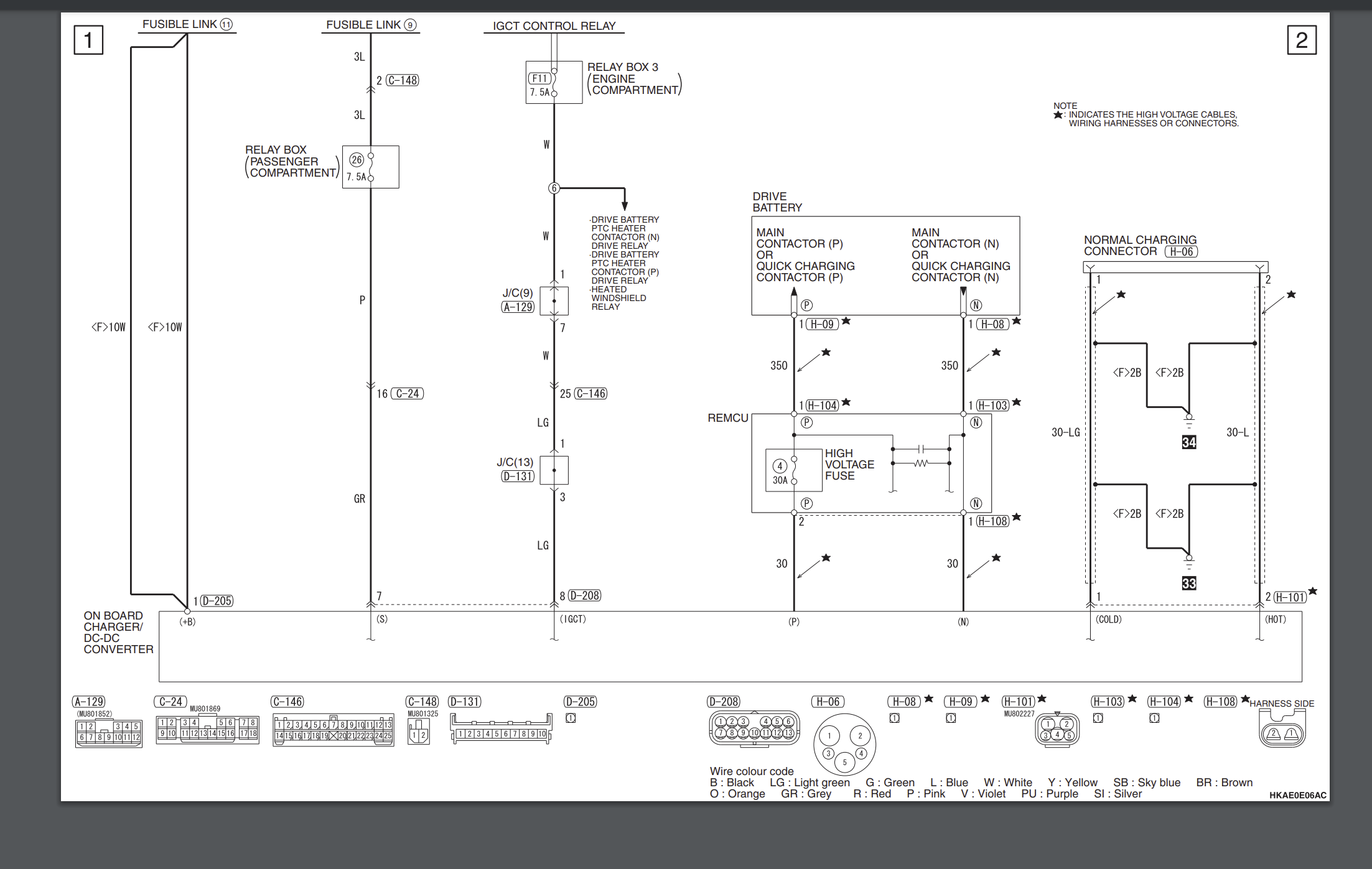

aot93
Posts: 198
Location: UK, West Sussex
Has thanked: 6 times

On my charger Senses wire is pin 7, Green cable going to the charger,
12V IGN pin 8, Yellow cable.
Enable is on 4 - Grey Cable

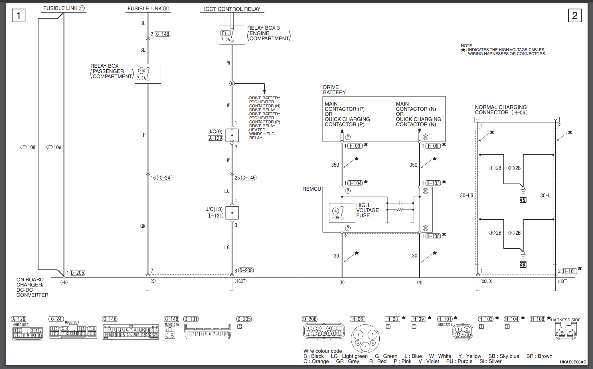

What sort of wiring diagram are you looking for?
I've posted the OEM wiring diagrams only a few posts up.
The Wiki page also has all the relevant info.
If you want to see an example of how I installed the charger in my conversion my diagrams are here:
https://oshwlab.com/aot93/mini-e-wiring
this is the relevant part:

I am sure you are capable enough to make it start. Considering you already put your car together...
Outlander wiring diagram is on this thread, second post or maybe this one https://openinverter.org/forum/viewtopi ... 8566#p8566
Well the thing is DCDC and charger are one unit. They use single CAN control unit both. Also you need to connect 12V battery to DCDC for more comfortable experiments. Your 12V GND needs to be connected to charger case!
Also have HV connected to charger. I think the lower limit is 200Vdc, the upper is 400Vdc.
1. connect pin10 to GND
2. You supply wire on pin7 to 12V battery positive terminal to sense DCDC output.
3. Connect pin4 to 12V to start DCDC
This makes DCDC to turn on. No need for CAN bus
To get charger to work you need a combination of specific CAN telegrams
4. connect Pin8 to 12V to start charger logic
5. Provide a CP signal - 1kHz PWM at 25% duty - to Pin9. Normaly you just connect EVSE CP line here.
6. Provide CAN telegrams to start charger at 500kbps
a) enable telegram x285 at 30ms
b) charge request telegram 0x286 at 500ms
When integrating with DUE i use EVSE PP pin to pull down a specific pin on DUE and signal start for CAN telegrams
It is all written in this thread and on the wiki. From now on i will just refer to here...
https://openinverter.org/wiki/Mitsubish ... r_DCDC_OBC
https://leafdriveblog.wordpress.com/202 ... ger-tests/
https://leafdriveblog.wordpress.com/202 ... -parallel/
https://leafdriveblog.wordpress.com/202 ... e-control/
https://leafdriveblog.wordpress.com/202 ... l-part-ii/
dadiowe
Posts: 112
Joined: Fri Sep 17, 2021 6:11 pm
Has thanked: 41 times
Been thanked: 19 times
Re: Mitsubishi outlander charger and DC:DC
Post by dadiowe »
Thank you guys for your help. I now have a basic charge system working.
Having re-read my post I can see that I did not make it clear that the pin connections I was unsure of were to the Arduino Due Shield
I will be using the Thunderstruck BMS to keep an "eye" on the charger and hope to be able to charge my 108s VW ID3 to as I understand it the maximum the charger can put out of 420v.
