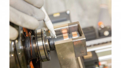

Yes, the Zoe motor has a pair of sliprings.
I found an image of the Zoe motor on the Speak EV forum. There have been problems with the brushes, notably with carbon dust causing current leakage to the frame. The early Zoe at least, used the motor as part of an AC rapid charger (up to the 43kW limit of the type 2 connector with 3 phases) and the leakage prevented charging.

Thank you SciroccoEV. Good photo of the rings
. One set of problems that can happen with induction motors is unwanted current flowing through the bearings causing havoc to the hard coating on the ball bearings, to solve that, if this problem can occur they insulate bearings at both ends of the motor. Here we have the potential for carbon dust to earth one of the bearings.(if I remember rightly, this can occur if there is a bit of zero sequence current flowing).

You only need to insulate one bearing to prevent the rotor and stator forming a single turn shorted winding. Many of the references to this problem hark back to the early variable frequency drives with a 16 step waveform and low PWM frequency resulting in lots of harmonic content.
