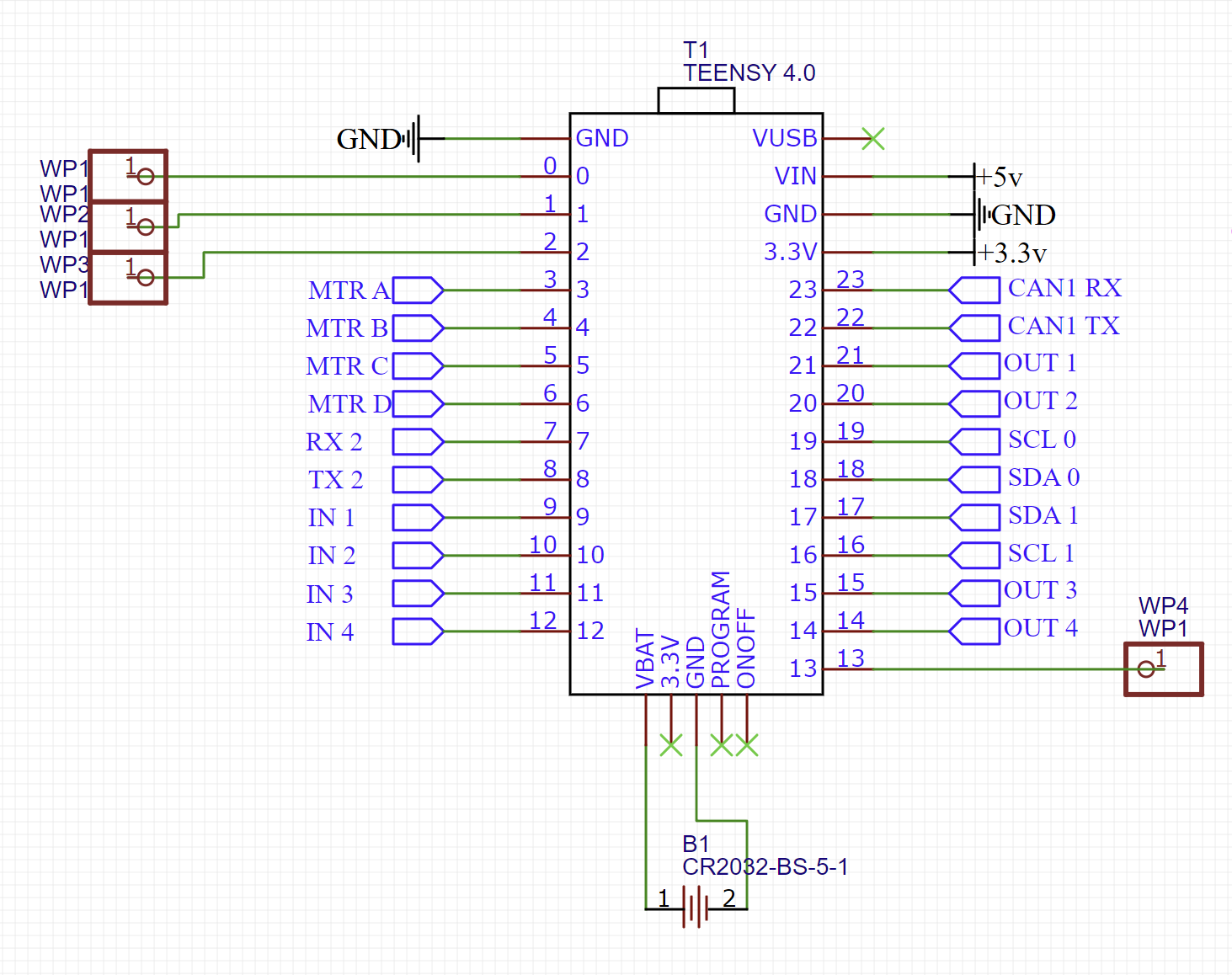

On the dash controller - what’s the need for connecting to the tiny 3v3 pad under the teensy? Does this just boost the strength of the 3v3 signal?

From looking at the schematic and pcb layout I don't think it needs to be connected. It's an internal connection on the Teensy board and should really have a different net name, so that it does not get connected on the main pcb.

There should be no requirement to connect to any of the underside pins.
Unless you are looking at the VBatt which is used for the clock.

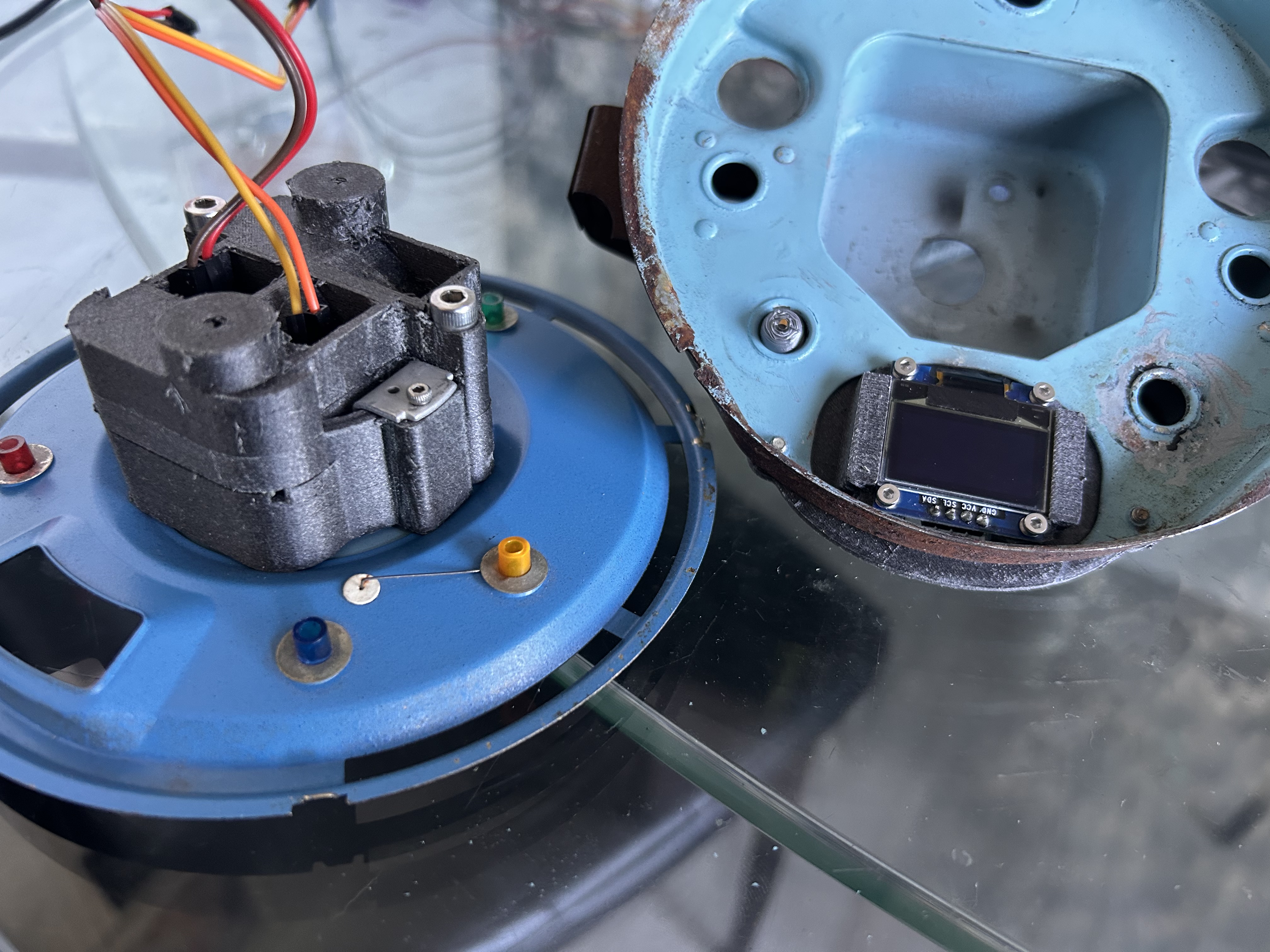

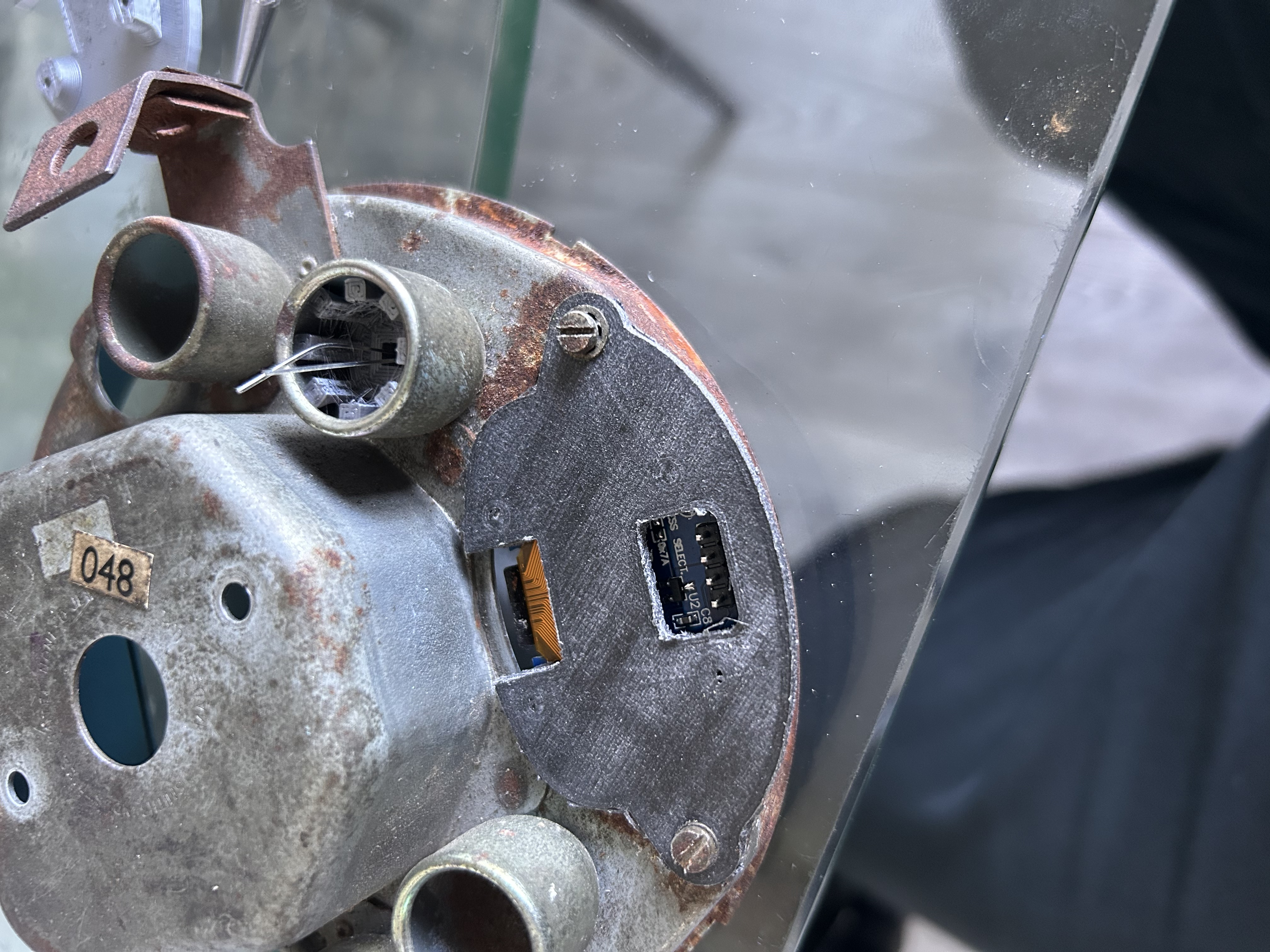

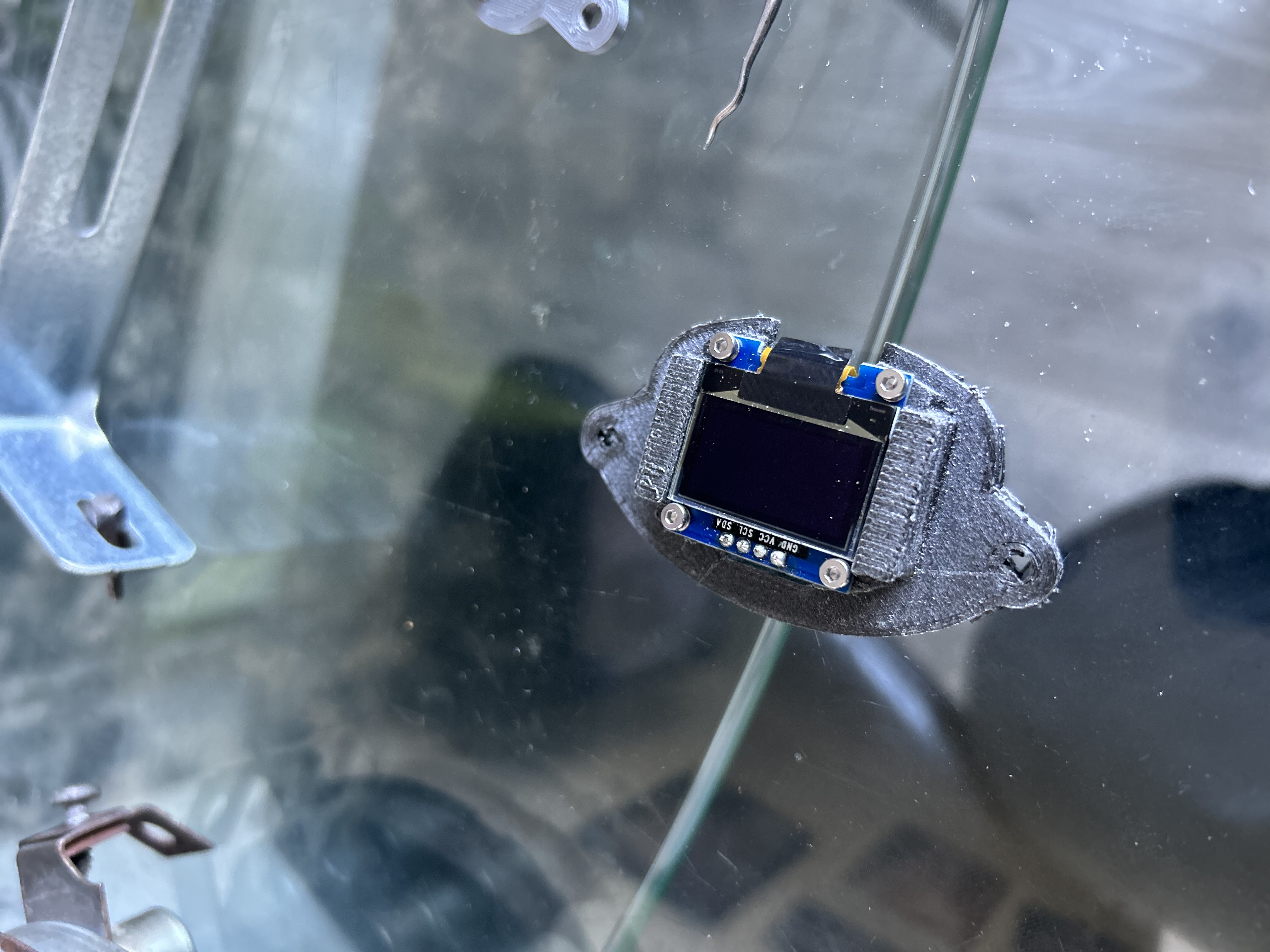

I’ve been playing with the dash control pcb and code to give us something more in keeping with the original Mini Speedo - @Tom91 helped with the code changes to suit his VCU but the PCB is still as @aot93 designed. I’m on my 3rd set of prototypes to mount the displays and stepper motor and it’s nearly there I think!

Nice, I think those little oleds look really good in the original instrument.
A tip if you get erratic needle behaviour is to edit the acceleration tables in SwitecX25.cpp the following values worked for me:
