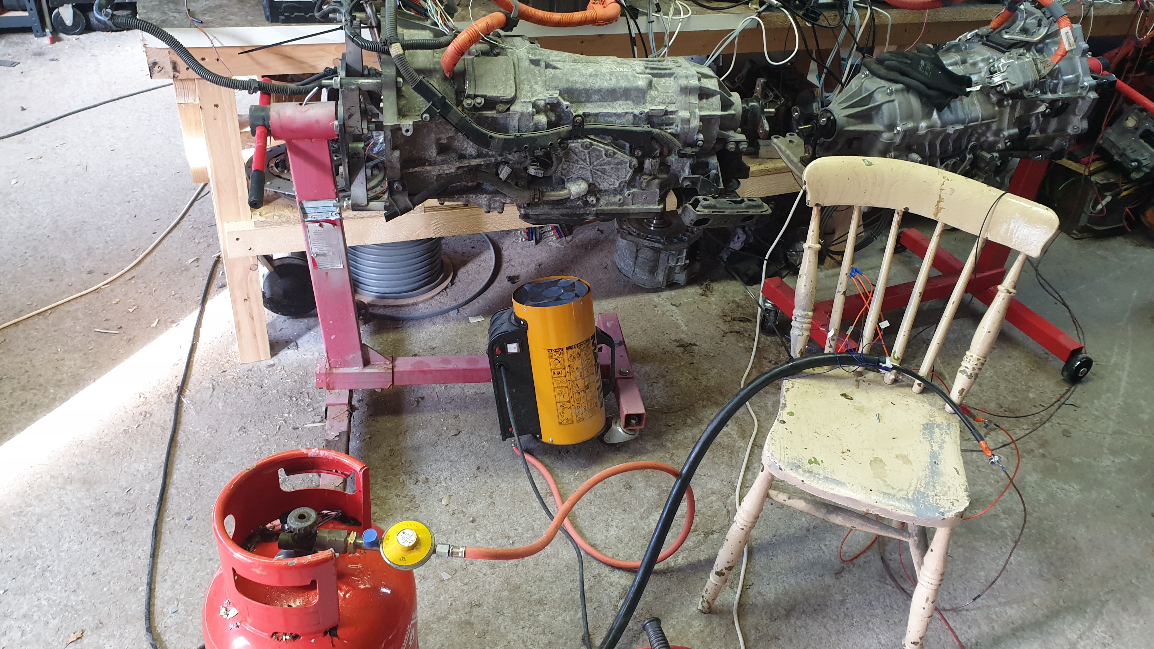

Today I tackled two big missing Gs450h items : MG temp sensors and gear shifts. Decided to take the simple approach of a best fit line for the temps rather than a lookup. Fitted a thermocouple to the top of the gearbox case and took an inital value. Then ran the motors and oil pump and applied gentle heat:) until 50C on case of gearbox. Heat off and overshot to 51C. Then log temps on way down. Of course its not accurate etc etc but some indication of stator temps is better than none. As the winter rolls in and temps drop I'll add more data points and improve the trend line.
Shifting with a torque cut is working well on the bench rig but I do have a lot of other projects calling me right now so will probably break away from this part for a while until I have a car available for some real tests. I've attached the spreadsheet for the temps. All done with 150k bias resistors in R43 and R35. All future vcu boards will have these parts modified. Interestingly it looks like the sensors in the GS300h are the same or very similar.

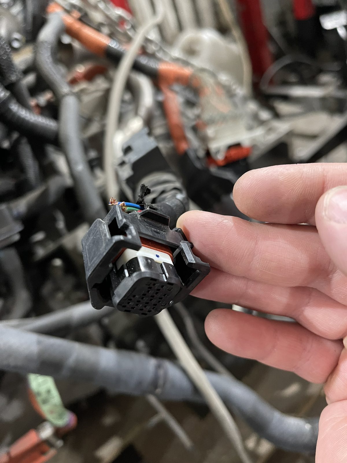

]Hello. Tell me the pinout of the connector g9266-47010 please. I need to understand what color and where what wires.
