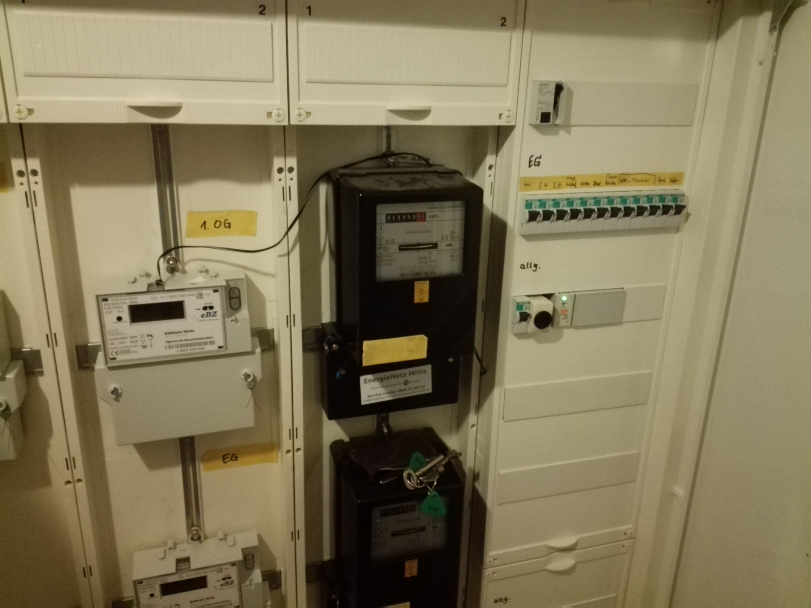

To start out we first need to know the energy flow from/to the grid. I had tried openenergymeter in the past but it was very inaccurate, I found it hard to use and also it required a Raspberry PI to run 24/7 which defeats the purpose: conserving energy.

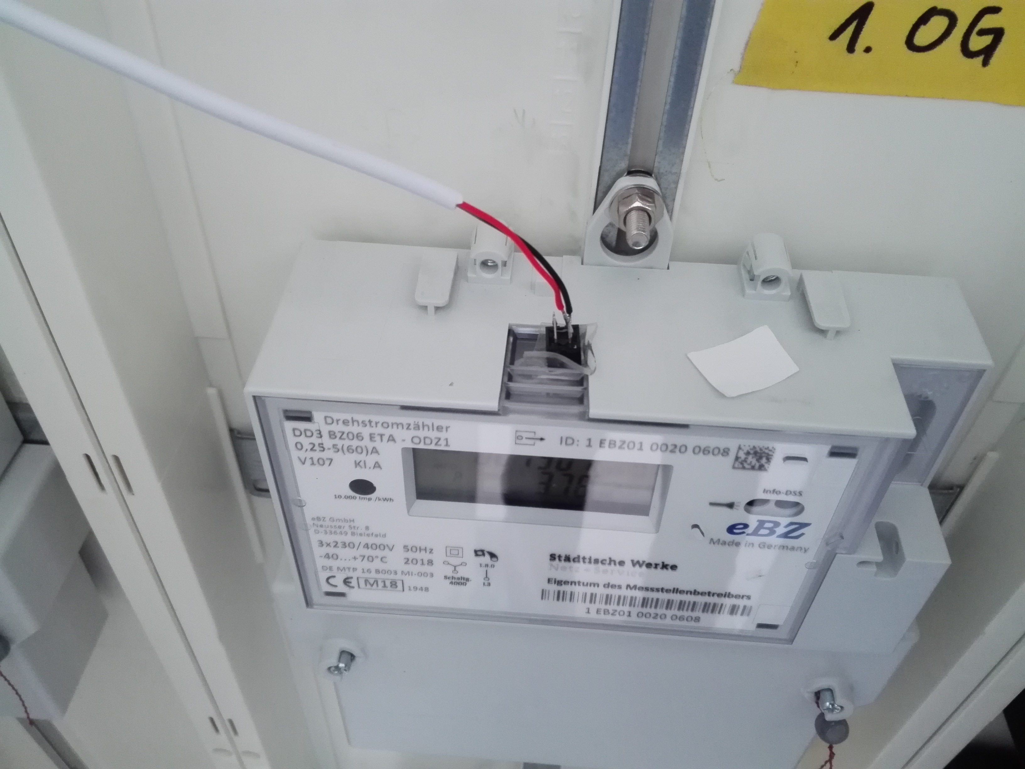

So I researched my existing utility energy meter a bit to find out it actually outputs a serial data stream via infrared (apparently the format is called SML).

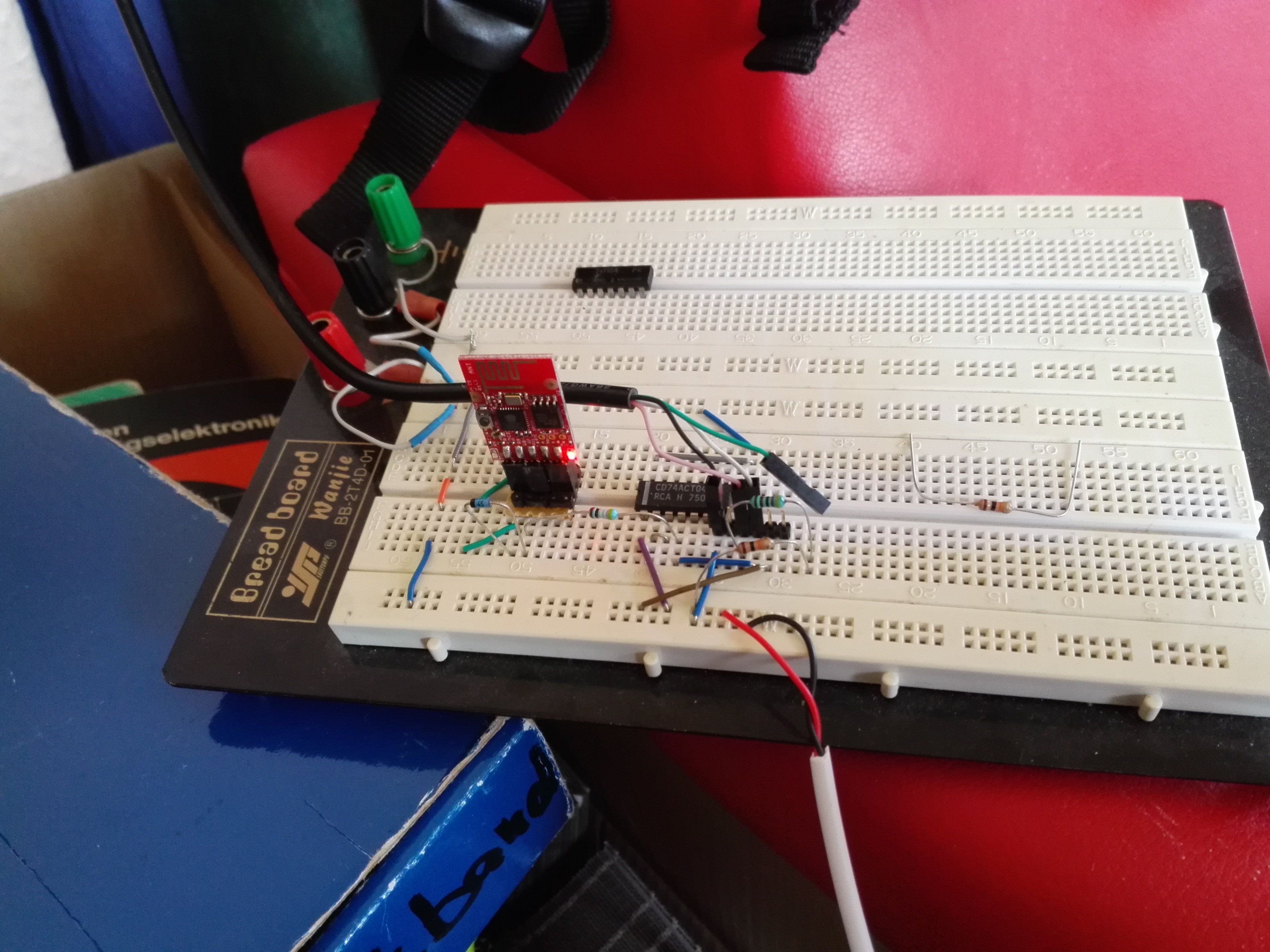

I started out with the physical layer. I mounted one of these reflective encoder heads (left over from Polo project) which essentially consists of an IR diode and a photo transistor. The diode is NOT needed! Nothing needs to be requested, the meter just dumps out the info every second.
Ok, the photo transistor needs 15k pull up (47k makes it too slow, 10k gives too little amplitude). Since the waveform looks rather distorted we feed it through a logic gate, I just use two inverters 74ACT04.
Then it goes to the ESP via a 470 Ohm resistor to RX. RX is connected to 3V3 via a diode to level shift the 5V to a 3V3 signal.

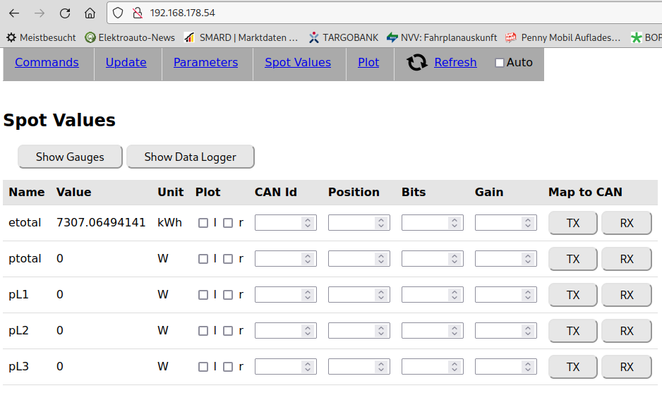

Next we need to write some Arduino C++. Little surprise I took the inverter sketch and modified it. Serial interface runs at 9600 7E1 (first time I see parity used).
Soon had some output

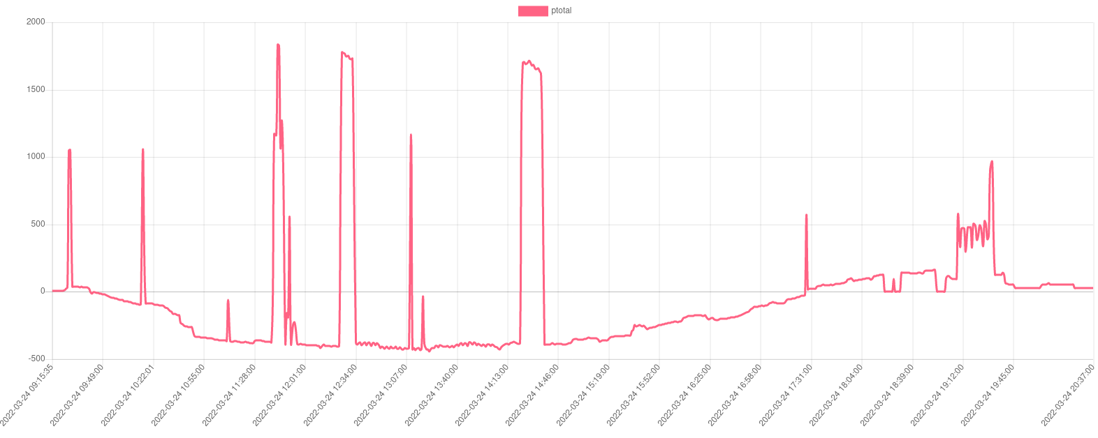

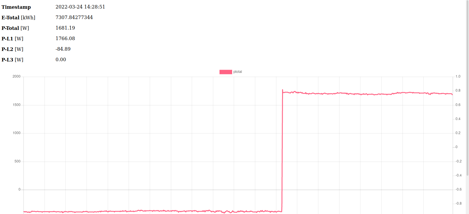

Now went off on a tangent and decided to record that data to a mysql database. That allows more systematic analysis.
So now have a 1-second updating web page

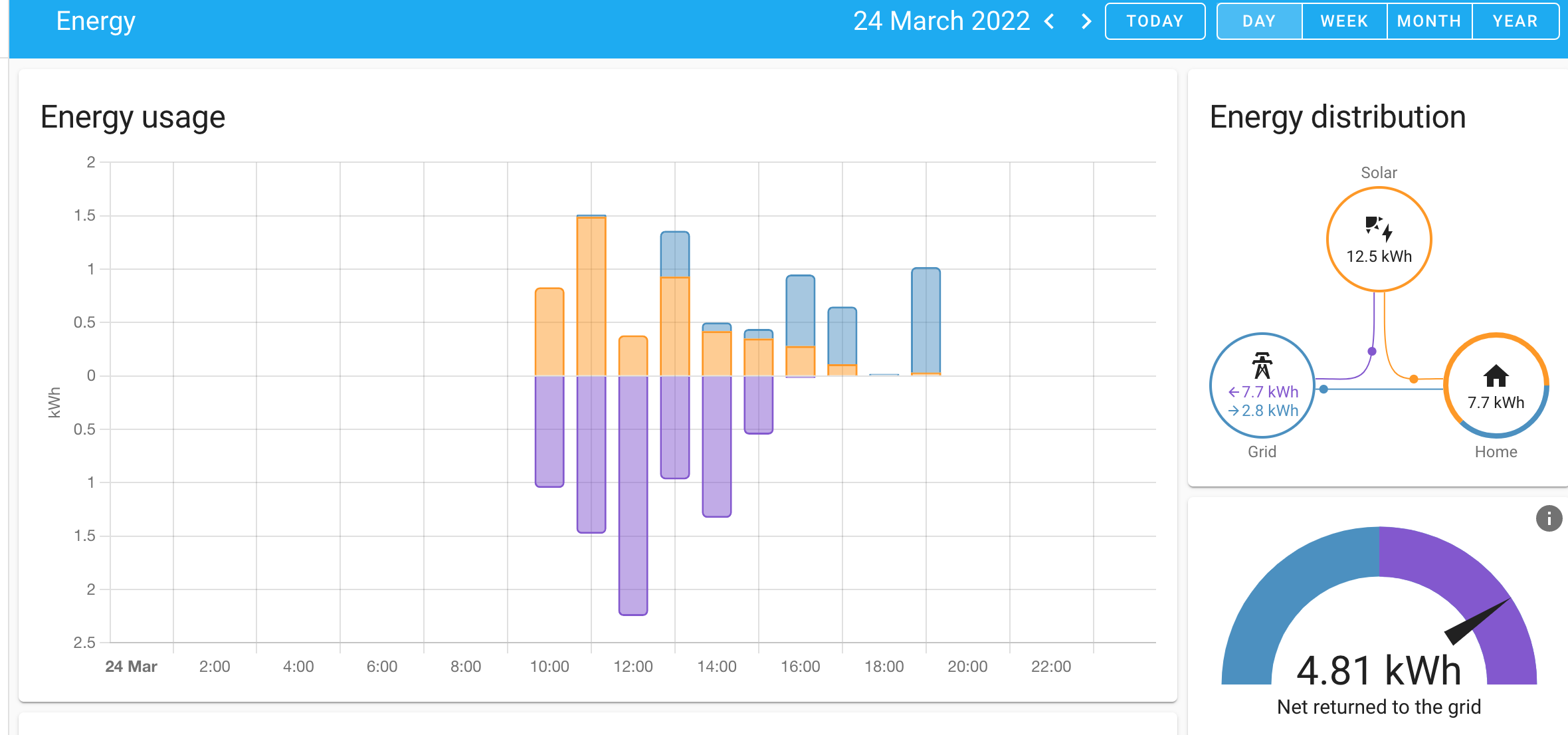

And a daily overview
Everything below 0 means we're exporting to the grid. Some number crunching later I found I "lost" 2 kWh today.
Decided to not run 10m of wire through the public stair case, below our apartment door and onto my desk. So put everything into a DIN rail enclosure next to a DIN rail 5V supply. Pretty huh?

It doesn't have any (accessible) electrical port, just IR ones

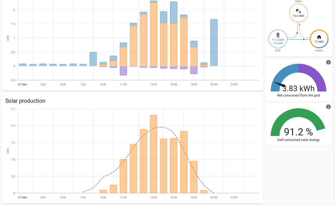

Im on this journey too , im using a shelly energy meter with assistant and bought an smart evse to dump the excess energy into the car. Only caveat is that min 100% solar mode is 6a but you can blend say 50% with grid by starting charger at 3a of export as its the same price as night rate for me. One crazy option is to use a transformer to reduce voltage to 100v for better resolution as car charger sports that voltage. My next development is to use an ac coupled storage inverter(sunny boy sb storage) with a ev battery then integrate it by chademo v2g mode. Currently just got a can capture of a compatible battery used with inverter to test.

paaa wrote: Sun Mar 27, 2022 8:57 pm My next development is to use an ac coupled storage inverter(sunny boy sb storage) with a ev battery then integrate it by chademo v2g mode.
Those Sunny Boy Storage inverters look pretty good, I want one :D Do you need other sunny boy equipment (home manager/meter)?

You need a sunspec compatible meter , I bought an elgris smart lan meter and it seems to par just fine. Its not cheap at about 180e but much cheaper than any smaller ones. Later on im hoping to just use an open source design of an ease meter that supports rs485 already to replace it. but that's a long way away.

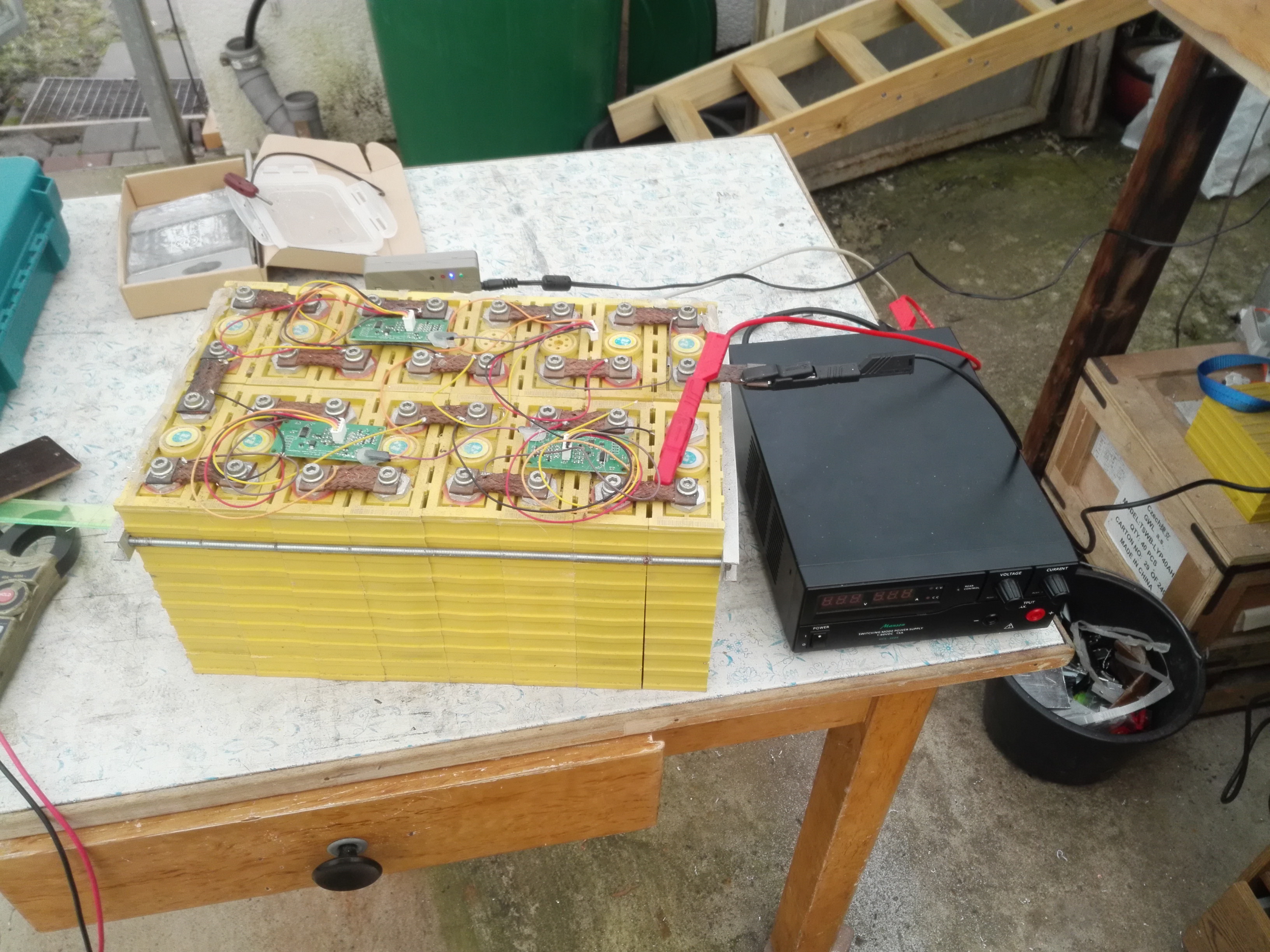

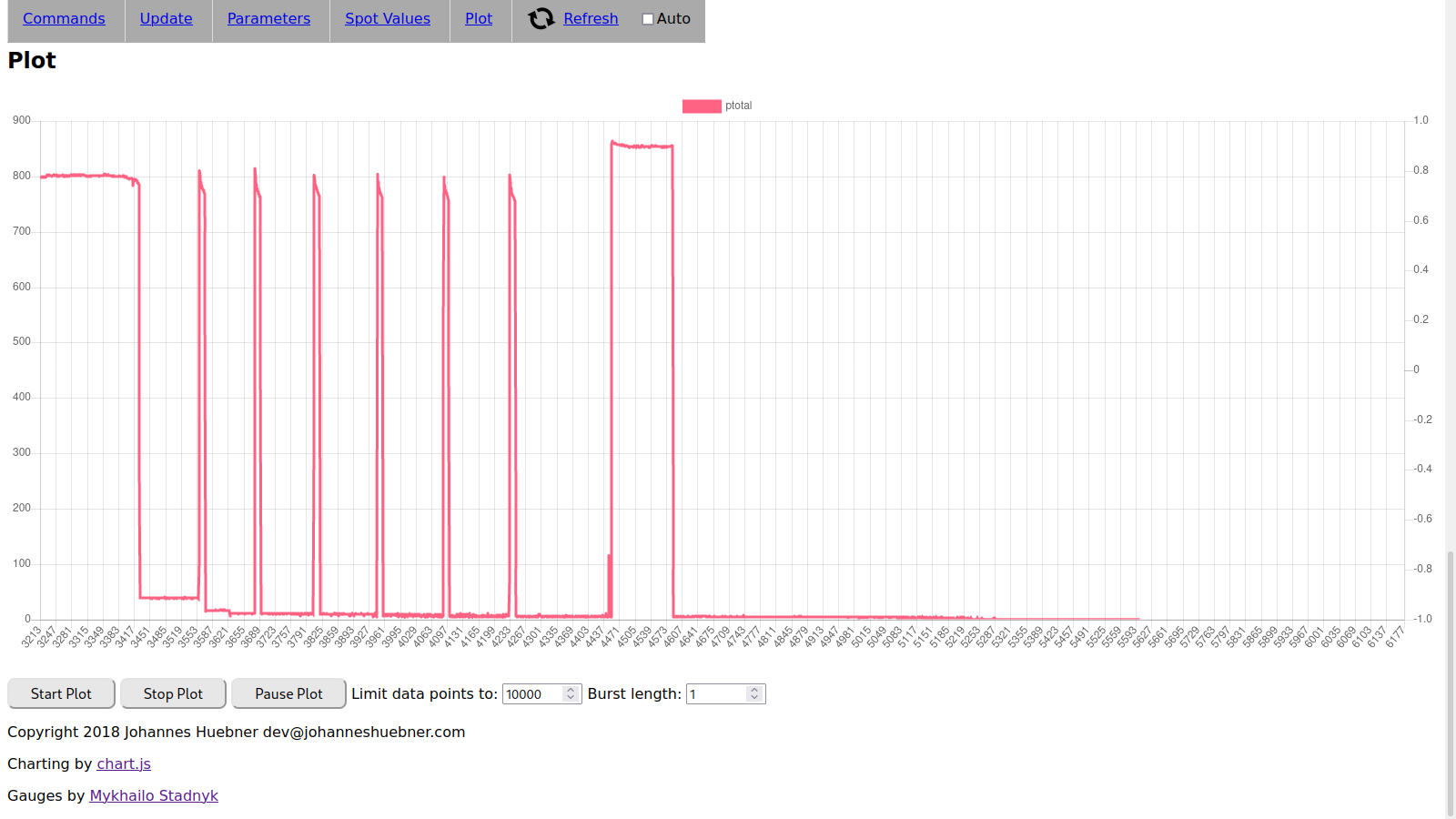

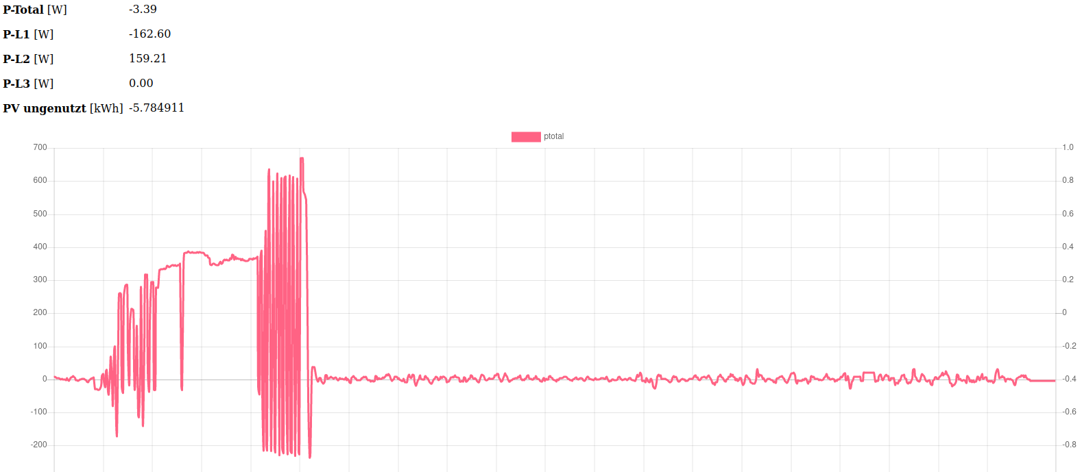

Successfully putting excess solar power into some old LFP batteries. I'm using a BeagleBone (for now) and a Manson switch mode supply with USB (for now) and am running the following script.
It fluctuates a bit (+- 10W) but reacts pretty quickly. Currently wife is cooking and the hot plates switch on and off in some 30s interval. In between it ramps up the battery and then ramps it down again within a second.

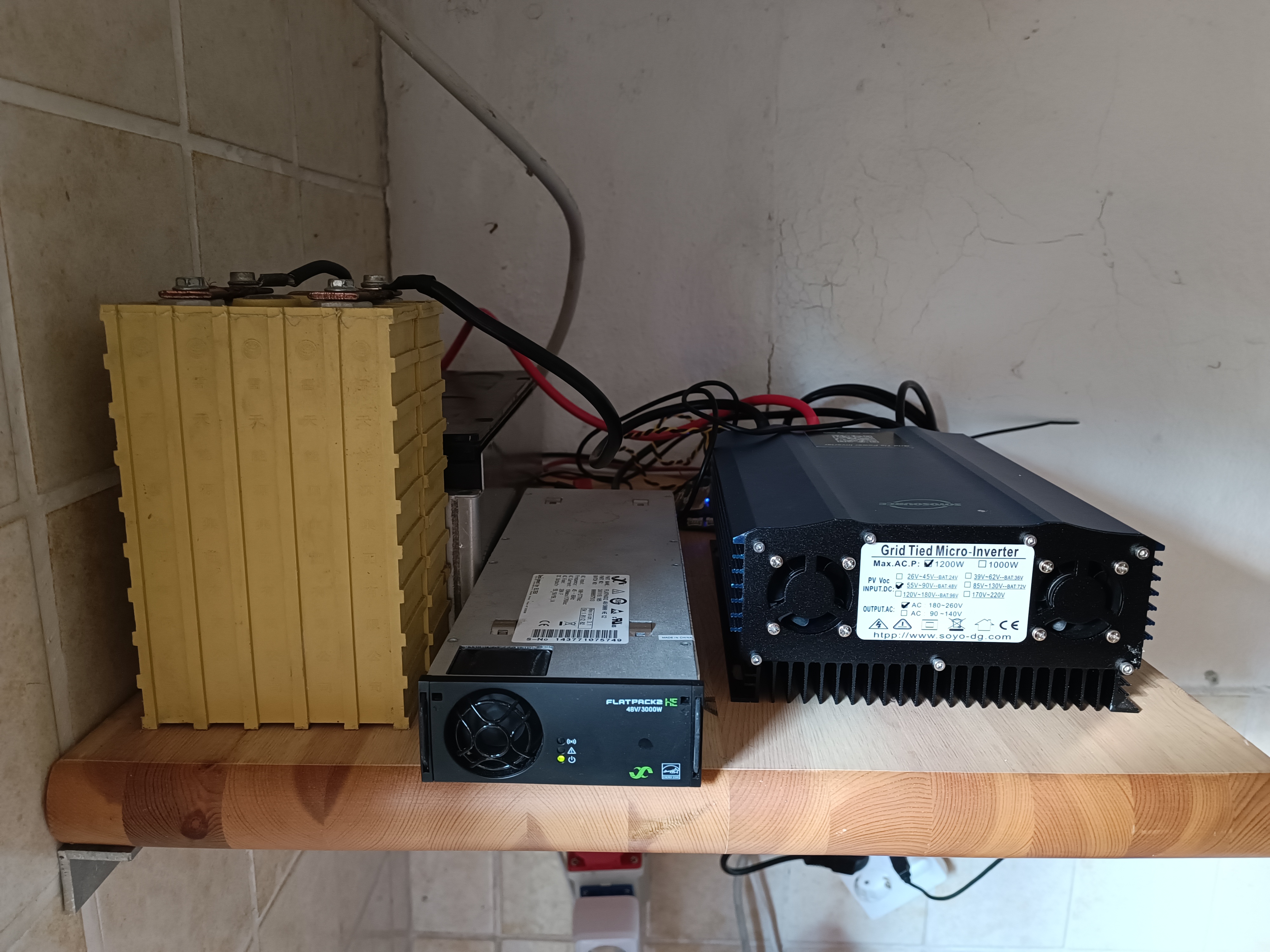

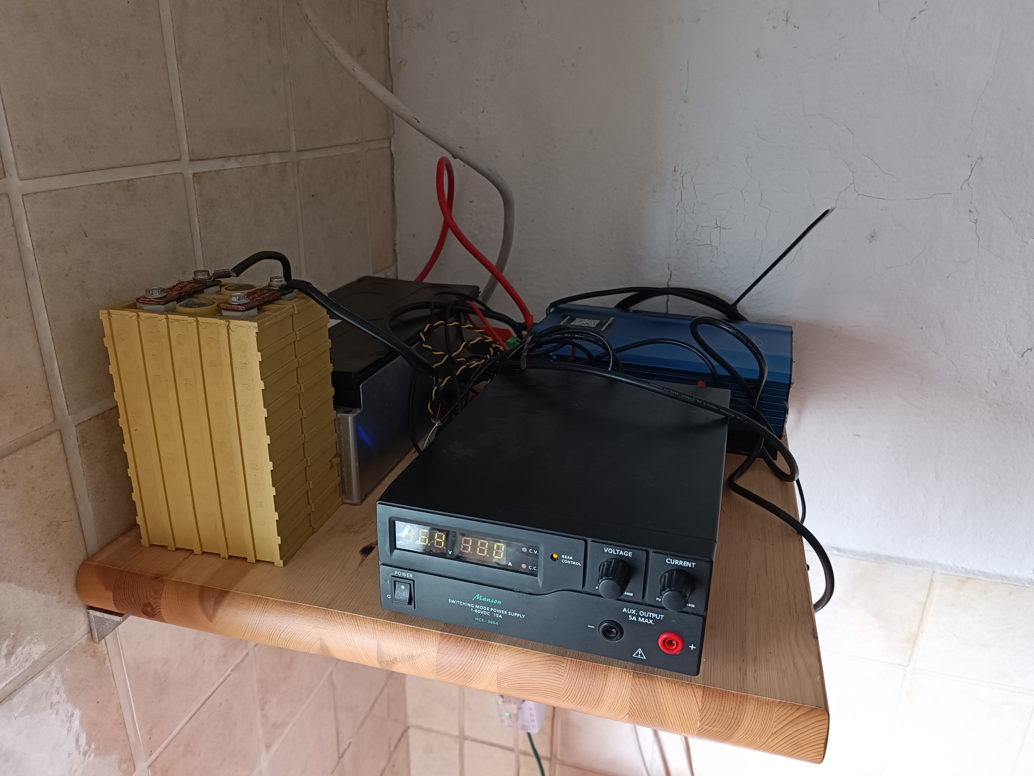

Relocated the whole system to the basement where it's cooler, more fireproof and most of all not as disturbing as when sitting in my desk. Both charger and inverter can be pretty noisy when operating at power.
Next step is replacing the lab power supply by an Eltek flatpack. I hope it goes as low as 44V.

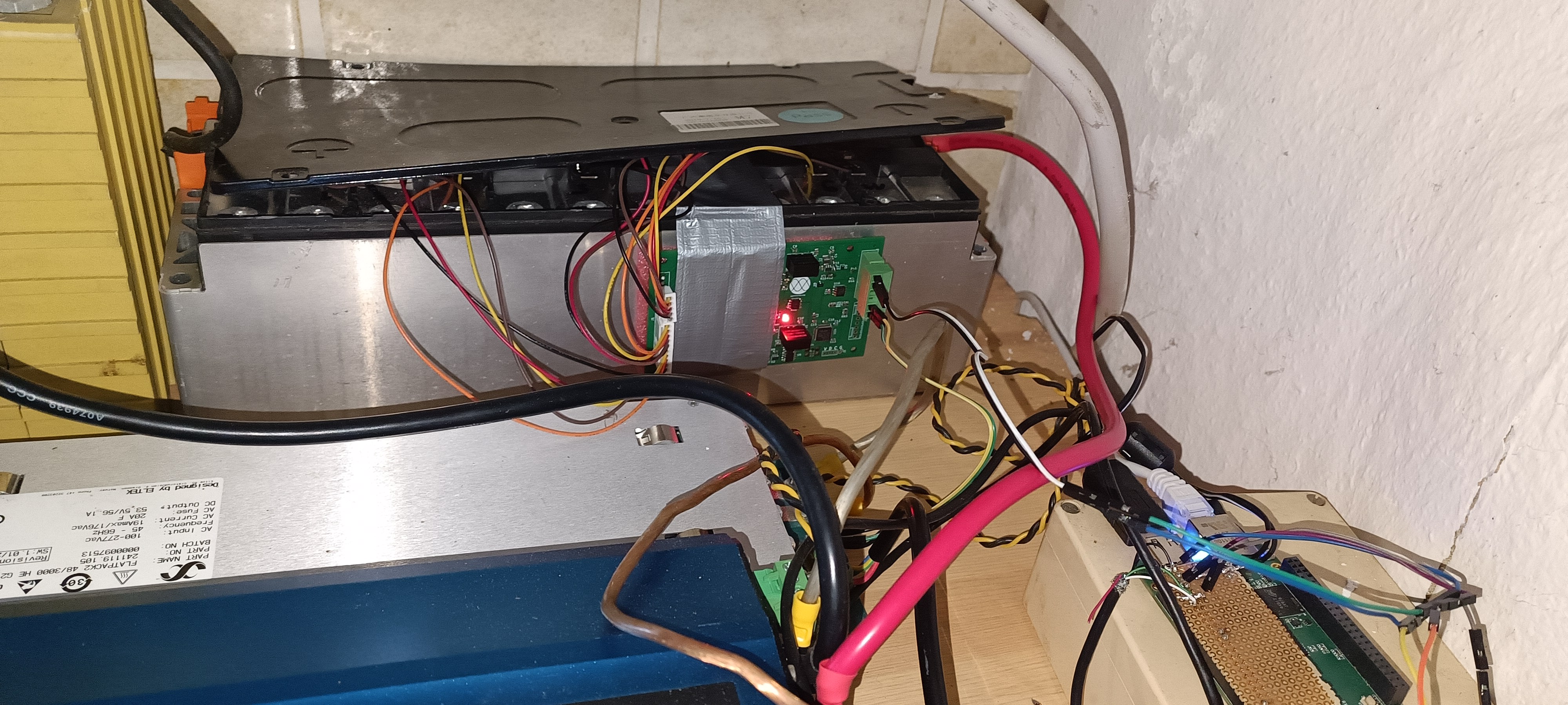

And today I did the Eltek replacement. Lab supply works perfectly well but I thought it is a bit over-qualified.
The Eltek uses CAN, the BeagleBone has native CAN so one less device connected over the notoriously unreliable USB.
There is one challenge though: below 48V the Eltek no longer accept the current limiting command. But has a 43.5V - 57.5V working range. So now I just do a PI loop that changes output voltage to arrive at the required output power. The measurements are updated fairly often, like 5 times per second so it seems to work reasonably well. Also the 10 mV resolution is very helpful. Mind you, the controller gains must be super low because a couple of mV make a whole lot of difference in battery current.
The driver will show up on github in a minute

Silly question I see you have used 2 lifepo4 cells to boost the voltage was curious what you strategy was to not over charge or under discharge them?
I assume thair (ah) capacity is substantially more than the lion pack and you basically discharged both the lion and the lifepo4 cells to half charged then hooked it together, that way regardless of the the soc of the lion, the lifepo4 will never be empty or full and sit in the middle of its soc?
Posts: 5822
Has thanked: 162 times
Been thanked: 1044 times
Re: Zero Grid Export and Reading energy meter with ESP
rstevens81 wrote: Fri Oct 21, 2022 9:20 am Silly question I see you have used 2 lifepo4 cells to boost the voltage was curious what you strategy was to not over charge or under discharge them?
Yes exactly. The LiIon is 40Ah and so are the LFP. Since it's 2P they well exceed the other pack despite being rather old. I just bumped them up until they were far enough from discharged and discovered they are also far enough from charged when the LiIon is full.

Plan is to automate car charging and also to charge the ESS battery with cheap electricity and discharge it when rates are high (while still not exporting to the grid because German rules and regulations)
Posts: 5822
Added the Switched ADC BMS yesterday. It works a treat and now I can keep an eye on the cell voltages. That said, without any balancing after 1 year of operation the delta is 5mV.
I found when two python scripts receive CAN messages you have to configure filters. Otherwise they might "steal" each others messages.
Posts: 5822
I found the Flatpack consumes a hefty 200 mA from the battery once its AC is disconnected. It also keeps sending CAN messages with no AC, so apparently the battery voltage backfeeds into the control circuit. I fitted a diode to its output.
Was also having CAN bus trouble (bus off condition), maybe related to switching it off. Connecting the can bus gnd fixed the issues.
EDIT: no the CAN bus trouble wasn't fixed by adding the GND wire. As always, when something has worked for months and suddently stops working you should wonder about the latest changes.
The latest change is the addition of a relay to power down the charger when it isn't needed. It has a little boost converter to be able to close the 12V relay from a 5V supply. Now I hooked the relay up to a separate power supply et voila, everything is working. So either the extra current draw (200 mA) from the beaglebones 5V rail or the interference caused by the boost converter is disturbing communication. Will add some more capacity and see if that helps
