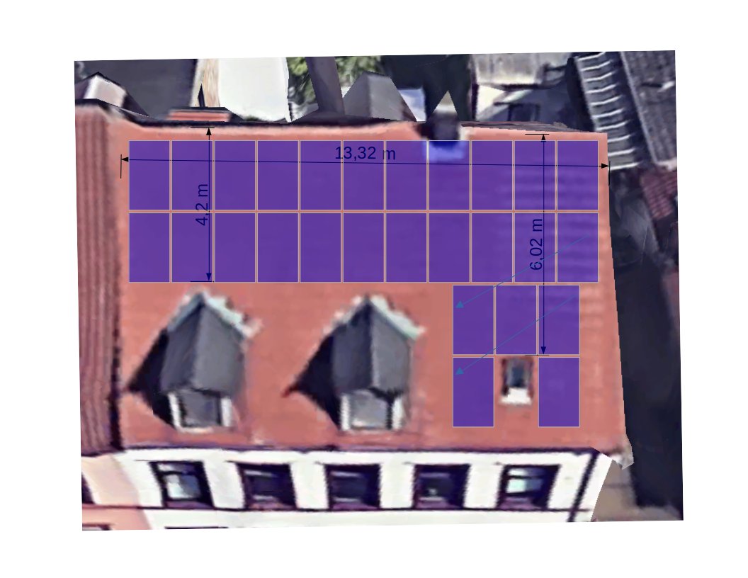

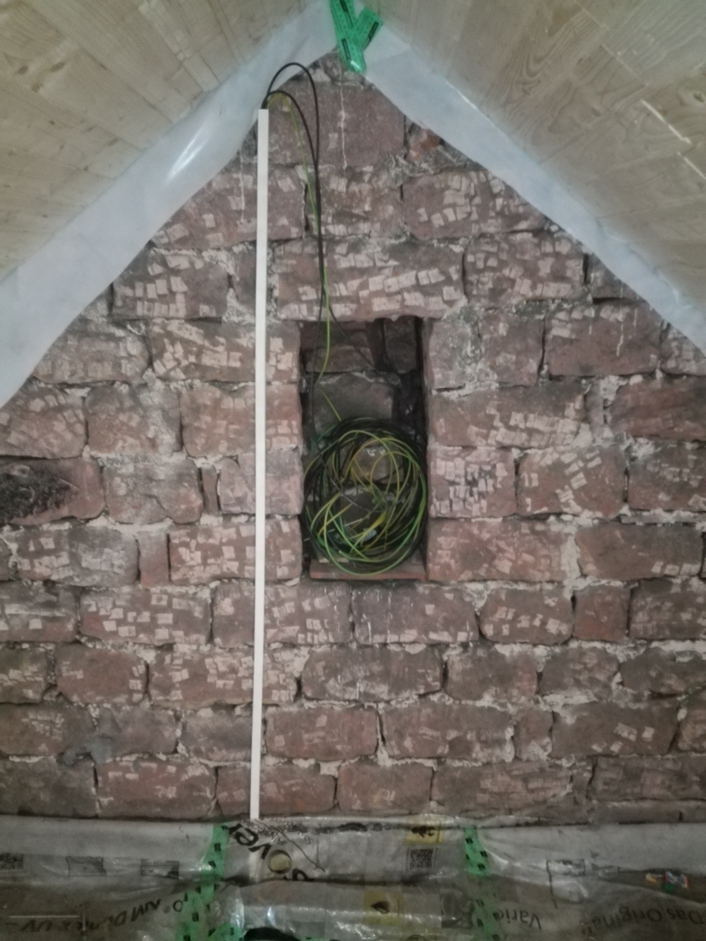

Planning
I took a screen shot off google earth with the roof tilted into the horizontal. Then whacked solar panels in there avoiding shadows. Then found out that I'd assumed the wrong width AFTER ordering the solar panels... So instead of 26 I can only fit 23. Oh well, there is no such thing as redundant solar panels, my dad will buy them off me. Electrical installation
every other mounting profile is connected to an earthing cable. Panels are arranged as one string with an idle voltage around 850V. DC+ and DC- first go to a string box that contains surge protection and two fuses. These boxes are available cheap and pre-built, no need to build your own. Then + and - go into the inverter while the three earthing cables from inverter, roof rack and string box are collected at a common star point in the fuse box.

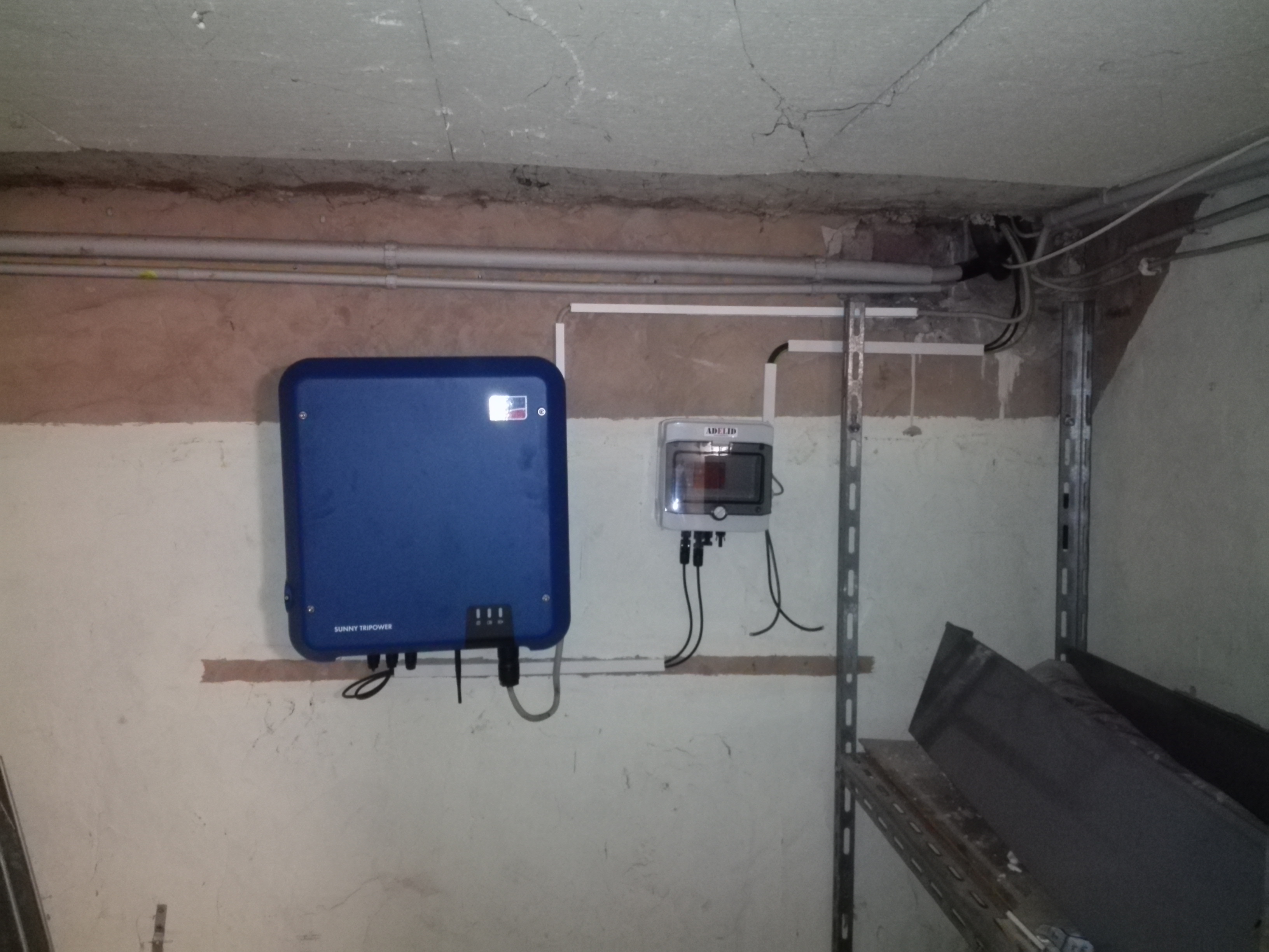

The inverter output runs via 3 regular fuses (because it is 3-phase) and through a bespoke energy meter into the grid. Will update that after talking to the electrician. Cables run completely vertical all the way from the roof, through an existing cable duct, to the basement where I chose to install the inverter. Then AC cable runs back up to the house connection box. Very fun to fiddle 5x2.5mm² cable through some unknown, bendy cable duct. Old trick, first I put the flexible grounding cable in, glued the AC cable to it with some strong tape and pulled it all down.

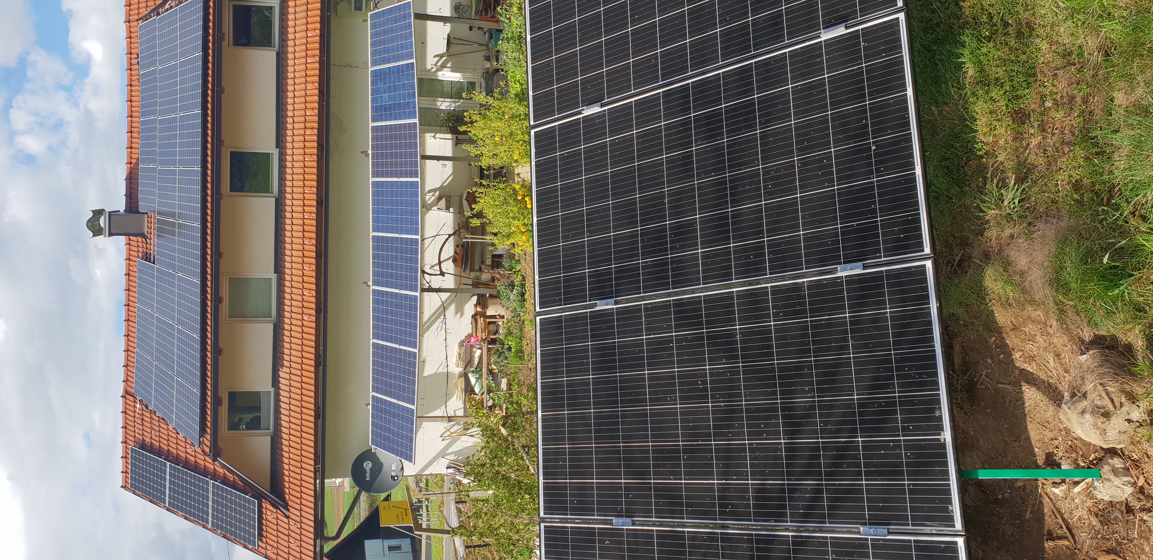

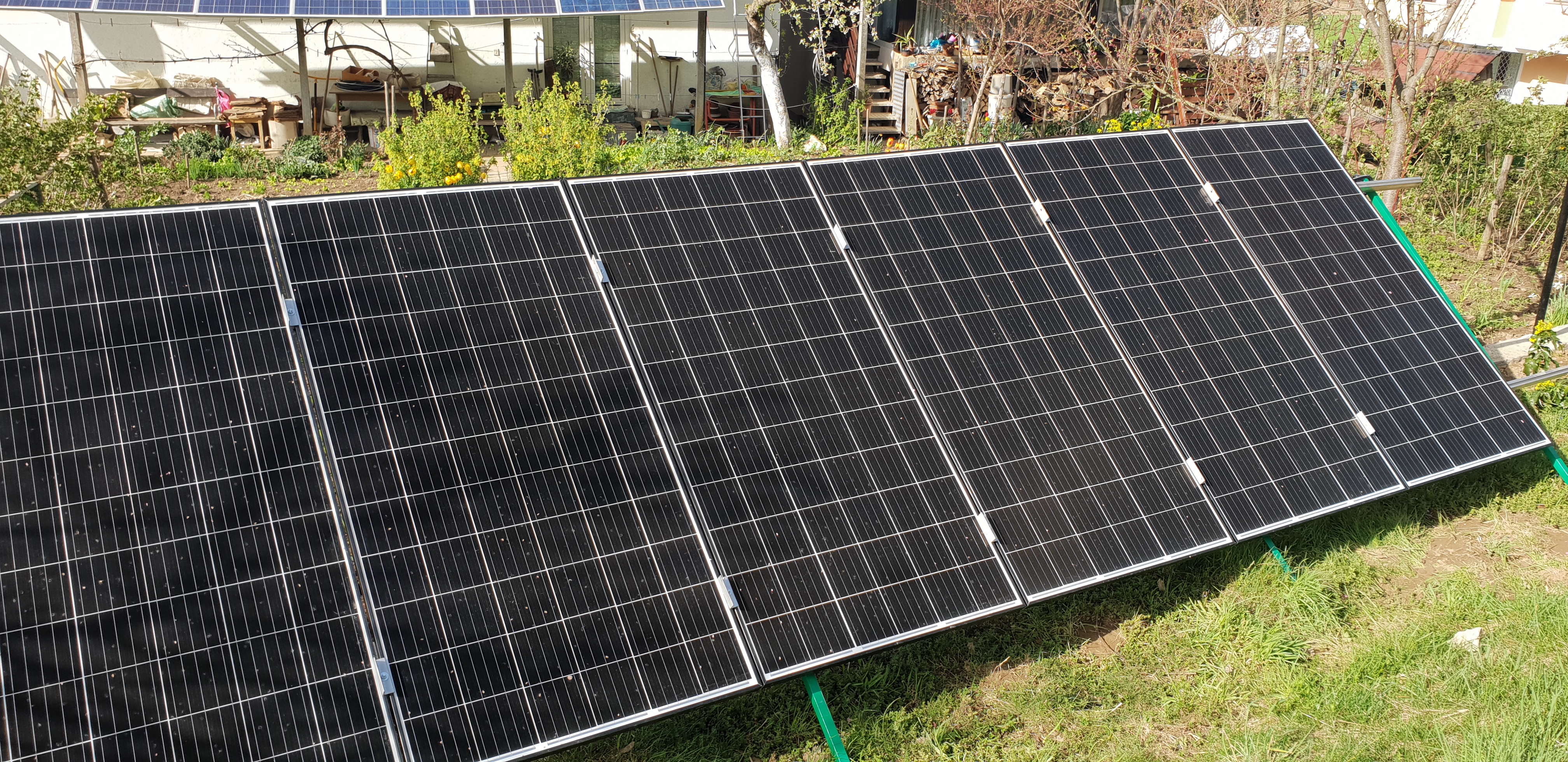

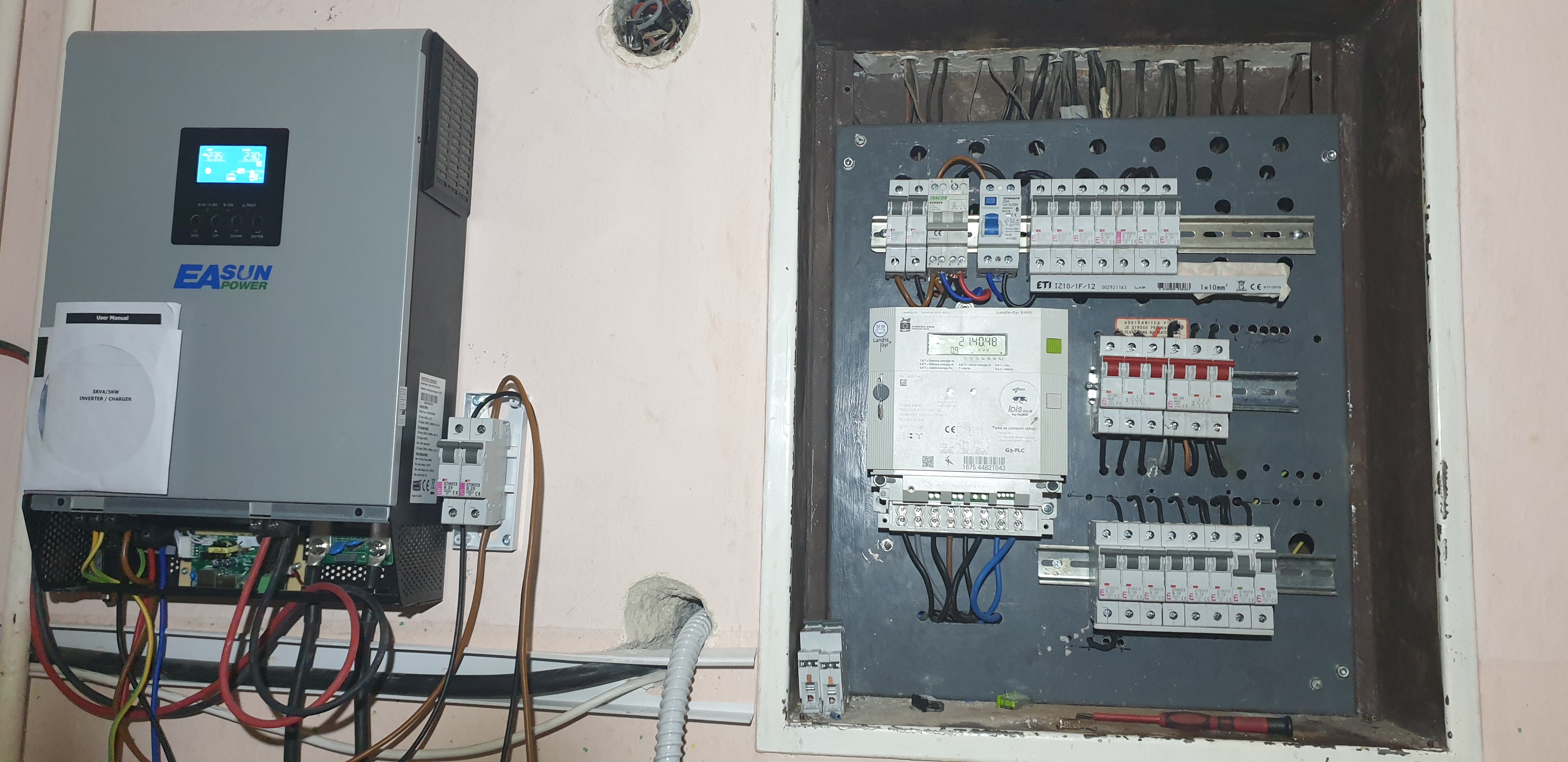

I have that mounted for 3 years now and it runs without any thought now.
With about 9kW i could cover annual electricity for my house and my car. But now that i installed 11kw heatpump i overspend by some 500e. Which is stil good considering energy cost for heating in winter.
Also pricing was similar at 1ke for 1kW of solar power installed.
But this year i ran into problems when i wanted to expand my solar to 13kW. Electric company refused because our grid is not strong enough. I now have lots of solar neighbours...
Well i decided to expand on my own and put panels in my garden and connecting inverter to battery. Philosophy behind this is to take the house off grid at least enough for every day use to be sustainable (wont you just love that high political wording) and thus freeing my netmetering of house consumption.
In any case if you dont get approval it is not the end of the world. You just setup system for your own house use combining with battery.
Solar paneling installed martian style... Joint view of both installations Volt battery in 48V configuration I had to rewire the house, what a pain! I got bms working...

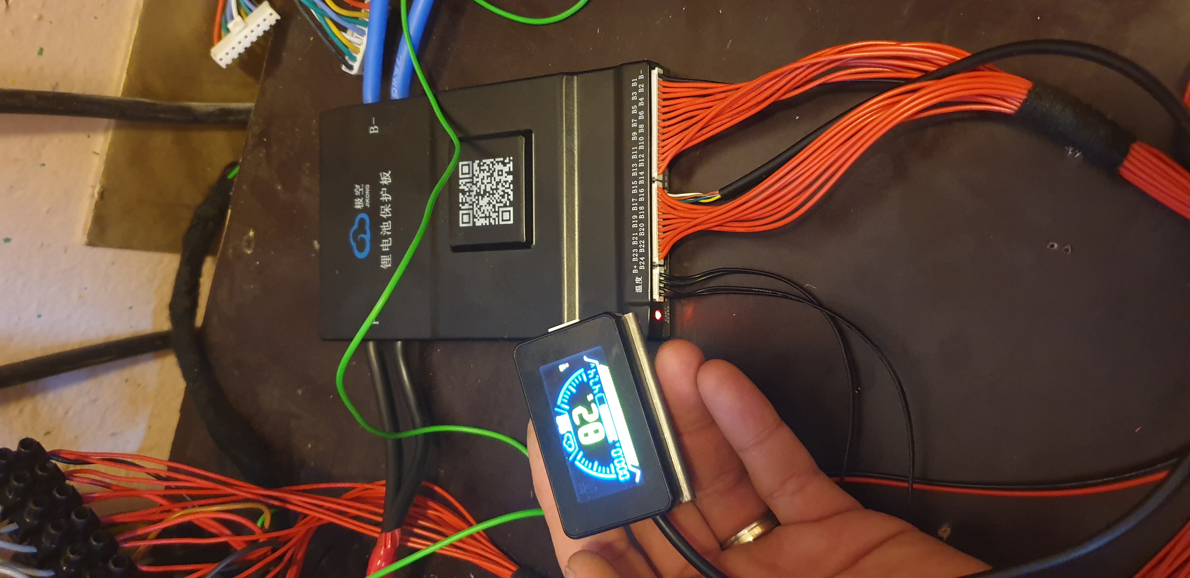

Very nice, I like the battery system. Which BMS is it? Hah, why don't you add a thread for it

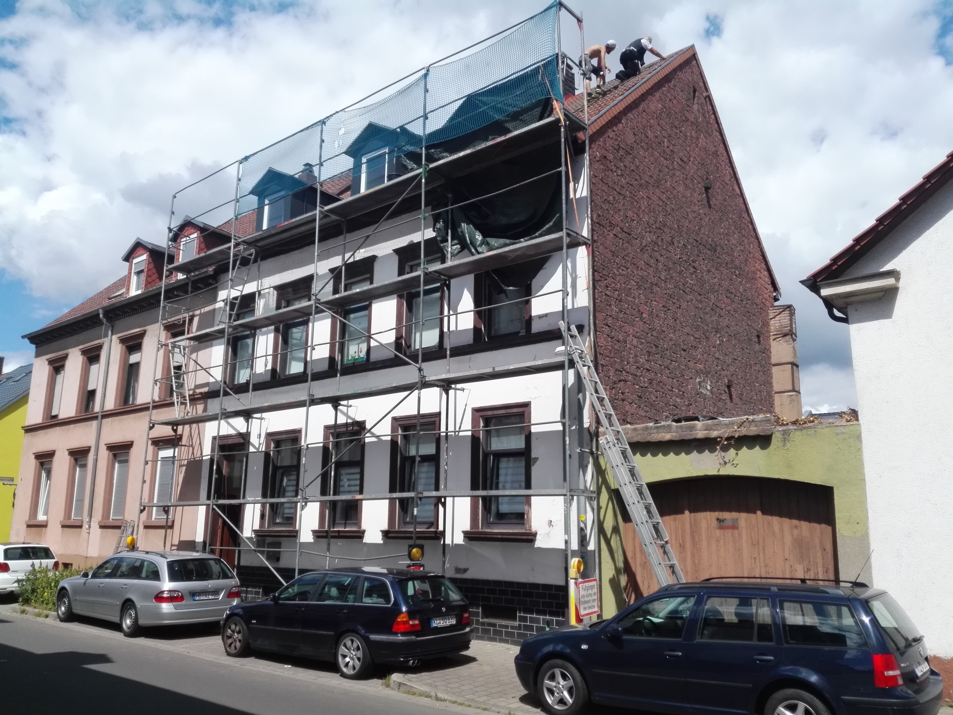

The system is now installed but not yet running. A new meter box needs to be added and the utility need to mount the meter. Might be a matter of weeks. I did however give away 45 kWh to one of the tenants. System peaked at 7.3 kW, I'm guessing we'll see more when it is cooler.

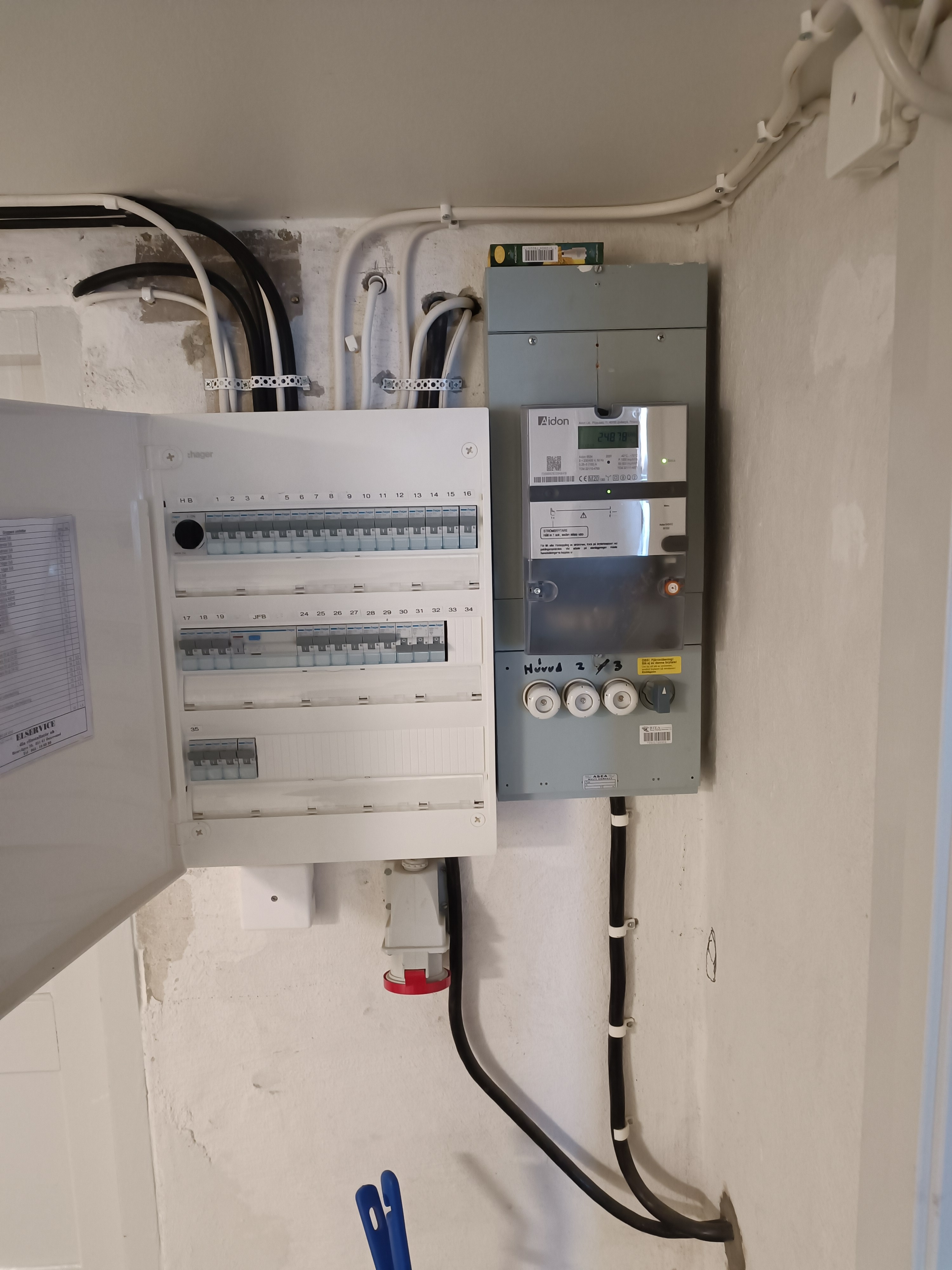

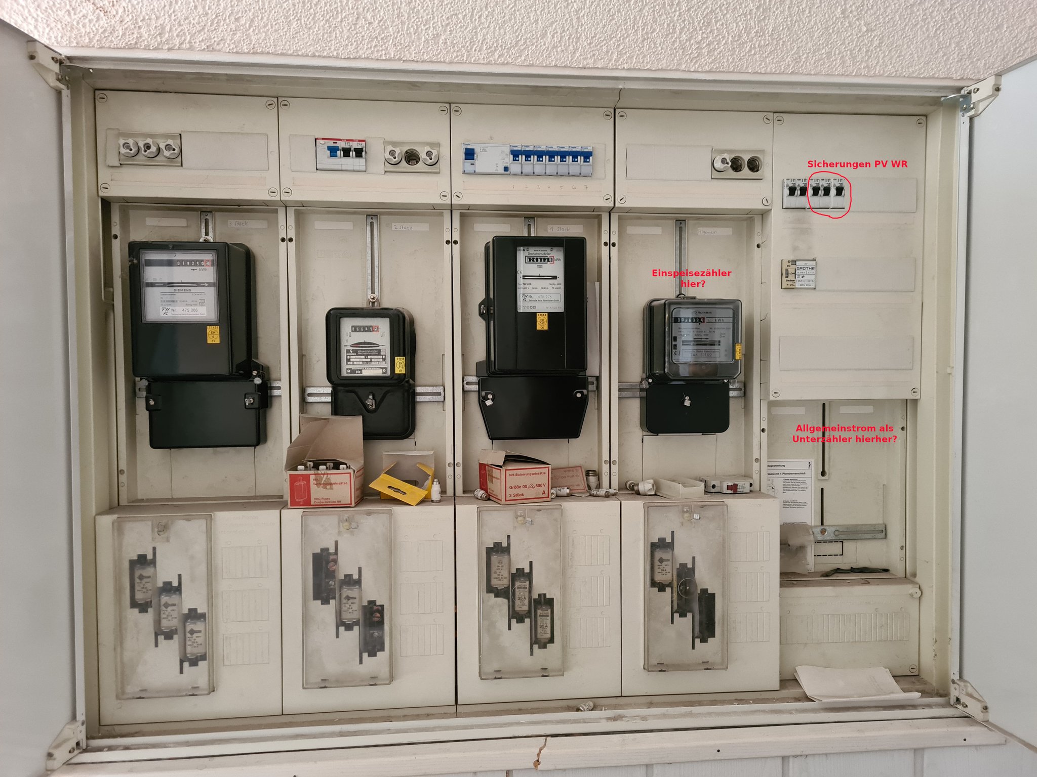

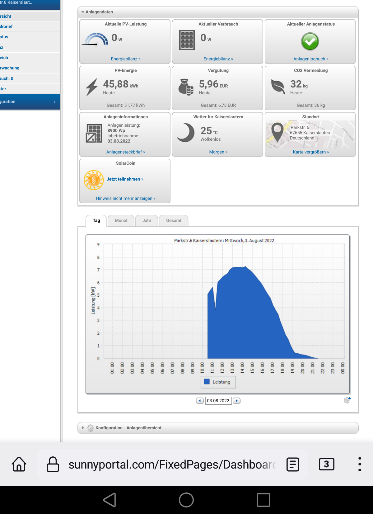

You won't believe it but it actually took until today to get the system officially feeding in. Had I known this before I'd have reconsidered the feasibility...
My very naive plan was to put a digital 3-phase energy counter onto the 4th position and meter the collective electricity separately. But this is Germany. There are procedures to follow. And I hate procedures!
This cabinet is too old, as long as it remains unchanged you can use it but as soon as you change something you'd have to upgrade the entire cabinet to the latest and greatest safety standards.
So that plan was up in the air, and additional cabinet must be installed in the basement, and it's gigantic! 1.1m high and 0.8m wide or something. Now that there's a second cabinet the main power line must be spliced. Requiring yet ANOTHER cabinet with more fuses in it. And because rules it must be attached with 16mm² cable despite just 8 kW going through it. The electricians didn't seem to believe that themselves so they started out with a simple splicing box and, I think, 10mm² cable. The utility said they wouldn't place the meter because 10mm² is very unsafe! So another 2 months passed until this was all corrected.
The disastrous financial end result: 3100€ extra instead of a few 100€ could the meter have been installed in the original cabinet. Wow, just wow. German Energiewende FTW.
Will update the post above with the final cost.

Yeah I'm glad I just did the system in my home without needing to inform anyone. I'm sure naysayers would find plenty.
Here's a recent Swedish cabinet. I'm sure installing that doesn't set you back 3000€. And it's not 16mm² either.
