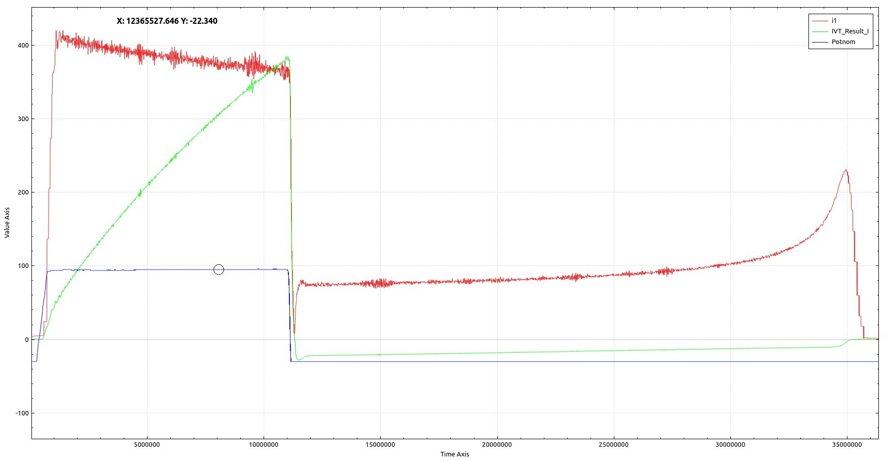

Just went for a drive to gather the data, and it seems I'm somewhat incorrect about the symptoms. I *do* have regen at high speeds, it's just negligable, and then at 5mph something unpleasant happens...
Here's a graph showing a 0 to 60 to 0 run. It shows that I'm getting around 22A of DC regen current, but as the speed drops (to around 25Hz maybe) there is a huge spike in AC current, which seems to exist only between the inverter and the motor.
I assume the solution here is simply to increase the value of regenrampstr to eliminate that current spike, however I am puzzled as to why the regen is so little. At a potnom of -30 I'd expect it to be quite a bit more noticeable.
fslippnt is -2 as it should be, and unfortunately I messed up the command to log ampnom, so I don't know what it was doing throughout.
I will do another run shortly with offthrotregen increased to -40 and regenrampstr increased to 25. Hopefully this combo will result in noticeable regen without the low frequency current spike.

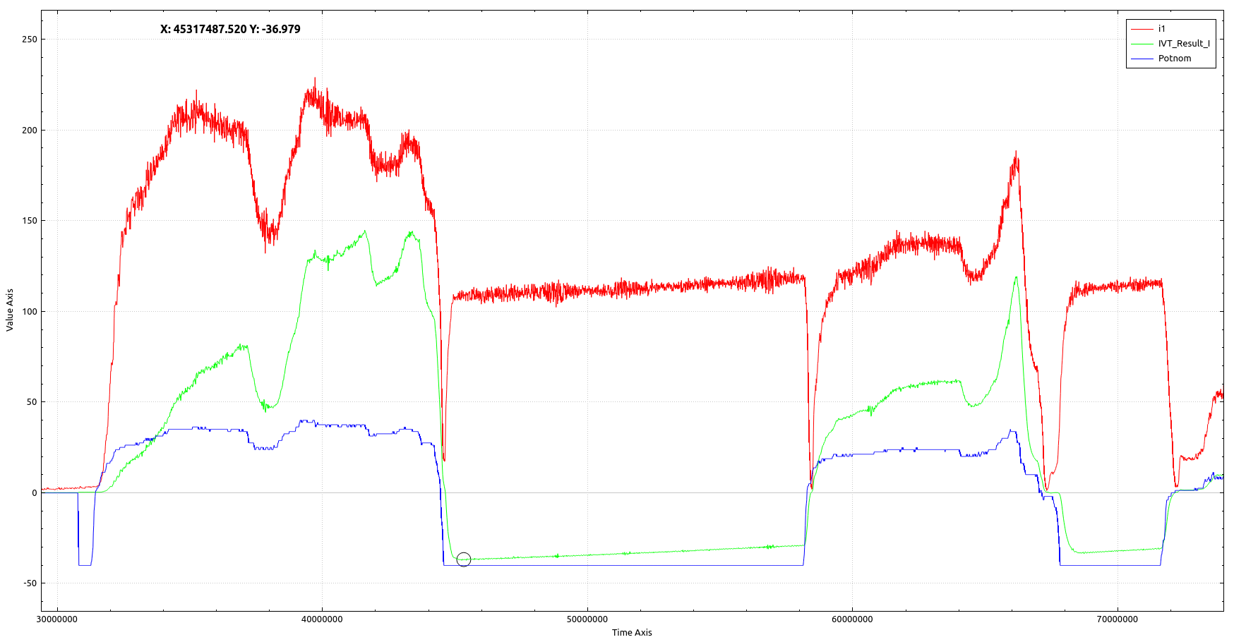

Fixed. Raising regenrampstr to 40 eliminates the current (and braking) spike at low speed. Increasing offthrotregen to -40 creates a meaningful amount of regen braking (-37A) at all speeds. Interestingly
