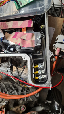

So I got my hands on a cute motor from a kia e-niro.
Its for a full electric car I think since the motor is so powerfull.
The ide i to use it with my prius gen 2 inverter, but I have to read up on how the resolver sync works in the openinverter software.

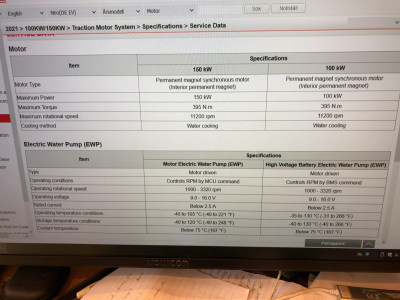

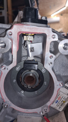

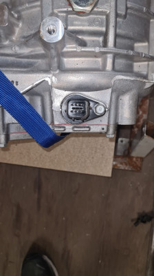

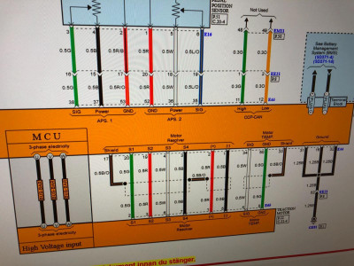

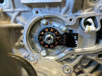

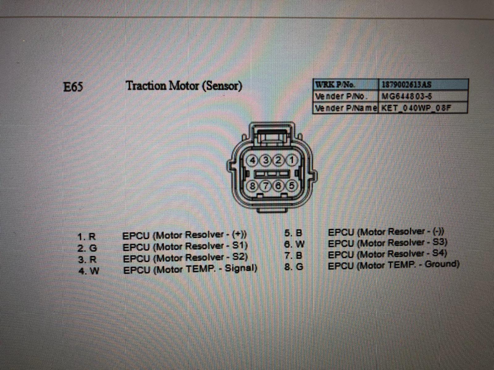

Here's some images on it, teh resolver and some data from the kia mechanic I bougth it from.

Resolver setup should be easy with this diagram. You might want to parallel MG1 and MG2 outputs to get most power out of it.

Ah, yes, the electric connections shouldn't be a problem, but more how openinverter sw handle the resolver syncing, is that automatic, or do I have to feed some offset to the software? (sorry for not having read up on this yet..)johu wrote: ↑Sat Jul 30, 2022 5:31 pm Resolver setup should be easy with this diagram. You might want to parallel MG1 and MG2 outputs to get most power out of it.

Ok,so started to prod the kia motor this evening, the resolver resistance is quite different from the prius resolver though.
the kia resolver has as follow:
-/+ 26,3 ohm
S1/S3 84,3
S2/S4 75,6 ohm
Compared to the prius p112 that has 8, 14 and 14 ohms on the winings
I guess that the -/+ is the primary winding, and the other two are cos/sin windings, it's strange that the two later differ so much, while the prius cos/sin-windings are almost spot on 14 ohm both...
The resolver is a semiteck korea OE36562700
Their homepage doesnt really disclose anything usefull.
http://eng.semiteckorea.com/products06-04/
Tomorrow Im going to feed sinewave with a function generator into the resolver and see what comes out on the cos/sin outputs on the scope...

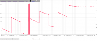

ok, been fiddling with this a few hours today, and now I get an angle from the resolver, but it seems to turn over from 365 to 0 several times in one axle revolution, and that doesnt seem right?
I tried incresaing the "respolepairs" to 4 and then it goes down to 365 degrees per 90 degree turning on the axle.
If i try to set "respolepairs" to anything higher than 4 i dont sem to get an angel at all strangley, 8 or 16 on should give 365 degrees on one axle revolution.
or is there any other scaling parameter for the resolver?

Re: Kia E-niro 100/150kW motor
The angle refers to the electrical angle, not the mechanical angle of the axle. Thus, it is possible and maybe also expected that there are multiple electrical rotations for each mechanical rotation. Based on the image of the resolver, respolepairs=2 should be correct.linda.ljungdahl wrote: ↑Sat Aug 13, 2022 8:16 pm ok, been fiddling with this a few hours today, and now I get an angle from the resolver, but it seems to turn over from 365 to 0 several times in one axle revolution, and that doesnt seem right?
- bexander
- Posts: 897
- Has thanked: 78 times
- Been thanked: 102 times
Are you sure? The Leaf motor uses a four lobe resolver and usually respolepairs=4 is used?LeonB wrote: ↑Sun Aug 14, 2022 1:30 pm The angle refers to the electrical angle, not the mechanical angle of the axle. Thus, it is possible and maybe also expected that there are multiple electrical rotations for each mechanical rotation. Based on the image of the resolver, respolepairs=2 should be correct.
https://openinverter.org/parameters/view.html?id=10
I’m sorry, I got that mixed up with the 2-pole pair prius resolver – yes, the Kia motor uses a 4 pole pair resolver.

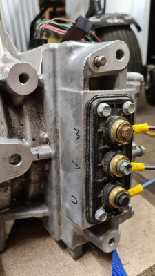

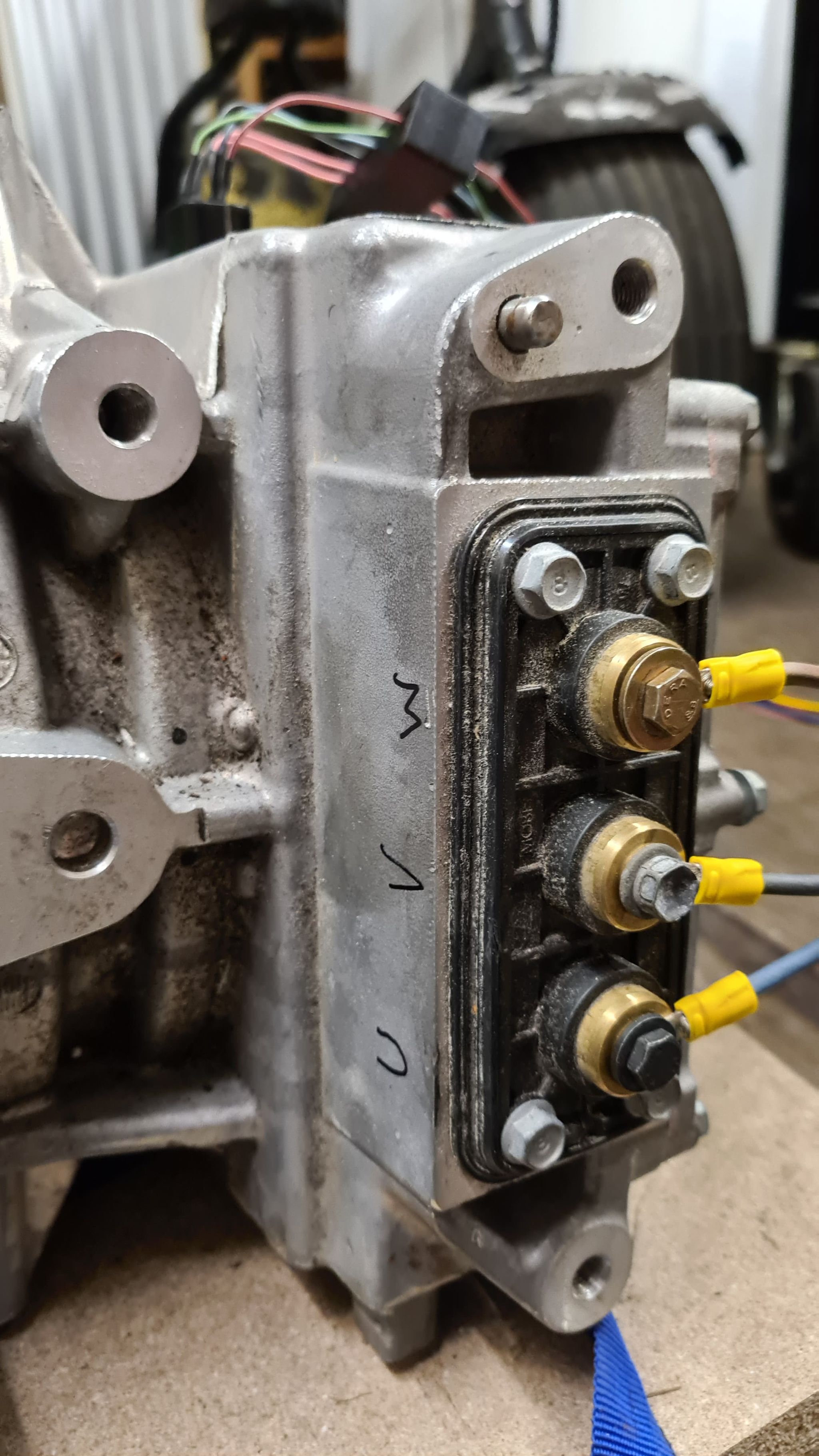

kia was kind enough to actually press the phase letters into the plastics of the connection block,but here are som images:

Here is a cover for the phase connections I made in tinkercad also.

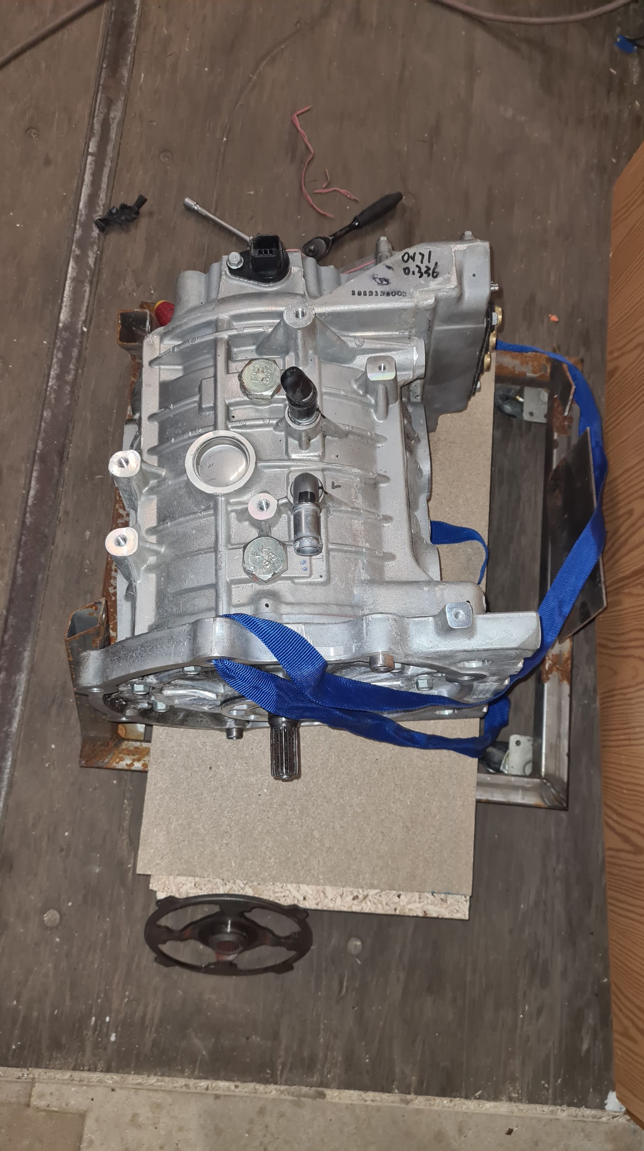

final drive with diff for this motor is part no:4450018EA0
the motor and final drive is the same between kia niro and hyundai kona.

Interesting project but are you now thinking of using the Kia final drive in the landrover?and yes, we will not use the full RPM of the motor in this installation, more like half rpm if even that.
(its maybe going into and old landrover directly on the driveshaft to the differential
As the E Niro final drive ratio is something like 8.206:1 - so if this is connected up to the live axles in a series landrover which are something like 4.7:1 you'll get a total drive train gear reduction of 38:1! which is quite a lot - great for rock crawling!
When they mount Tesla drive units longitudinally in the centre of 4x4's they also change the gear reduction to something like 4:1 from 9:1 to also take into account the reduction in the axles.

hehe, no, the idea is to connect the motor without its final drive to the land rover diff...SuperV8 wrote: ↑Tue Nov 08, 2022 3:12 pm Interesting project but are you now thinking of using the Kia final drive in the landrover?
