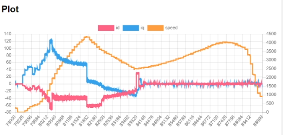

I have done a lot of test drives in the last weeks and although I made some progress, the motor is still not working as expected.
Mainly, the unwanted regen is still there, although it is shifted to only happen above ~2800rpm and it feels not as strong as in the beginning, even though it can reach ~50A regen current. This is at curkp=250, curki=3000, curkigain=0, syncof=47500, syncadv=10. Increasing syncadv decreases this regen current all the way to 15A at syncadv=40 and increases the subjectively perceived torque at sthe same time. At this high value however, the car accelerates on its own when letting go off the throttle above ~5500rpm.
Here (viewtopic.php?p=38910#p38910) it is mentioned that syncadv should stay at ~10, as it is just meant to compensate the time lag of the resolver readings at high rpm. So I stopped experimenting with it.
I have also tried every one of the 4 permutations of the resolver pair polarity combinations, but two of the combinations didn't worked at all and the other two were identical. Going through the whole range of syncofs values also did not reveal any improvement.
Thus, my latest attempt was to modify the firmware (v5.17) with custom MTPA constants that I found online for the Prius Gen3 motor:
static const s32fp fluxLinkage = FP_FROMFLT(0.124);
static const s32fp lqminusldSquaredBs10 = FP_FROMFLT(0.00074); //additional 10-bit left shift because otherwise it can't be represented
static const s32fp lqminusld = FP_FROMFLT(0.00085);
Furthermore, I integrated the corrected (?) MTPA formula from here (viewtopic.php?p=28867#p28867).
   s32fp term1 = fpsqrt(fluxLinkage2 + ((lqminusldSquaredBs10 * isSquared) >> 7));
   idref = FP_TOINT(FP_DIV(fluxLinkage - term1, 4*lqminusld));
   iqref = sign * (int32_t)sqrt(isSquared - idref * idref);
I also tried the original MTPA formula and it feels like the correct one causes more torque at low rpms, however there seems to be no difference at high rpms between the two. Sadly, there is also no difference compared to the original constants, the unwanted regen remains unchanged.
Here is another interesting plot when driving downhill: (parameters from above were used, ffwstart = 400Hz = 6000rpm -> no field weakening)
The car accelerates till 81852 where I completely let go off the throttle. Unwanted regen starts off at ~35A and tapers off to 20A at 83800. The motor stutters barely noticeable and then just freewheels with 0A. As I am going downhill, the rpm starts to increase again but there is no regen current. Hence, it seems the unwanted regen is not dependent on rpm alone.
Other notable quirks of the car are, that torque and power feel really good at low rpm (motor input current ~100A), but quickly taper off (e.g. only 60A at 5000rpm). It seems like the inverter can't push il1 and il2 above 90A (slightly dependent on syncofs), no matter how high I set my throtcur.
Also, driving backwards at syncof=47500 causes the inverter to quickly heat up and overheat. Lowering syncofs to 41000 gets rid of the overheating, however the motor now has only very little torque in forward direction.

Thanks for those experiments. The behavior in reverse reminds me of my Leaf setup with wrong pinswap.
I think I'll make an MTPA-less firmware again that lets you configure throtid/throtiq separately.
Question: I take it that you disabled regen via parameters?

johu wrote: Mon Apr 18, 2022 2:56 pm Question: I take it that you disabled regen via parameters?
Yes, brkmax etc. are set to zero.
One thing I noted and that is also visible in the plot above is, that the absolute value of id increases when letting go off the throttle. I would expect both iq and id to immediately (or as fast as the PI controller are able to) go towards zero, just like they do after the unwanted regen. I redid the same scenario as above (equal parameters, driving downhill) but plotted uq and ud as well:
So before letting go off the throttle, ud seems to already max out at ~-35000. (this may be connected to my rather low power at high rpm?). Immediately after letting go off the throttle pedal, it jumps to ~35000 and again, reaches a maximum value as it seems. So the PI controller wants to increase id to 0 but as a result, id decreases even more? This goes on till id slowly creeps close to 0 and then suddenly everything is ok again. No unwanted regen, id=iq=0 and ud and uq are at some sane value, opposing the back-emf. So there definitely is a problem with id and its PI controller not being able to control it.
I also quickly tried the firmware with an alternate fw controller (viewtopic.php?p=38670#p38670) and implemented my MTPA constants and the new formula. I also used the parameters linked in that post. On the one side there is no unwanted regen anymore, however now the car just accelerates on its own when going above 2800rpm and only stops so when bringing the car to a full stop. As soon as the car goes into auto-acceleration, ud is maxed out again:

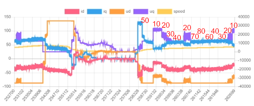

Furthermore, I did some idiqsplit testing: Field weakening was turned off (fwkp/ki=0) and I started with syncadv=0. For a wide idiqsplit range (30 to 80), I cannot feel a difference between different values and overall it feels equal/ slightly worse to MTPA. Again, ud seems to be a limiting factor as it maxes out quickly. Below is a plot of a test run at full throttle and different idiqsplit values (red numbers are the idiqsplit values at that interval):
So for idiqsplit>30, ud just maxes out and uq is also just constant. At idiqsplit=20 ud isn’t maxed out, but the car accepted a bit less power/ had a bit less torque. The ratio id:iq also looks off here, seems to be ~30A:50A and not 20:80.
The unwanted regen remained when running at a low idiqsplit without ud at a maximum. As soon as I let go off the throttle above 3000rpm, ud quickly goes to the maximum positive value.
Increasing syncadv to 35 increased power (from 35A to 70A inverter current) and decreased unwanted regen but also introduced unwanted acceleration at 6000rpm. So just like before with the MTPA formula. Syncadv=25 gets rid of the acceleration but decreases power a bit.

Alright, now following celeron argument about too much current actually decreasing power at the top end, you could try decreasing throtcur. That of course limits torque in the low end but does it yield an increase at the higher end? I'd keep syncadv 0 for now as it's essentially just affecting iqiqsplit as well. Also try bringing field weakening back in for the above test. And thanks for your work. I can chime in once I have my Prius conversion running.
And yes, only one pinswap bit for PWM is possible (and meaningful)

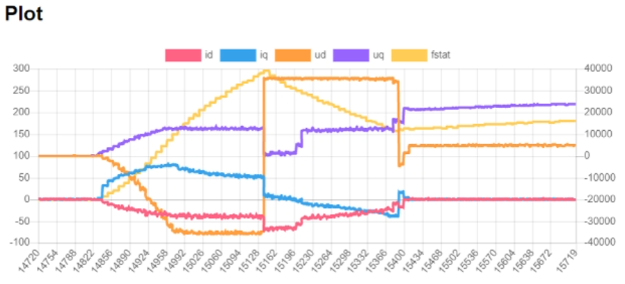

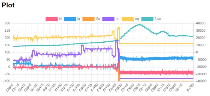

A short update on the Golf: After trying out many different firmware variants, I am now not using any MTPA formula, but the idiqsplit firmware linked in one of the posts above. I haven’t had luck with any kind of field-weakening controller, but increasing syncadv above any reasonable value always gave me a huge boost in performance. This, however, created problems with self-acceleration and unwanted regen in the upper rpm range.
Being tired of trying to make it work “the right way”, I kept working with a high syncadv and tried to tune away any flaw that came with it. To do so I am now using a field-weakening controller, if you could call it so, that, depending on the speed, adds both Id and Iq. The amount and ratio between the two can be tuned to get rid of any unwanted regen and acceleration. Fast changes in the throttle position still led to a very heavy regen, but that can be fixed with a high (>500) curkp. However, this causes quite a bit of ripple in the currents at low speeds. So additional to curkifrqgain, I introduced curkpfrqgain that gradually increases curkp with speed.
Overall there is progress and I am quite optimistic, although some tuning is still required.
One thing that bugged me for quite some time was the low current output of the inverter. I could only do a max of 200A on MG2 before overheating while for example the wiki states up to 500A.
I already mentioned before that inverter temperatures were usually 10°C above the actual ambient temperature. During the last couple of hot days, there were instances where I started the car and the inverter reported temperatures 20°C above the temperature of the batteries which are sitting right next to it. So, while I expected the temperature offset to get better at higher temperatures, it actually got worse.
Thus, I laid my fate in the hands of the Toyota engineers and turned off the temperature derating. I started to increase throtcur and while the reported temperatures quickly maxed out at 100°C, the inverter did not stop. Suddenly I was able to pull twice the amps without any problems. Hence, I will put the inverter into an oven next and try to get a better calibration curve.

I did a calibration of the inverter temperature sensor and now MG2 can deliver 400A easily and temperatures keep below 40°C while driving. At temperatures above 100°C, the inverter trips out on its own so the calibration seems about right.
