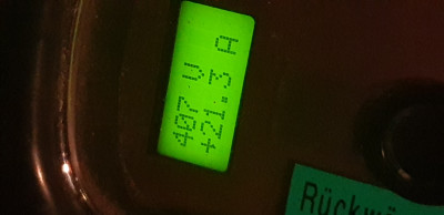

900 asked me how my Gen2 charger is doing with opensource firmware.
I put it in the car now, yay! It was a whole days work. I had to lift a lot of weight under my car, i feel like i had a workout :)...
Then i had to replumb coolant and deair...
It is now wired to sense EVSE PP signal and pull in Cp signal. That works by itself and i cant use PP signal for anything else. If i connect my DUE there it would just float and DUE would not sense connection.
My setup is to use A1 output on start and that is connected to my DUE (previous PP) input pullup pin. This works really well and starts my coolant pump and car fans when charger is connected.
Also to stop charger i am using its A3 input pin which is pulled up to 12V. I can pull to GND with BMS output to stop charger.
As for charging above 400V it seems to drive current well above up to 410Vdc which is what i have tested. Today i will continue to 420Vdc and report back. Charger jumps around a bit which is why first photo is just 17A. But that is only transient and normally it keeps to 21A that my EVSE requests.

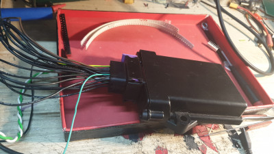

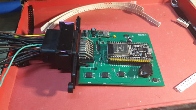

Hm... i can quickly redesign V5 board for use with NCVs.
I will probably just keep ULN driver where it is and replaced relays to 3x NCVs. That way you could very well use the board as VCU for Chademo with the actual code. If you have interest you can make some boards and test that.
Because of better availability i went from DUE to ESP32. I have the board here and i am trying to recode it via PlatformIO.
I will let you know.

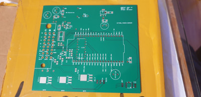

That reminded me of a project i started before chip shortages.
Here i post a VCU V5 build files with DUE CORE R3. Lately i cant get any such board, but it was a good alternative since it already had EEPROM onboard.
I will redesign the V4.2 later into V4.3 without relays...¸
EDIT: I forgot to put pcb file with gerbers...
DUE Shield V5.zip
(168.98 KiB) Downloaded 520 times

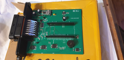

Posts: 3795
Been thanked: 411 times
Re: Arduino DUE VCU with analog and CAN control
I just couldnt resist and i quickly modified V4.3 DUE shield.
I added 3 NCV switches and wired them to existing power outputs.
I kept 5 ULN outputs but I did double two outputs on the ULN chip so you could use it up to 1A too.
I kept 5 pull up inputs which can be used with external buttons.
I had to reroute 12V to keep 4 PWM output transistors.
PP pin, CP pin with possible PWM sensing.
2x CAN bus
2x analog inputs prepared for hall pedal sensors
I expect Serial1 pins could be connected to Wifi module too...
I will have to work on V4 schematic in the next days but i think you get the gist.
EDIT: I forgot to add CP transistor to pull EVSE in...fixed
DUE VCU 4.3.zip
(169.39 KiB) Downloaded 407 times

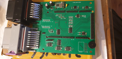

Posts: 3795
This weekend i designed a shield board with full Arduino due on top.
This is meant as a quick DUE VCU V6. I will probably make 5pcs for testing and later i will develop V6.1 with some more input ptotections.
Could be that DUE board would be easier to develop then ESP :).
Case is made of alu with 2x 24pin sealed connector from aliexpress. I couldnt find its 39pin equivalent pinout connector. If anyone has its library it would be much appreciated.
https://www.aliexpress.com/item/3291424 ... 4itemAdapt
EEPROM of course...
3x analog inputs via resistor divider. They were meant for throttle pedals or similar 5V inputs...
Cp pin logging
PP pin input
3x NCV transistors
Piezo buzzer for error reporting.
Quad opto for those inputs that need to be 12V.
Rest inputs i based on resistor ladder pullups to 3V3 and need to be pulled down to GND to activate. Otherwise chip may be damaged.
Likewise i used 3x ULN chips with doubled pins for true 0.5A latching. I am confident those outputs will drive any signal relay reliably.
I reserved one ULN chip to drive PWM outputs. I used 4x resistor ladder tied to 12V.
There are 2x CAN bus chips
There is WiFi connector on serial2.
Board could be used without 5V regulator, since DUE has its own. But i suggest to put one in since various pedals and switches can tax 5V regulator too much...
DUE shield V6.zip
(210.1 KiB) Downloaded 383 times

Imade some small changes to V6 board.
I put a voltage divider on input pins of the opto. Now they can be used even if you dont have the opto. You just populate those resistors so you can sense 12V signals directly.
I rotated Wifi module so it will clear the casing.
I added 5V to 3V3 regulator. The argument is sometimes 3V3 regulator on DUE can ack up and the second one can provide stable power.
I also needed to reconnect 5V lines and 12V input. 5V is so limited it cant be used to drive logic of DUE board. But just for testing you can use the board 5V output. I recommend you add true 5V converter later for a full product.
I replaced the files in my previous post so you will need to redownload them. I dont want to make 6.1 design before i even have proof of concept made.
I will send boards for manufacture. I only get the bare boards, that is the reason behind this shield conforming to DUE board...
Incidentaly when i made a CAD (carboard) board design :) i discovered i would need to remove the DUE board power socket. It seems a small sacrifice and i will power the board from its Vin pin anyway.

I got my V6 boards from MFG. Some photos later.
Its a simple dock for Arduino DUE board so maybe not really robust, but i have used that in my Pug for 2 years now. I only had to replace DUE board once and it was my fault... providing 12V into pulldown pin!!! :twisted: .
For now it seems i can use this VCU setup for at least 4 things if not 5.
1. Chademo protocol control with some reshuffling of I/Os in code
2. Leaf drive stack VCU control
3. SimpBMS like controler which would require code porting
4. Outlander drive VCU again requires some code porting, but most of the stuff work with my V4 already
5. Any other I/O control with 2x CAN bus, maybe even Zombieverter.
Sadly i dont have 4x CAN bus transcievers so i dont think we could use this for control of Lexus drivetrain. Would have to make another board... maybe later :).

Like i showed before i developed a V1 of ESP32 VCU design. I shuffled outputs a bit so i cleared the dubious pins. I still need to test it, but it looks good.
My goal is to develop the code for this board which would be able to run Chademo process a BMS or use it as VCU with option for wifi interface.
