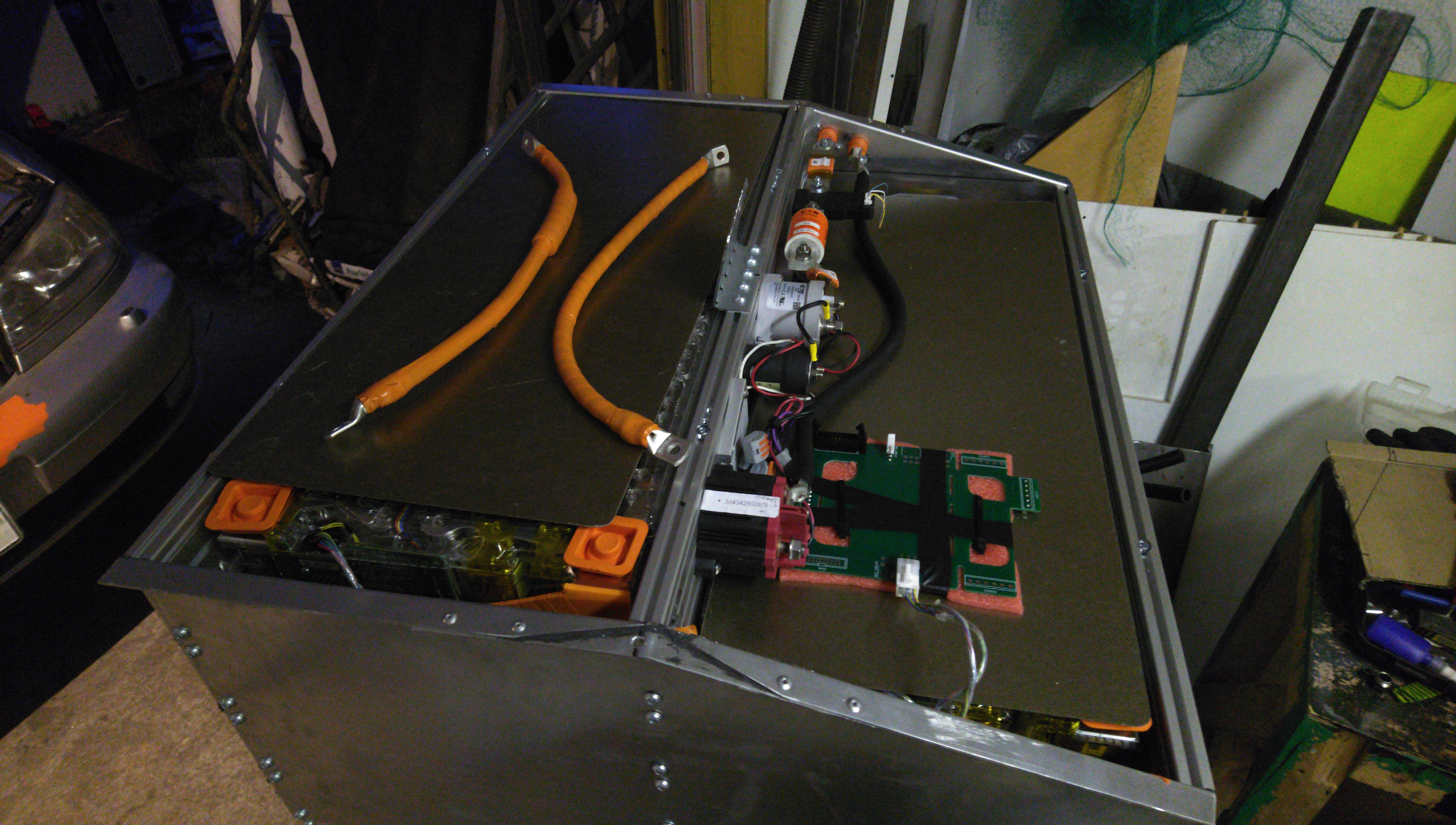

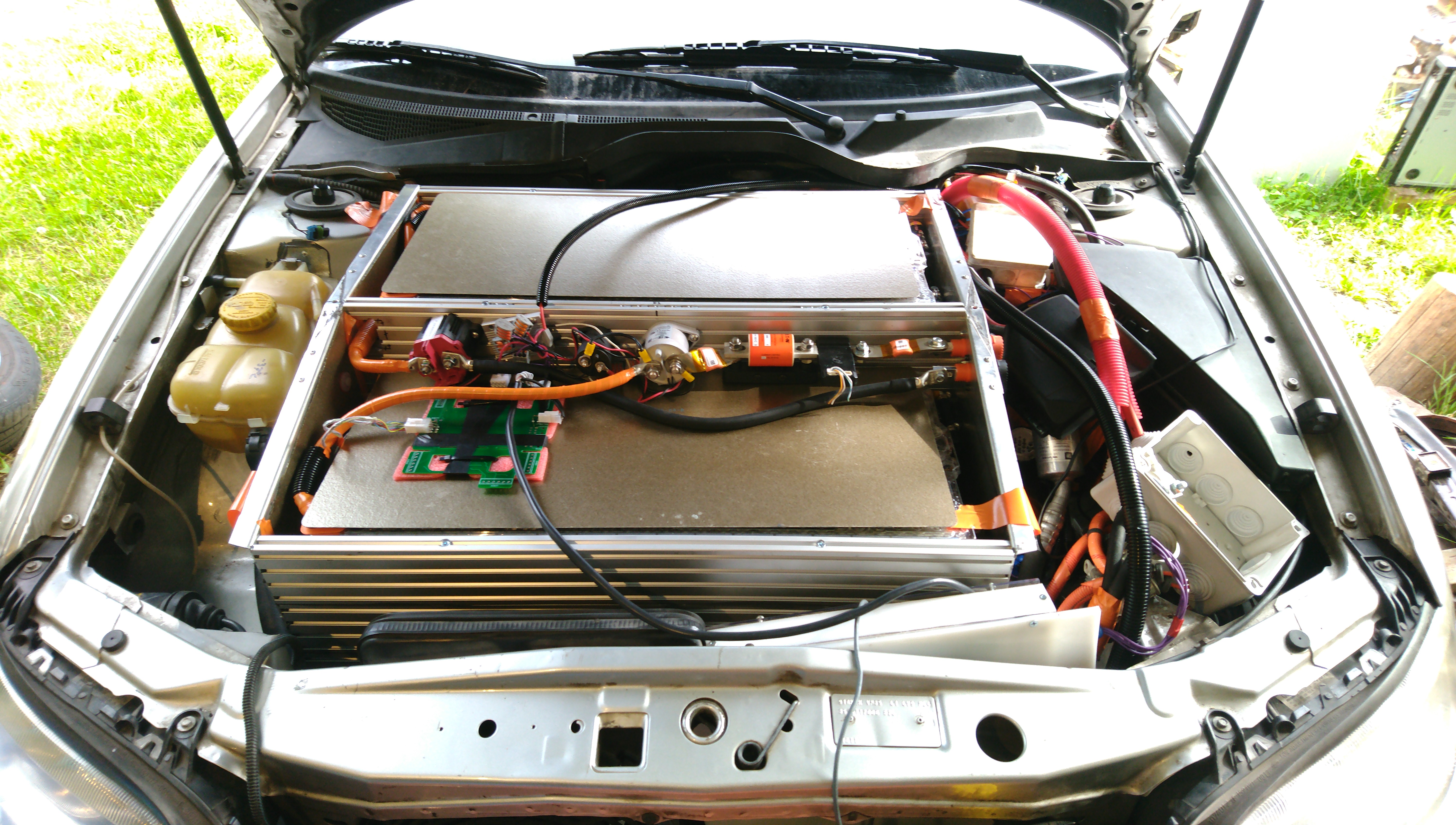

How do you like the look of very expensive? The not very expensive option is to the left.
I have to house the HV junction box at the original 12V battery location. As the 12V battery isn't really a service item and I didn't want to run super thick 12V cables to the rear, I placed it underneath the front battery box, next to the cabin heater. These are both mounted now to my satisfaction, and, as I type this, the steel parts are getting accustomed to their new coat of paint.

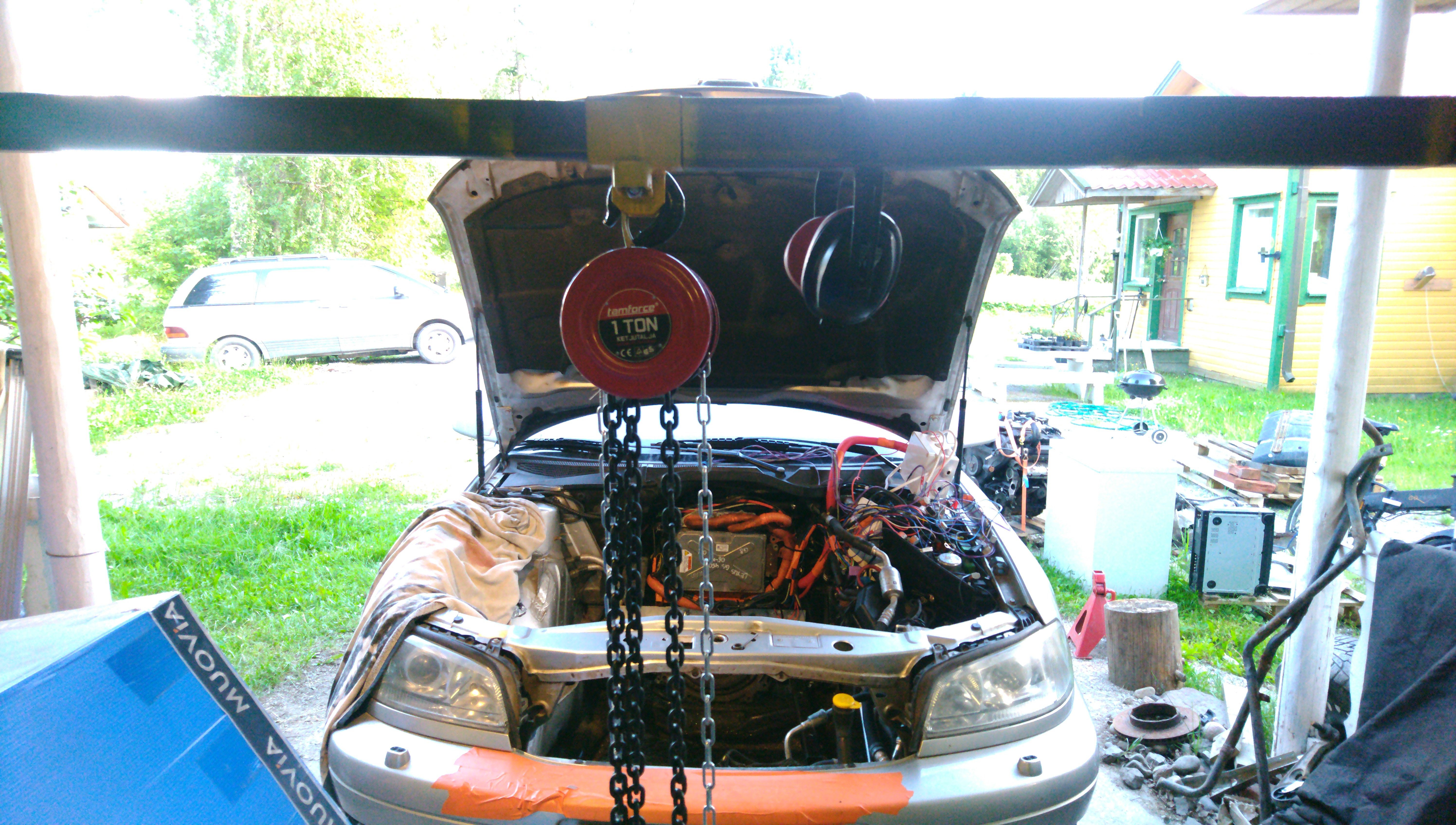

Upgraded my hoist a bit to make sure I don't drop very expensive

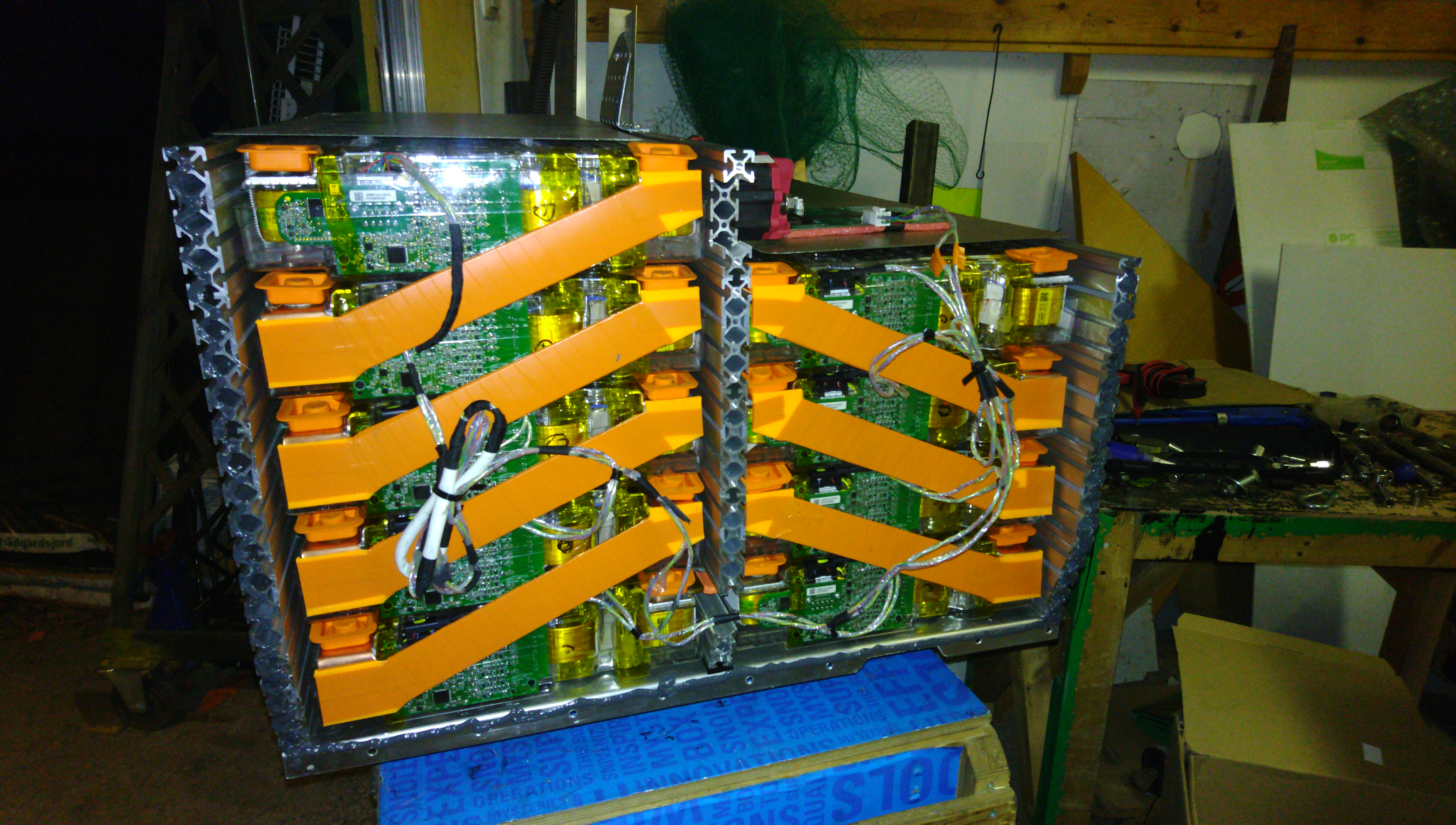

I like your battery box, looks much lighter than steel one that I build, which also took ages to build. What size and type of aluminum bar you are using?
Posts: 3795
Been thanked: 411 times
Re: Opel Omega B2 + GS450H
Interesting. Any specific reason you built it from segmented alu fins instead of bending from full alu sheet?
Post by celeron55 »
Those are 20x80 profiles. I use them because they match the module side profile quite usefully, and I need those sides to be extra rigid because the box has to be 2mm thick at the ends due to space constraints. Also I have had time constraints when designing it, and I wasn't sure if I could find a place to bend sheet metal. Well, as you can see I did find one, but that was after I made the design. This design could have been made caveman style if I had to.

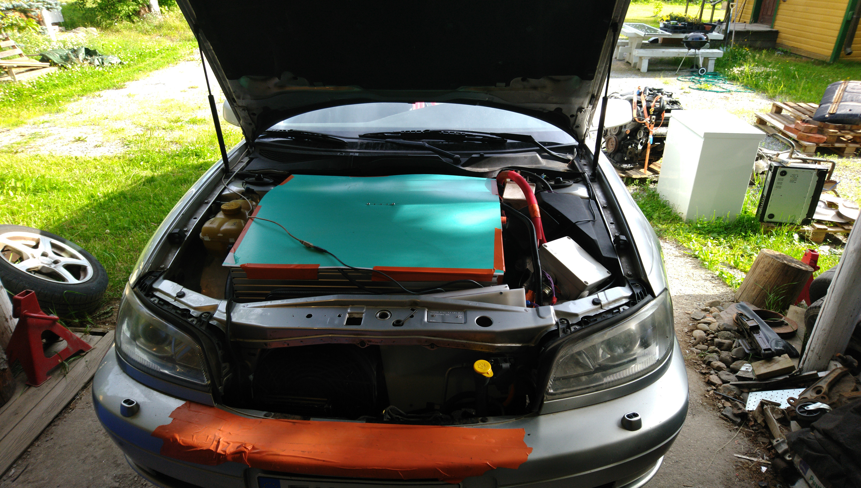

Installed HV stuff in the small space on top of the front battery box. The expensive alu profiles show an added benefit here, as I happened to have some of the appropriate cage nuts to go with them. How many? Only 1 left now. I'm that efficient. Also crimped two internal 50mm2 wires but didn't install yet.
Then I quickly modified the original Tesla harness into something I can use and wired up the BMS to see if everything worked. Had to modify the code a bit to get it going. Then noticed one of the modules looked like it had a broken sense wire, inspected it, and found two detached wires on the bottom (as they always are).

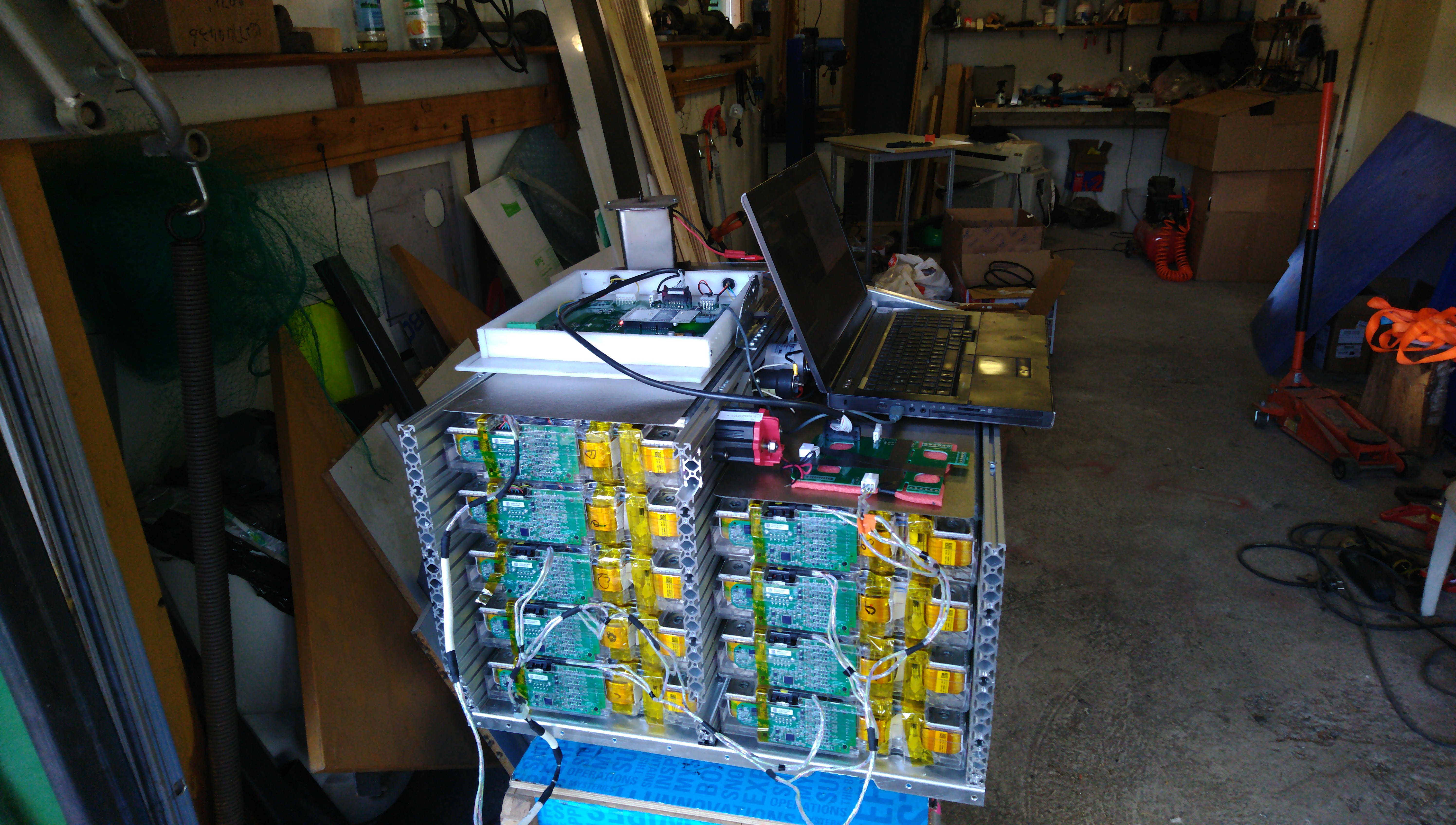

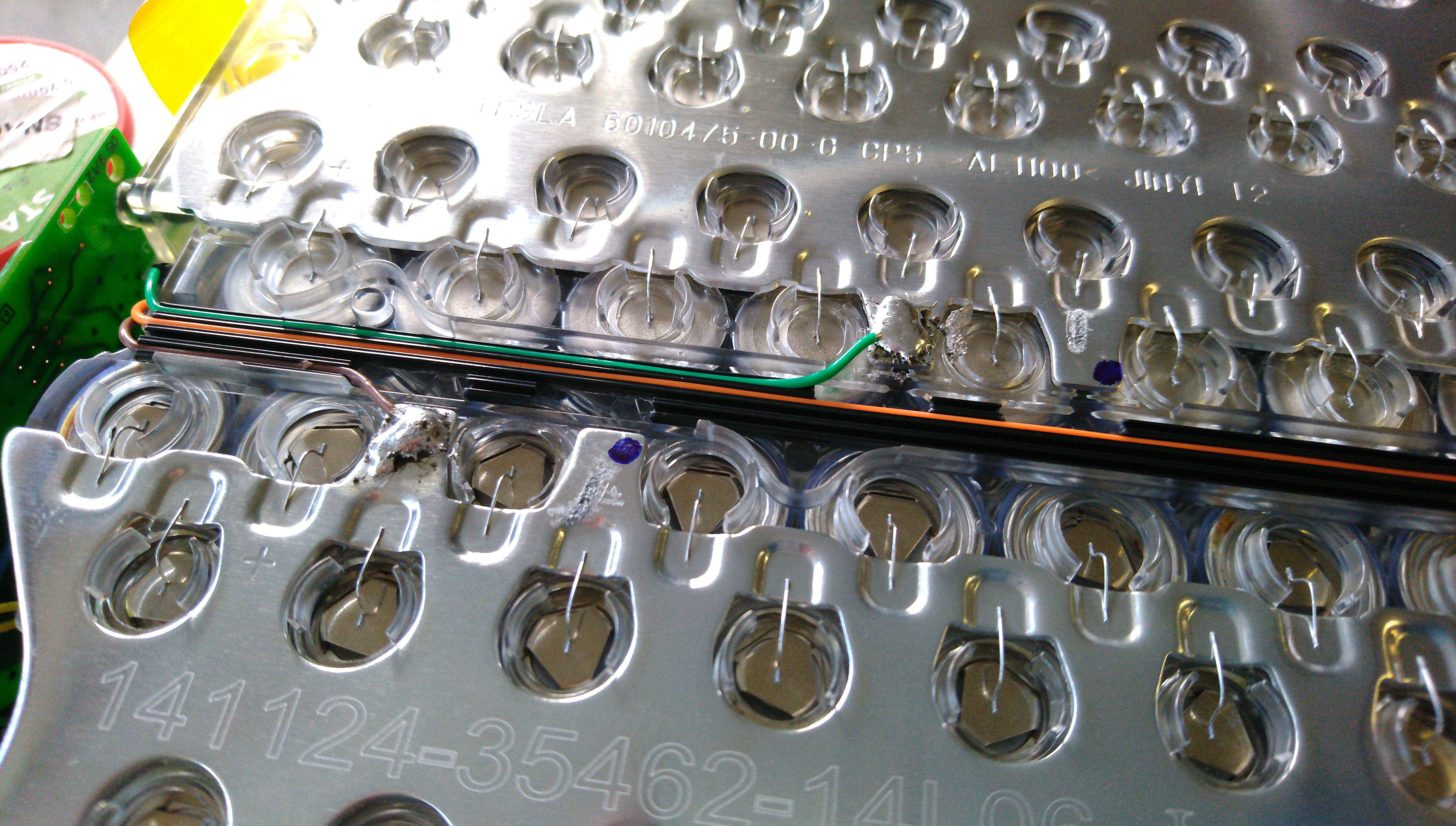

I was wondering how I'm going to get air out of the cooling loop, so I grabbed some Tesla hose connectors and... just went on with that idea. I had the space for these available and they were easier to reuse than trying to get the hoses on the non-nipples.

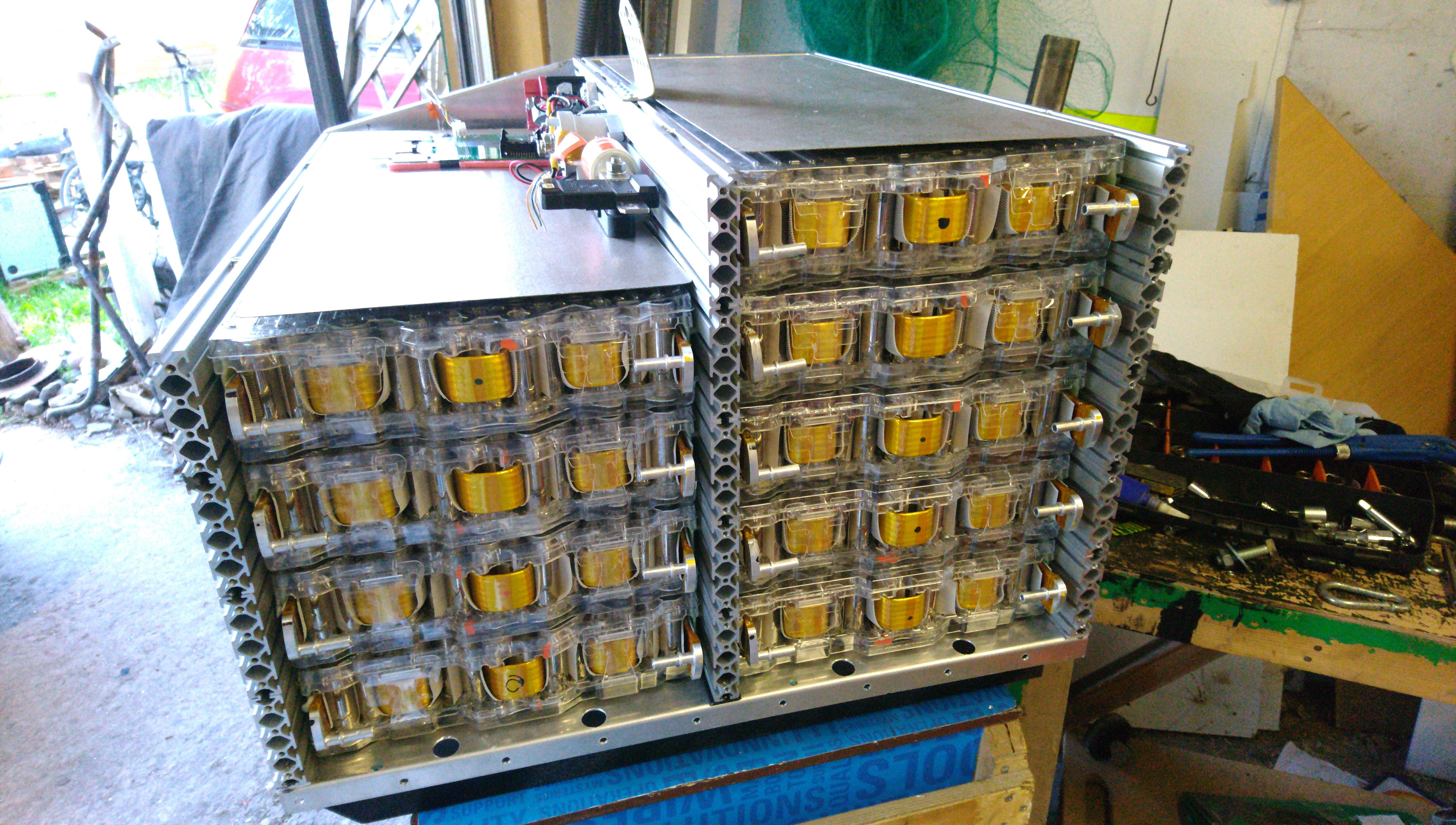

3D printed spacers to block the modules from sliding on the rails are also visible, and some adhesive sealant. The side plate is going on, with HV connectors. Those are Amphenol's cheapest 350A offering at the time of browsing Mouser, or something like that. I even managed to get them keyed, but didn't manage to find matching colors. Also, no HVIL. Might 3D print something later.

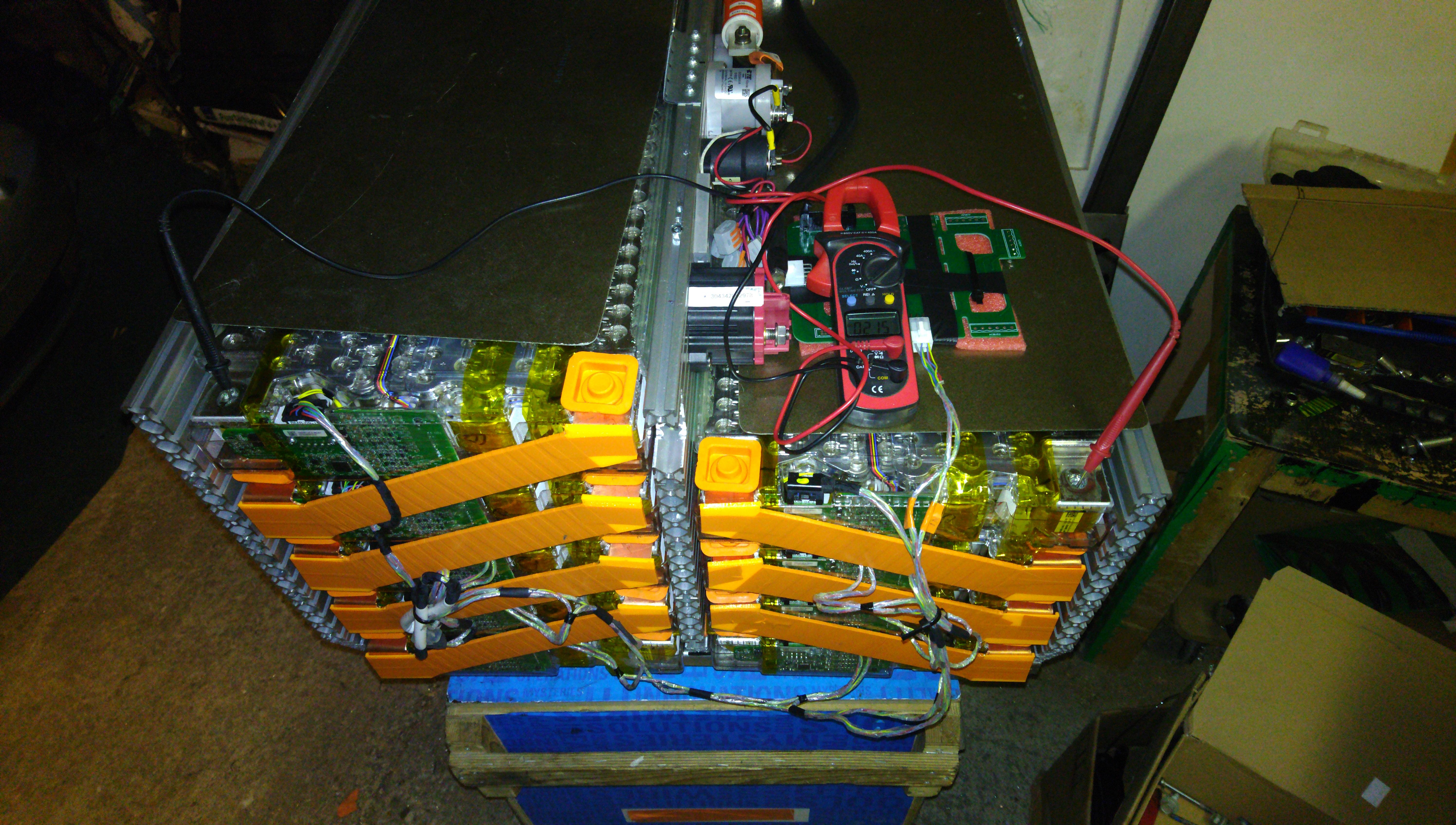

Turn the box around, and we have the scary side. Installing the module interconnects in this box is NOT enjoyable at all. There's very conductive very sharp alu profile very close to everything, the terminals are stacked on top of each other, the plumbing on the other end of the modules prevents pulling the modules forward much at all. Basically you just try to maintain focus and hope you'll die some other day for some other reason. And add lots of electrical tape on your spanner. And work with only one hand wherever possible.
Ready to provide some juice. 3.98V/cell.
Add some insulating fiber sheet (the Tesla variety) on the aluminium side plate, Add the spacers, add the adhesive sealant, screw on the side plate. Also seen are the final cables from the module terminals prepared with orange tape and a protective sleeve where there are sharp corners.

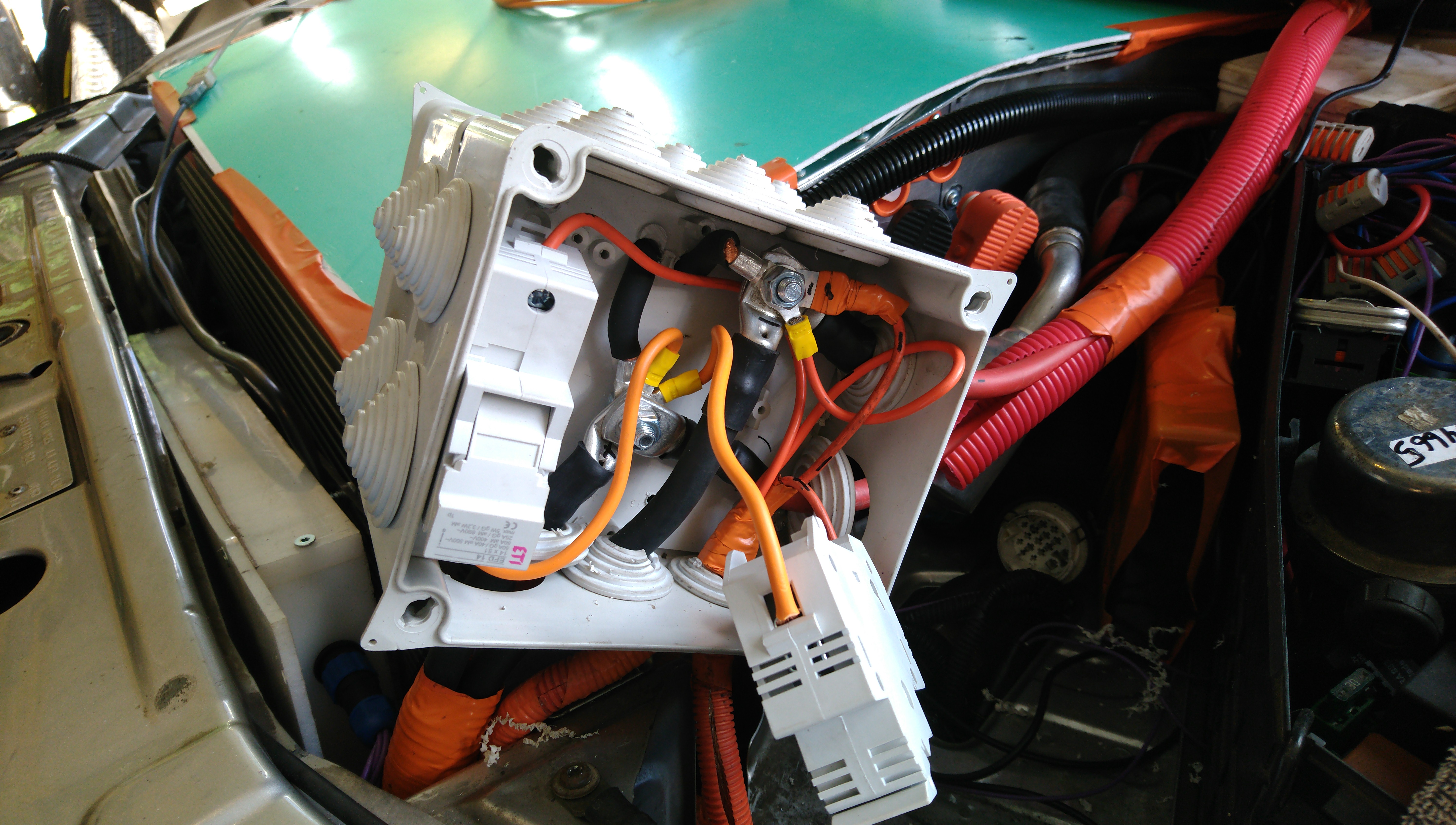

Double decker HVJB and a quick aero mod.
I hate these IP55 boxes but it was all I could get for now and they're a good size. I'll add lots of sealant to make them waterproof.

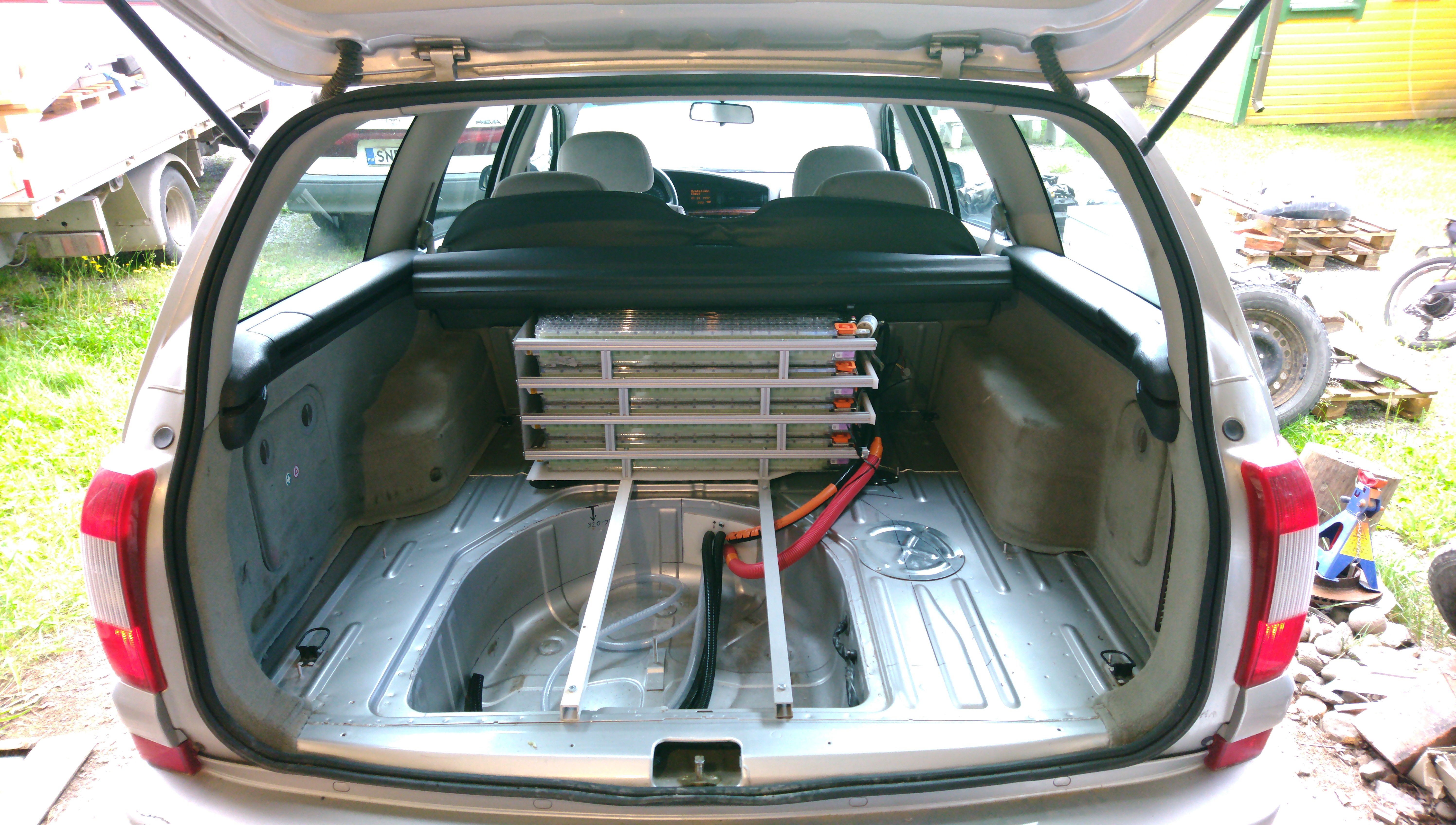

Connected the temporary rear pack electrically and made it structurally reasonable.
Weighed the car. With me inside (60kg), it's 1100kg front, 860kg rear. The maximum allowed front axle mass is 1080kg. I think I went too far with the front pack. Might have to move one or two more modules to the rear to get this inspected. Without passengers the front mass is 1070kg, so I could try my luck I guess.

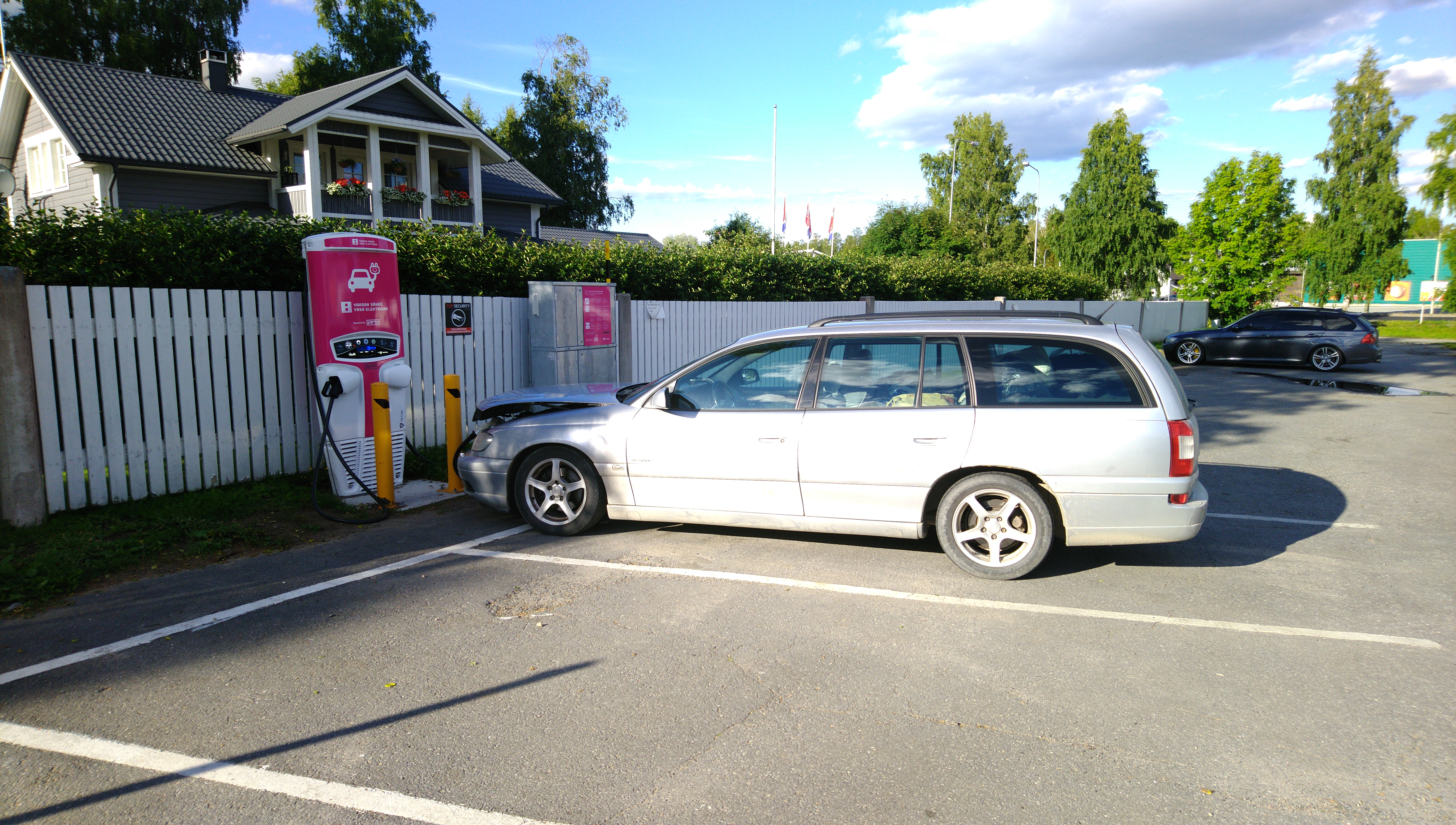

Tested the outlander OBC on a public charging station. Works fine.

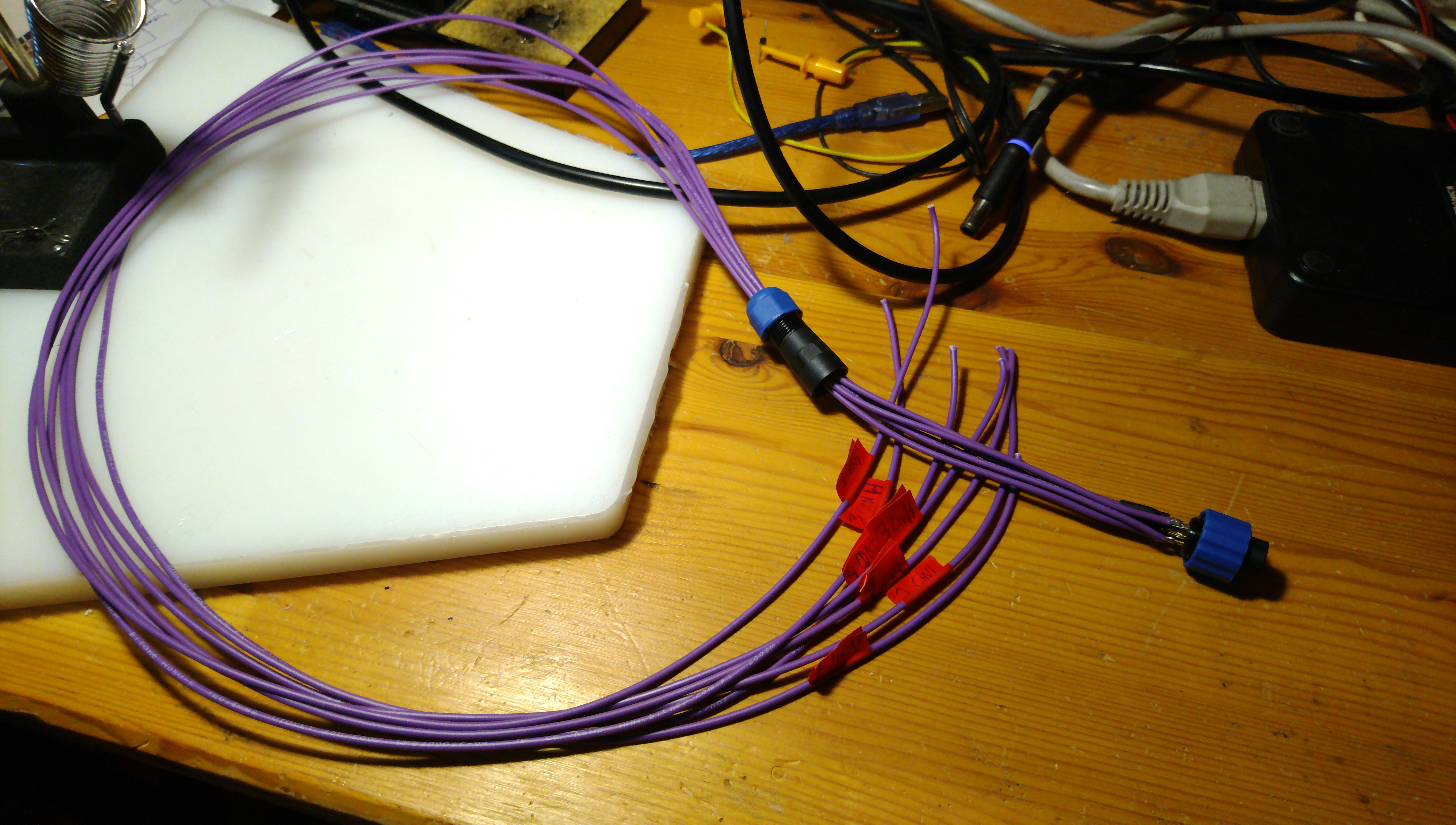

Then it was a matter of making this connector, with pins GND, CAN H, CAN L, Contactor output (open drain) and +12V power (looping the CAN cables back and forth to maintain correct bus topology) and fishing it into the necessary locations.

- Final rear battery box including enlarging the spare wheel well. Possibly with 5 modules instead of 4, moving 1 from the front to the rear to create more reasonable weight distribution, or alternatively I'll move the 12V battery and the AC charger to the rear. Will have to decide.

Here's a happy photo of the last charging stop on the trip. That's an ABB charger. Those things always work. In the background is a row of Kempower CCS units. The ABB charger has probably been raised up like that because of snow in the winter.

celeron55 wrote: Mon Aug 08, 2022 11:56 am - Some fast chargers don't detect the car at all. I have no idea why. I follow the standard very precisely so I blame the chargers. However that means I got too close to being stranded on the road trip which wasn't fun. Maybe I'll just order a CCS connector and skip right to that? We'll see.
Did those detect an other car? Are you pulling proximity to 12V with some resistor?
Not quite sure how this "detection" works anyway. But as soon as you plug in the screen says "Connection ok". Haven't found anything in the standard but may have not read it very thoroughly.
