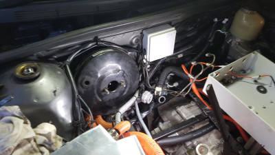

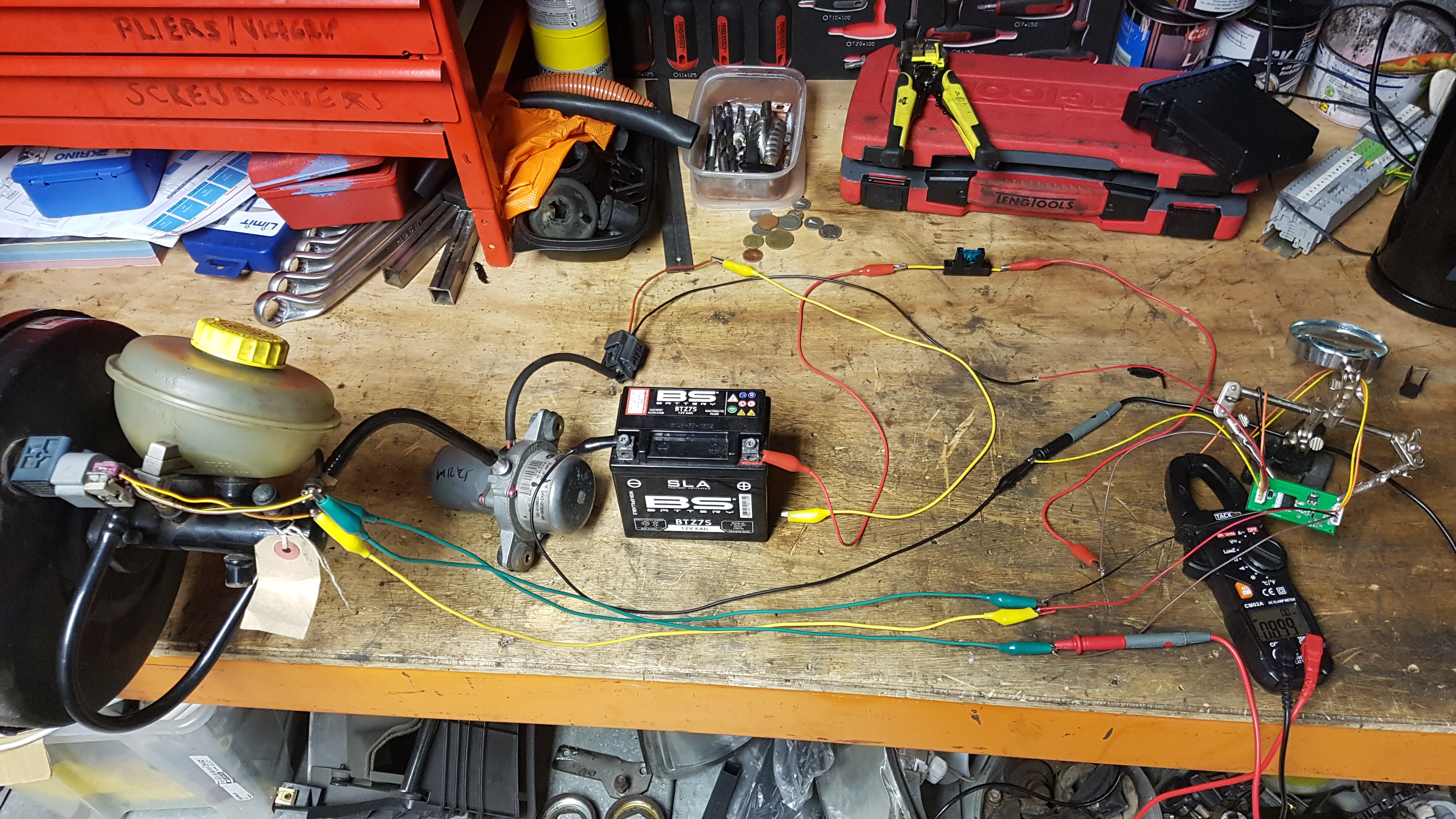

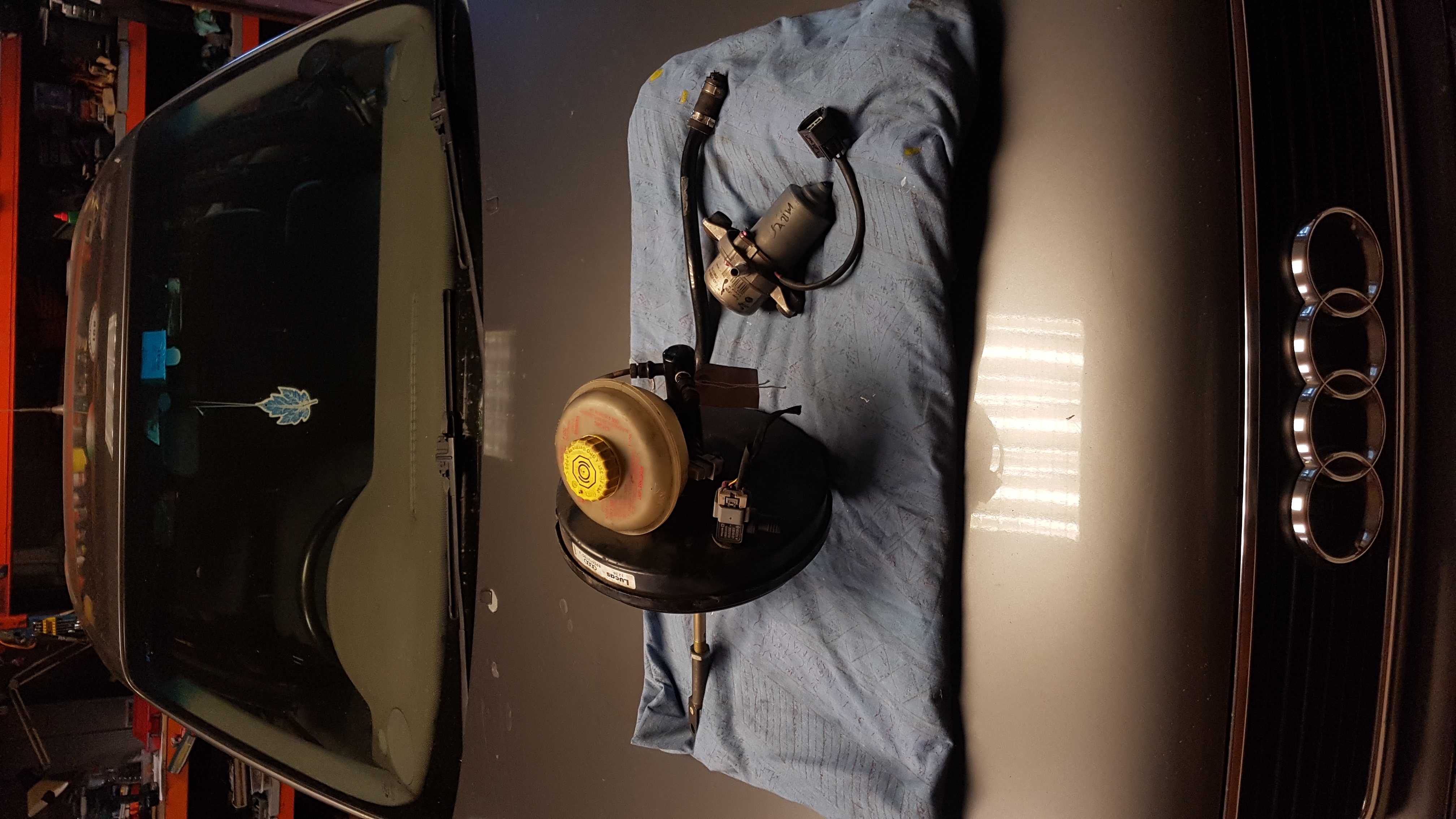

FIrst up, as promised too many times, I got stuck into the new brake servo. Remove the old hydraulic system and slide in a tried and tested vac system with a servo from an 80 Cabrio, a UP28 Hella pump from a Jag, vac sensor from a Mk4 Golf, a vac reservoir from an A8 and finally a mosfet switch to do all the switching on and off, courtesy of Johu. All bench tested and then finally installed, it works a treat.

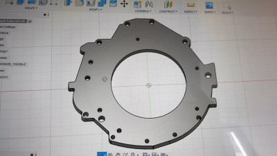

After that, I went and tackled the job I had been putting off for ages and dropped the rear pack. Not too bad in the end and came out pretty handy. With that however came out the charger, rear HVJB and all the fittings. I have already committed to building a proper sealed battery box though in CAD and getting it made up with proper HV connectors and the like. Next was to retrieve the BMS and open it up... which was ugly. I must say, the box did a great job of keeping the magic smoke in though :lol:

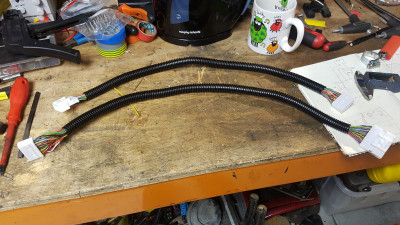

The plan, aside from swap the BMS for one less charred, find out what the hell happened and replace. I went back to where I had had multiple changes of heart when wiring up the voltage taps on the separate 4 module pack in the front and with a heavy amount of documentation found that yep... I had friggin mixed up 6 taps. Bugger me. While I was at it, I re-checked every tap in the rest of the pack so I was 100% before bottoming it all up again. As you can see in the pic above, I extended the rear pack wiring out after a couple of nights making up 2 x bms jumper looms so I could have the BMS in the boot.

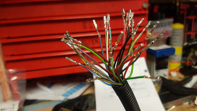

I could have simply done a solder joint extension but had a few molex connectors and crimps so, went that direction. If anything, honed my crimping skills. As I was on a roll, I decided to tidy up some LV things up front that I had let go, like putting in some 80A fuses for the PS pump and between DCDC and 12v battery. I also put in a 12v isolator switch (see it in the bottom pic on the RHS) and a new safety inertia switch fitted to the bulk head to knock out the 12v power to inverter and VCU in the event of a shunt.

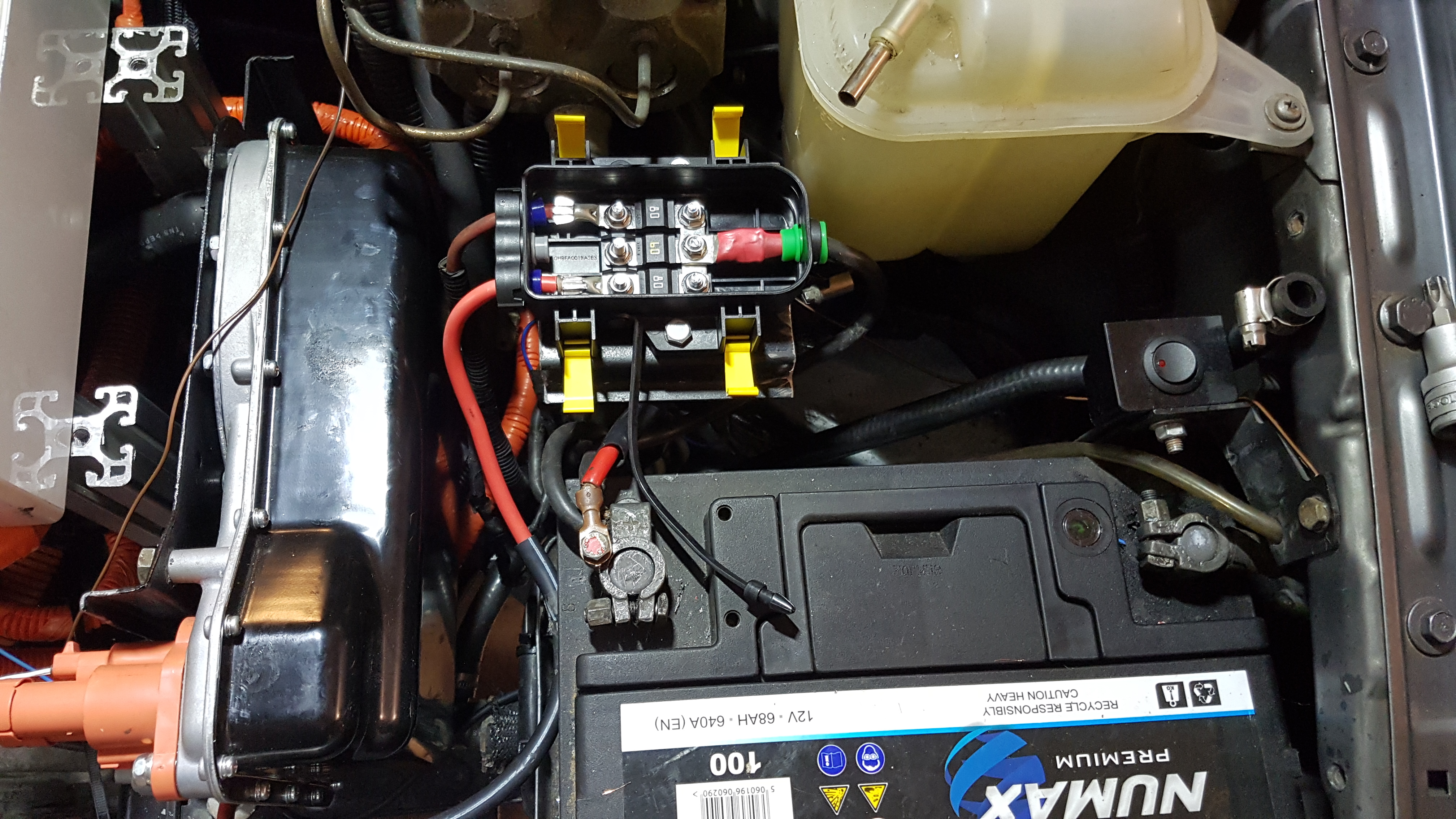

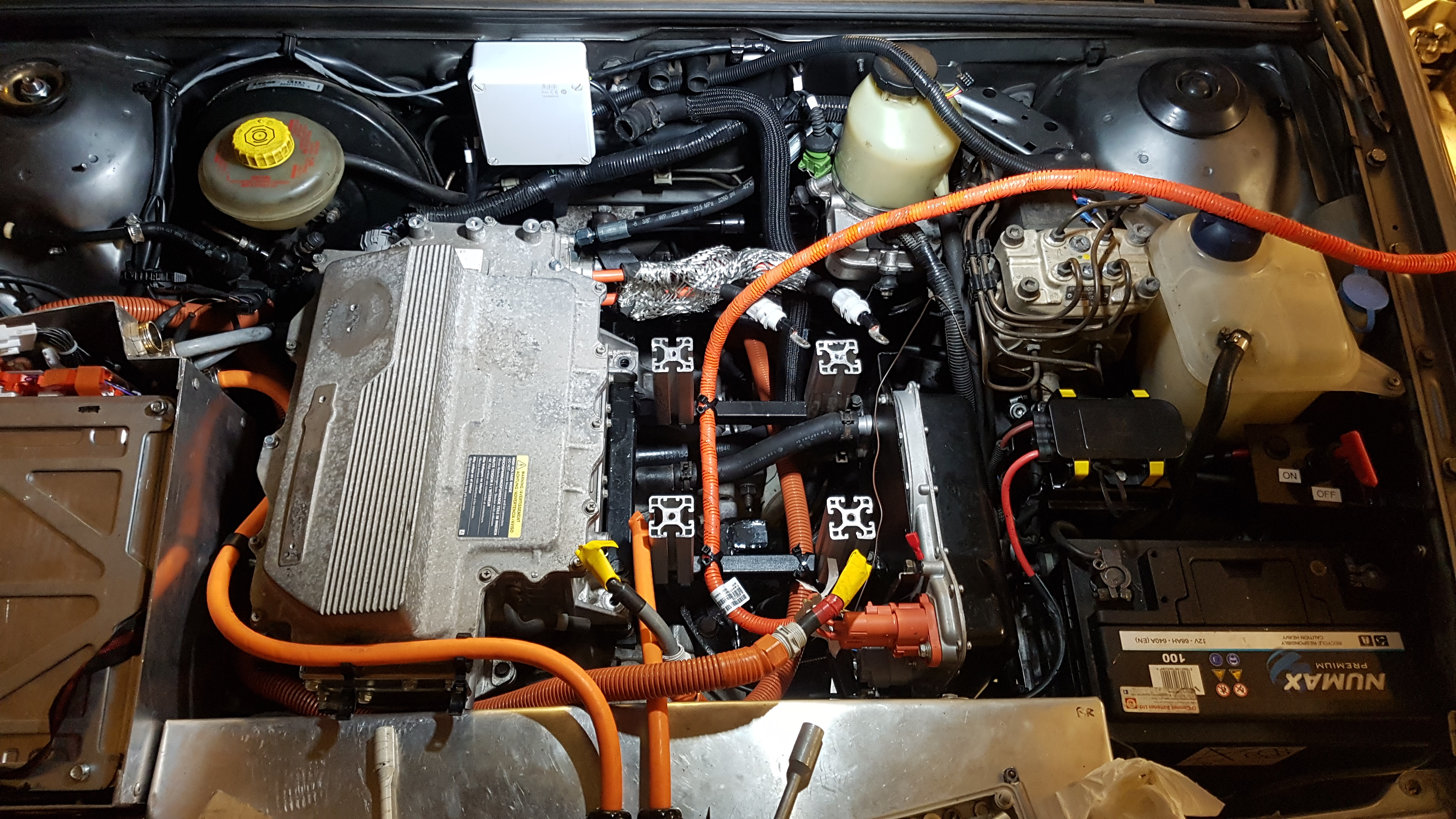

A few other things I decided to do also were to upgrade the messy DIY shielded HV up from for proper 50sq shielded cable from HVJB to front pack and from front pack to 4 pack. Really tidies the bay up and just gives me a another piece os mind I have brought the standard up a touch.
All this had me on a roll and was well chuffed after months of not doing anything due to work and family commitments. The day came to put it all back in. It looks brilliant! Re wired the BMS connectors, following all detail directions, to work with the later Leaf unit and plugged them all on, one... by one... 1, 2, 3, 4,, 5... FIZZ POP!!! Two or three little sparks rose from the board.... BOLL@CKS!

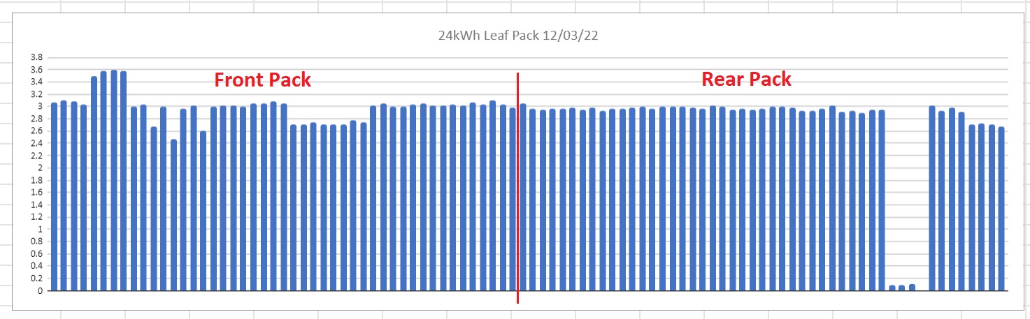

Long story short... I left it for 3 weeks. Just glanced at it when I passed by the car in the garage and then took the board to the bench. What the hell... when I tracked the damaged diodes back to the connector... it led me to cells (in around 73 to 80 in the front pack. What the hell?? Popped the lid. Continuity checked... everything... top to bottom. Perfect. CHin scratch. I then removed all the bus bars.

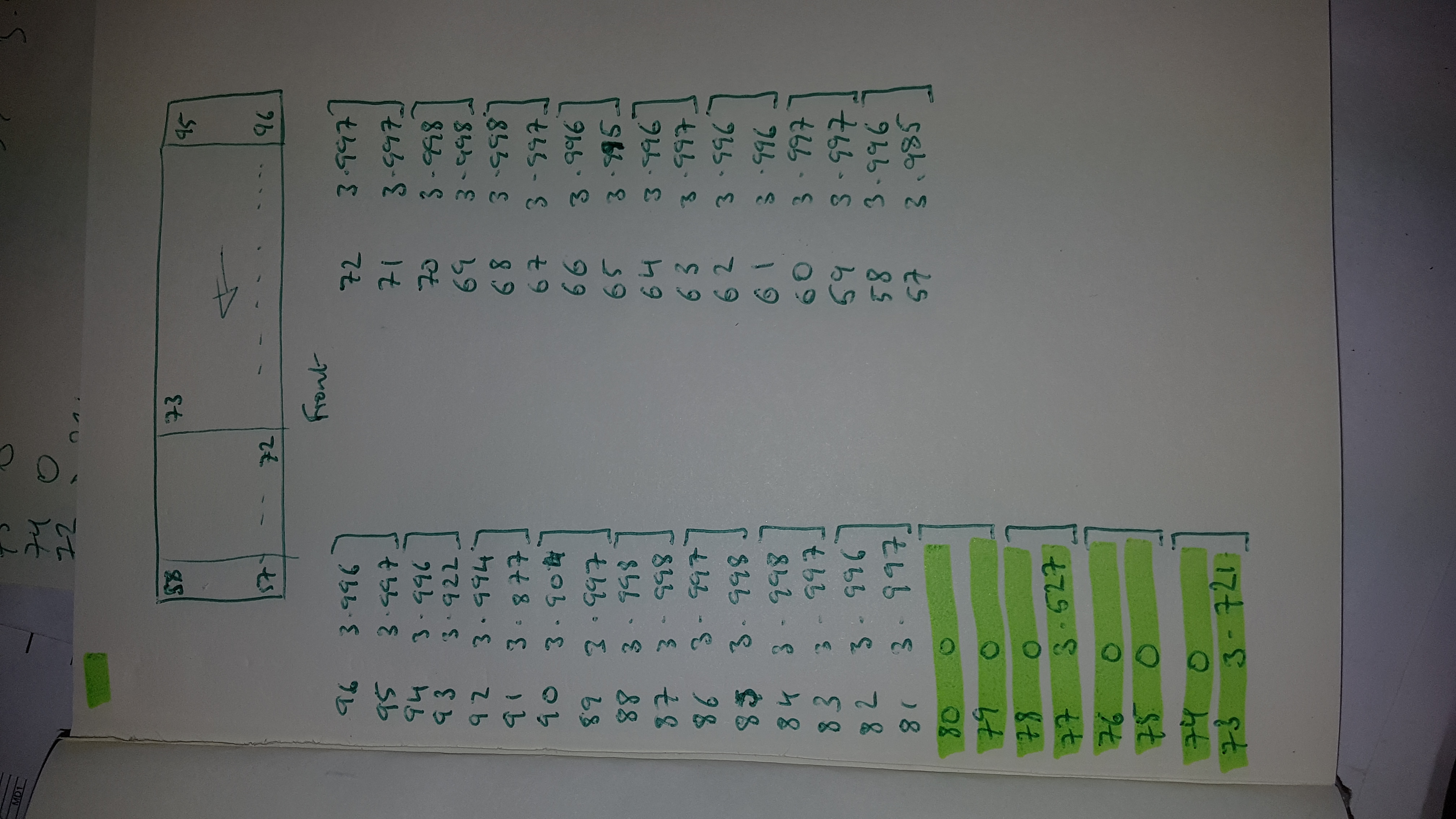

All the way along from Cell 96 back 3.98v, 3.97v, 3.98v, 3.99v......0v... 0v... 3.52v... Oooooh kayyyy. In a nutshell, for whatever reason, in the process of only 3 charge and discharges, with no BMS, three modules have shat themselves. Anyway.,... thanks to the OI and Course past pupils in the community, within the space of a day I had sourced 4 (yes 4... in case) new modules AND a replacement BMS... I'll use the one I popped for spares. So, it'll be front pack out, see what the hell happened. More than likely they suffered from voltage drop rather than an over charge. Interested to see if there was any swelling...
On that bombshell, I hope to get the car moving again very soon as It's well overdue a spin.... Always carry protection kids. Always use a BMS

Argh what a hell to go through! I believe the damaged BMS must have discharged those modules. Or was it not at all connected? After I had popped my LBC I noticed increased current draw on the damaged channels. Leave it on there for months... well.
Also the LBC is very sensitive on loose connections. Forget to tighten a bus bar or cable, next time you charge current flows via the BMS instead of the bus bar. Pop.

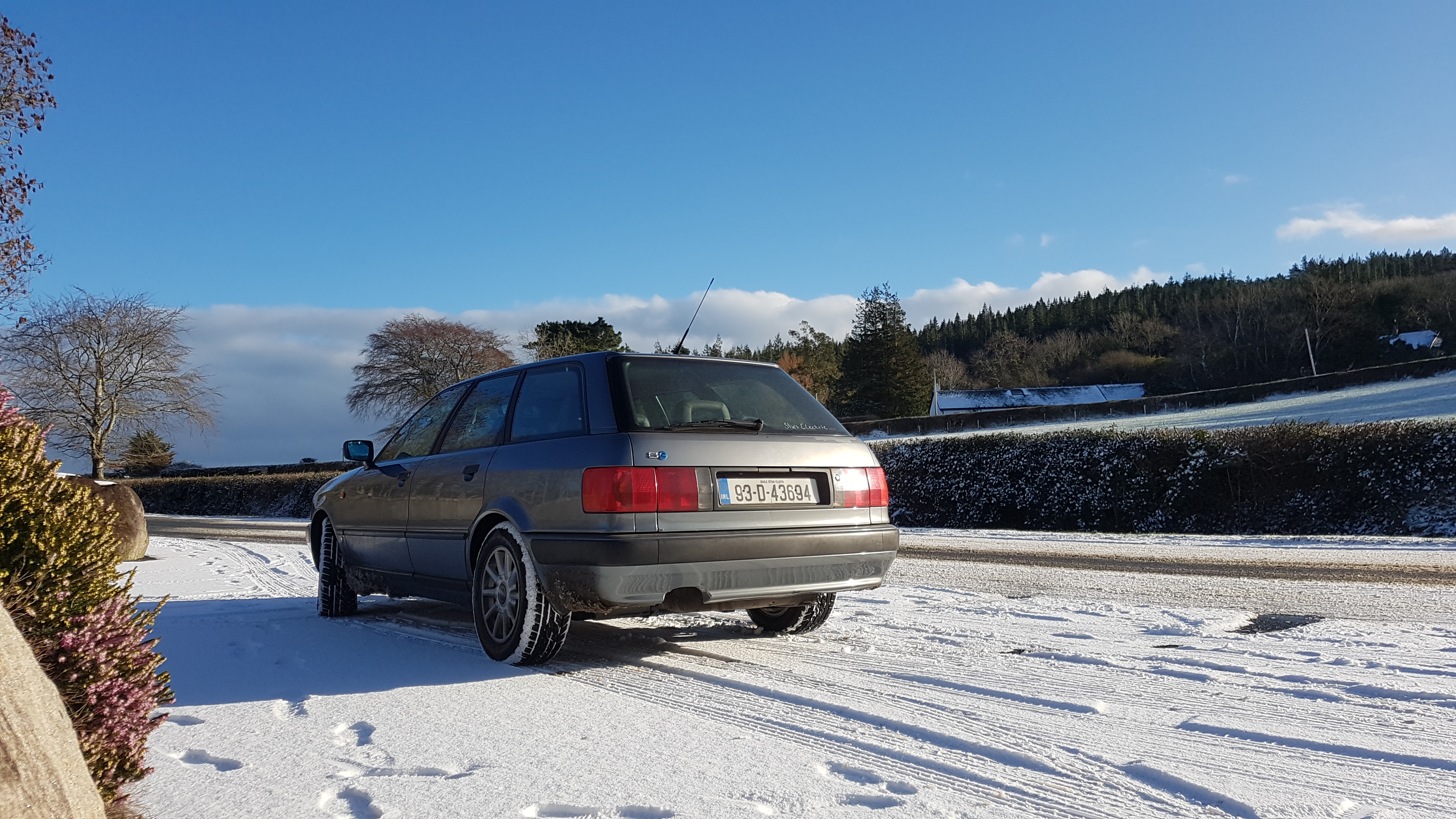

Seems like forever and in fact, it probably has. The 8e seemed to have a brief a successful few months and then went on hiatus. And it's been driving me mad.
The reason? Multiple. #1 is being back in full-time employment and #2 emerging out of the pandemic meant life including everything that comes with a family of three kids trying to make up for the time we were only allowed to do laps of the garden. Saturdays and Sundays once more became a busy frenzy of sport and activity related running back and forth and evenings getting everything else done that was not possible during the workday. Pretty much, the same as many out there! Just meant that all the jobs to fix the BMS and battery problems went well and truly on the back burner :(

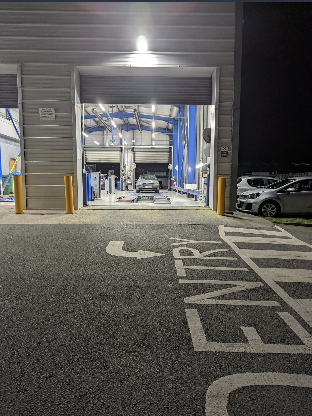

The good news is, it is fully road legal!! It got its NCT (MOT) here in Ireland after only a few fixes on the wishbone's but was bloody over the moon when they passed it. It was the same place Damien got his checked so they were familiar but no favouritism :lol: . They were very thorough but once it was passed and docs handed over, they were all questions.

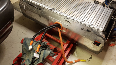

So, the plan? the issues? First off the bat is, well. The battery. If you remember, back in the day when I let the magic smoke out of the BMS, it looked like a scene from a Die Hard movie. On the back of that, I discovered I had wired the voltage taps wrong and once I had rectified that, I injured another BMS (only slightly - recoverable) when I did not notice that 3 modules had crapped themselves and were at pretty much 0v. Modules were replaced (thanks to Glyn Hudson) and balanced (with help from Paaa), I hooked it all up and a couple the chips began to... get toasty. Fffffffffffffriggin hell!!!!! What did I do? I rolled the car into the workshop and put a blanket over it. That was November 2021.
In early March this year, I took a courage pill, slapped myself in the face big Willie style and rolled it out into the sunshine and proceeded to take a recording of each cell tap. Remember - I still had no BMS to report back what was in there.
And there she was..... The Rear Pack... the pack I had never opened, taken apart, fiddled with - two big fat dead modules. Excuse me while a scream into a pillow for an inordinate amount of time. I rolled the car back into the workshop, found the blanket and draped it over the Audi once more.
The theory is, as BMS#1 died and fried, through all the multilayering of the board, it took out those 4 cells living happily on the far side of the board from the carnage opposite. It never clicked in my head to do a voltage tap check on the rear pack. I thought it was hunky dory. You live and learn.
Plan? Let's get this on the road again. What do I need? Three new modules because one other has gone below 2.5v for a prolonged time and I'm not happy with it and the other two for the obvious reason. That's a front and rear pack out job but, I'm resigned to it now and I know I can do it with help over a weekend. So that's, in a long way round, where I am. Apologies for the very very.... very tardy response time. I have been keeping an eye on things here but feeling totally crap at not helping enough in other people's projects, especially after the help I received. Just hope the videos I put up helped one or two people at least.

Evening all
Both the Audi and I have been off the radar for a while. Like the rest of the world, the fun some of us had brought on by lockdown, uninterrupted time in our sheds/driveways, came to an end and the busy timetable of daily life/work resumed. The Audi drove and charged, but very 'manually' and I was all out of cash. It slipped down the priority list. Until @marcexec messaged me just after Christmas about the Tog Hackerspace meet on the 26th of February in Dublin! Details are in the Events and Meetups section here. Here's another link:
https://www.tog.ie/2023/01/diy-your-way ... c-vehicle/
So, no excuses. I have been tipping away at some small stuff (replacing dodgy modules, balancing pack, automating start sequence) but, now there's a real goal to get the things that were bugging me, sorted and get it on the road full time.
Jobs:
  • SimpCharge- automate charge stop/start
  • CAN bus - run full top to toe network to all nodes
  • Blutooth ODB2 reader
  • 7" single DIN Android screen
  • Install BMS - and not go pop
  • Seal up rear pack with new HV connector
  • New rear HVJB and tidy up- charge contactor and MSD
  • Put Audi's face back on
  • Drive to Tog Hackerspace under its own electrons on 26/2/23...
Nothing like a deadline to focus the mind. Here's some more info. Hope to add more updates as I progress.
