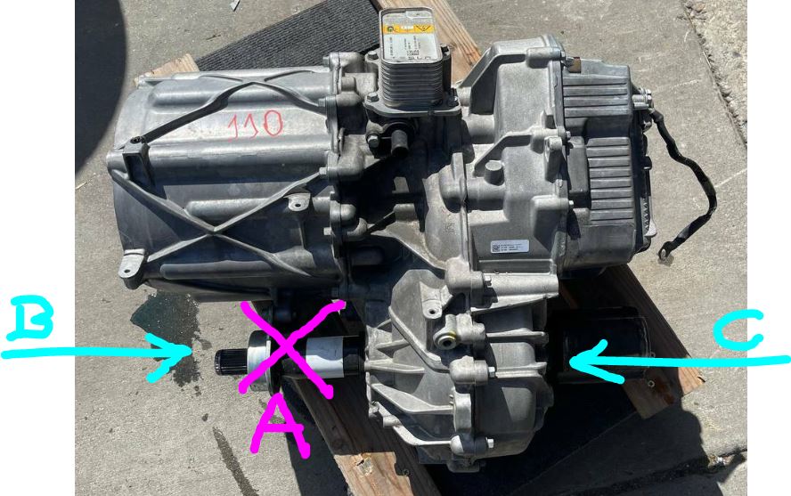

Hi there,
I am planning on using a Tesla Model S Front SDU in an EV conversion of a Subaru Legacy which will involve putting the F SDU in the back and making the car RWD instead of AWD. The reasons for this (instead of using a rear SDU) are space and orientation of the SDU within the original subframe etc...
Q: For the Front SDUs, can one remove the half shaft arrangement a A) below and use a pair of Tesla Model S rear driveshafts at B) and C)? Could work if the splines are the same right?
Then I could use a pair of basic new aftermarket driveshafts such as these?
I have hunted all over the show for the answer to the above but haven't found anything definitive so apologies for the noob question if it is detailed somewhere where I have missed it!

Hi elShankos. I run an SDU in the same manner as you are contemplating. I removed the shaft (A) and used FRONT driveshafts as the cv joint bodies are smaller than the rear from what I have learned (and spent !!) The rear type (LDU ??) cv joint fouls the casing at (A) when I tried them but please check dimensions from what you are buyng.
Two things to note...
I am convinced my torque steer (with a heavy right foot) is due to the fact my driveshafts are now of different lengths, if I had located the SDU so the differential had been central to the car the torque steer may have been less I suspect.
Secondly I purchased new aftermarket driveshafts which from the ones I bought definitely do not have the same tolerances/quality as the OEM shafts, thus the play in the joints at the diff end is greater and you can feel the difference simply when twisting by hand.
I am looking for secondhand OEM shafts now ! Who said buy cheap, buy twice ! So right.
Hope that helps and hope all goes well for you.

Yes; the A pieces is to equalize the length.
This is most important if the motor drives the front wheels.
On the rear the torque steer is more limited due to a stiffer wishbones setup.
I recommend too use the engines on their original place with A shaft.
The second advantage the A piece brings is that having the knockles closer to the wheel the shaft will make a steeper drop so less likely to fool somewhere in it's path.

Hi Peter, thanks a lot for the reply and all the details - I will then definitely go straight to OEM driveshafts as you suggest. I am aiming to centre the differential part of the SDU to keep the driveshafts the same length - but the potential snagging as you and EV_Builder have mentioned is something to be cautious of. One thing I have been wondering about is : does anyone know if there would be any issues with mounting the drive unit in a vertical orientation as below?
I'm aiming to find a way to get the drive unit to fit into the space where the original rear diff is:
Nothing is impossible right ? :D
