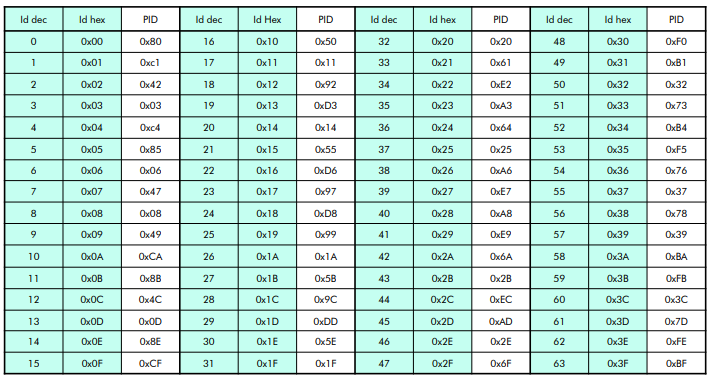

according to my program it should be like this:
back message:
ID 33 (0x61)
length 8 Byte / ENHANCED Checksum
Byte 0 =1 at HV voltage under 200V, =0 above 200V (below 200V it want work, so its a kinde of HV OK)
Byte 1 =112, always, i dont know why
Byte 2 =RPM as set via PID=32 in Byte 0
(Byte 3 =110 below 200V, =14 above 200V, =46 when er running)
Byte 3 bit 6= HV not OK
Byte 3 bit 5= running
Byte 5 =temperature 160 at 24°C, i don't know the scaling and what themperature that is til now
Byte 6 =54 at 109V, =28 at 56V =83 at166V scaling: Voltage/2

ID 32 (0x20)
length 6 Byte / ENHANCED Checksum
Byte 0 =RPM (dec 20-250)
Byte 1 bit 2 = aktivate
Byte 1 bit 0 = start
Byte 2-5 = 0

Hi, What baud rate does the VW LIN bus run at? (I have had a look through the forum posts and the wiki but can't seem to find this).
I've got some I-Pace air con valves that run LIN at 9600, the VW compressor and the VW heater and I'm wondering whether they could all coexist on the same bus.
muehlpower
Posts: 807
Has thanked: 18 times
Been thanked: 186 times
Re: VW A/C Compressor
Post by muehlpower »
Pete9008 wrote: Tue Jul 05, 2022 9:34 am Hi, What baud rate does the VW LIN bus run at? (I have had a look through the forum posts and the wiki but can't seem to find this).
VW uses 19200 baud. I run heater, compressor and the VW A/C pressure sensor on the same LIN bus.

What's more interesting is that the IDs and message contents don't all match with your results. I'm guessing that the comms may vary from model to model or generation to generation. I've only looked at the status message as I have no HV supply connected.
Compressor - part No 12E-820-803-E
Sends status on ID 0x21, extended checksum, 19200baud, message contents - 00:f0:e8:ff:ff:ff:ff:ff
Heater - part No 3Q0-963-231-E
Sends status on ID 0x30, extended checksum, 19200baud, message contents - 00:fc:c0:80:7e:48:46:46
I think the compressor ID may match yours (I think you have included the address parity bits?) The data seems different (unless this is because I don't have HV on it?). The heater matches yours.
I'll do a bit more investigation once I have a HV supply available.

in my post the PID[30] and PID[48] are decimal, in hex it would be 0x21 and 0x30

This is the complete table of all LIN addresses. According to this table "Id-dec" I send the commands for A/C at 32 and for heater at 28 and get feedback from A/C at 33 and from the heater at 48. 31 in my first post is wrong, I will correct.
The heating performance can be specified by byte 0 at Id28 and observed at Id48 byte 0

Just to add / clarify for the purist, no offence, the difference between ID and PID are the two parity bits. Both of them make one byte. So there are only 6bits for an ID. That's why we have 63 Addresses maximum.
IMHO we should talk ID not PID.
PID is implementation level.
