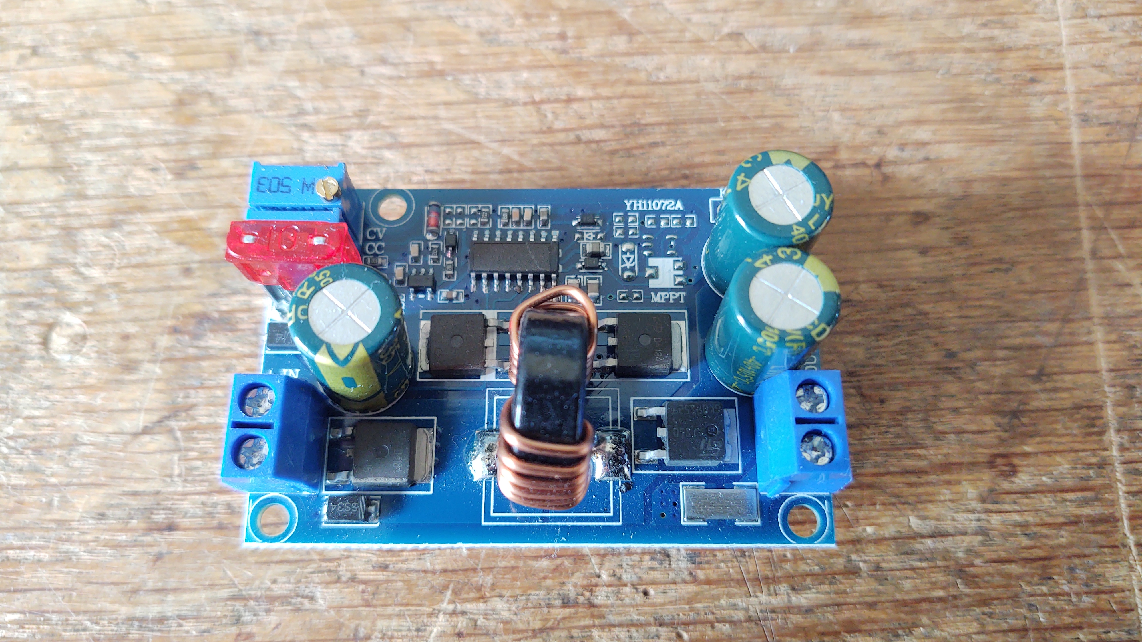

- Posts: 859
- Location: Northern Ireland
- Has thanked: 272 times
- Been thanked: 152 times
Re: Kilovac contactor has a high resistance
Assuming my battery voltage will be 14V while the dc-dc is on, my VW contactors will be drawing 8.5W so from what you are saying it is too much. If I used a small dc to dc converter I can set the voltage to anything I want so if I set it to 10V the contactors would be drawing 6W which sounds more reasonable. If I set it to 9V they will draw 5.4W but maybe it is too close to the minimum safe voltage.celeron55 wrote: ↑Tue Jul 05, 2022 9:10 amGenerally a contactor without an internal economizer is specified to require about 100ms of full voltage (usually 9-15V for 12V models) when switching on, and about half of that (5-7V) afterwards.Alibro wrote: ↑Mon Jul 04, 2022 7:07 pm As for using the VW contactors have you any suggestions about lowering the current draw? 600mA seems like a lot to be drawing for long periods so I was thinking of reducing the Voltage to them. They seem happy at 8V but maybe 9V - 10V would be safer. I haven't got my Outlander PHEV charger/dc to dc going yet so am not certain what voltage it will supply but am assuming around 14V.
The release voltage in practice will be just a couple of volts, but it won't handle shaking or full current at a few volts. It also will unreliably switch on at much lower than the specified minimum, depending on temperature, orientation and vibration.
Sometimes it's possible to drive uneconomized contactors within spec by using a single voltage. Such voltage will be around 8V for 12V models.
A rule of thumb for me is, if a contactor takes in more than let's say 7W (for a GV200 sized one), that's probably an issue. Depends on the size of the coil of course. A big coil can dissipate more heat.
Thanks Johannas, I had been searching for a thread like this one for ages but probably used the wrong search terms.johu wrote: ↑Tue Jul 05, 2022 8:54 am I found some Chinese relays to still hang on at 2.5V https://openinverter.org/forum/viewtopic.php?t=531
Would you use a simple circuit like this for your main contactors? I can't think why not but I don't know what I don't know.
BTW I tried the economiser that was screwed to the Kilovac contactor with one of the VW contactors and it didn't work. The contactor clicked closed briefly then opened again.

- Posts: 859
I found an interesting article here.
https://www.electronicdesign.com/power- ... ay-drivers
However I think for simplicity (unless someone advises against it) I will go with a constant voltage dc to dc converter and will set the voltage to between 9V and 10V. I already have several suitable modules so will go with what I already have.
Maybe I'll use this one as it is suitable for 5A.
Simplicity is king I used it on my charge port contactors which have to handle 125A. Wouldn't hesitate to use it on main contactors but Panasonic relays only take in 300mA@12V so couldn't be bothered.
Never thought contactors could shake loose but celeron has a point there. For charge port relays it doesn't matter as the car is then stationary
