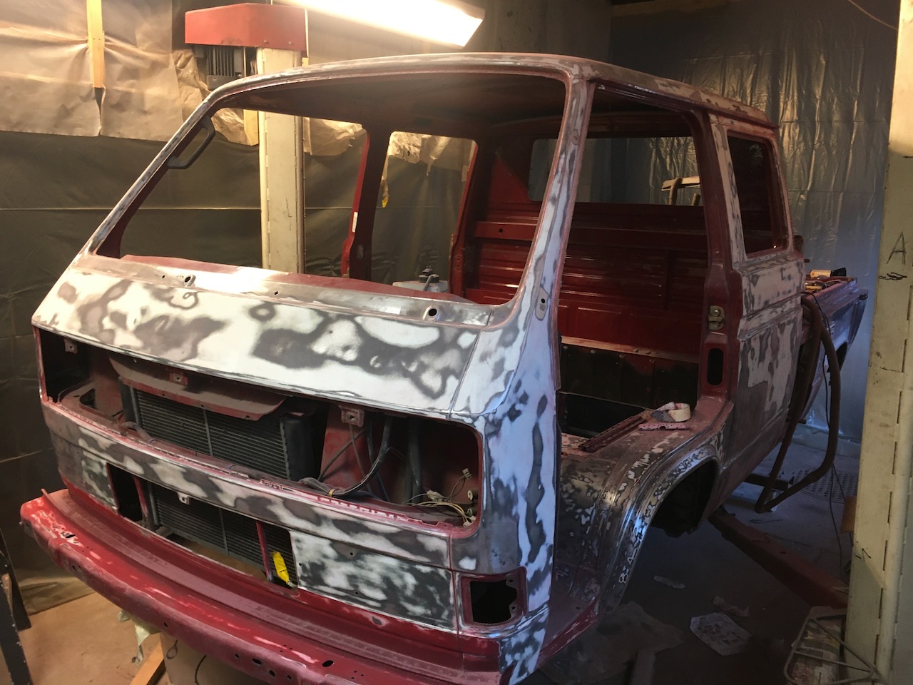

BTW: I guess it would be nice to post a pic of the T3 which should be electrified first:
The whole "rustauration" thread can be checked out on the Swiss VW bus forum:
https://vwbusforum.ch/t/monster-ii-besc ... agen/13585
But beware: The thread is long, in German and definitely not rated PG-13 as it contains many many pictures of pure and utter horror (rust everywhere!). :shock:

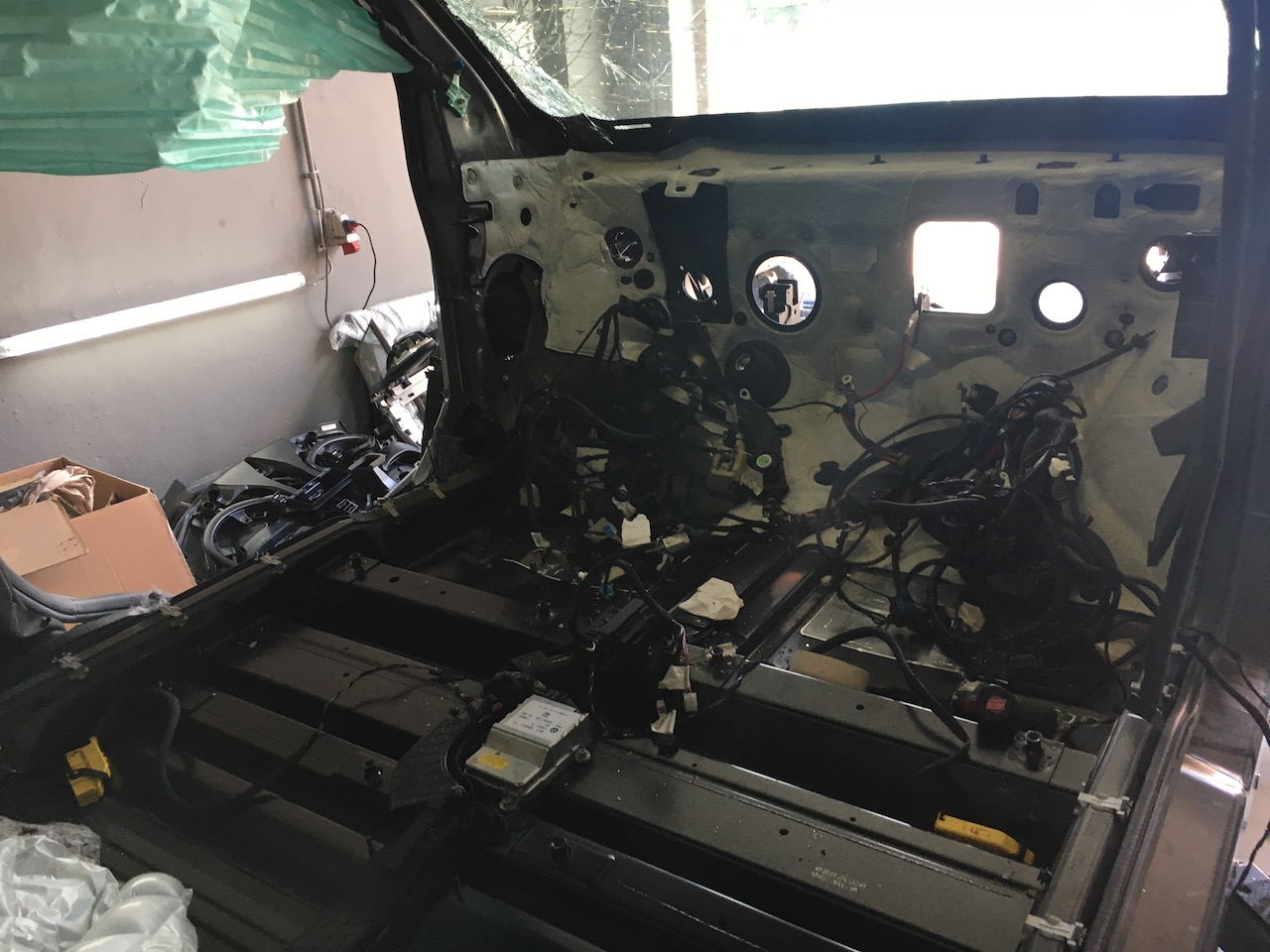

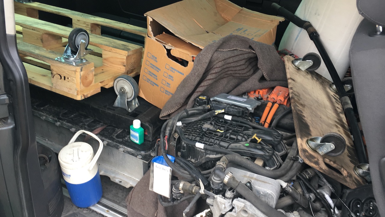

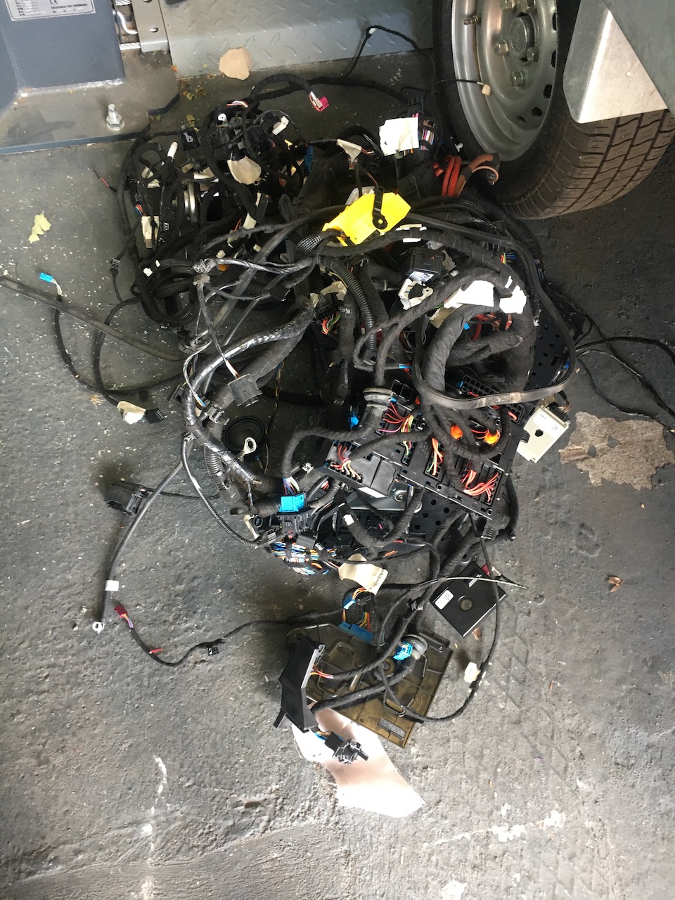

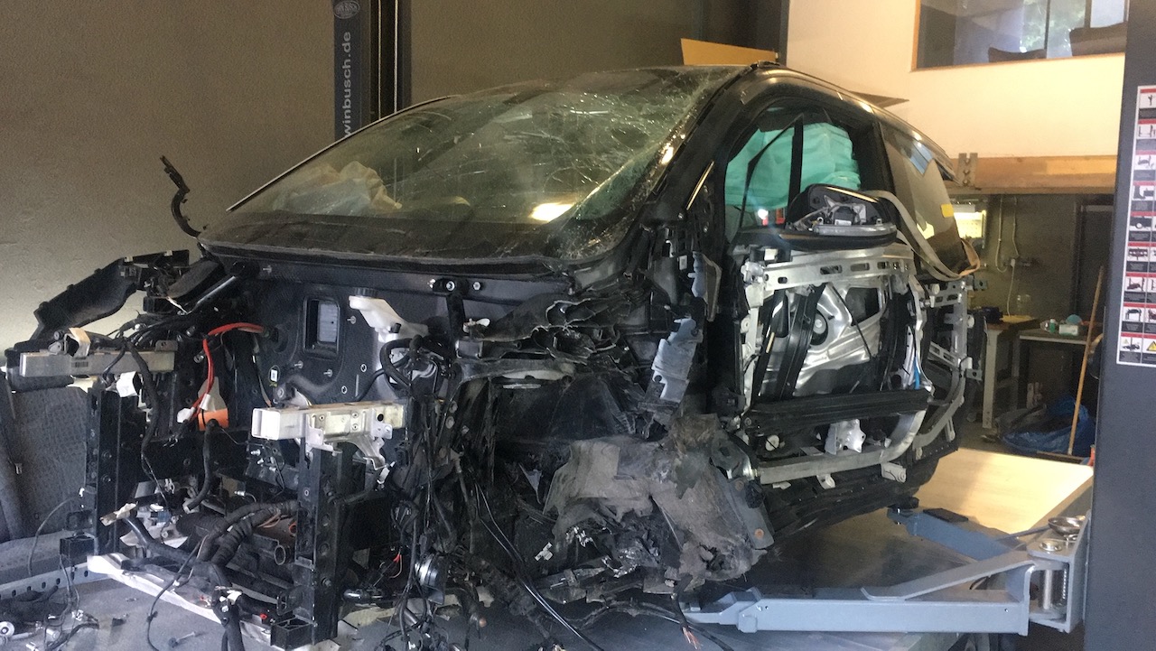

Despite the fact that
a) the BMW i3 motor / inverter seems to be pretty much uncharted territory
b) and more importantly me not having any clue about what I'm doing here
I did go ahead and picked up all the parts I could possible need last weekend from a donor car.
I did check the voltage of the cells: 3.85V. IIRC this is a tad high for storage, right? I don't think that there will be much going on with it in the next 6 months or so. So can I leave it at this?
Cheers!
