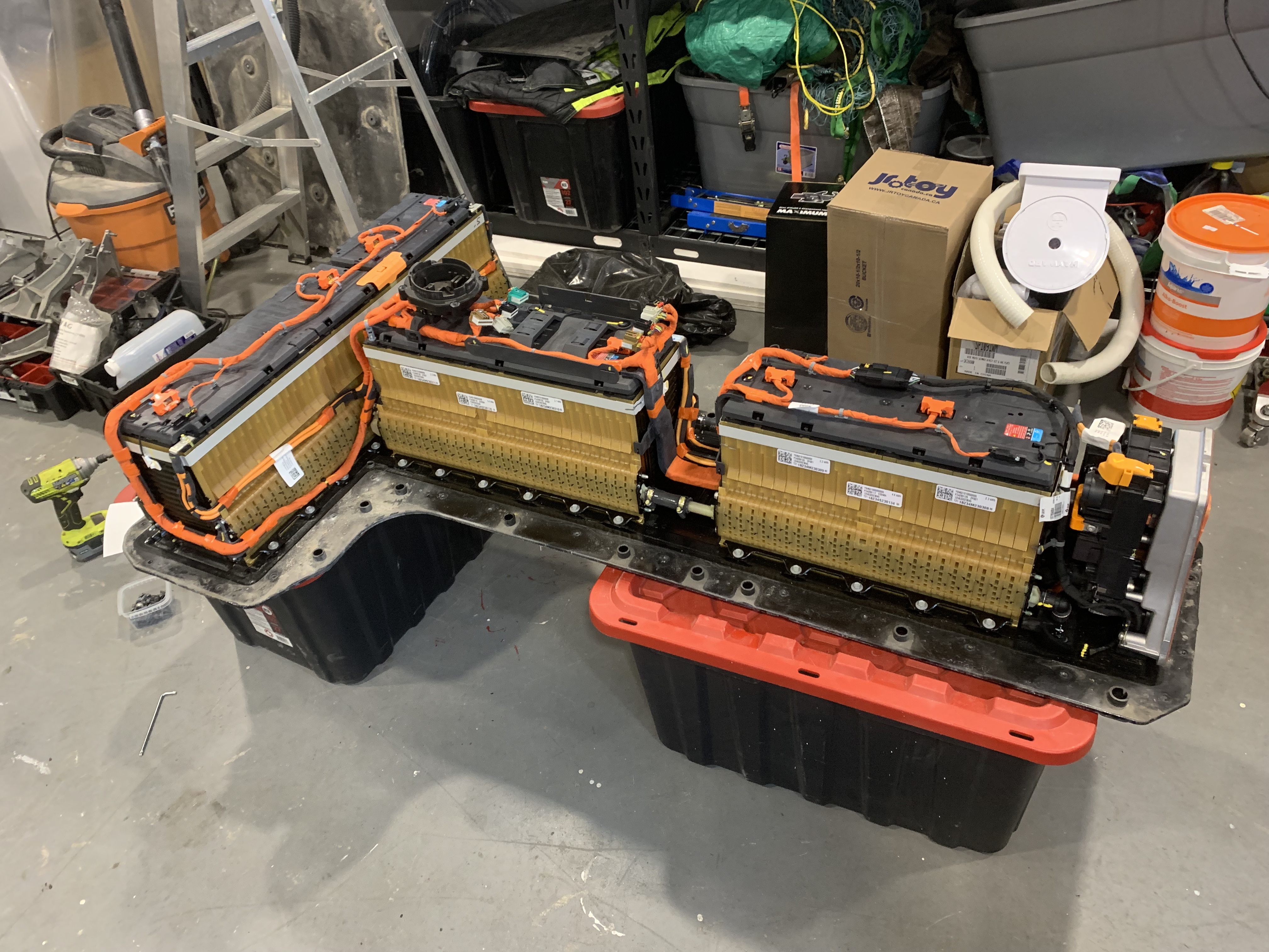

Project Update 1:
  • Batteries: Chevy Volt Gen 2 & Chevy Spark Modules - 2x 18.4 kWh = ~36.8 kWh
  • LDU Sport Drive has arrived!
  • OpenInverter Board in hand (Not yet assembed)
  • I-Booster arrived and mocked up for fitment. Minor adaption required.
  • PTC Heater from ZeroEV arrived, Mocked up, Awaiting install in Heater core
- Volt battery has arrived, The shop that sent it crated it amazingly! The volt battery assembly weights ~200kg.
Broken down the battery subassemblies weigh:
2x12S = 77.9 lbs / 35.3 kg
12S & 16S = 89.5 lbs / 40.6 kg
12S & 2x16S = 140.9 lbs / 63.9 kg
1 Pack total weight = 308.3 lbs / 139.8 kg
The Spark battery is comprised of 6-16s modules. I went this route as the battery was amazingly cheap and since each battery is separate I get multiple end caps. I intend to combine the modules into different blocks, but having extra quick connect fittings will make life easier.
- LDU unit seems to be in great shape. I was a bit concerned with reading the forum, as well as the long documented issues with LDU replacements.
The unit I purchased came from a 2013; as such it was a gamble that it was a early revision... The yard was unable to give me any details about the rev model, so I ordered hoping it was a reman unit. Thankfully it's a -P revision which puts the replacement at 2018.
The donor only had 40,000km so either way it's had an easy life.
- Thanks to Johannes I just received the OI board. All looks great and well packaged! Will prep to install over the weekend and hopefully spin the motor for the first time soon. I opted to pay extra as DHL packages to Canada all default to Ocean Freight now it seems; As my I-booster took 3 months to arrive!
- I-Booster - After many parts bin investigations, It appears that many of the recent Audi Hybrids use the same form factor I-Booster as the existing Vac boosters. That being 2 diagonal bolts (rather that the more common 4 bolt pattern).
The I-Booster PN is: 4M2614105 from a 4M Audi Q7 - This booster primarily has Flexray, but I'm hoping it's failsafe action is similar to the other canbus boosters.
Currently in the process of fitting the booster, It'll require a slight lengthening of the ball end, as well as shortening the threads on the existing bolts; as the 981 has a blind hole where the new bolt bottoms out on.
- PTC Heater is ready to install.

HV Circuits
Purchased 5 of the cheap Kilovac contactors from Batteryhookup, This should get me started and hopefully let me get started on designing the HV Junction box.
The harvested Panasonic relays/contactors from the Chevy spark battery pack I have will be used for the various heaters and precharge circuits. With the main contactors being used for the charging circuitry.
My cells are from the Chevy Volt Gen 2, as well as the 2016 Chevy Spark
Volt:
Spark:
The two packs are great for spare parts!

Battery Mounting
Much more work to be done for this task, Once I have the front mount fabricated I'll be able to design the battery tray mounting points.
There is enough places to make a box which can be mounted directly to the chassis points using factory threaded points.
I've started mapping this out and will add some CAD dwgs as I go.
