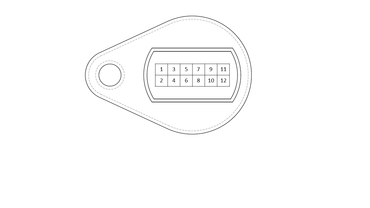

I'm trying to do a pinout for the wiki - and get ready to hook up my rear motor in place of the front one. Does anyone have a full pinout including the temperature sensor connections figured out yet?
Based on my little sketch below, am I right in thinking that 1-2 are EXC, 3-4 are SIN and 5-6 are COS?

Here are my notes for the rear inverter / motor, I've not worked out which resolver wire is which as it's not needed to know with the OEM inverter.
Also the factory wiring diagram, hope it helps.

Thanks for that. I saw the official pinout but that threw me as it has 14 pins and Tom's one only has 12?

I've added what I think is the correct pinout to the wiki based on the REMCU doc that @aot93 supplied (thank you). Appreciate if someone could check it: https://openinverter.org/wiki/Mitsubish ... Drive_Unit
Understand the 14 pin/12 pin thing now having looked more closely at the connector (2 pins unused). Doh.

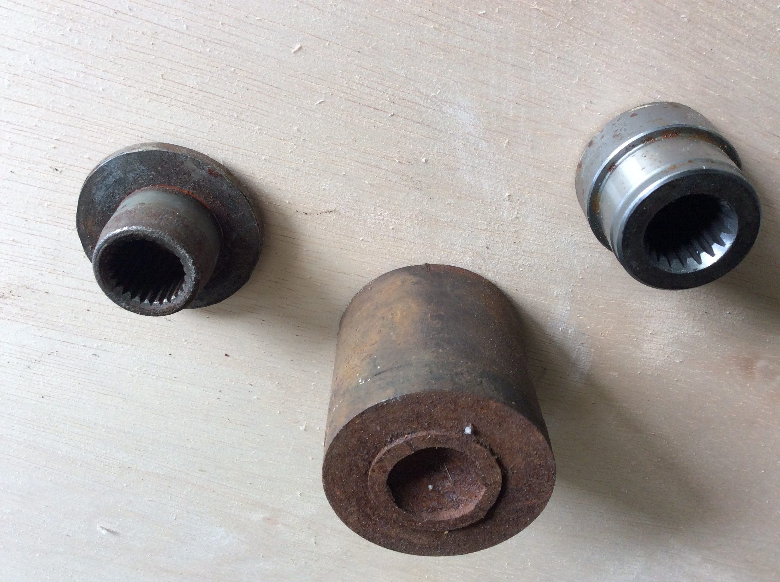

As I will not be using the native diff, due to difficulties acquiring suitable drive shafts, but using the original beetle gearbox, I need a motor spline, a gearbox spline, an adaptor plate and a spacer. The diff can provide the first and fourth. I used a worn out wood cutting bandsaw blade to remove excess material from this new ‘spacer’ and extracted and shortened the original spline. For the adaptor plate I am using a piece of 10mm plate that will have a 3mm deep by 283 dia spigot that will register with the recess in the beetle bellhousing. The gearbox spline obviously comes from an old Clutchplate.
As the beetle gearbox mounts originally supported the whole 100kg engine it should be more than adequate to support the 40kg Y61. Also the spacer to motor fit has to be perfect as it hasn’t been changed and uses original fittings. The spacer to adaptor plate may need an extra spacer or two to be added as the mounting surface doesn’t extend the whole way around. Most of the centre of the adaptor plate will then be removed to reduce mass.
