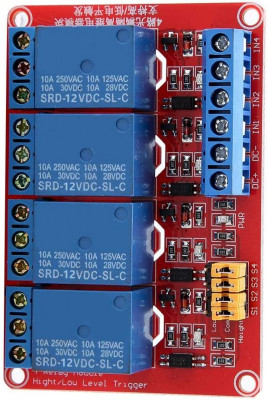

Hi everyone. I am using a Leaf Gen 2 board, but I thought this might be more of a general question, so I dropped this in the General category. Firmware that shipped with the board was 5.14 and I have not changed it.
I am using the below pictured opto-isolated relay board between my contactors and the Openinverter Leaf adapter board. I was concerned about the continuous power draw from the contactor and did not want to damage the Openinverter outputs.
Contactors are both TE 2098190-1 with economizers. Precharge relay is a Panasonic AEV52012. Precharge resistor is TE 100 ohm chassis mount HSC100100RJ.
I've noticed a strange behaviour during bench testing and now while testing with low voltage (40V) in the car. When I turn on the ignition switch that powers the inverter and relay board ---- the positive contactor "pulses" on/off for a split second. Then the precharge relay turns on and the system waits until I apply the start signal. After which the precharge relay turns off and the positive contactor engages. So the overall function seems normal - except for that "pulse" when switched on. I also verified the pulse with a scope and no relay board - so its definitely something with the Openinverter control.
Why does the positive contactor "pulse" ? Is there a floating pin somewhere on my Openinverter board? I already tried a 5K pullup resistor on that pin, but it didn't work. I can't imagine the inverter capacitors liking the sudden jolt of 310V. Not to mention the contacts inside the contactor - which I've already read about people having those get welded shut! Do I need to test some kind of RC delay ciruit? Has anyone else seen this?
Comments/suggestions?

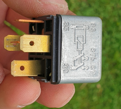

So this little automotive 12V relay that I was going to turn into a latching relay and drive main contactor is no go then?

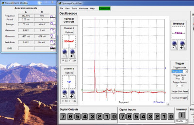

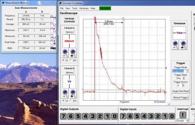

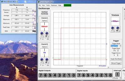

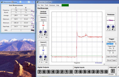

Some scope shots with only the Leaf board powered. No other connections
1. Power up - Pin 2 on STM32 2. Power up - DCSW_OUT And faster time scale OK, for the most part, these look normal.
With the little relay board now connected. It is on the same 12V/Gnd connection as the Leaf board. PRE_OUT and DCSW_OUT are connected to the relay board.
1. Power up - Pin 2 on STM32 was the same as above
2. Power up - DCSW_OUT But now look at it with a negative trigger: So what I came to realize is this:
- Power is applied to the Leaf board and the relay board simultaneously.
- OUT_DCSW is grounded before the STM32 boots up
- The relay board responds almost instantly to the 12V power
- The opto on the relay board sees the ground from OUT_DCSW for a split second before the STM32 finishes booting
- The relay clicks on for approximately 2ms during the boot process - thus pulsing the main contactor
- STM32 finishes booting and sets OUT_DCSW high, thus turning off the relay and corresponding contactor
