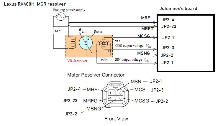

I need to connect Lexus MGR to Johanes's V3 board.
Can anybody tell me if shown picture is correct, or did I missed something?

konstantin8818 wrote: Sun Mar 29, 2020 9:27 pm I'll bump this thread.
Measure the resistance of the terminals to be sure. The exciter circuit (mrf/mrfg) should be different, and the sin/cos should both have similar resistence.

slow67 wrote: Sun Mar 29, 2020 9:32 pm Measure the resistance of the terminals to be sure. The exciter circuit (mrf/mrfg) should be different, and the sin/cos should both have similar resistence.
Will do. My concern is about MSNG and MCSG are both connected to the same pin, wich provides 1.7V if I understood it correct.

Post by xp677 »
Sounds like a common ground that is at the midpoint of a 3v3 sine wave. Can't see an issue there.
