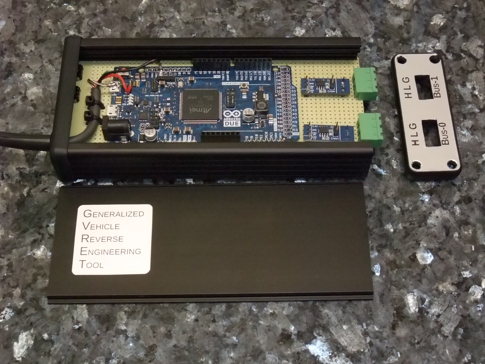

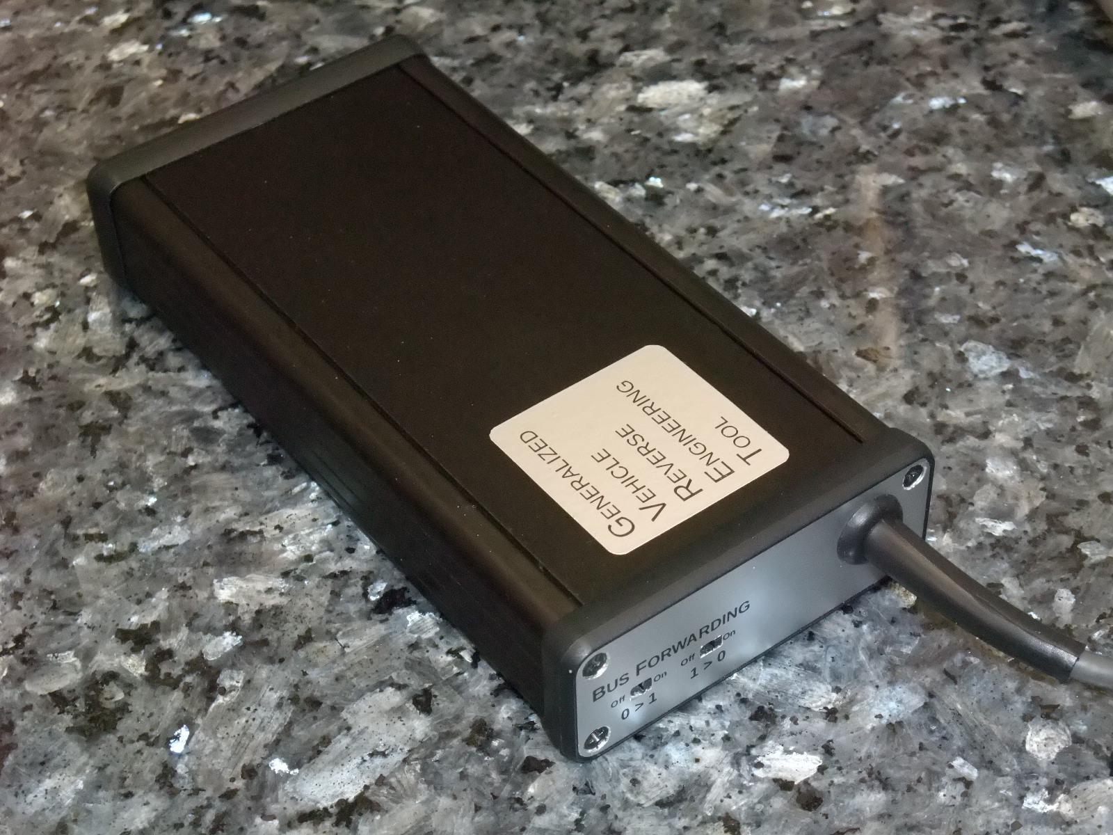

No progress on the car as I still need to create space in the workshop. No progress on the PCB as it needs a good check before sending out and I haven't been in the right frame of mind.
I have however finished my CAN analyser tool: It's based on an Arduino Due board running GVRET (see the excellent how to here https://openinverter.org/wiki/CAN_bus_with_Arduino_Due) and it works very nicely with the SavvyCAN software. So far I have been impressed with both. One thing worth mentioning if following the wiki how to, pins 11 and 12 on the Due need pulling low if bus forwarding isn't wanted (if they are left open all messages received on bus0 are forwarded to bus1 and vice versa). I've added a couple of switches on mine to allow this to be selected without opening the box.

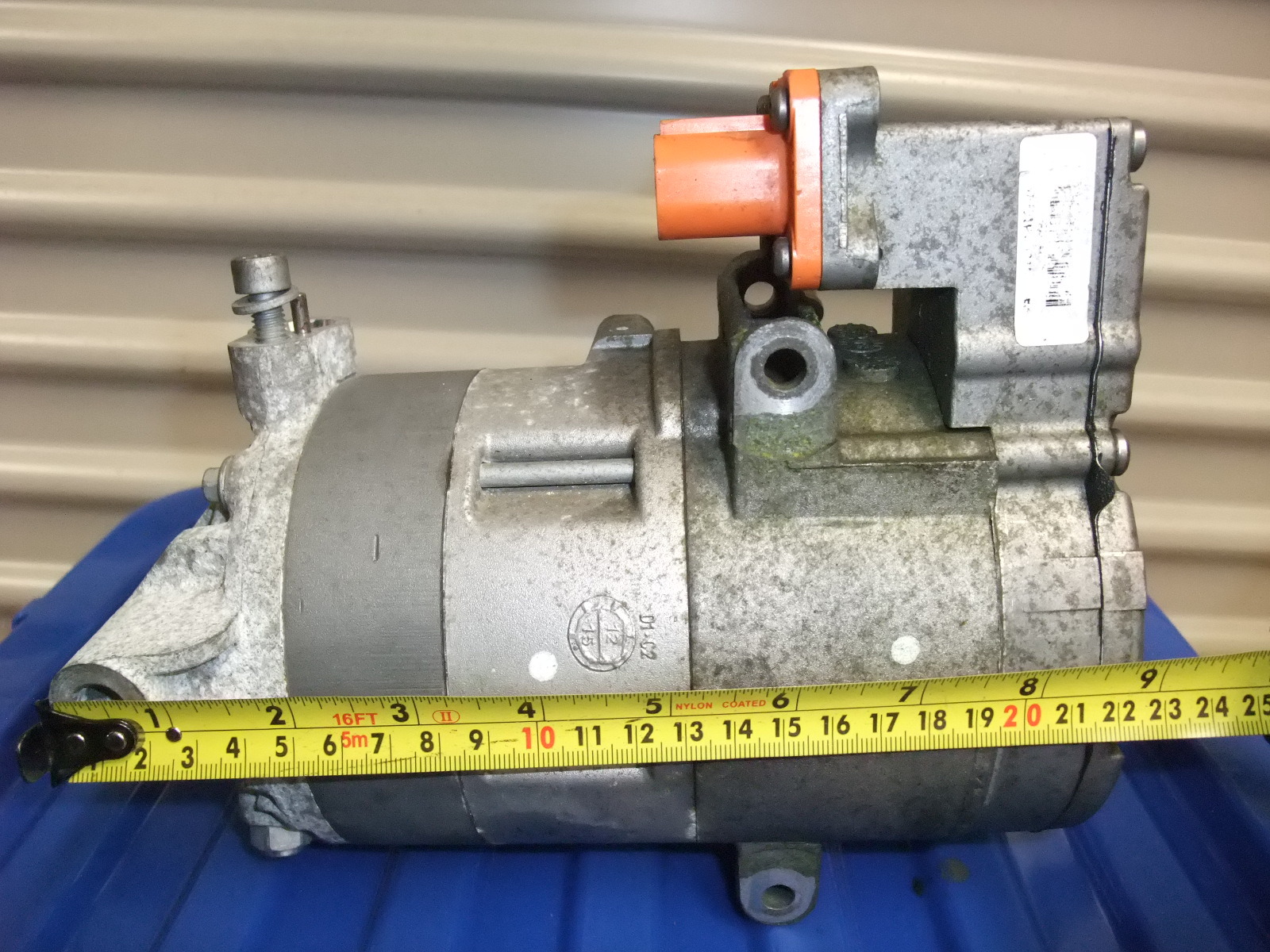

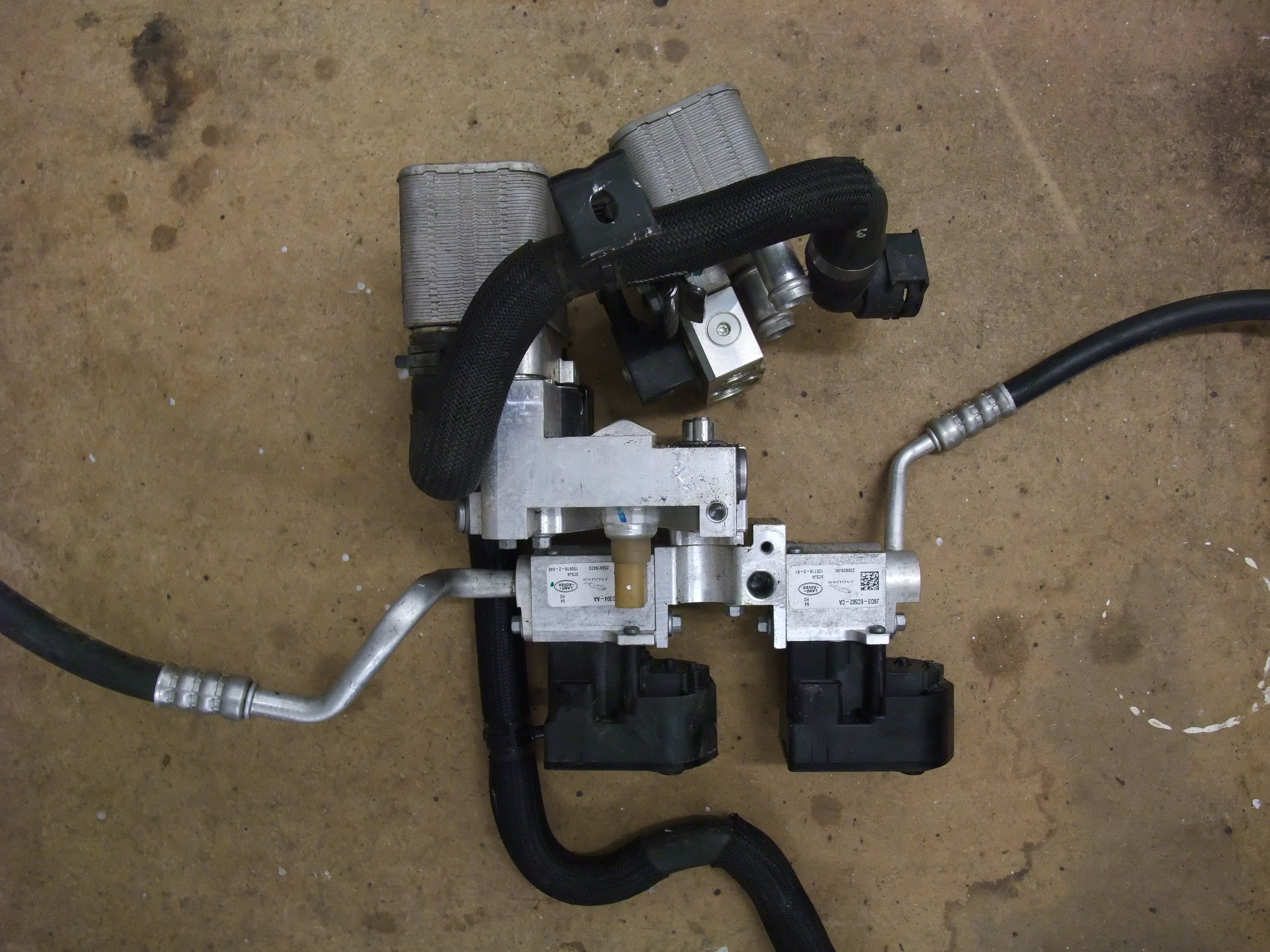

Still not got the car in the workshop. Noticed on the way back from the MOT for the car currently in the workshop that the engine temperature was low, turned out that it had the wrong thermostat fitted so that was an easy fix. What wasn't so easy was that while fixing it I noticed that the in car heater heat exchanger, the oil to water cooler and a couple of other hoses were all blocked. It's taken a couple of days to get it all cleared out and working but it now seems happy. The final issue was a blockage in the T for the vent pipe which meant it didn't bleed properly. It's amazing how much a little bit of air can affect the efficiency of the cooling system!
On the Roadster I have picked up this AC compressor for a good price (think it may have been wrongly been catalogued as an ICE compressor): Question - Are they all this large - I was expecting something about 2/3 this size!
Not really a problem as it will just fit in the space where the 12V battery currently is but if there are smaller/lighter alternatives available I would be tempted to change.
The other thing I'm wondering is whether to use it just for cooling or whether to try and use it in reverse cycle as well for heating. I realise that AC heating will only work if the ambient is a few degrees above 0C but that covers over 90% of the time. I'm also wondering whether motorised AC expansion valves will allow flow both ways if set to wide open, if so it would simplify the reverse cycle plumbing quite a bit. Any thoughts/comments on this welcome.

Been fixing a few more issues with the Roadster, one door lock and the heater blower weren't working but sorted now. You always know it's not going to be an easy repair when you find someone has been there before you and you have to spend most of your time removing the previous 'repairs'! Also coded up a spare key fob as the Smarts have a habit of randomly losing key programming and I only had the one key.
Ordered a few more bits the first of which has arrived: Air con valve block from an I-Pace, hopefully it will provide two heat exchangers complete with expansion valves and solenoid valves to control them plus a pair of what I'm hoping can be used as refrigerant flow control valves. Still need to figure out the control interface but I'll start a new thread to cover that. When I have a chance I'll also sketch out what I have in mind for the AC (I'm hoping to achieve both cabin and battery heating and cooling from it without too much plumbing complexity). It may not work but even if I only use a few of the bits of the above it's still worth the cost.
