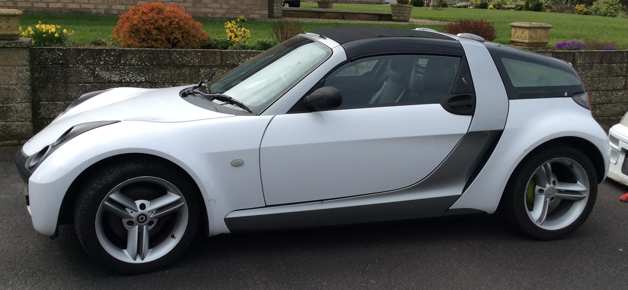

Hi, I'm new to this site, and new to the whole EV bit but have been reading though everything here and have been inspired to start an EV project of my own.
Over the years I seem to have moved from small fun cars to larger comfortable ones, and in the process lost a lot of the enjoyment in driving, so the plan is to get back into something small and light that is fun to drive. The search for a suitable car led me to a Smart Roadster, not something I had ever considered before but a but of research convinced me it could work. The main problem with the roadster seems to be the terrible gear change and weak engines which led me to think about an engine swap. A bit more research, finding this site and realising just how far DIY inverters and control software have come has convinced me to go electric.
So far I've got the car, it's a but tired and needs some work for the MOT but should form a good basis.
In terms of other components:
Inverter - I have a Prius Gen3 inverter in pieces on the bench and am looking at the options to replace the logic board. I think it is going to be a custom board based on the openinverter hardware and software as this will allow me to integrate a few other features. The biggest problem with this at the moment is getting components! So far I've bought a few STM eval boards from which I'll rob the processors and I'm hoping to reuse components and connectors from the Prius logic board where possible. The plan is to use MG2 to drive the main motor, MG1 to drive an early generation Prius AC compressor, the boost/buck converter for HV battery charging and the DC/DC for 12V battery charging. If this works it should make for a very neat and compact install.
Motor - It's looking like a Mitsubishi Outlander rear motor and diff at the moment. The packaging is not ideal as it will push the motor out behind the rear axle while it would be better in front but once I have one I'll have a look at the possibility of rotating or flipping it. Worst case it mounts in the standard orientation in which case some of the suspension arms may need relocating.
Batteries - Probably a BMW 330e pack with the modules rearranged into a new housing. I'm hoping that this will fit in the area currently occupied by the engine and fuel tank but it will be tight. This may all change once I can get a better idea of the available space. I'm in two minds what to do about battery heating and cooling. The BMW battery packs have a very nice AC based system integrated into them which it would be nice to keep but is this just an unnecessary complexity for UK weather with slow charging? Overall I'd like to get 12-16kWhr of batteries into the car. Based on other conversions 160Whr/mile seems a reasonable target for the Roadster which should give a 50-70mile range which is more than enough for day to day use.
BMS - Yet to be decided, if the BMW packs are used then probably try to reuse the BMW BMS boards.
There is going to be a fairly slow start to this project as I'm still in the end stages of a house refurbishment/move and that has to take priority. The plan for now is to collect all the bits and sort out the new logic board ready. While doing this I'm also going to get the car back on the road in standard form and try to do loads of CANBUS logs as I'd like the new powertrain to be as closely integrated into the existing car systems as possible. In particular I'd like to try and keep the existing ABS and stability control systems working (which includes engine torque control). This may be a bit ambitious but worth a try. I'm planning on using GVRET and SavvyCAN for this unless anyone can suggest something better?
My background is in electronic design and embedded software but have never done any high power electronics or motor control so all that side is very new to me. I have built a couple of kit cars so am fairly comfortable with the mechanical side of the conversion.
Got to say I'm more than a bit nervous about the high voltages involved in this!
