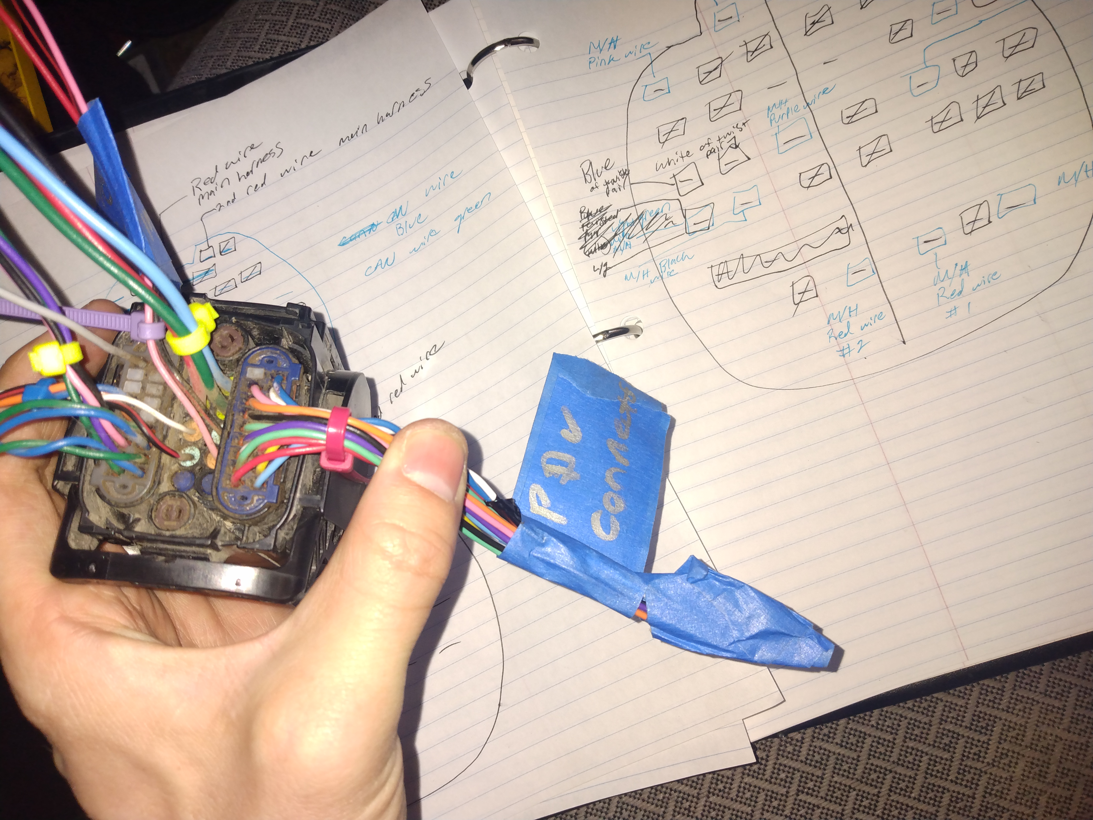

Hi all, I am working on a 2019 leaf and I wanted to reuse the harness that came with the leaf and connect the zombieverter directly to this harness to run the motor. Dose anyone have a pin and harness wore diagram for the third gen inverter and 3rd gen wore harness and connect?
I have attached images of the connector I am talking about. I don't know the name of this connector.

I have managed to account for every wire but one which is this grey wire. I have used colored zip ties to help identify which wore bundles goes to where and then uses tape labels. I have also made a simple drawing of the connectors on the motor and what wire goes where I will post it after I redraw it.

Here are a couple for images that I couldn't fit above

janosch wrote: Mon Apr 25, 2022 11:35 am Hi,
I don't know the pinout, it might be worth checking the maintenance manual if you haven't done already.
On another note, we don't use the big main connector, so if you want some I can cut them off and post to you.
I have looked in in Chilton’s, and several other manuals, but didn't find it probably because of how new it is? I have a feeling that the only place I will find it is nissan-techinfo which I don't have access to yet.
and about that main connector sure!
Today I am going to try and figure out where that grey wire goes and redraw the basic diagram.
I was curious if it was easier to use both the main connectors and also cleaner for the most part? Since I had it, I figure it would be worth trying out and it is a really good weatherproof connector so why not for the final installation for after I get this motor bench tested. I am not using the PDU section yet as the PDU that came with it had a hole in the casing and metal chunks inside of it, the car was in a front-end crash, so I have to bench test that later.

*** I just realized that the inverter drawing is flipped and inverted and I need to redraw it for the correct orientation and this was based off of the image Darla posted and what I found on my connector and harness. I also realized that the way you read the diagram is like how you read Japanese manga. I will make the corrections and post the new images and then delete this post.***
Here are a couple of drawings for the main harness and the inverter connector. I didn't have the OE diagram for the main harness connector, so for the pins I defaulted to assigning pin #1 to the top left most pin and then the ascending order goes vertically downward until that column and then the order moves right one one column and then downward. For the middle section the pin order goes left to right row by row, not sure why i did that I meant to continue with how i previously had it, and then the last section goes back to the other way. I also did not have the OW diagram for the inverter connector so temporarily I have the pin numbers starting in the top left most corner and then in ascending order from left to right until you are done with that row and then move down one row and move left to right. For the inverter connector the view orientation: as you look at the face of the disconnected connector that is attached to the motor harness and not the connector on the inverter itself.

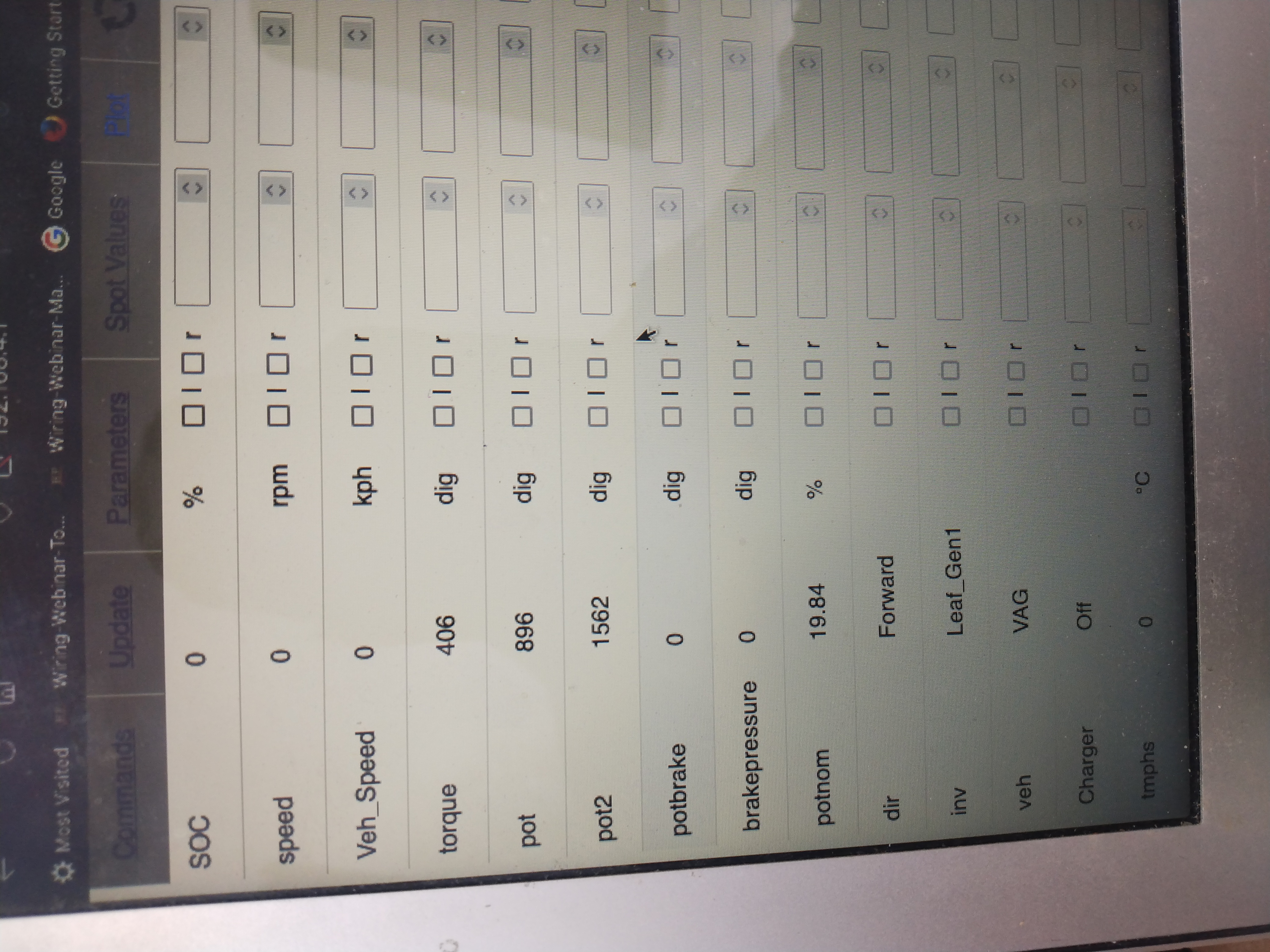

T15 on
Run mode
Throttle is responding and Tq command being sent.
No Errors
For some reason no can communication with the inverter.

just going over everything and double checking everything.
I can not get the inverter to come on.
I made sure that there was a good ground for the 12v system and I am using a fused battery input that powers a power distribution block that feeds the VCU +12vdc and the VCU goes to the common ground. I double checked that Pin 52 of the VCU, Start, is working properly and I can get the precharge to complete and all relays and contactors close. I have start as its own momentary switch that automatically releases when you are not pressing it. T15 is it's own switch along with HV request. for forward, reverse and neutral I have a three position switch and I confirmed that I can toggle between forward and reverse.
I checked pack voltage at the inverter input terminals and I read 191.8V after the precharge is complete and contactors close.
I verified that Pin 43 of the vcu goes to pin 11 on the inverter and is connected to the green wire. Pin 44, CAN EXT.1-H goes to pin 5 of the inverter which is the blue wire.
I tried the manually on button in the vcu and that did nothing.
For the red wire on the main harness which goes to pin 18 on the inverter I put my positive DMM lead on that and the other on the common ground and then turned the system on and I can see the power switching on. For the pink wire which powers pin 1 and 6 on the inverter with the whole system off and battery connected I see current battery level and then when the system is on I can see a .2 Vdrop. checked all the grounds and made sure they are all good. between the ground wire and motor case I measured 17.4 mV.
with the system on from can hi to ground I measured: 2.453V
CAN low and ground: 3.385V
across can hi and low: 20mV to 180mV difference mostly sitting at 155mV, voltage fluctuates.
for start up i first turn on t15 and hv request and then press start for 6 seconds and the release at which point the precharge completes, system is in Run mode, no error and I can read udc voltage, but invstat and invudc is off and 0. TQ command is being sent and I can see the VCU is sending CAN signals and the POTs are changing value and going to a positive value. So if the inverter can get power and switch on this motor should be spinning.
I am pretty sure that the wiring is correct for this harness. Thoughts anyone?
