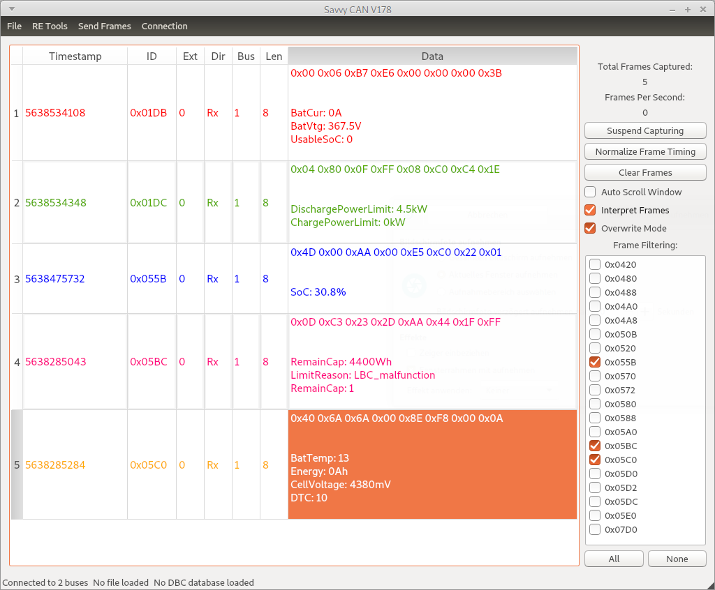

So hooked up the BMS today and looked at CAN values.
Of course most values don't make sense as the LBC/BMS doesn't belong to this battery.
I am getting a very low power limit (0 charge, 4.5kW discharge) because of "LBC malfunction". DTC is 10. Anyone know where I can find a list of DTCs?
Gotta say, SavvyCAN is awesome, it was real easy to define the signals despite the weird bit order.

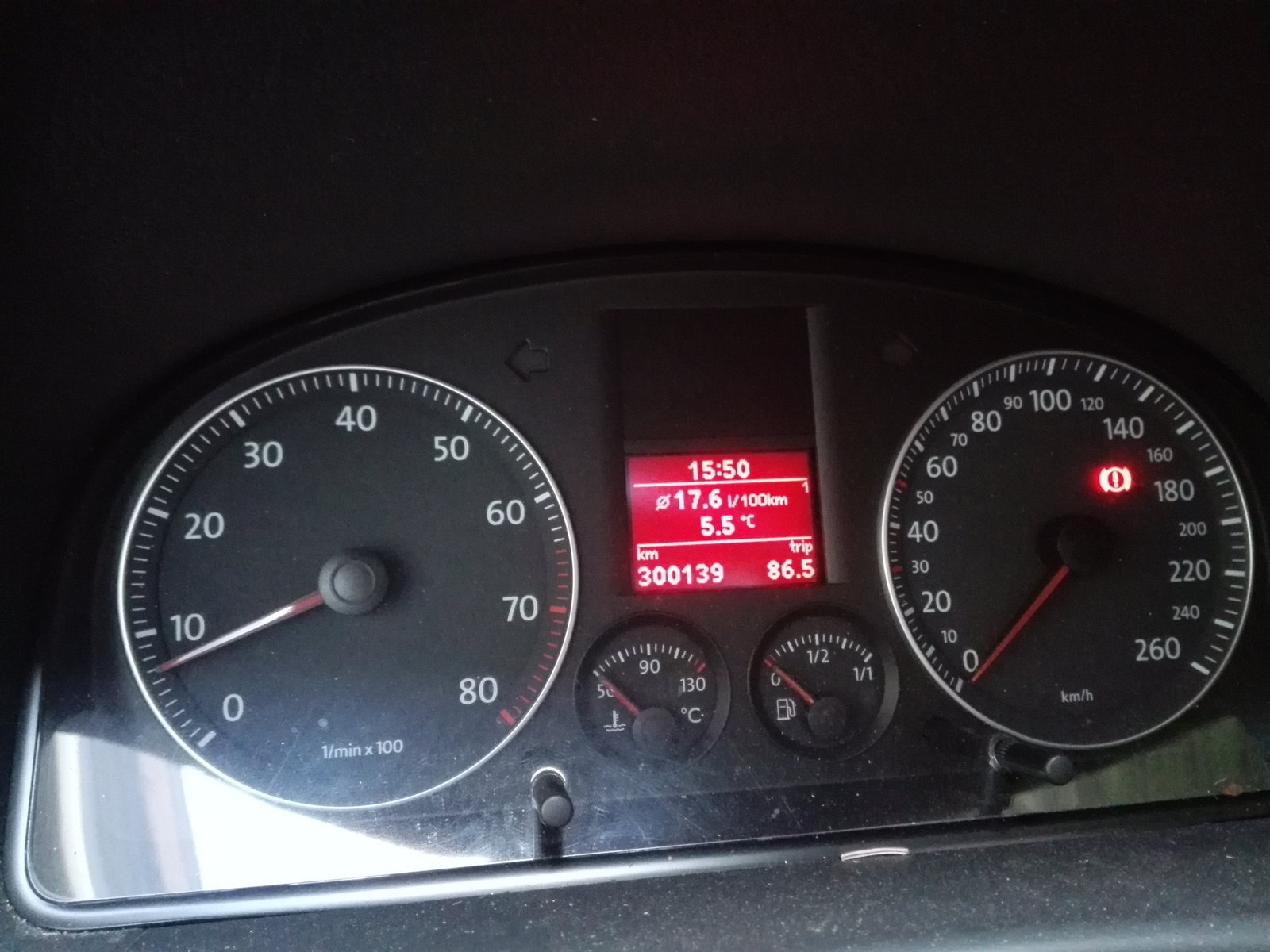

Did a test drive yesterday and here is the economy figure
(kWh/100km).
It was like 80-100km/h mostly flat back road driving
- Posts: 2382
- Location: Bristol
- Has thanked: 206 times
- Been thanked: 559 times
is that trip meter accurate? At 176wh/km doing 80-100 km/h is very good for such a big car.

Yes it should be. It is fed by an upcounter. The faster it upcounts, the higher the consumption. It is linear, I checked. So if you count up by 28 per 10ms it will display 10l/h. If you start driving it will convert that to l/100km. So I just take the power reported by the BMS in kW, multiply by 2.8. Now if I pull 1kW it will display "1 l/h".
Wow, thats almost too good. Maybe because I have no auxiliary drain right now. I don't have any equipment to weigh the car, so will have to wait for the TÜV visit.

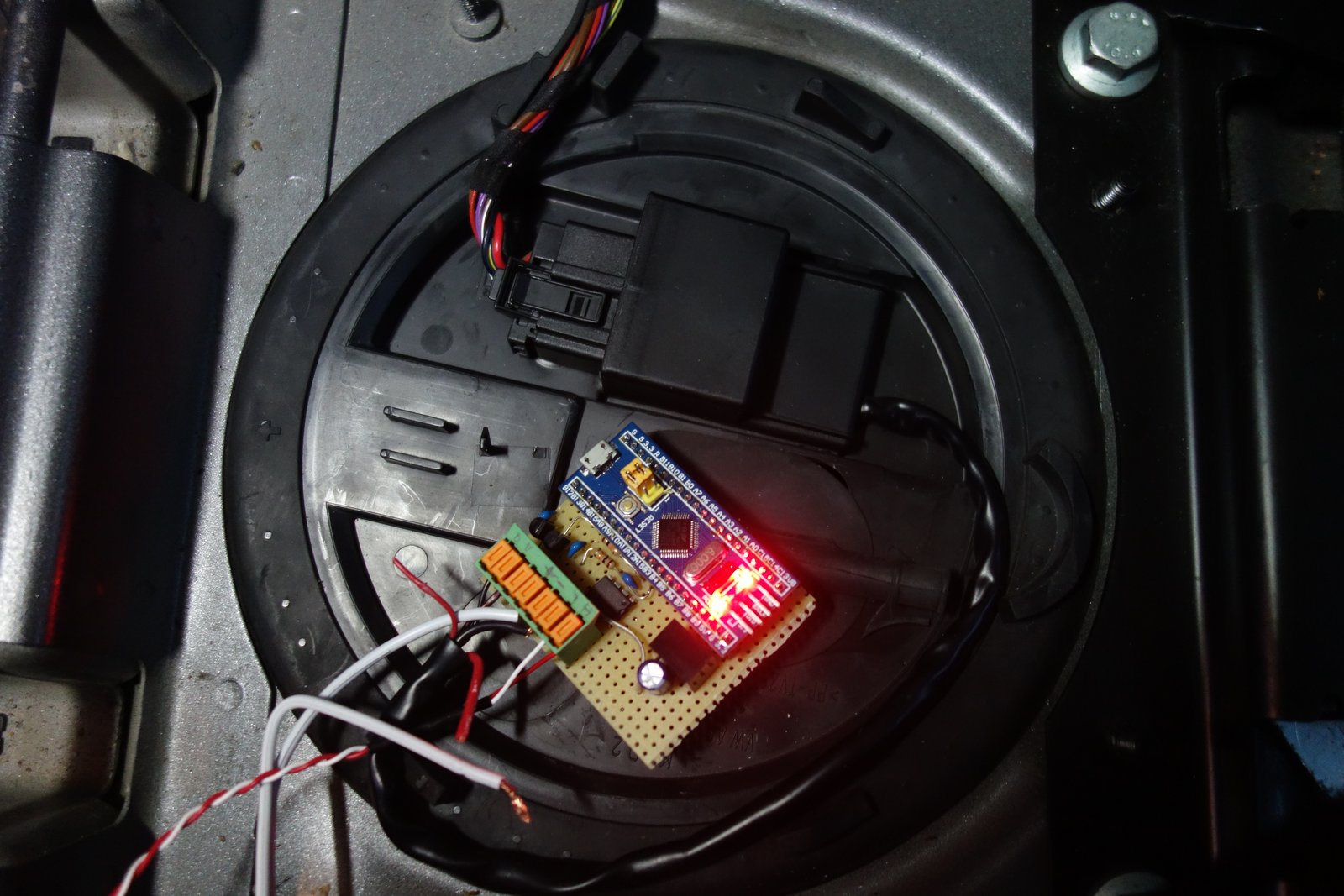

Sorted the fuel gauge today.
Blue Pill+MCP2562 CAN Transceiver+ 2 BC547 transistors
So at 50% SoC we output 36% duty cycle on both transistors. As SoC increases we decrease duty cycle on one channel and increase it on the other one by a certain amount per % SoC. Perfect analog pot simulation.
Then mapped SoC from the Nissan BMS to it, done. Still took me all day
Idle duty cycle and SoC gain are configurable so I hope it will work for other cars with a similar setup.

I final-mounted the fuel gauge driver today and put all the trim and seats back in.
But oh no, as soon as I spin the motor all warning lights go crazy
Seems my CAN bus extension from BMS to gauge driver causes a problem. After all it's routed on top of the batteries so will see a fair bit of EMV. Maybe it's a termination issue. Still haven't measured total bus resistance.
So remove seats and trim and try again
