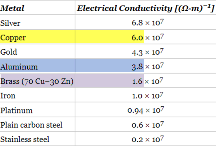

Metals Conductivity Chart
Brass machines well (well, depending on the lead content) and is widely available but is a not a great choice for a conductor. Aluminum is a better conductor choice, if the environment is suitable. Copper conducts well but corrodes easily, which is why it's often tin-plated in corrosive environments (and why most terminal lugs are plated).
Iron, steel, and stainless steel are very poor choices for a conductor of any significant current.
