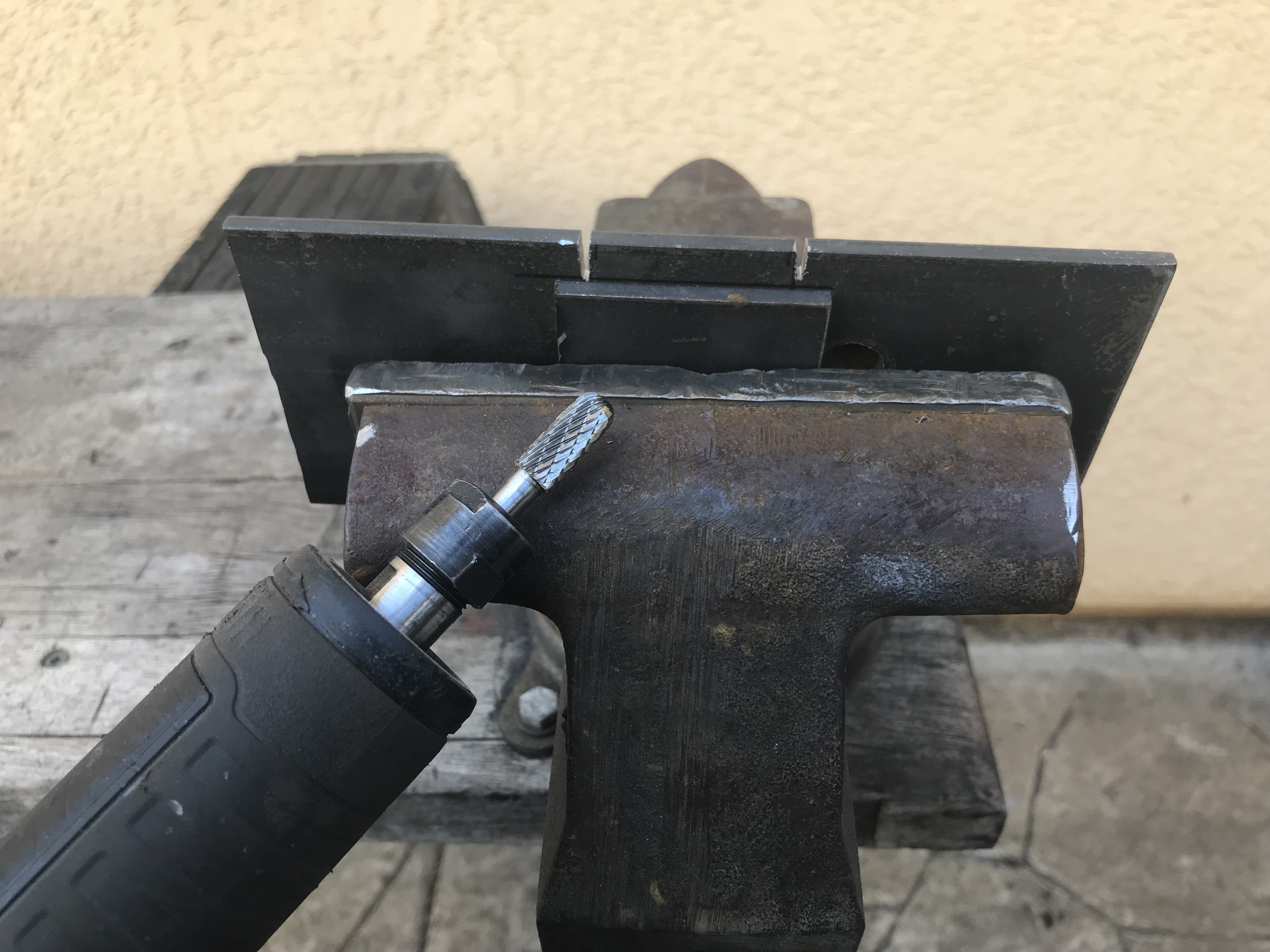

Post by Gregski »

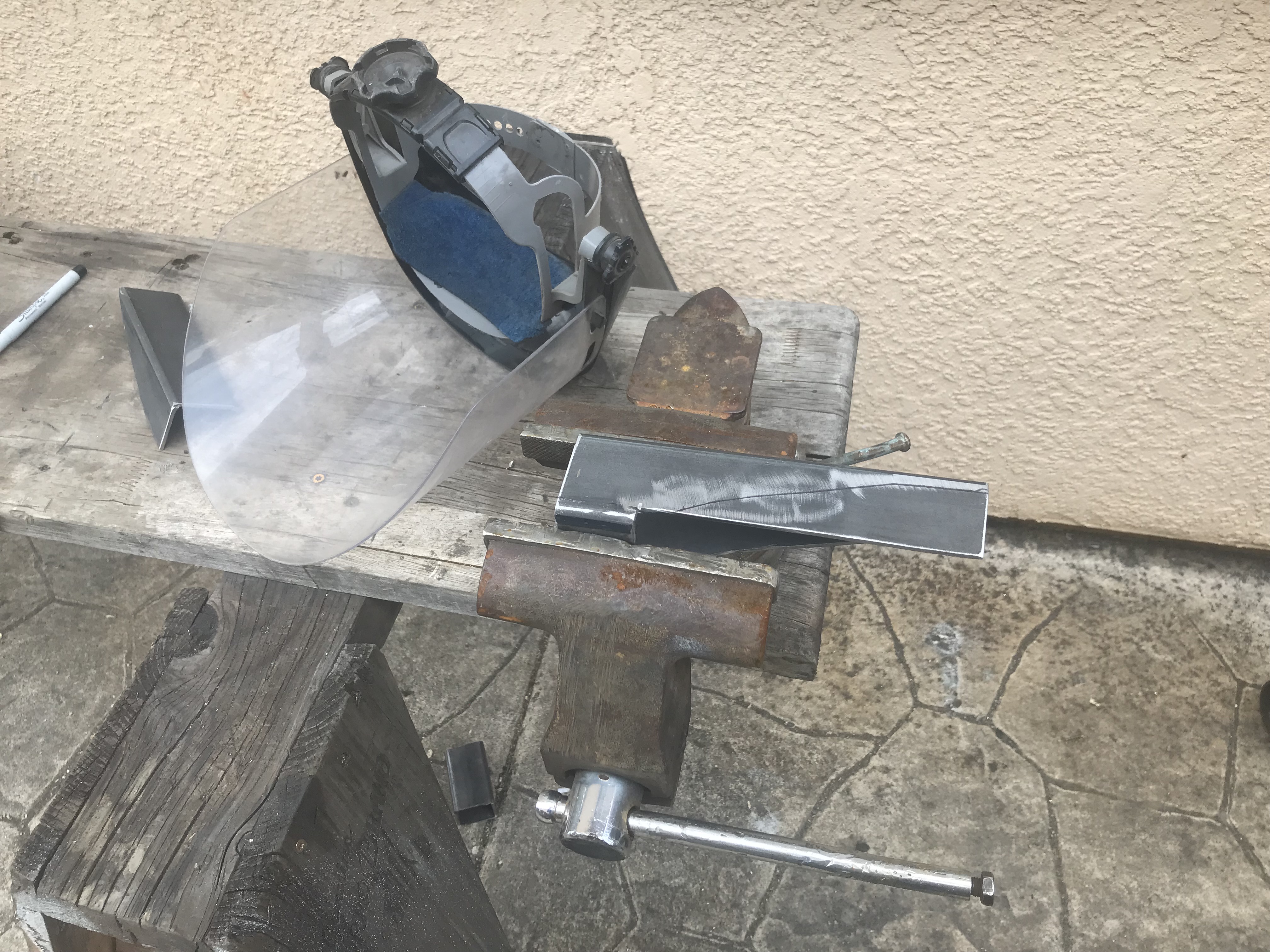

another day another template (and one dull razor)
Gregski
Posts: 3158
Has thanked: 630 times
Been thanked: 1607 times
Post by Gregski »
not my favorite tool, still trying to learn how to use it as sometimes I am a surgeon with it, but most of the time a Barbarian

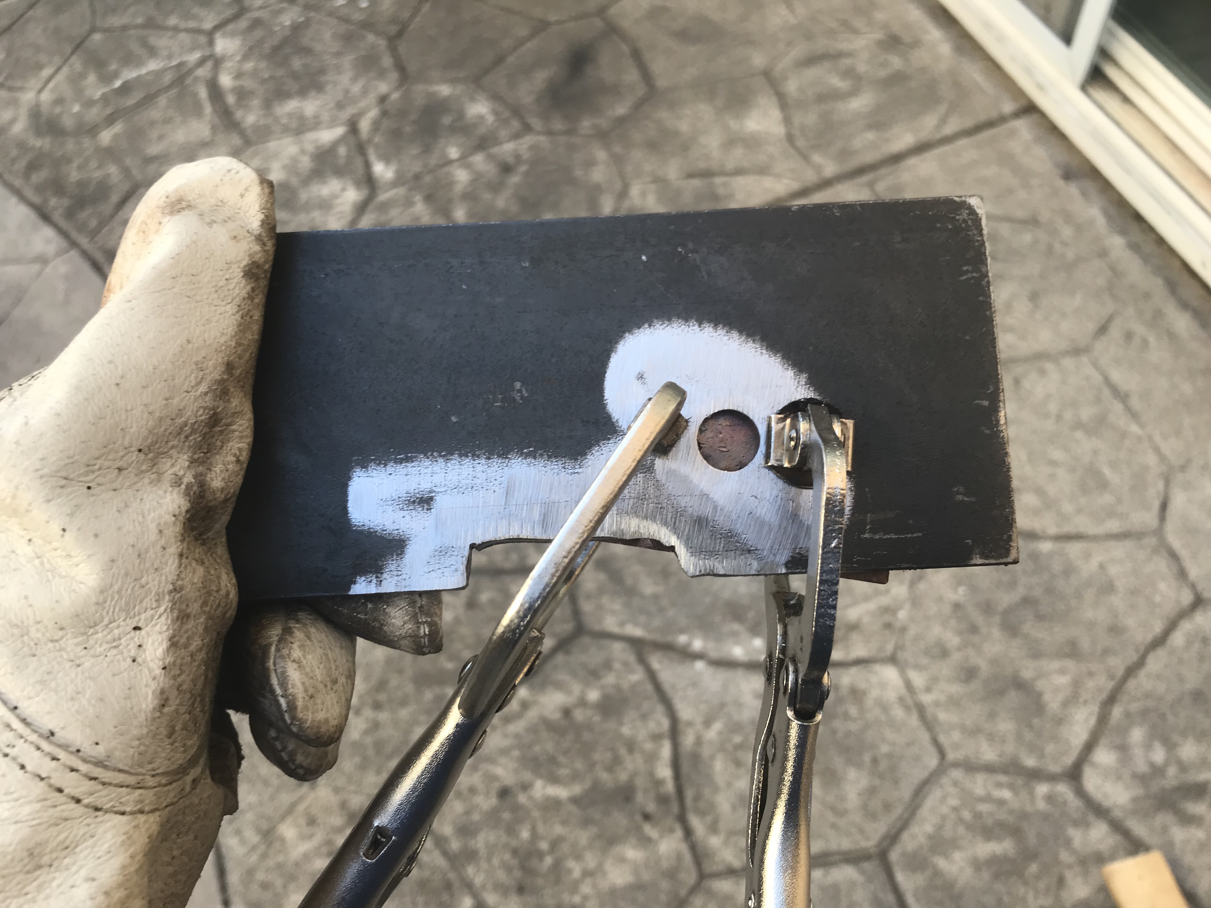

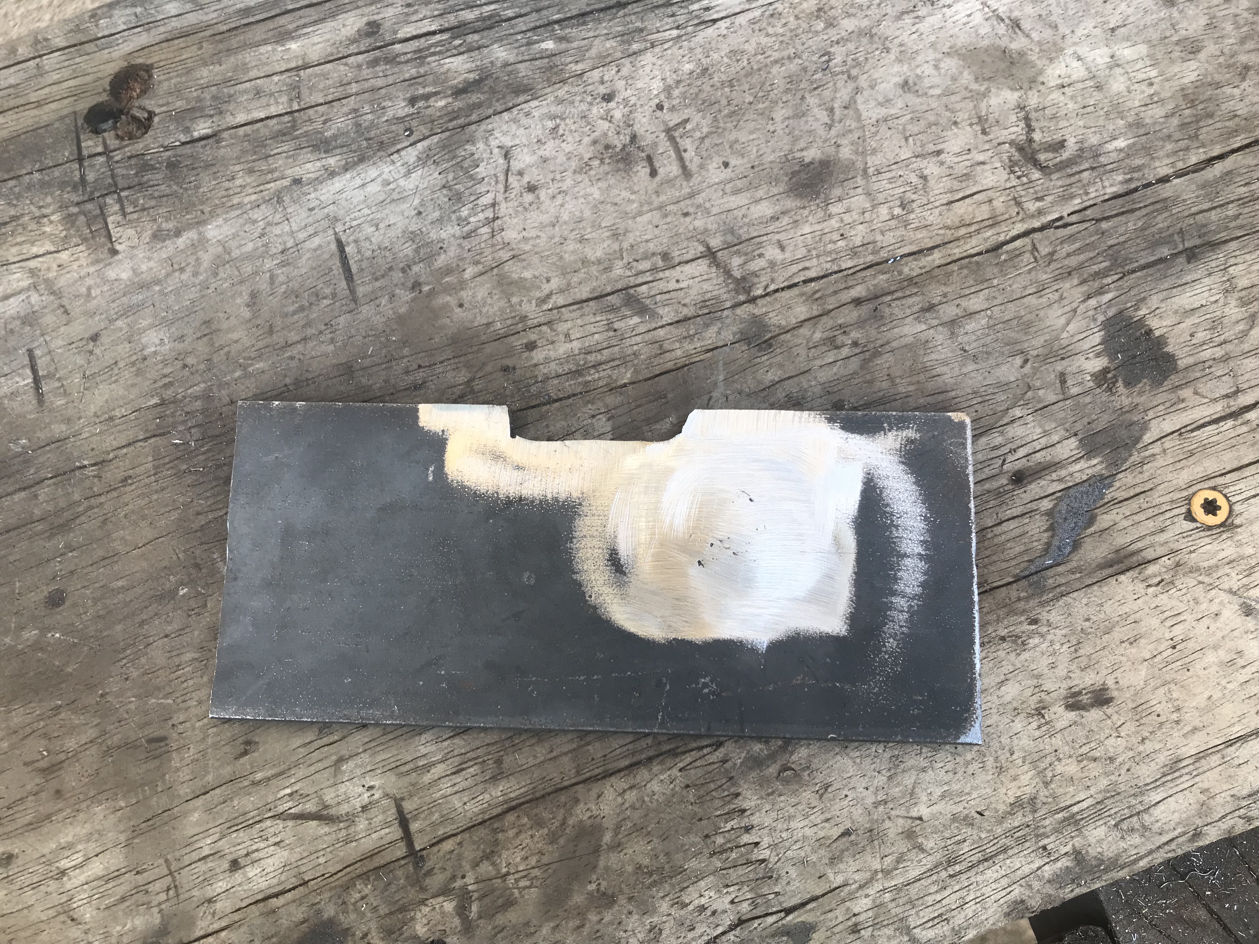

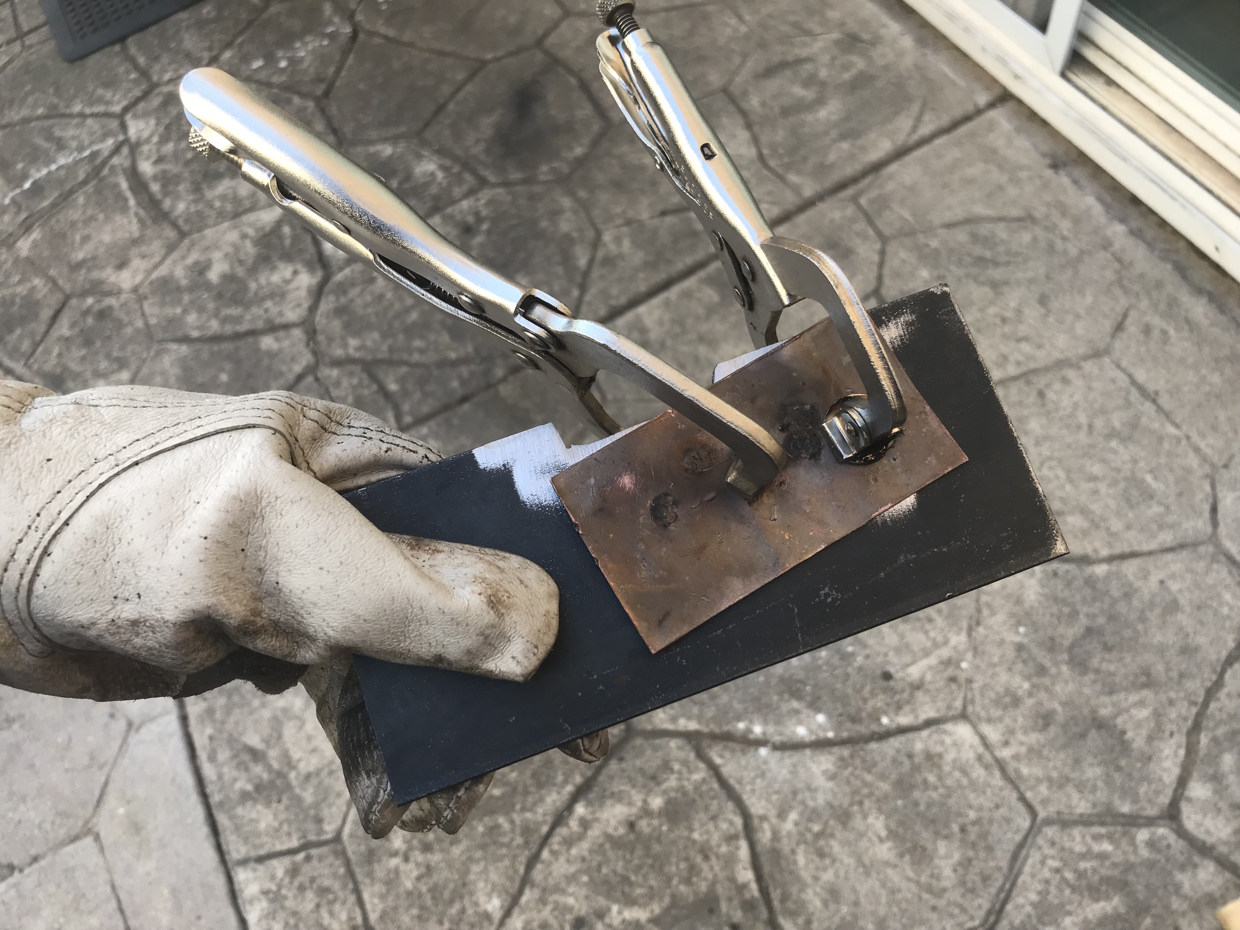

Post by Gregski »

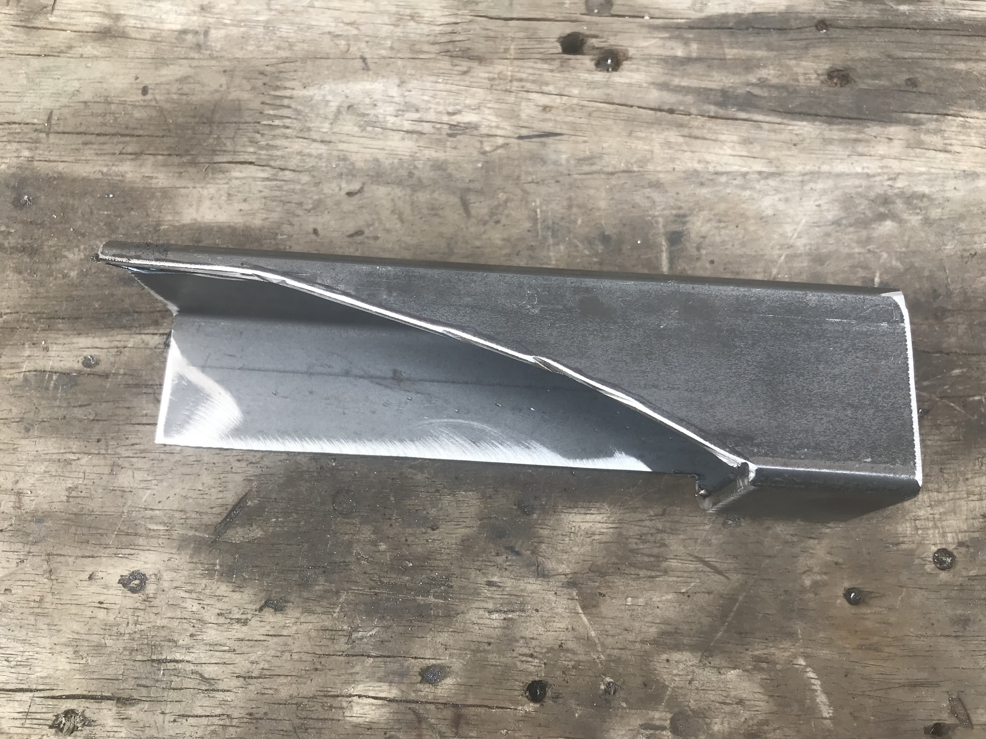

top tip on fillin in them holes, anything bigger than tiny I like to use some backing plate on it, this is a flattened out piece of copper pipe you can source at your local plumbing supply, works great as the filer rod won't stick to it
and Robert is still your mother's brother

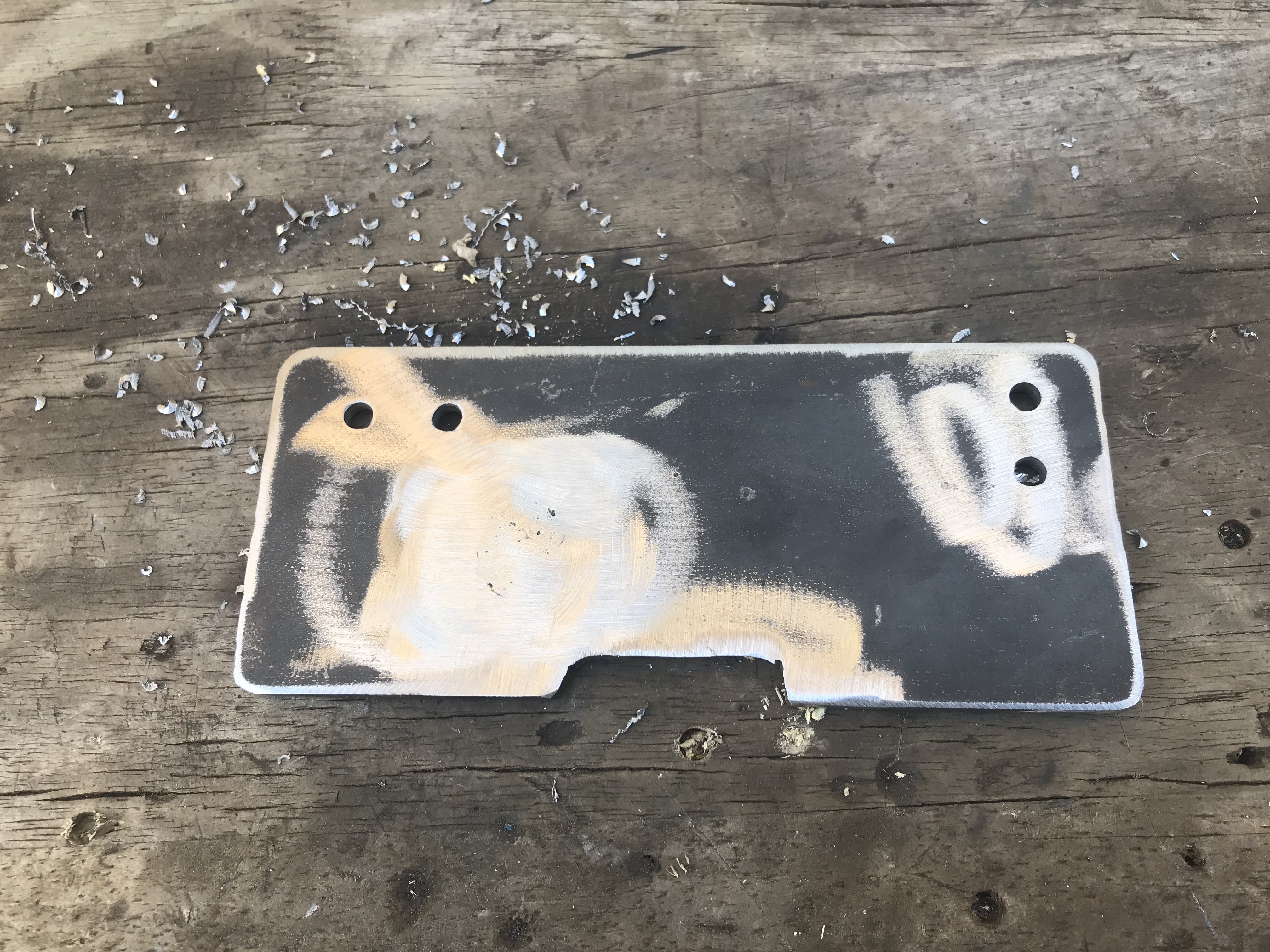

Post by Gregski »
Top Tip: on punching holes, lay a piece of paper or card stock over the holes and with a ball peen hammer gently tap tap tap the holes perimeter and it will punch out the perfect hole for you to transfer over, also great for making paper gaskets, works around edges as well for that perfect border cut

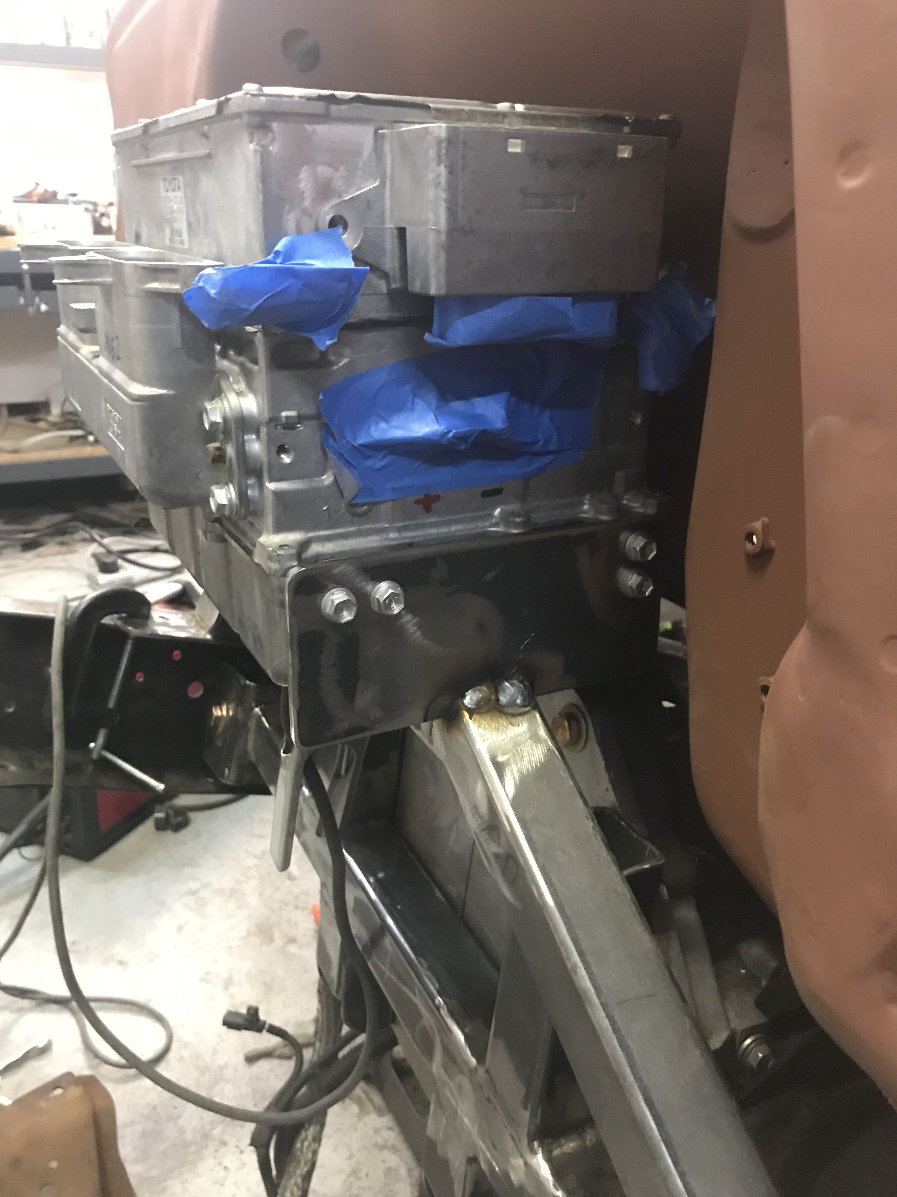

Post by Gregski »
and let's glue it on there
Gregski
Posts: 3158
Post by Gregski »
well now for the moment of truth, will this thing come out?

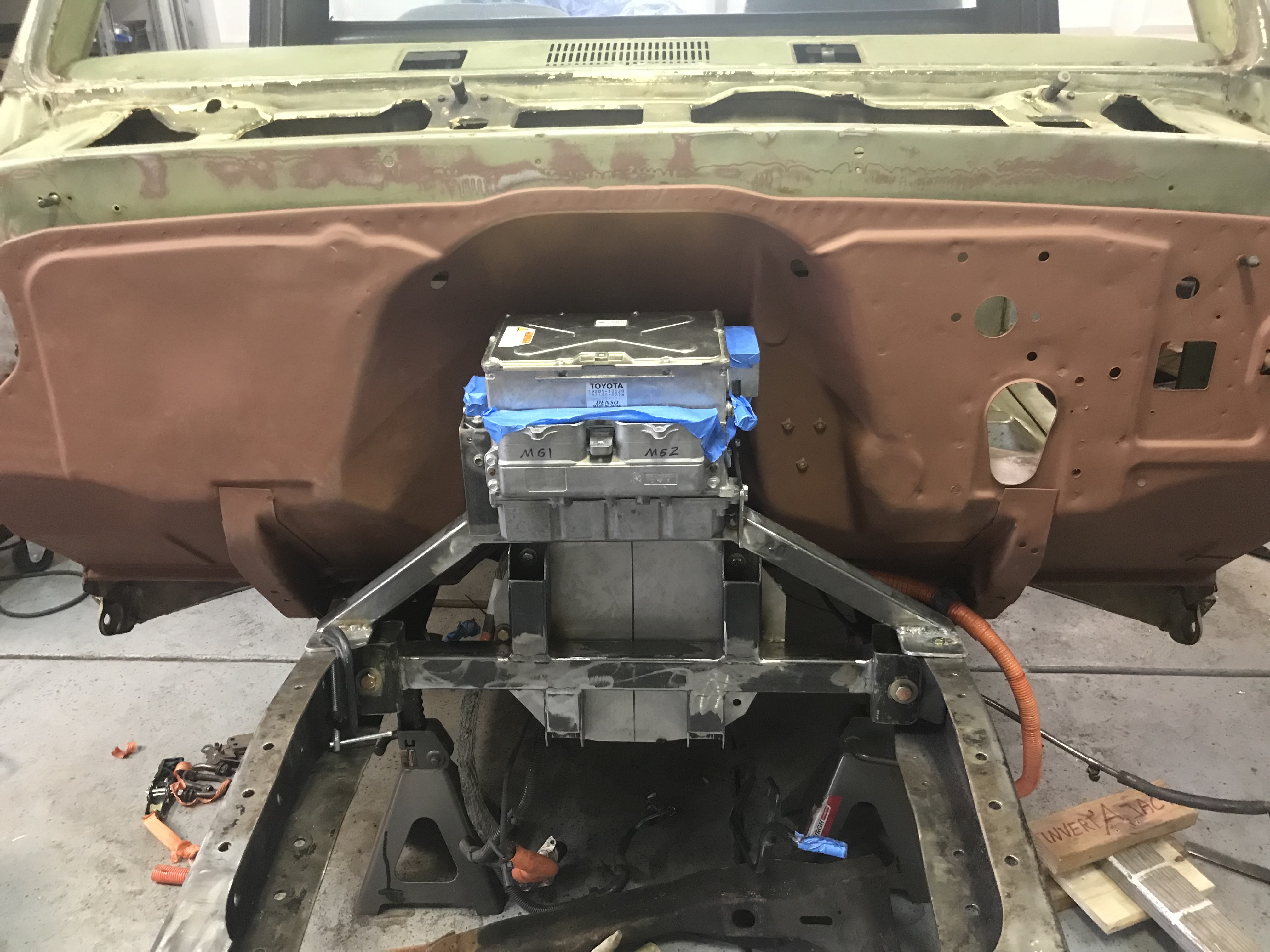

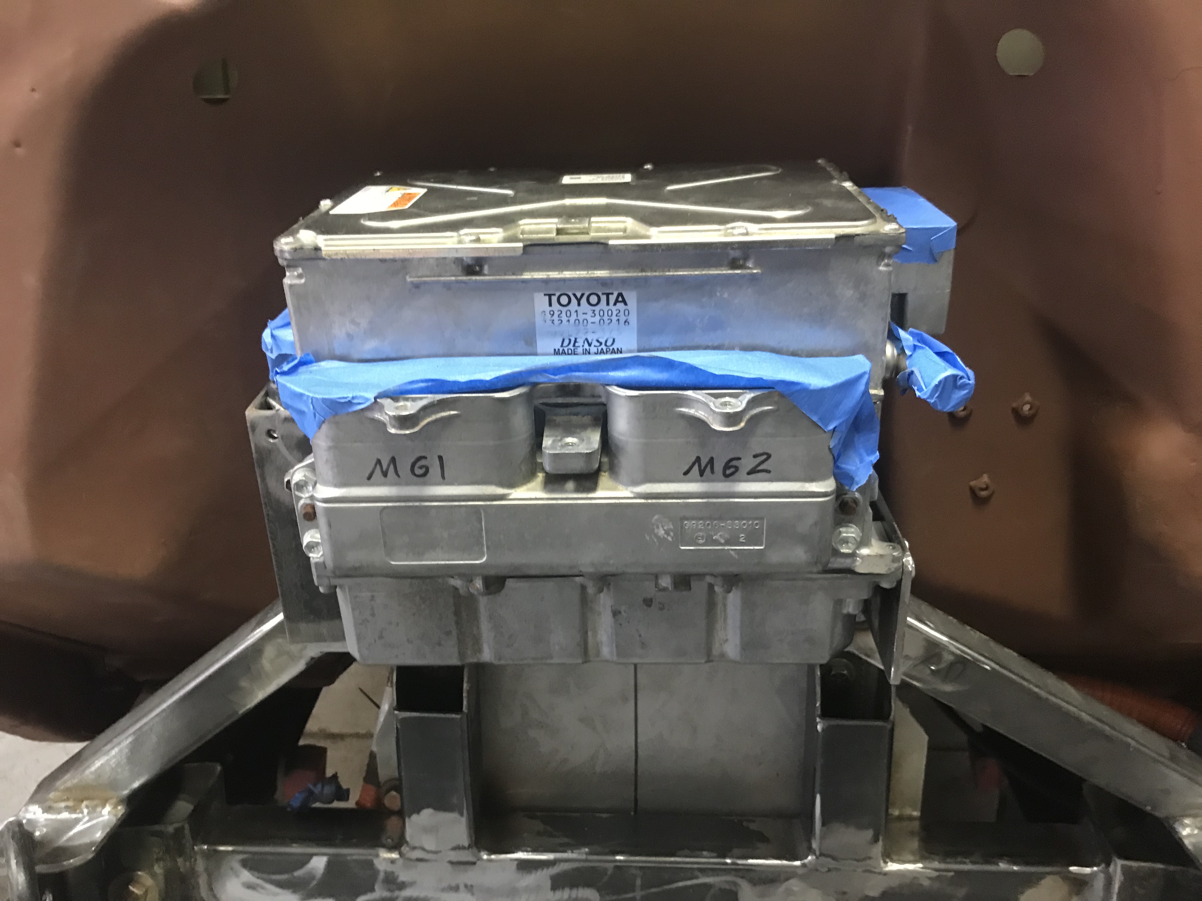

Post by Gregski »

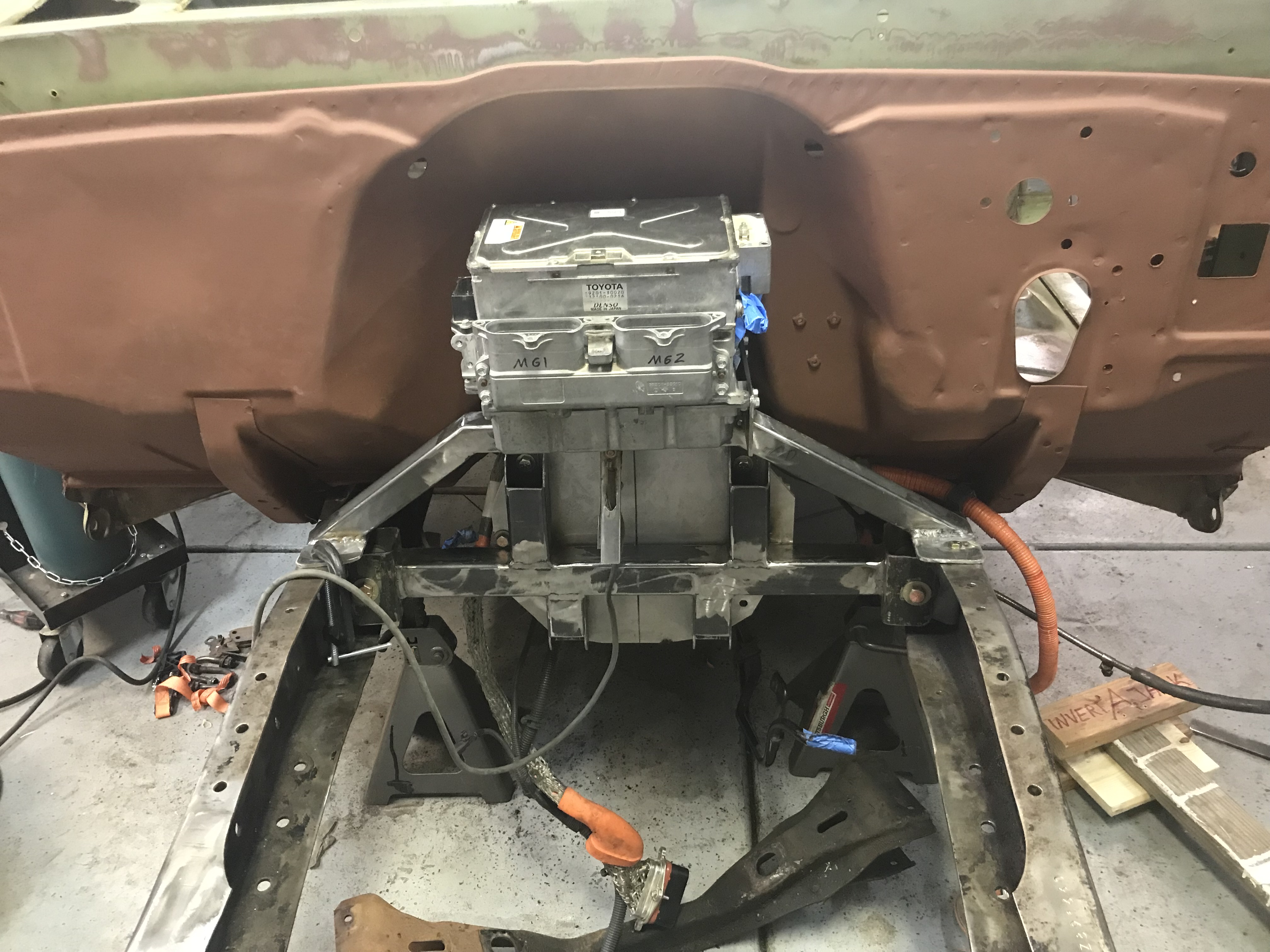

and here is Reason #197 why I chose the Lexus GS450 transmission as my electric power plant, essentially so I won't have to do this:
In this video Damien Maguire shows us what it takes to attach a first gen Nissan Leaf electric motor to a BMW E46 five speed transmission.
  • adapter plate
  • input shaft coupler
Don't get me wrong we loved our 2013 Nissan Leaf which we leased for three years, and of course I love Damien, everything I know about EVs I learned from his videos.
but please take a looksie and anjoy
oh by the way 197 is also the horse power of the bigger electric motor inside of our Lexus transmission, yes there are two electric motors inside of it, the other one is a bit smaller

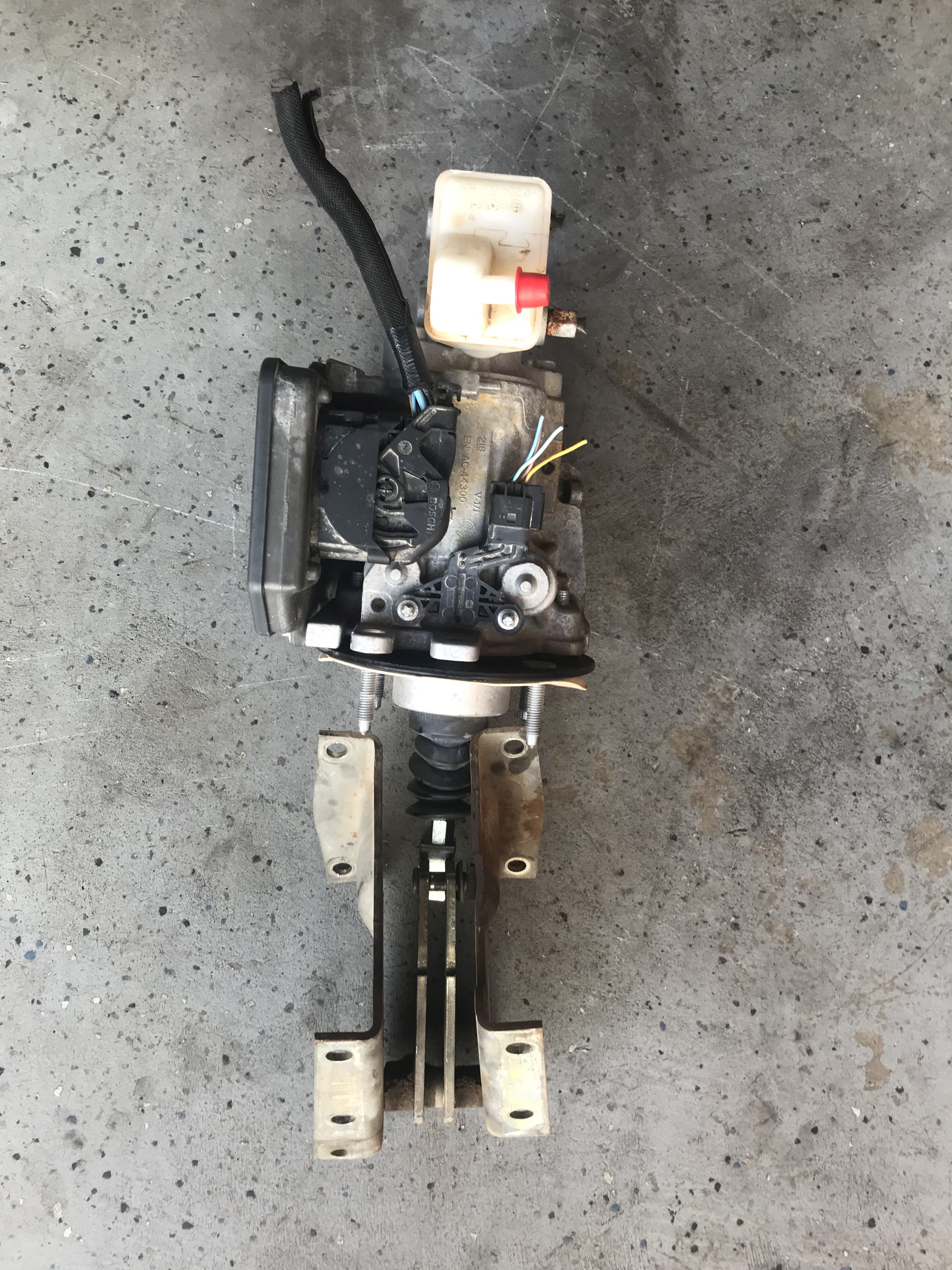

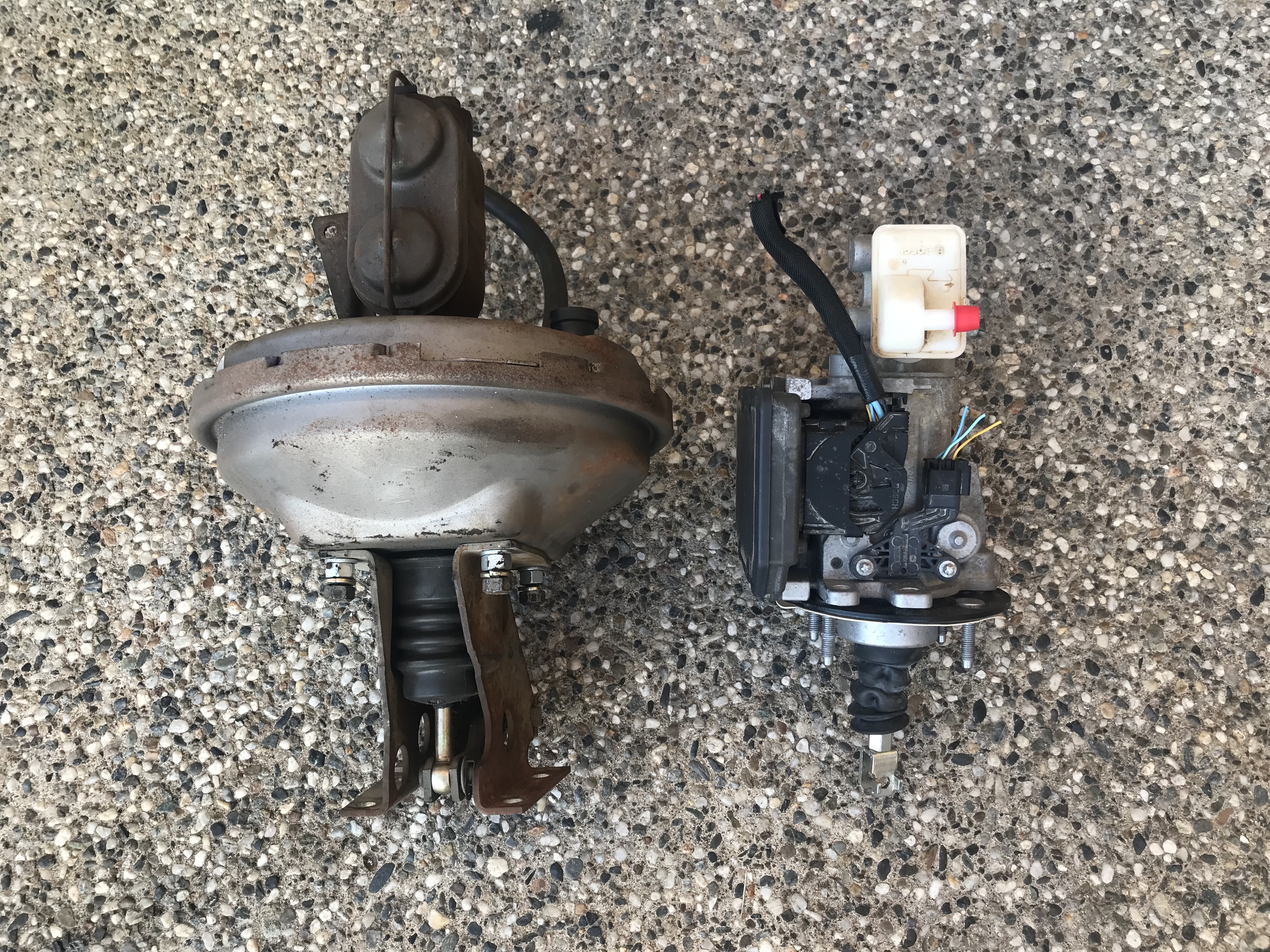

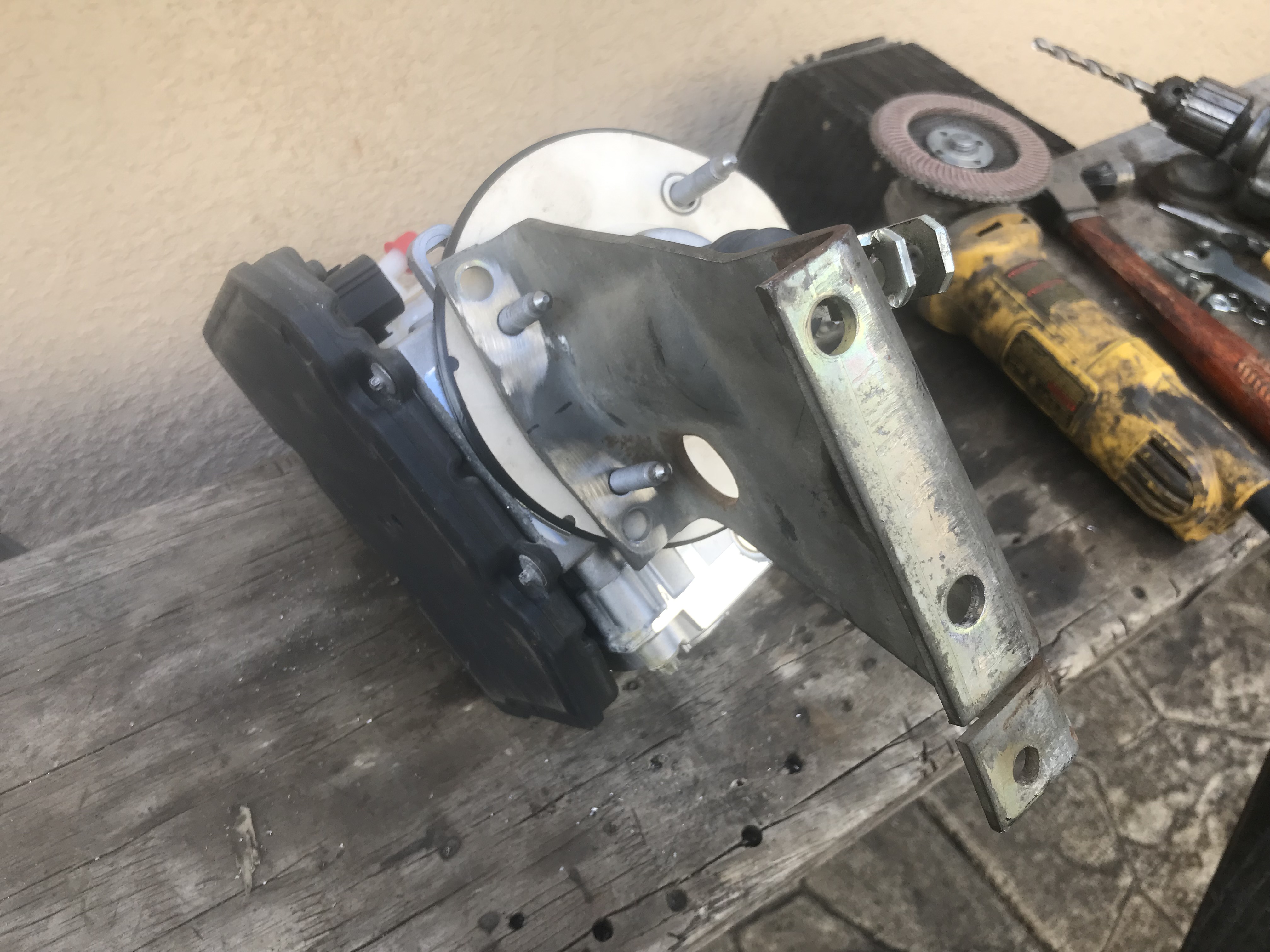

Post by Gregski »

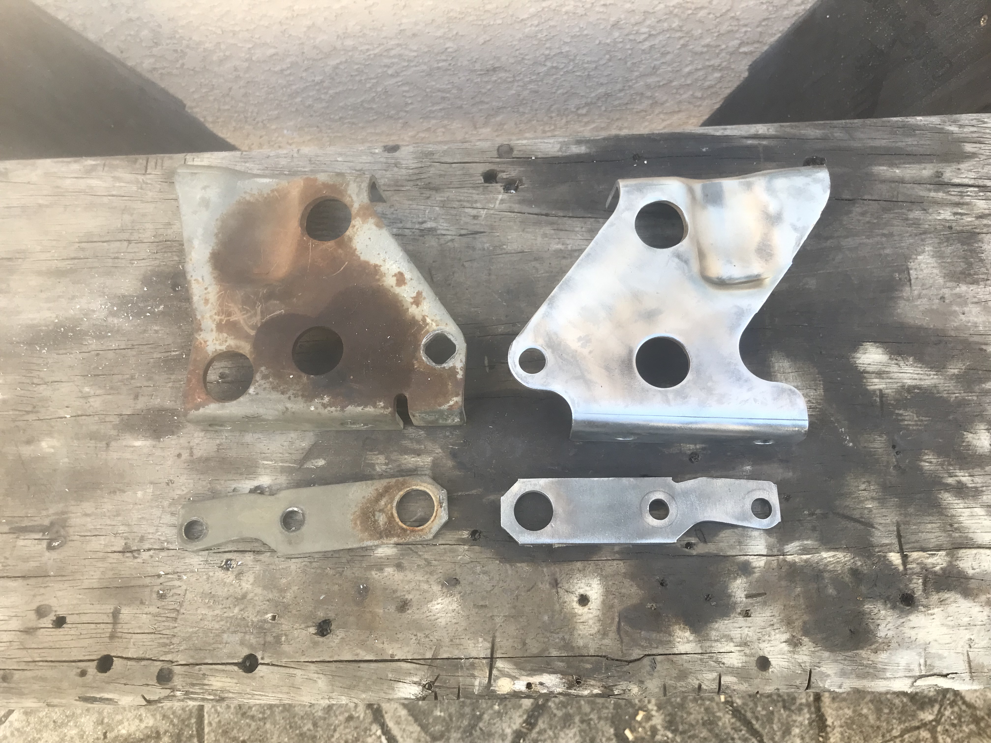

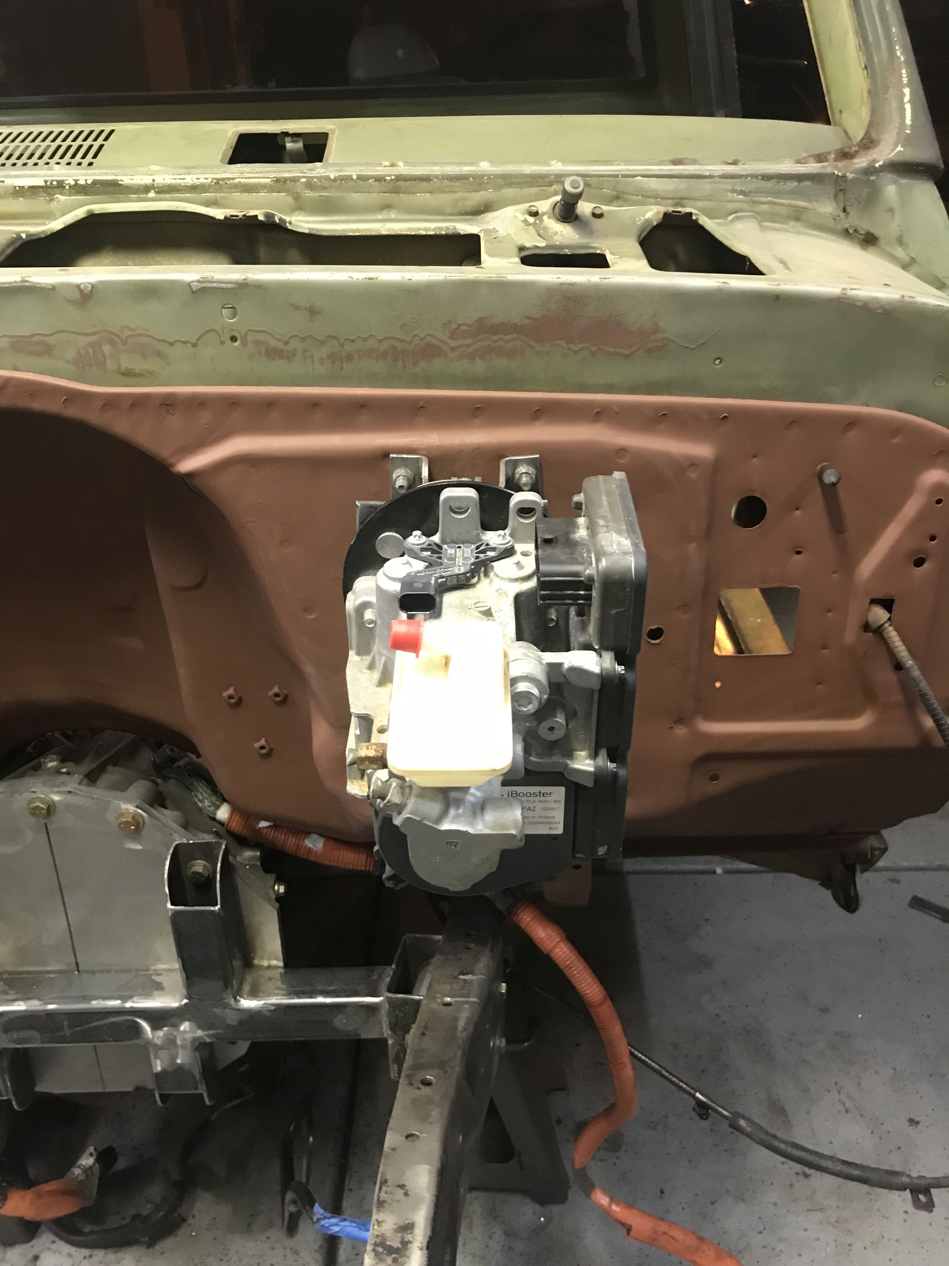

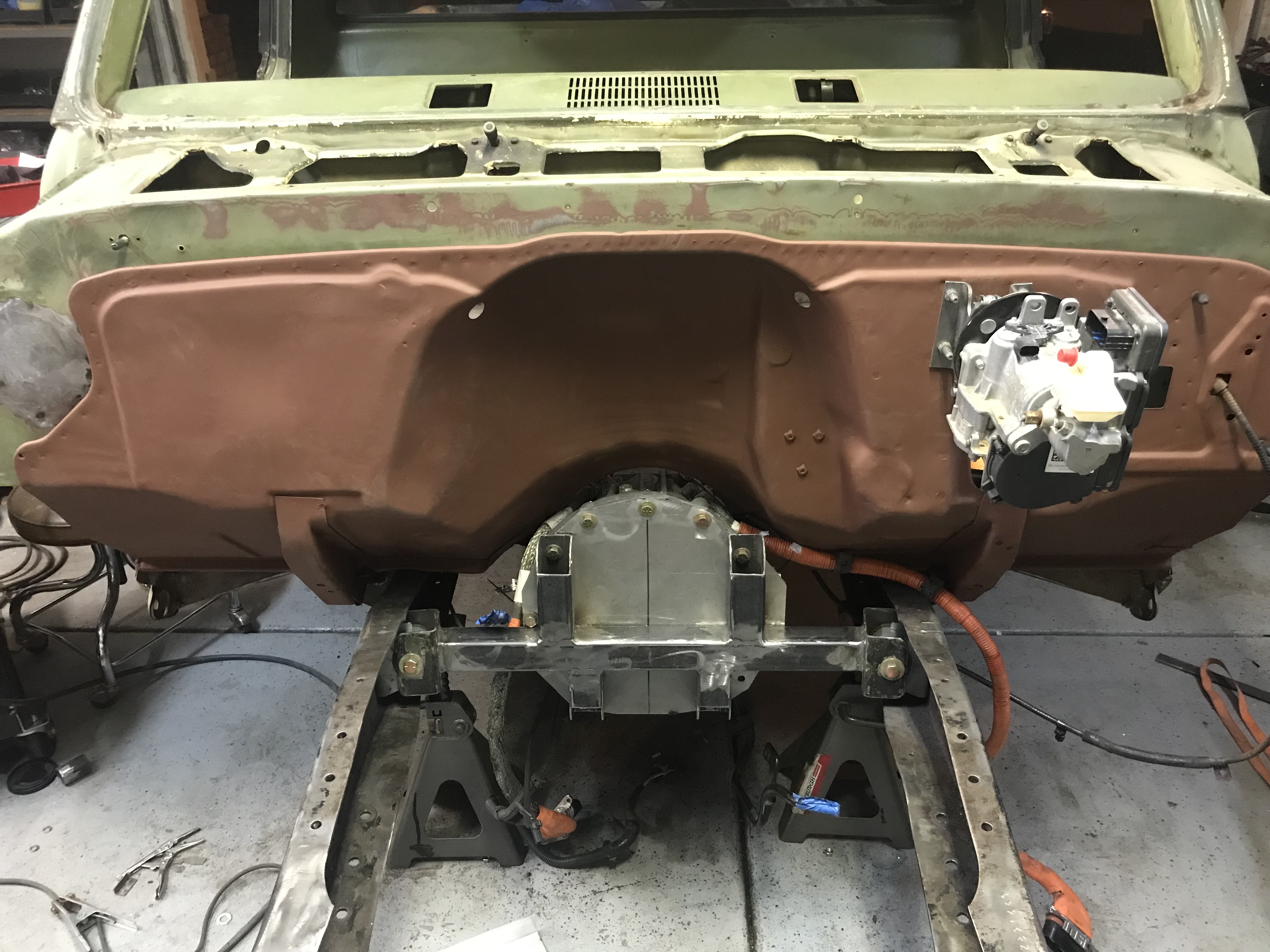

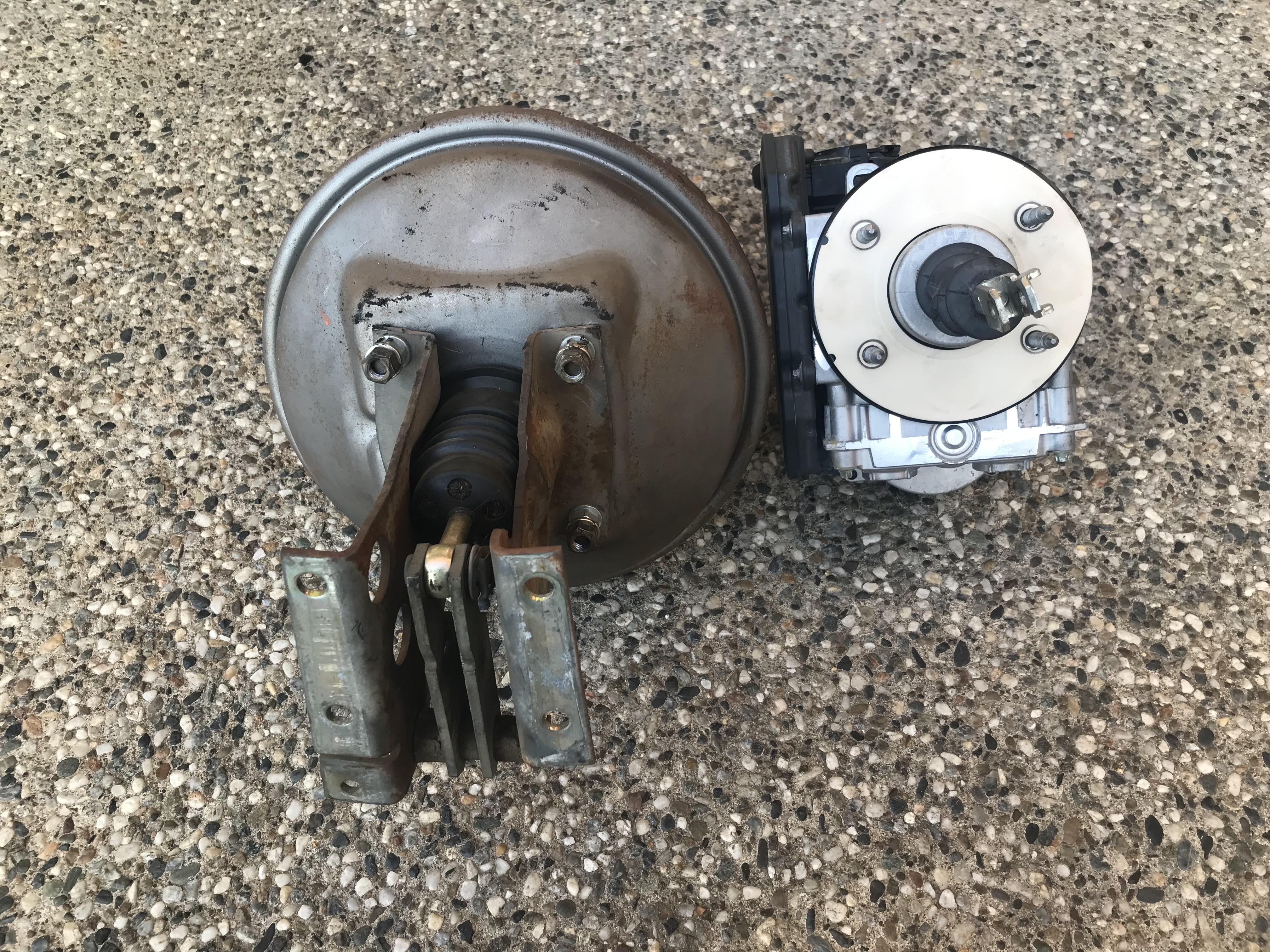

so when the combustion engine goes away, so does vacuum or the source of vacuum, this means that we loose power brakes, as the brake booster is vacuum operated, here I am starting to work with a replacement electronic booster called an iBooster from a 2018 Honda CRV (there were two generations of this animal, and I believe mine is still Gen 1)
thanks be to Lars and his amazing blog on this topic at EVcreate.nl Electric power brakes
but first the mandatory stare and compare (Chevy on the left, not Chevy on the right)

Post by Gregski »
I can't believe the short sightedness of the Chevy engineers, that merely 50 years ago they could not foresee that we would some day be bolting up electronic components to these rigs, was all that pretend metric compliance for nothing? needless to say I must drill four new holes, oh the calamity

Post by Gregski »

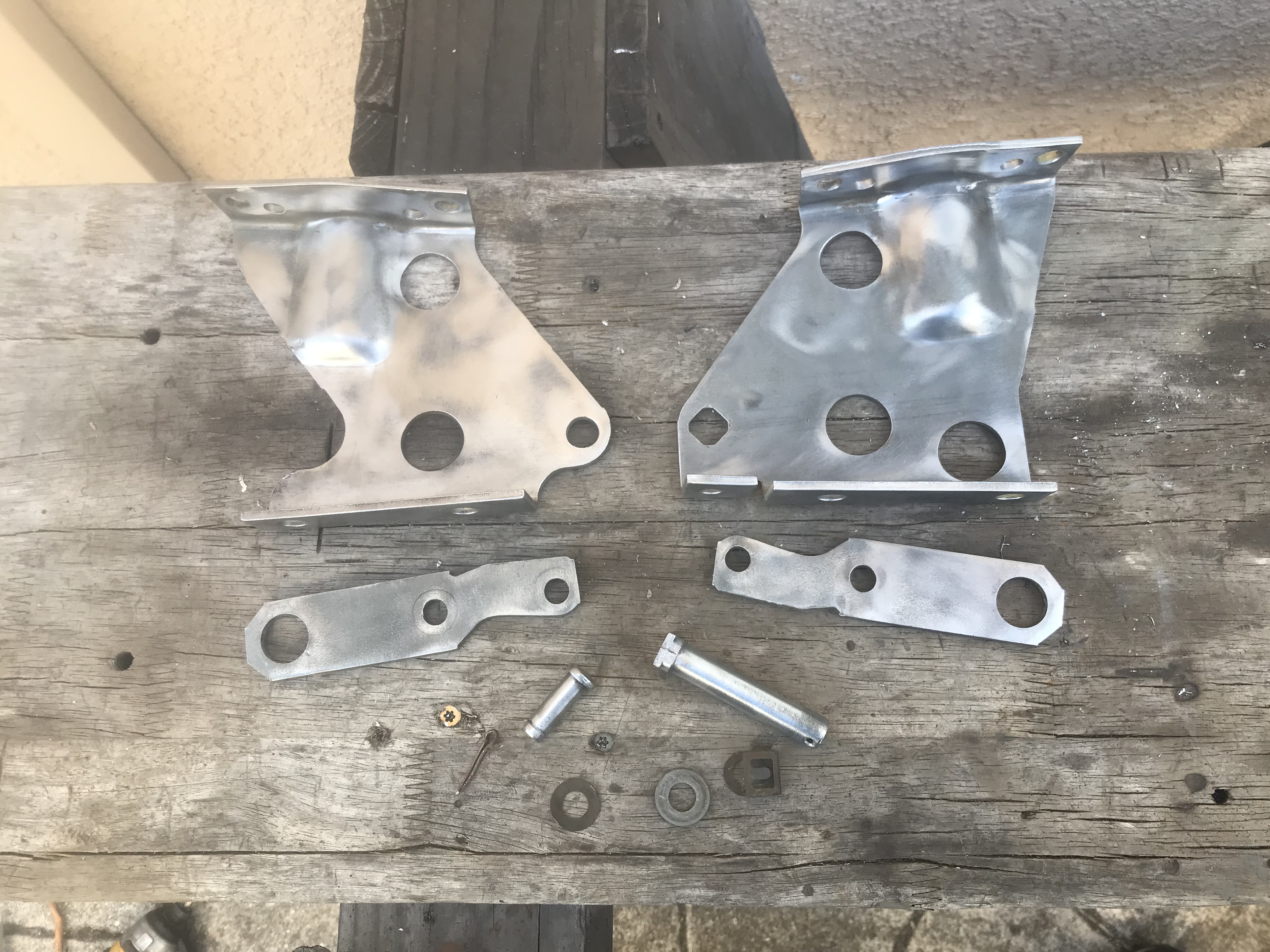

time to adapt and overcome
I may weld up the old holes, I may not

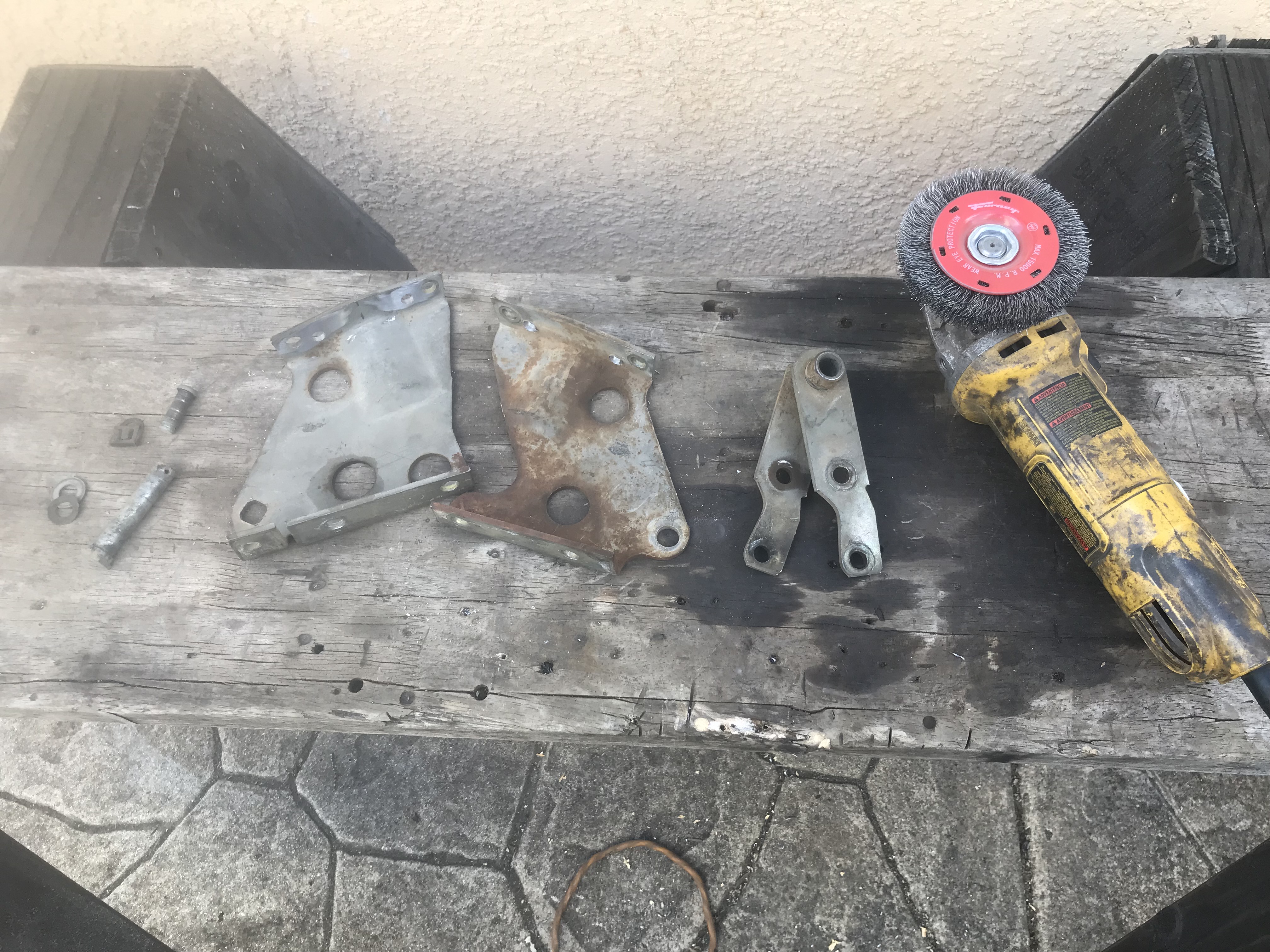

Post by Gregski »

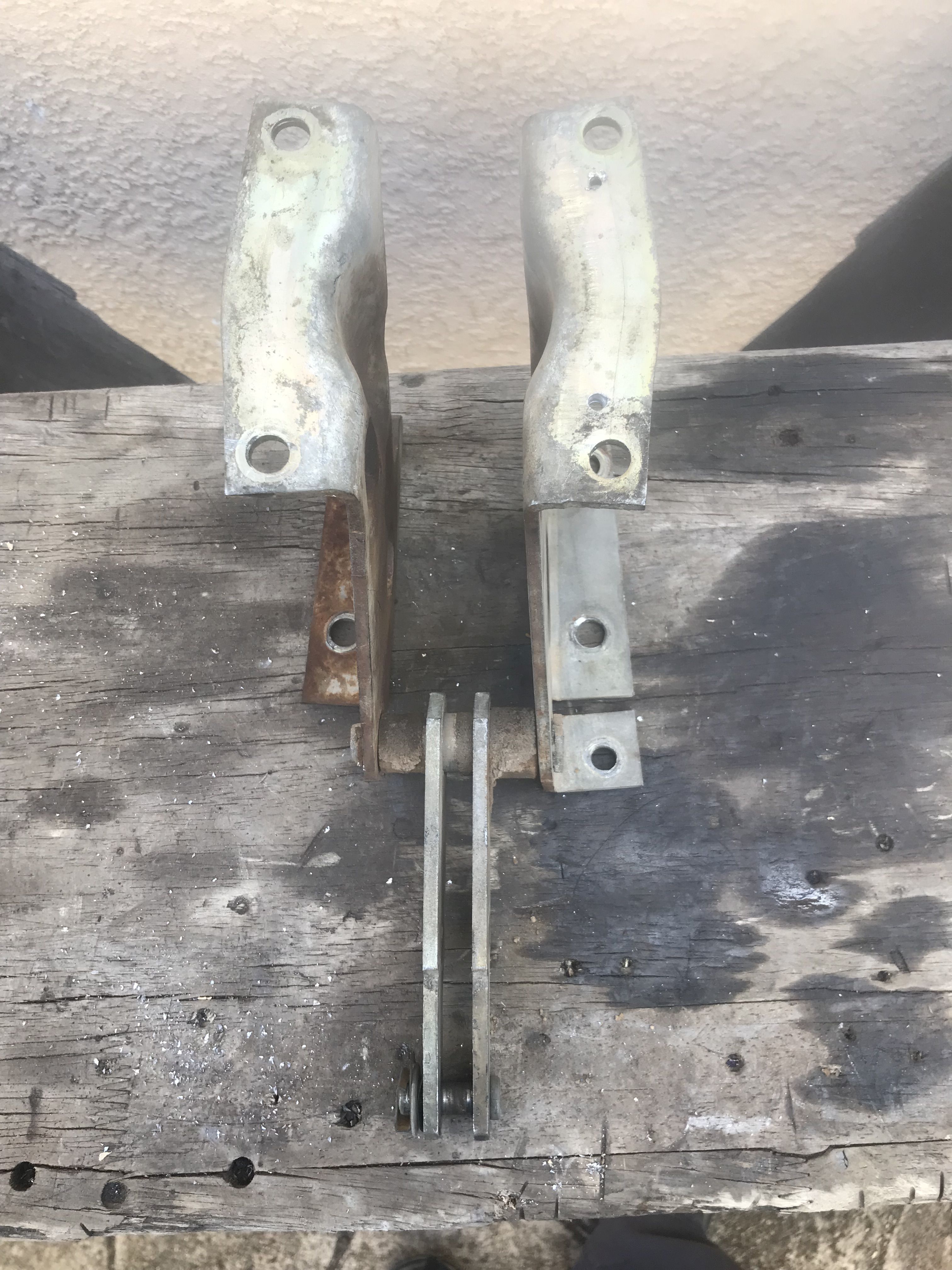

and I like to clean my old parts after I work with them, to maximize my chances of tetanus

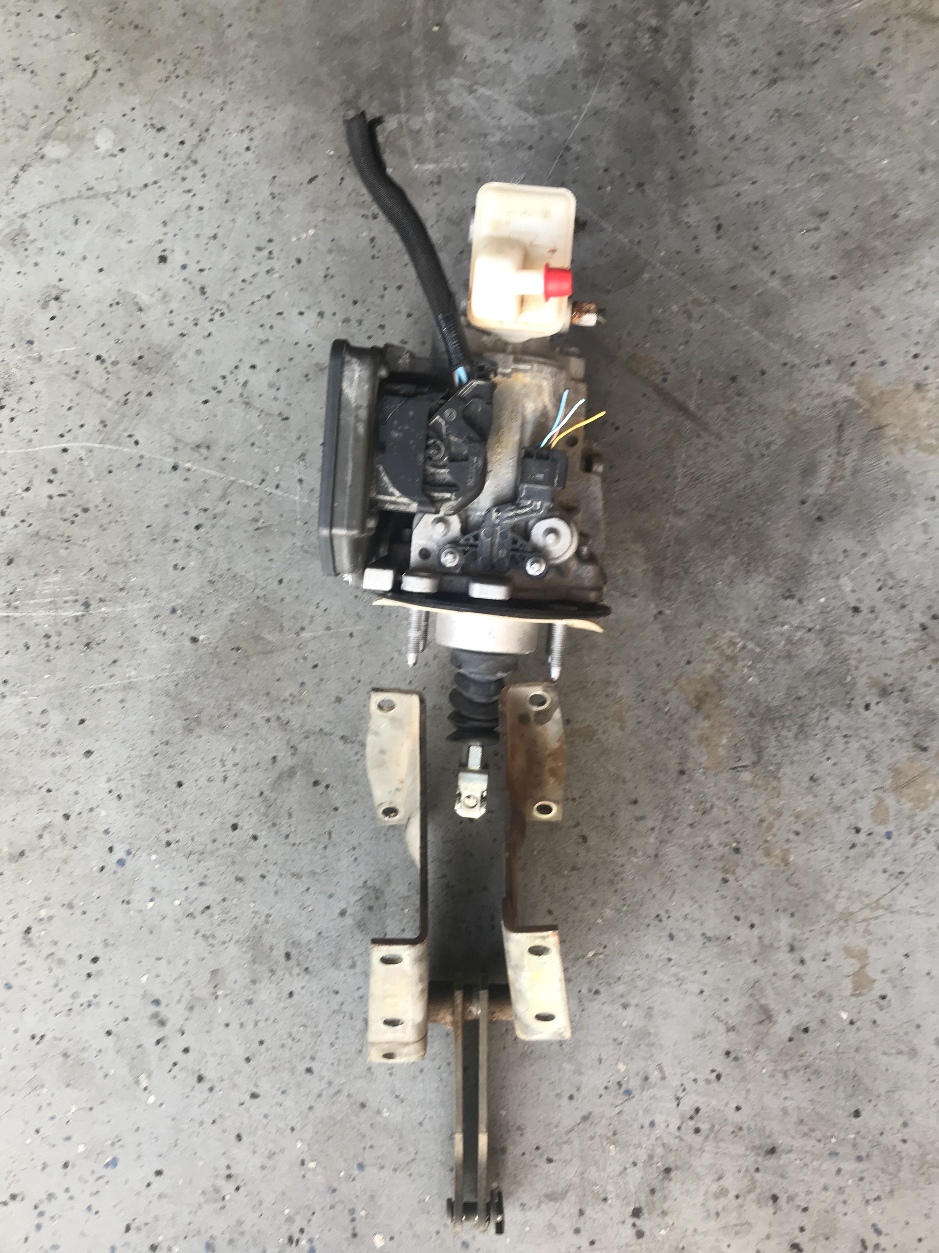

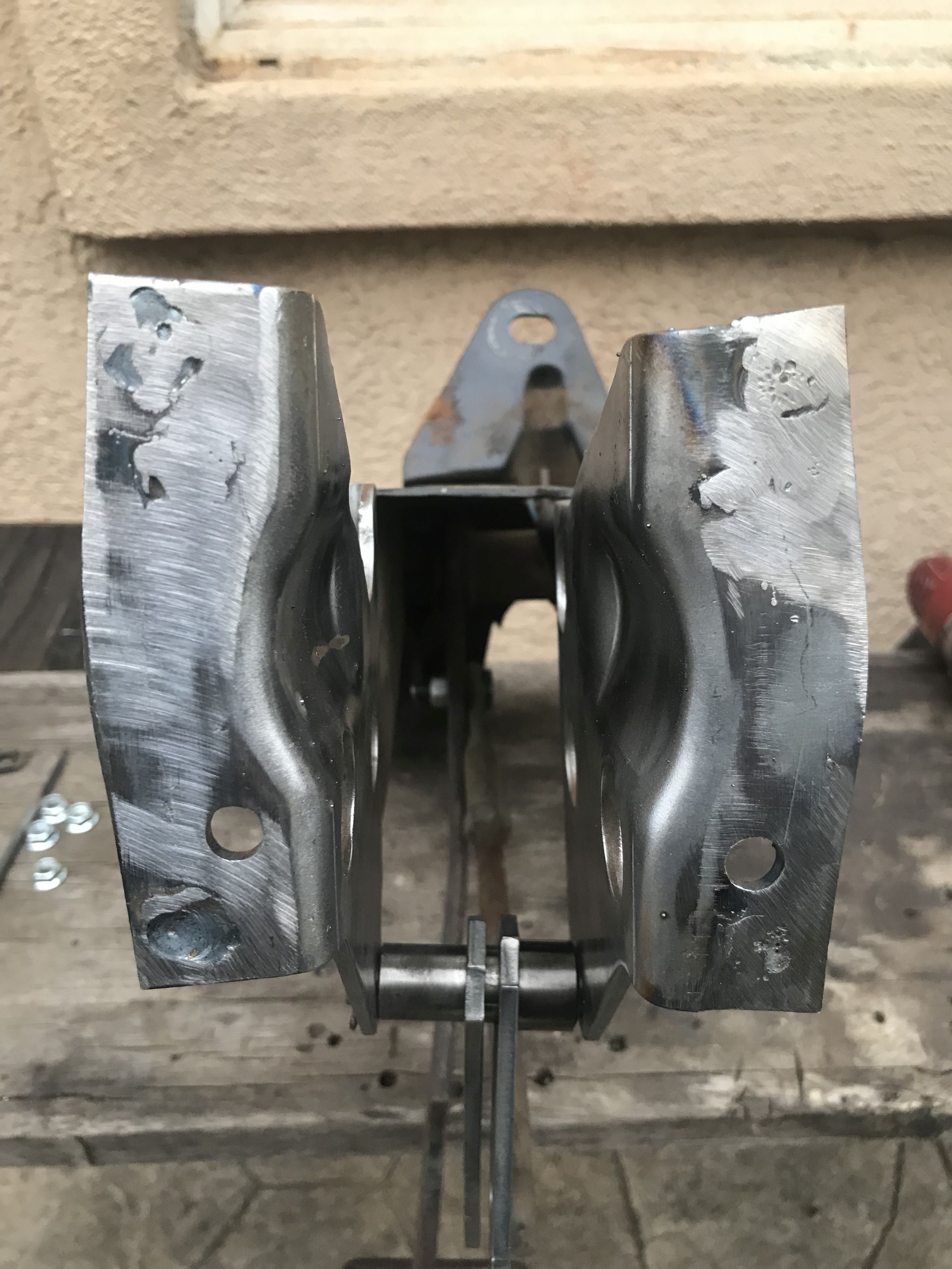

Post by Gregski »
after little thought I just nibbed off this eyelet off of the old booster and stuckatized it on to the new one
Gregski
Posts: 3158

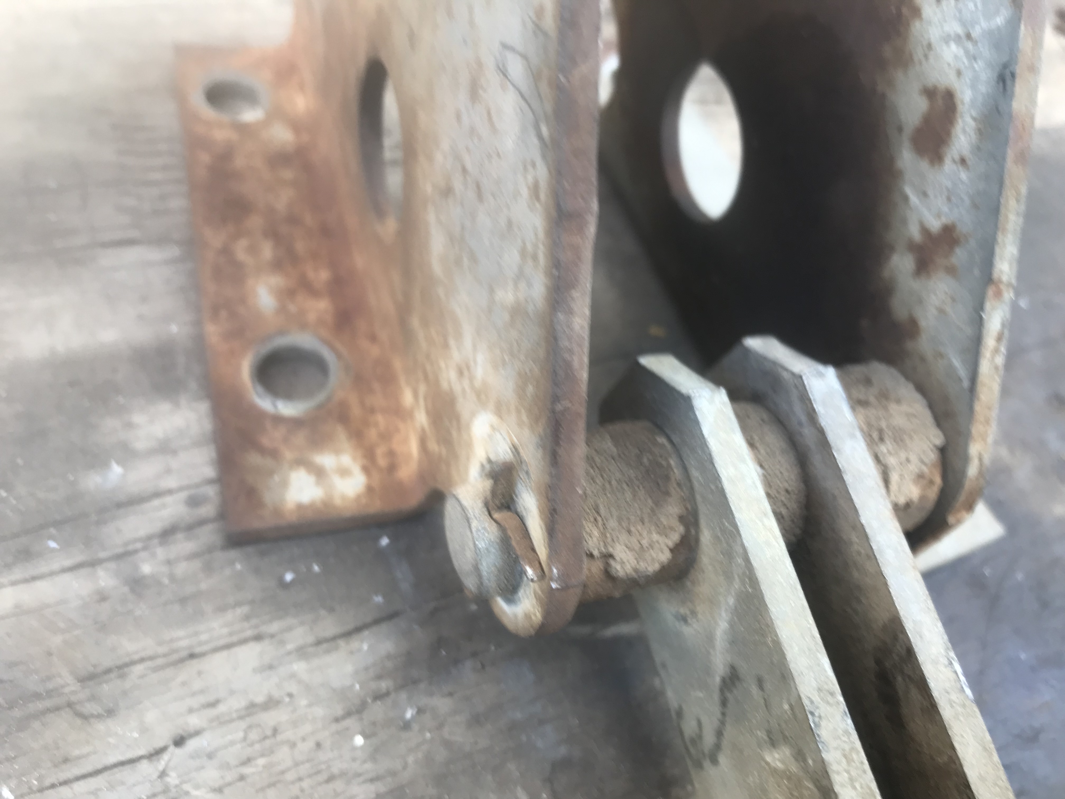

Post by Gregski »
Fun Fact: Trusting that your 70s vehicle was built with the highest of precision fitment standards in mind and perfect symmetry is a sure way to make you drill and weld up your new holes two or three times to fianlly meet their polywhompuses
this is how off the factory brackets come off the firewall towards the new booster, they are NOT even (like I originally assumed)

Post by Gregski »
this is the part where you tell me I mounted it sideways or upside down ?
2018 Honda CRV iBooster same crap as in the Tesla but for a 1/3rd of the cost

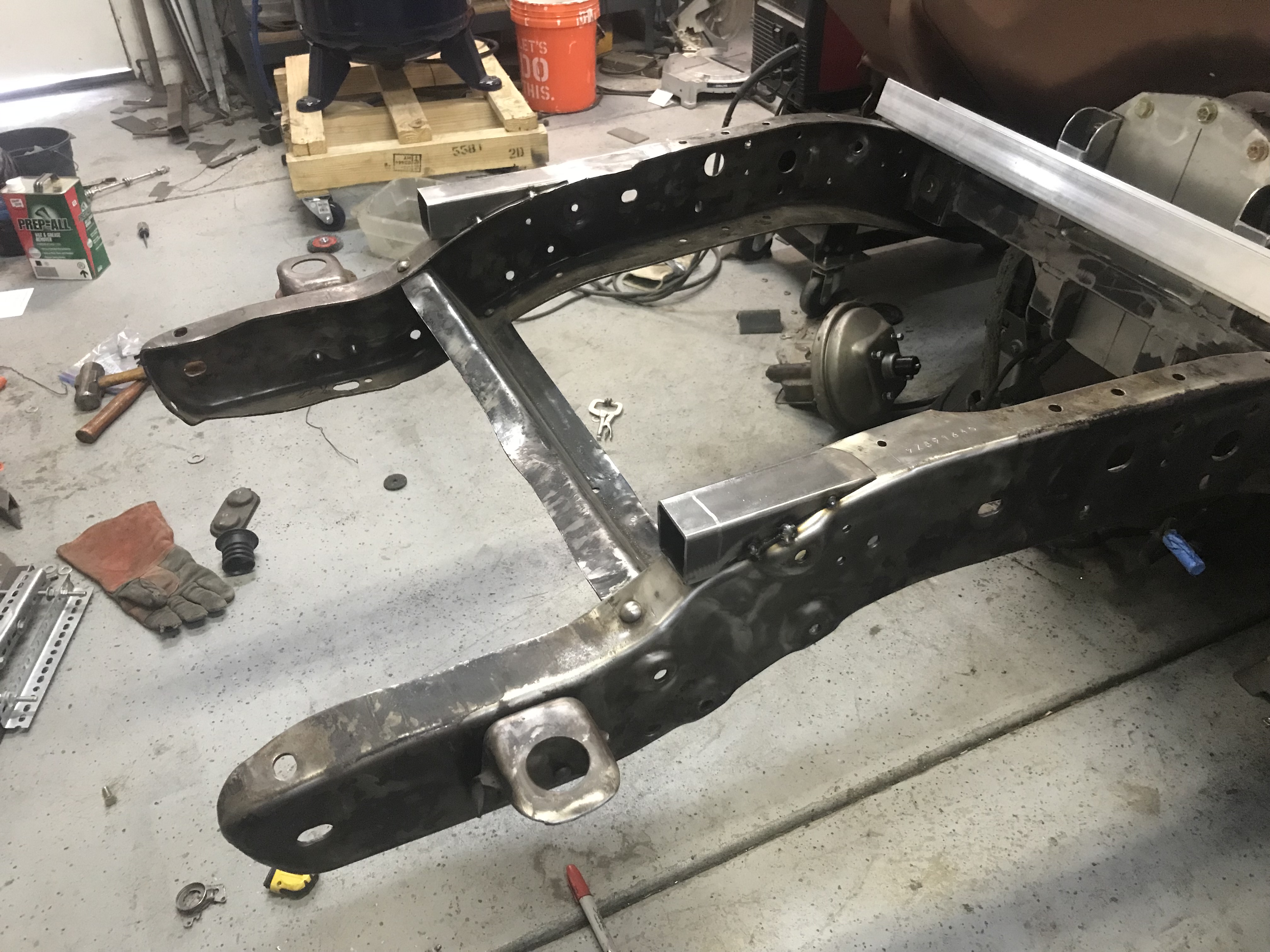

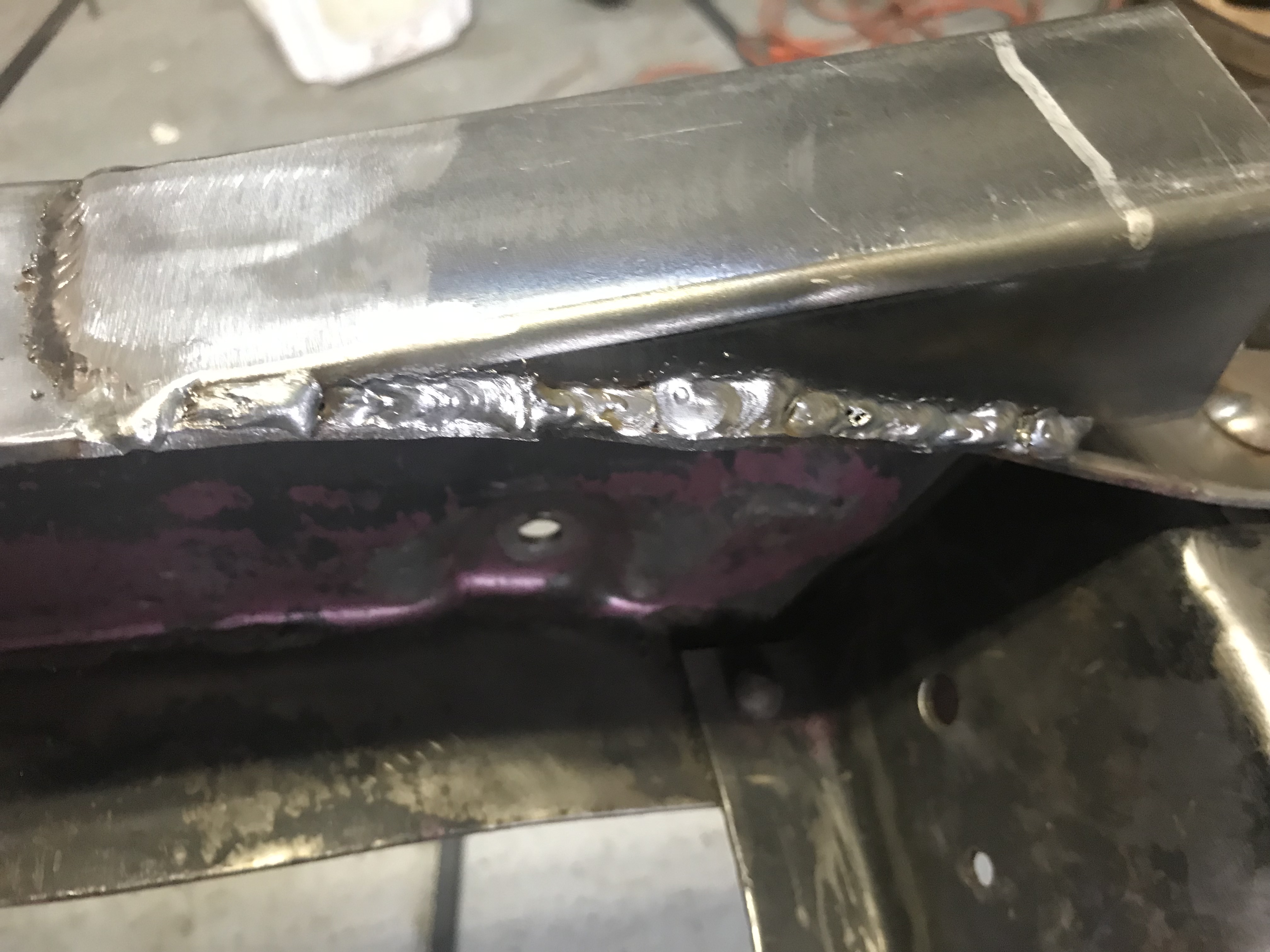

Post by Gregski »

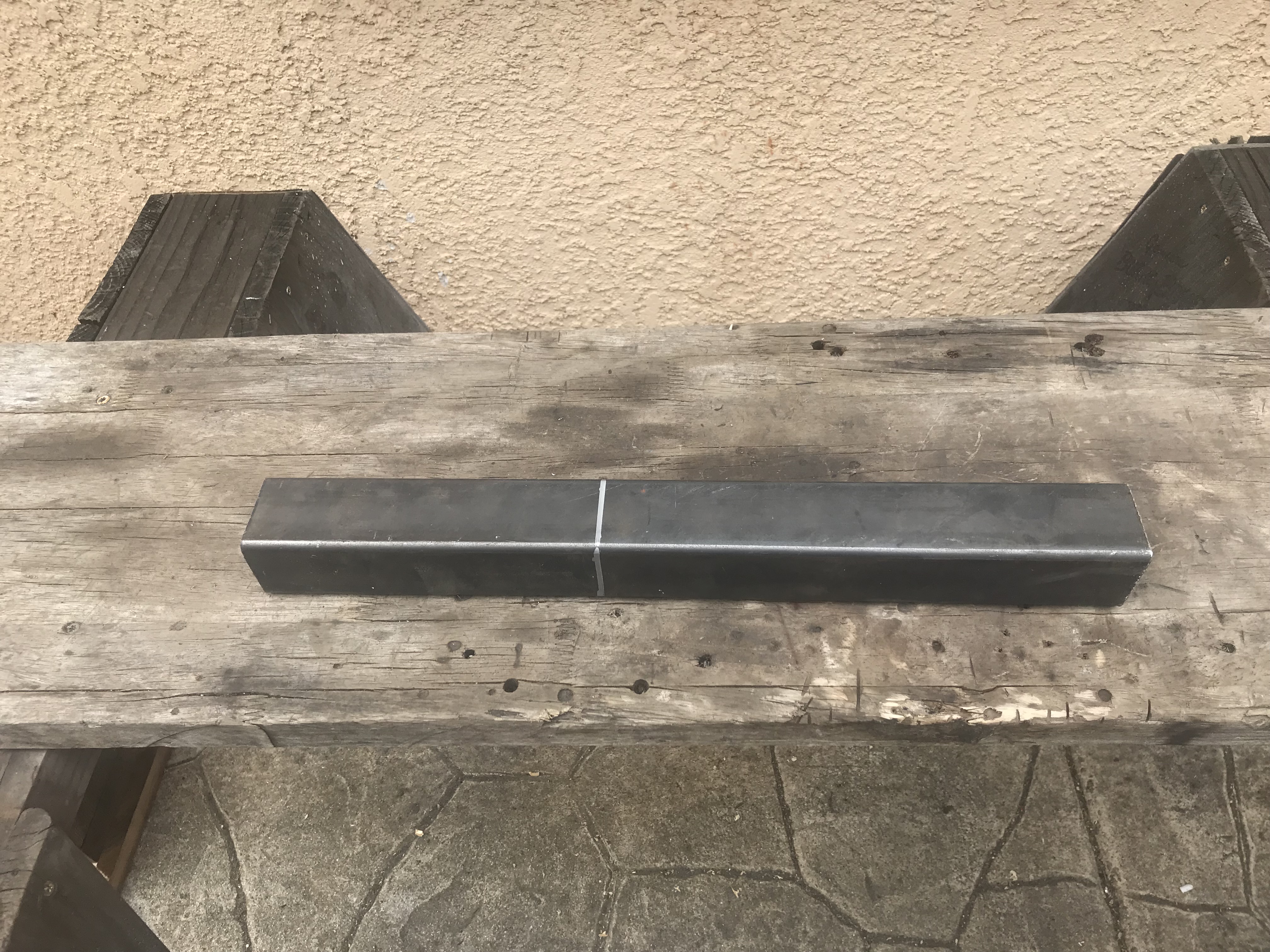

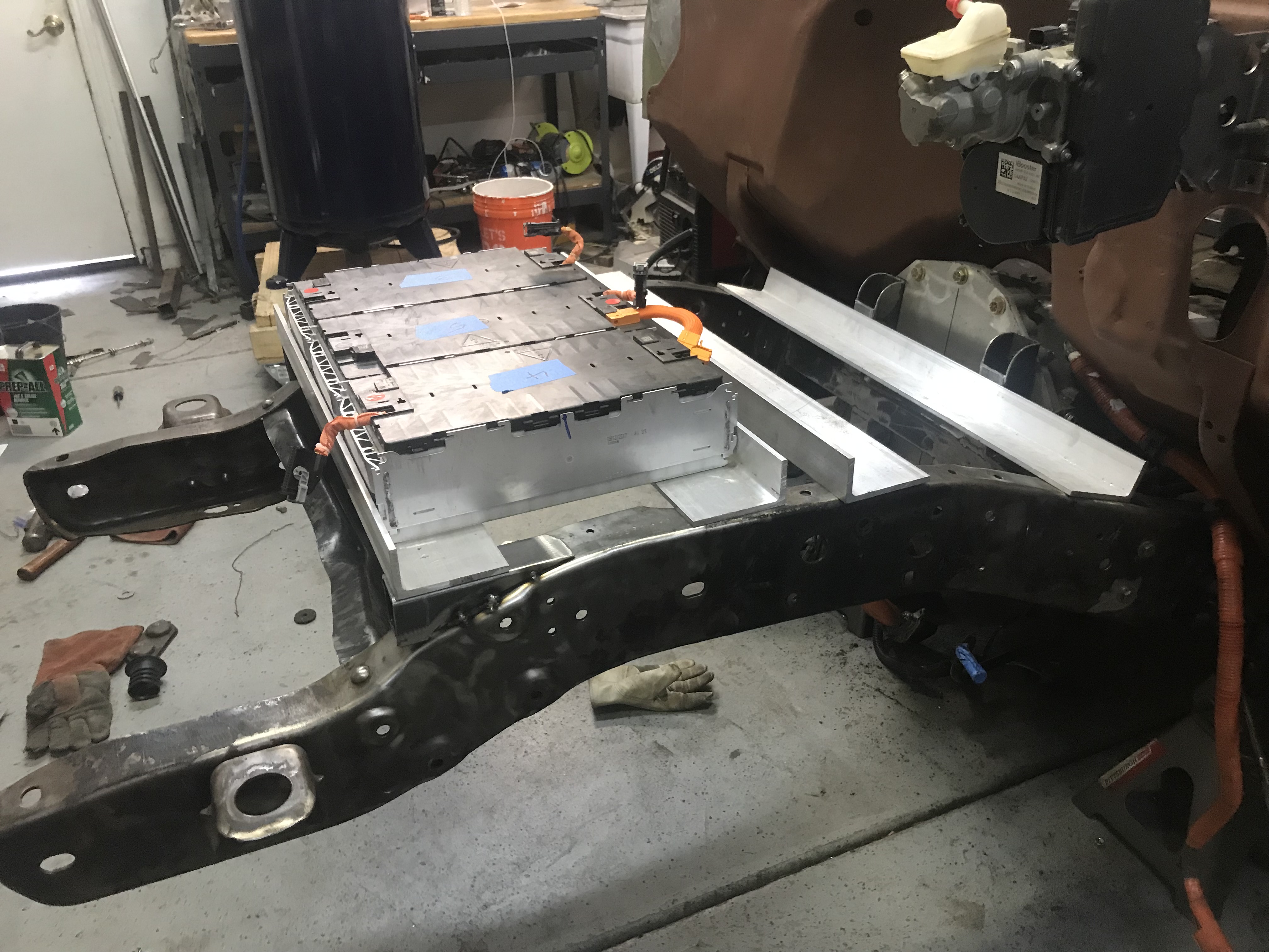

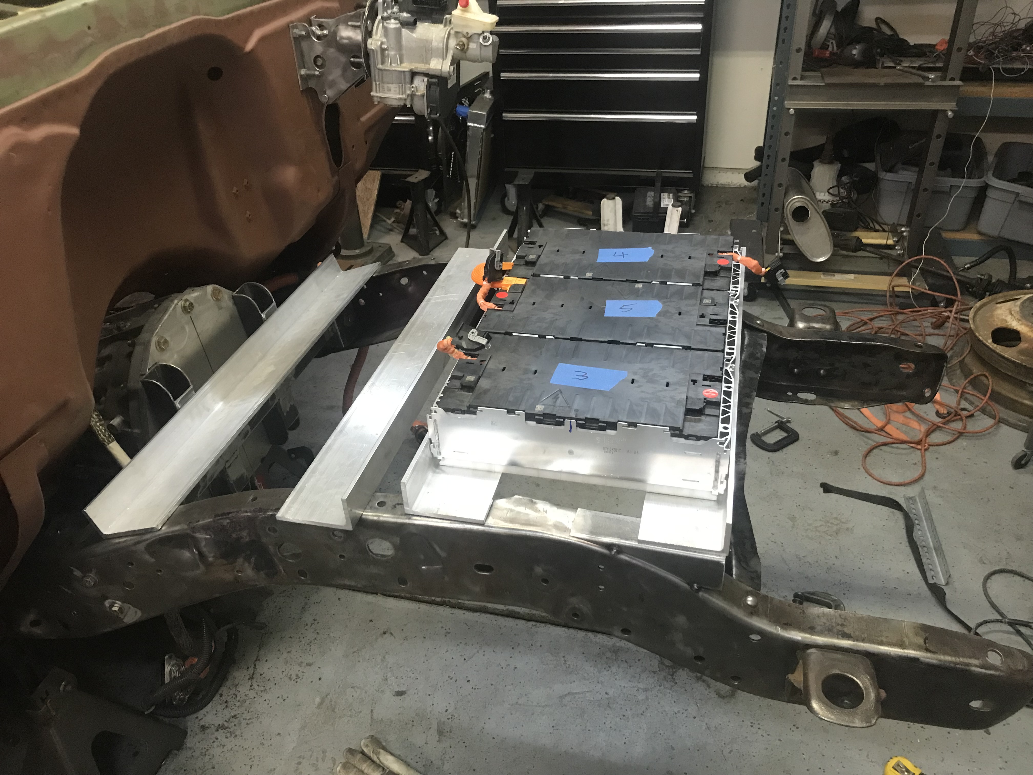

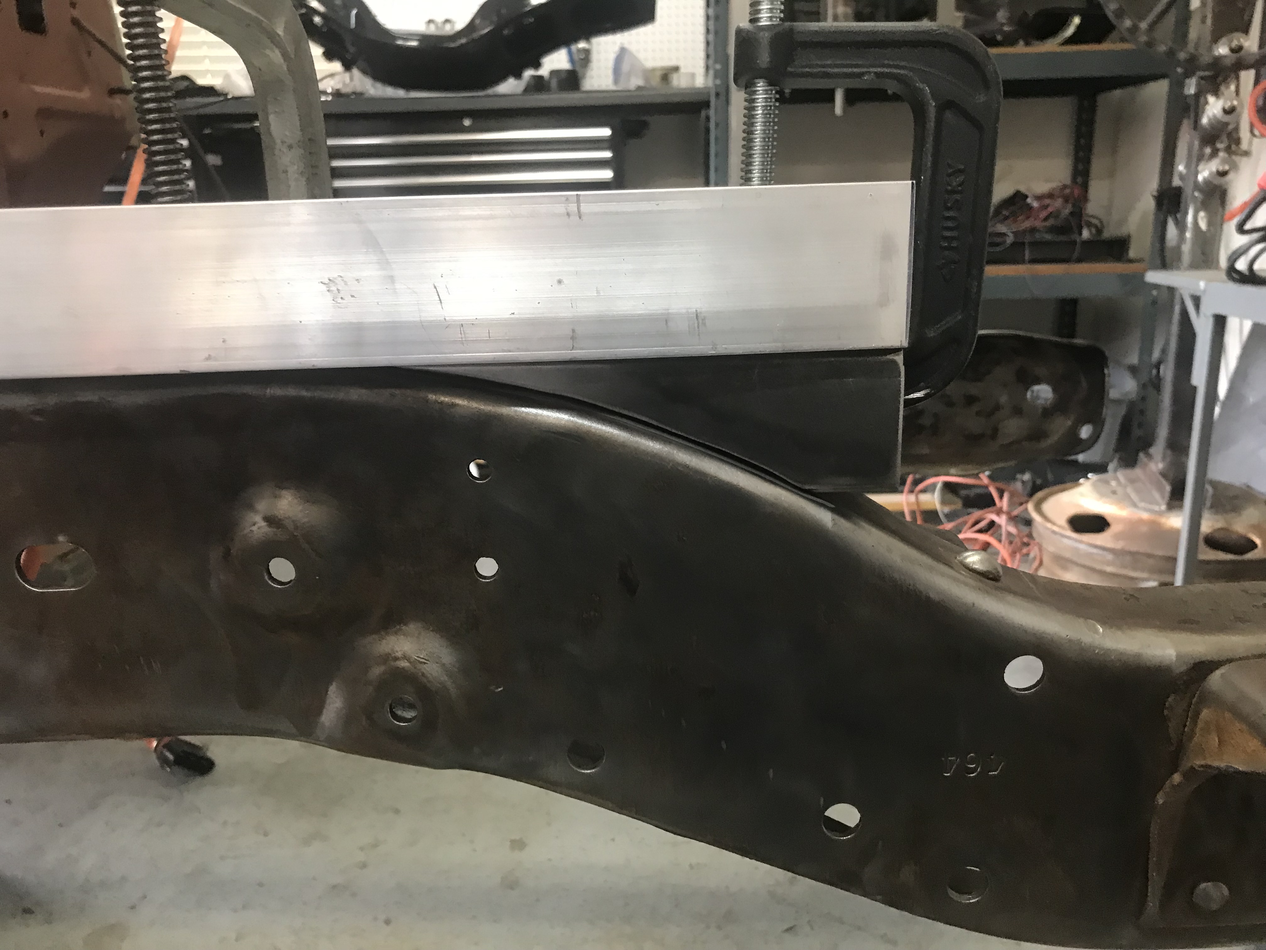

I think I put off tackling the battery tray long enuff, so first it was time to make the uneven, even!
using only the finest metals from my scrap pile of finest metals
Gregski
Posts: 3158

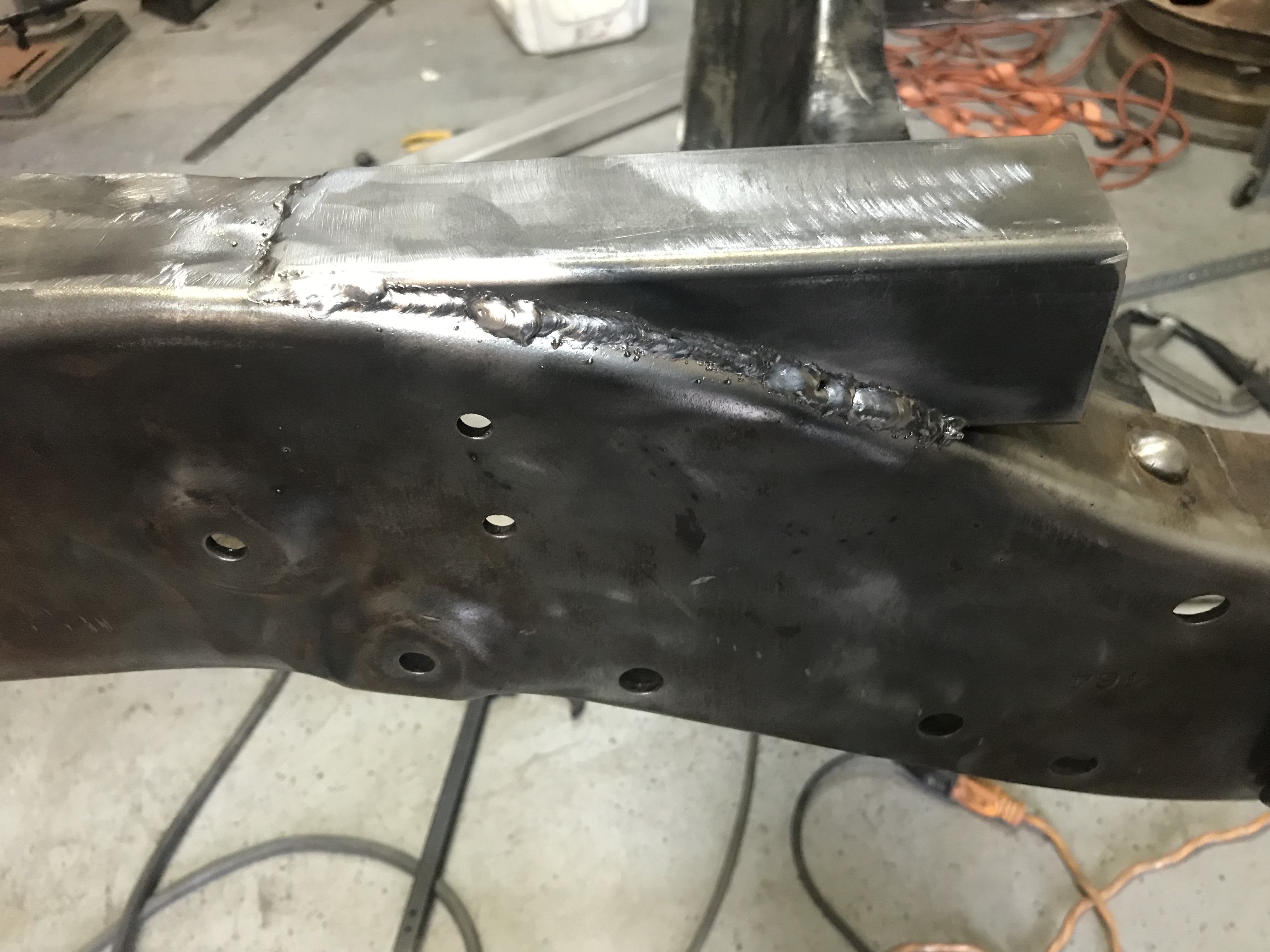

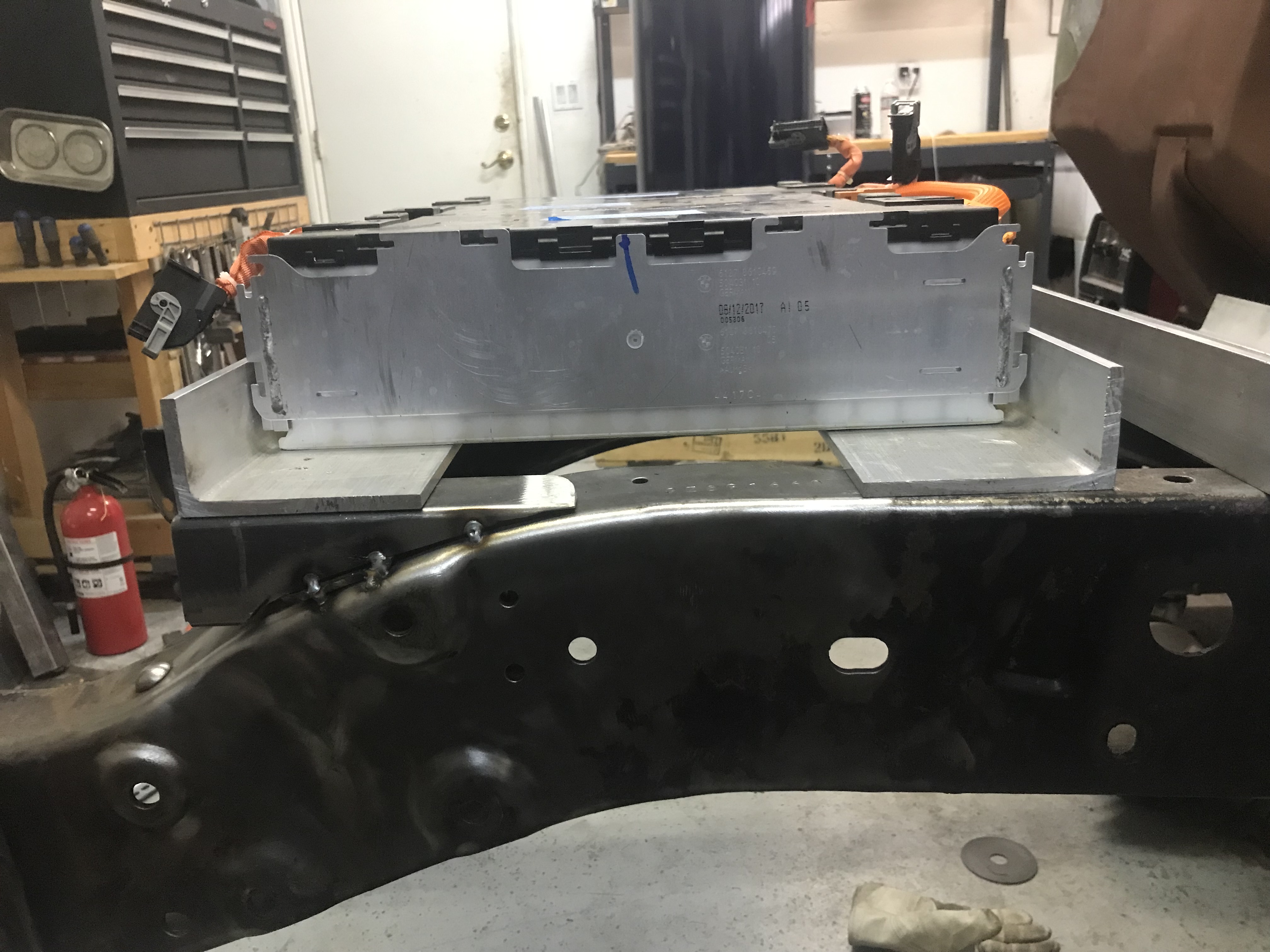

Post by Gregski »
this is approximately 3,612 back and forths with the angle grinder
tack you very much
Gregski
Posts: 3158

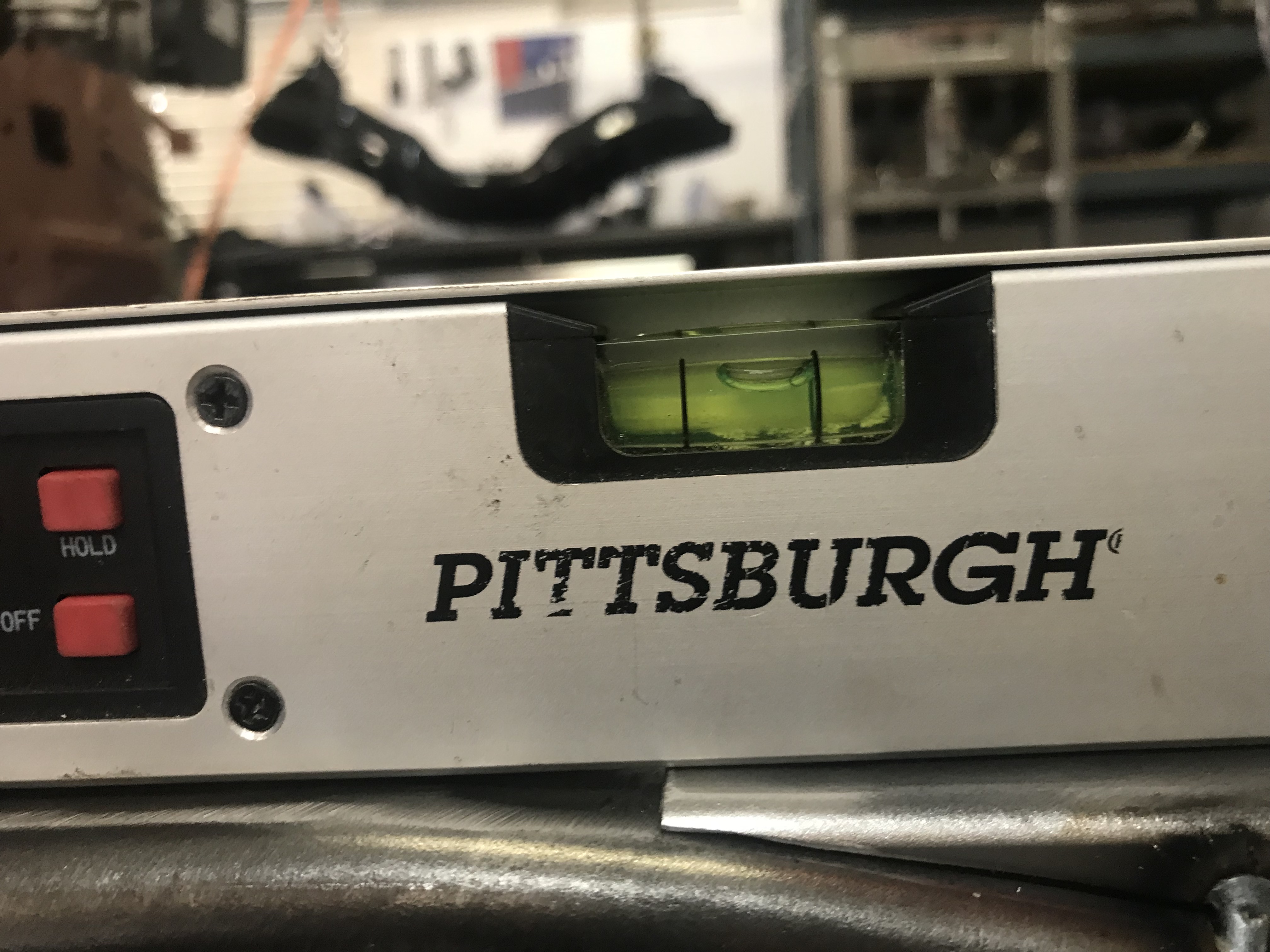

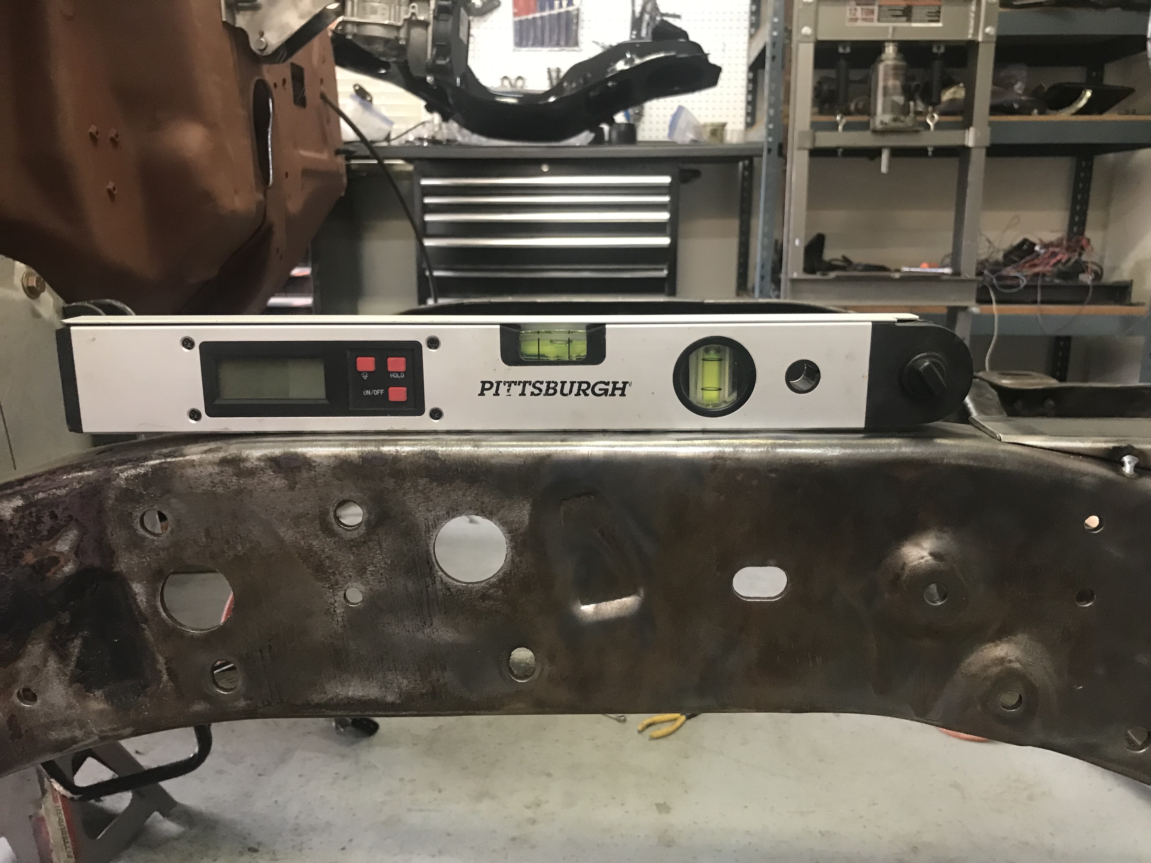

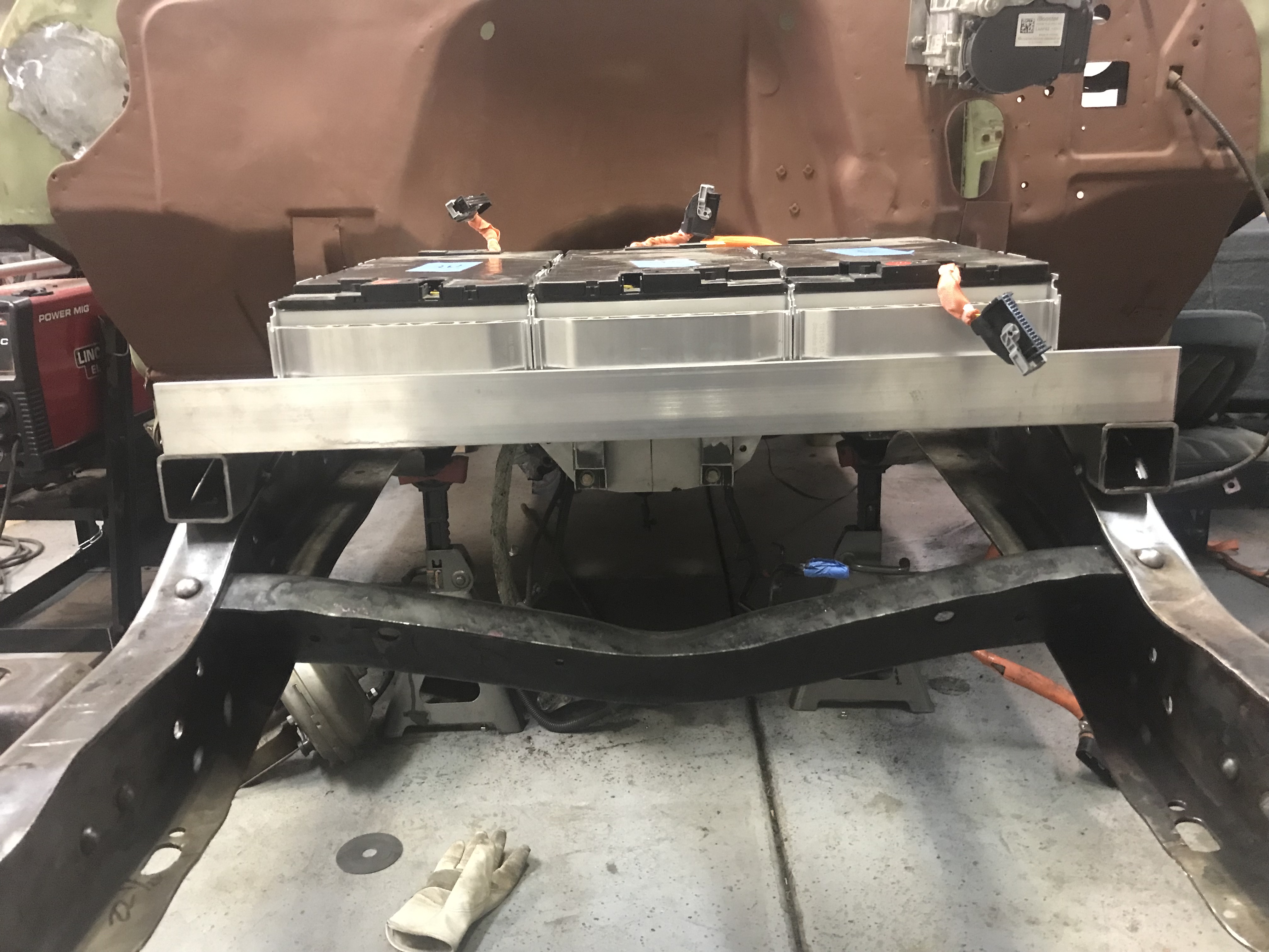

Post by Gregski »

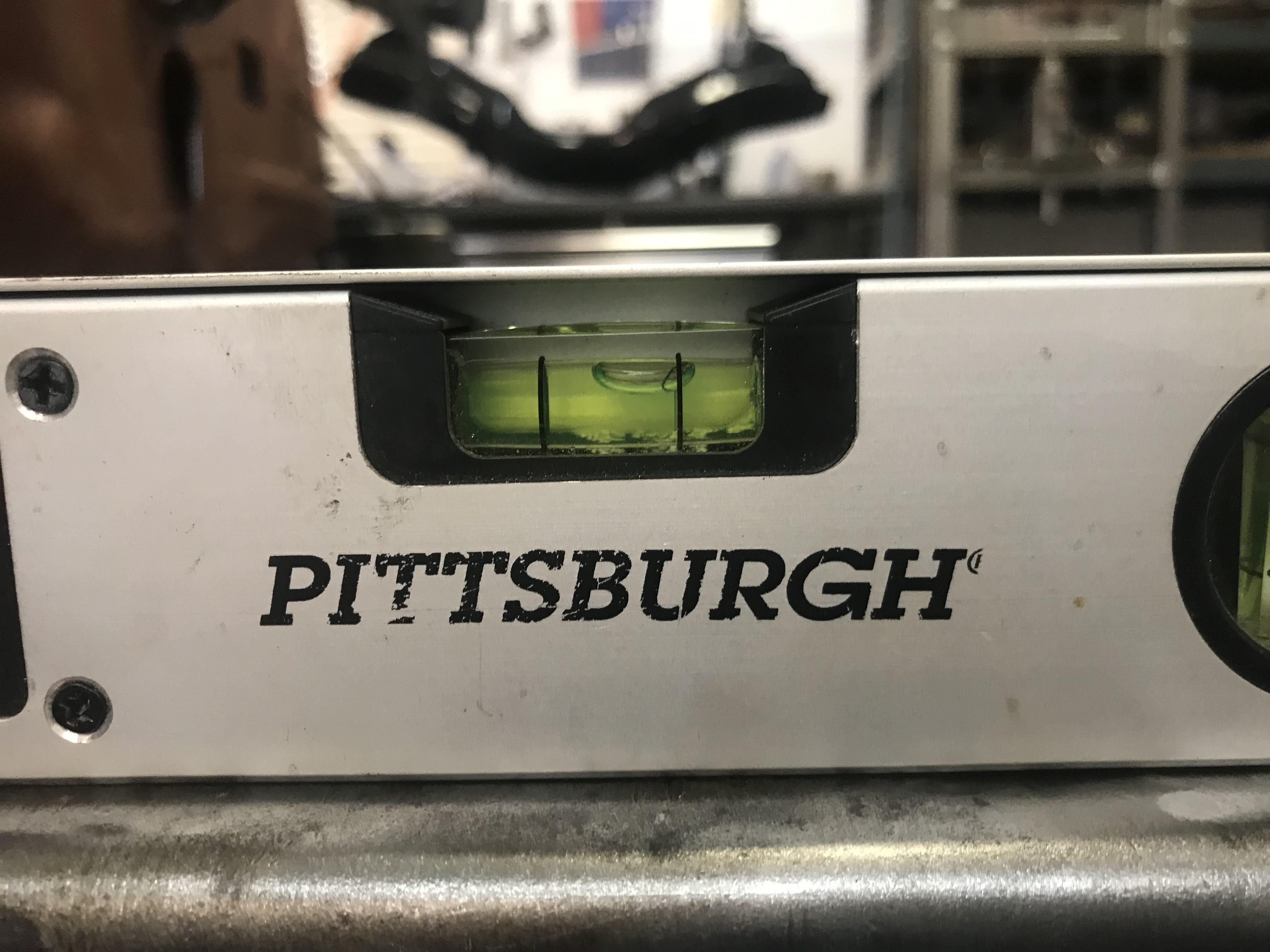

at first this level of inaccuracy made my heart skip a beat...
but then later I realized the whole front end is up in the air a bit more than the rear and not on the level
so Top Tip, when twerking on old cars or trucks, measure and go off of their parts and not off of the circumference of the earth and shiet, (I once built a perfectly symmetrical split bumper for my '54 ... spent hours and hours on getting both sides identical, and then I mounted them and they looked jacked, I could not figure out what was wrong, so I cut the uneven side all up and welded it up so it looked like HELL on the garage floor, then I mounted it up, and my wife goes HMMM THAT LOOKS PERECT !!!

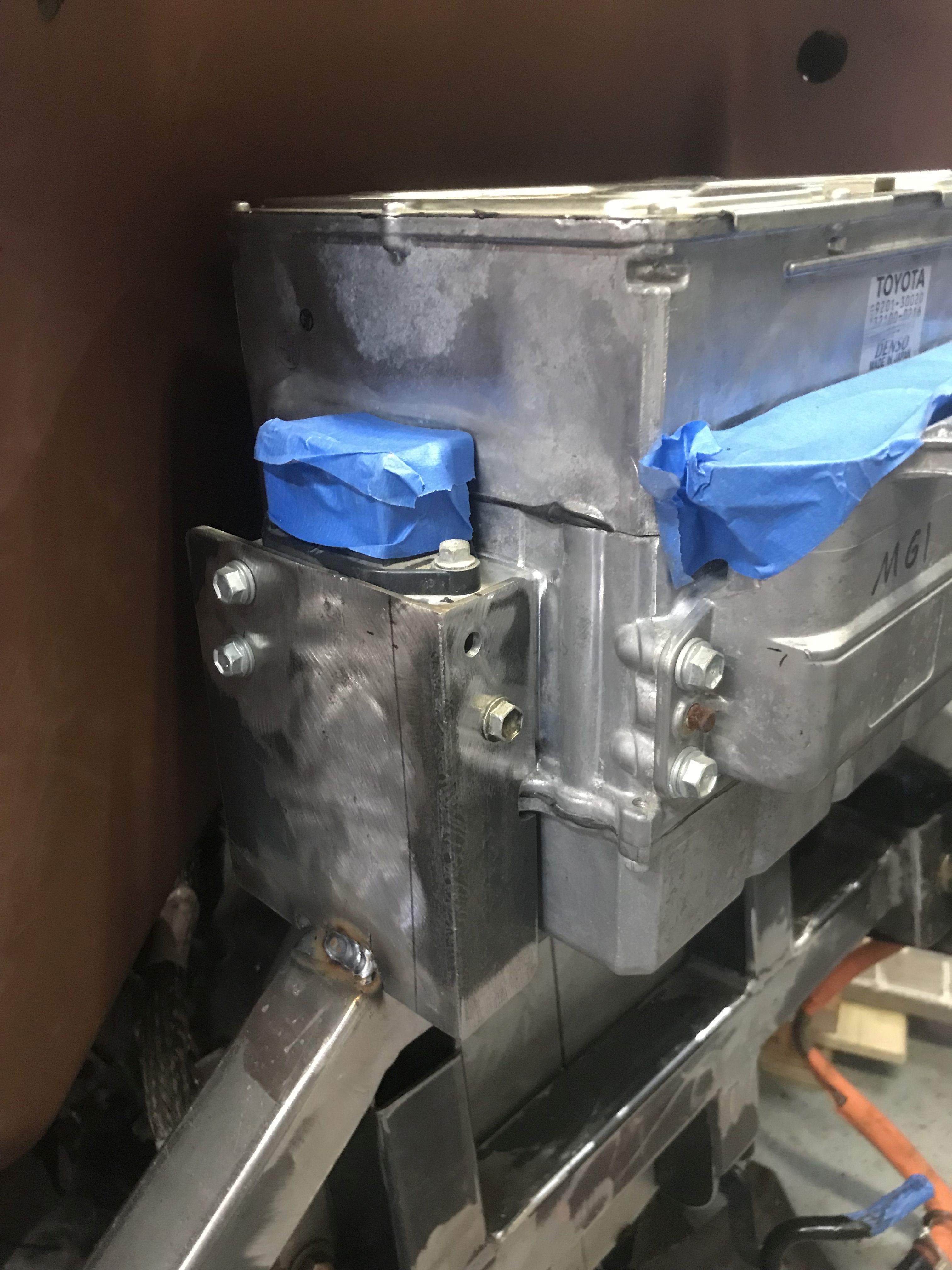

Post by Gregski »
that's more like it, I like it! do you?
Gregski
Posts: 3158

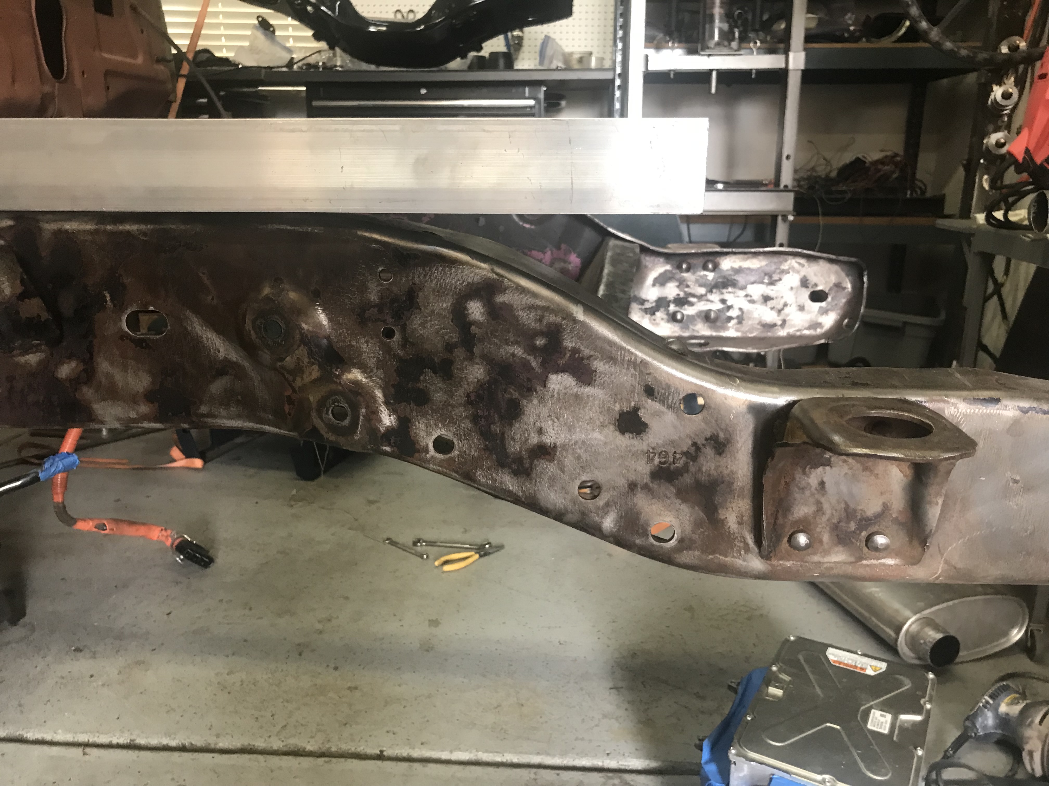

Post by Gregski »
and here's how them horns look naked, perfectly level from 50 feet...
not purdy but strong
