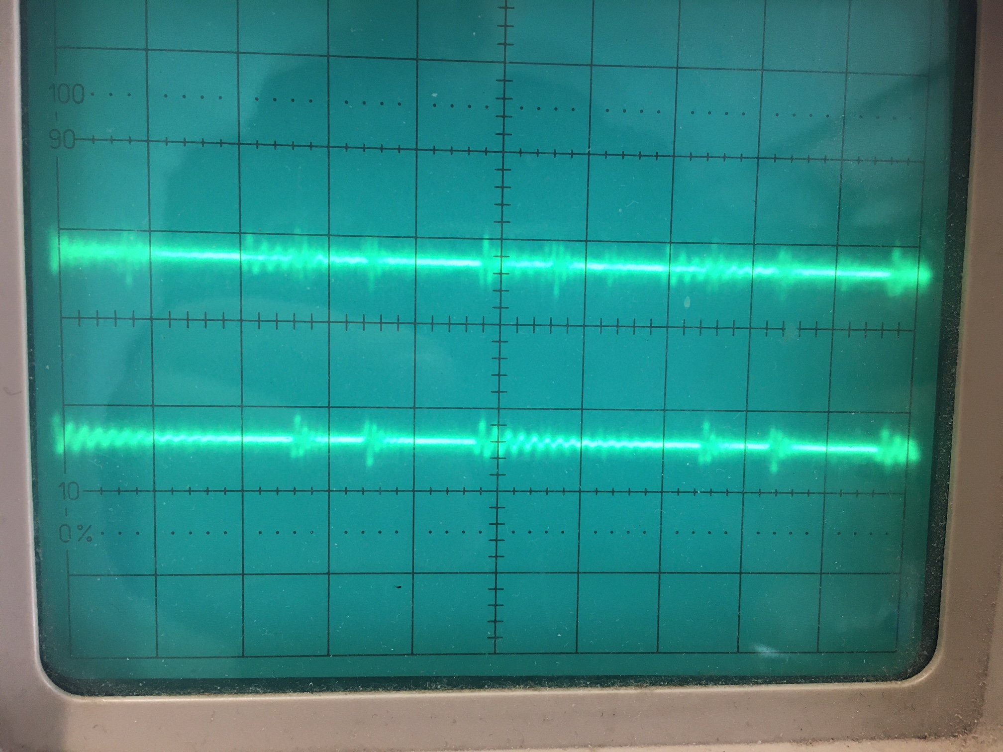

I need some help. I've got the GS450h motor and inverter (suppled by a breaker and from the same source vehicle) wired to the ZombieVerter, throttle pot connected and all wired up. I do not have a shunt connected and I'm using two 12v car batteries in series as my HV power. I'm using the gearbox manual gear selection, which correctly provides the forward/reverse signal appropriately to the VCU.
The VCU board is missing IC10, IC20, IC12, R14 and R48 but I don't "believe" these impact the operation of running this Lexus setup. I made my own loom with the correct connector to the inverter and checked continuity from the leg of the IC on the VCU through to the inverter connector - all good.
Going through the start procedure, relays click at the appropriate time and HV power gets to the inverter, the "opmode" shows "Run", the "potmon", "pot" and "torque" increment as expected, the "dir" shows "Forward" but "InvStat" shows "off" and the motor doesn't turn!
I've attached
JR_Zombie_GS450h_ Inverter Management Console.pdf
(473.29 KiB) Downloaded 323 times
Before I pull the last of my hair out, could someone look through attached settings captured from the web interface and let me know if I've got something wrong?

you need to calibrate your pot 2 , I cant see pot 1 min but I assume as your idle value is above the min ,meaning that inverter won't actually go into drive as it already thinks your pressing throttle. I am surprised to see you don't have any inverter udc , is your inverter making a high pitched wine when turned on?

paaa - thanks for your advice. My throttle has a single pot, so, I set that parameter and the web interface reflects it's movement and torque requests/potmon respond to change accordingly. The Inverter does not buzz/whine at all.
Putting an old Skool scope on the serial pairs, all pairs are at ground before "Start" is pressed, then jump up about 1.5V and produce this waveform - I'm wondering if anyone has seen this issue before and how they solved it. - No square waves or whine for me!
